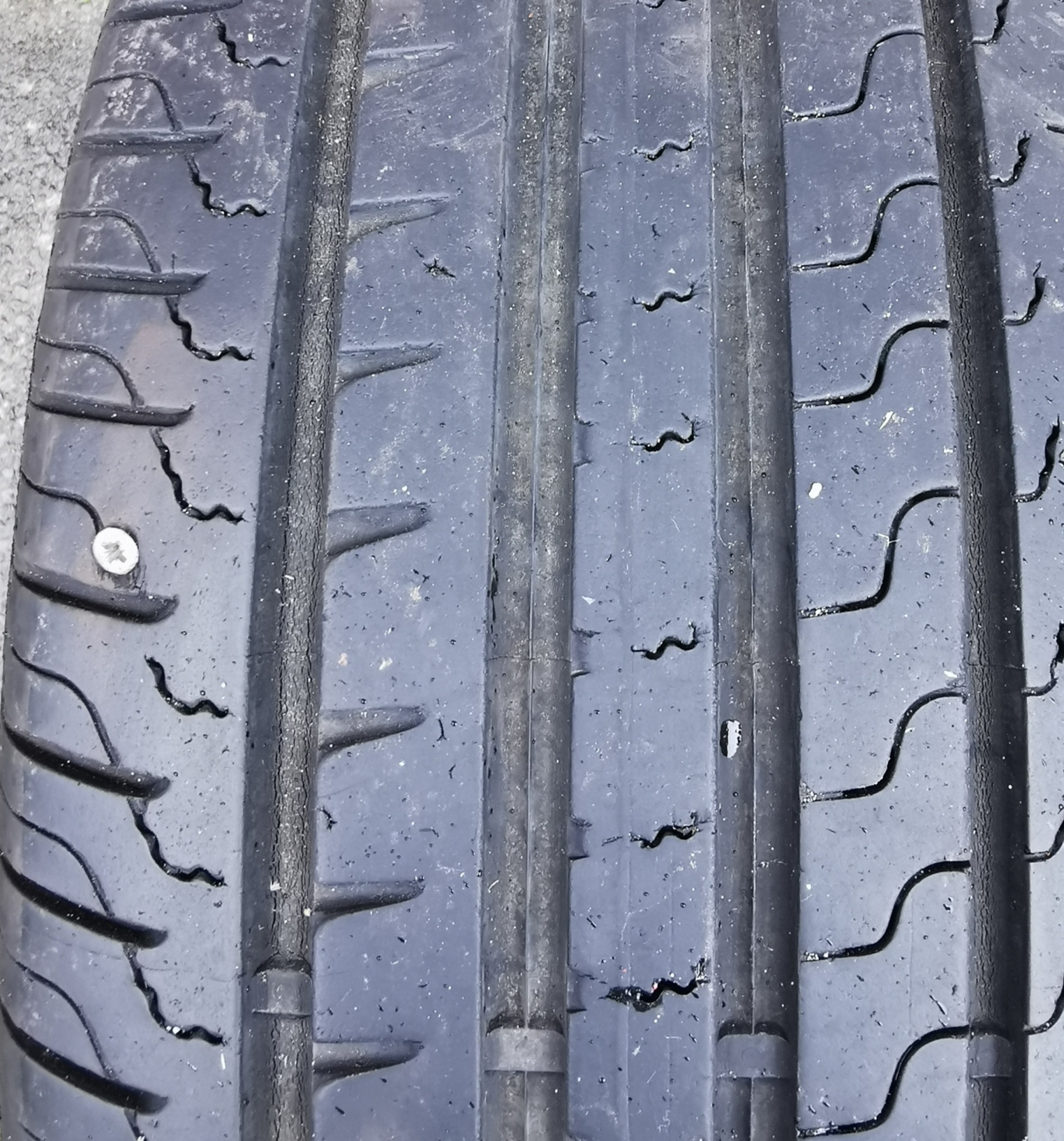

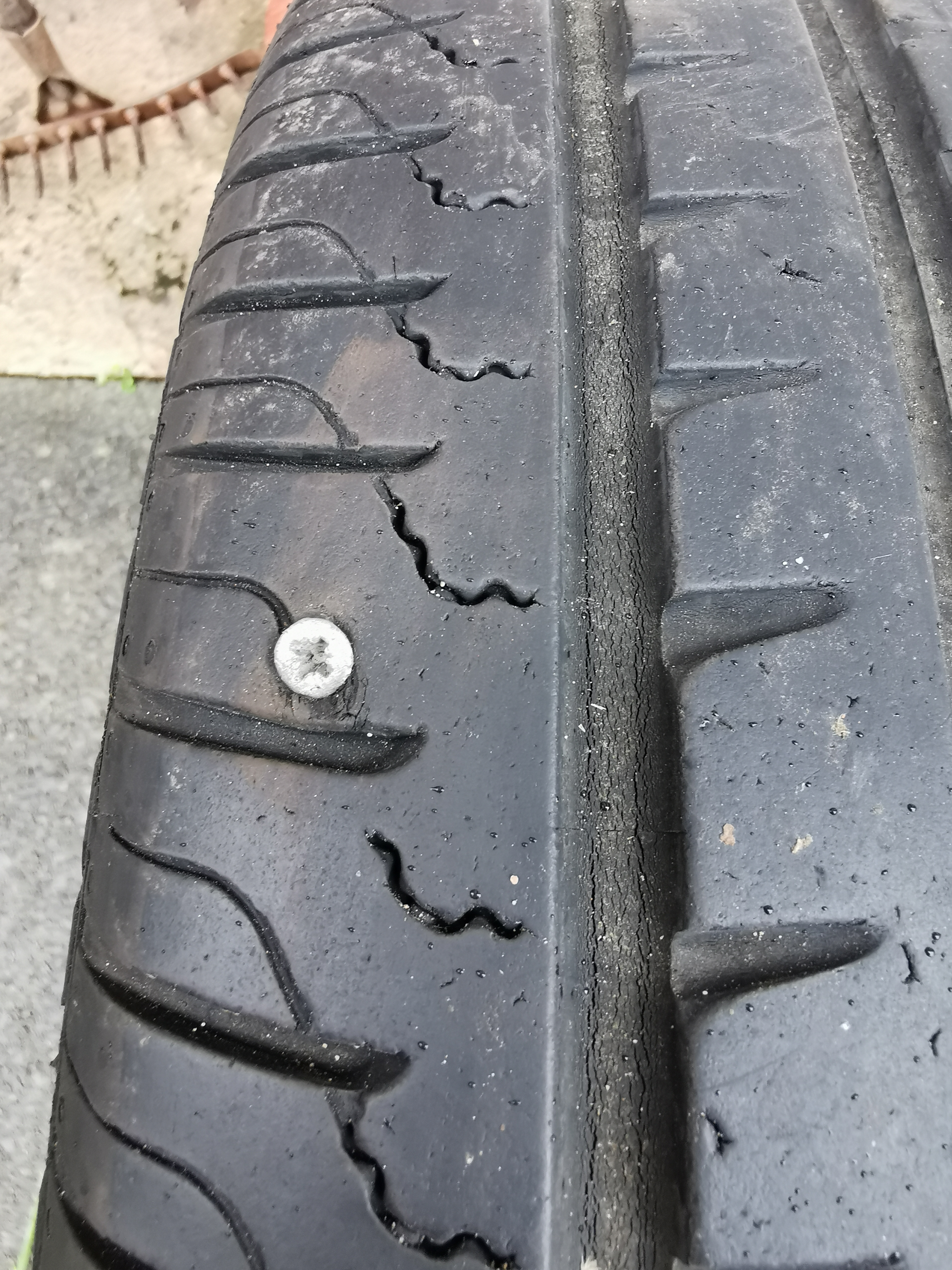

Thoughts on this, ideally I'd get a new tyre however I've not long since had them on new hence the annoyance.
Repairable or not or do I bite the bullet (don't want to really!)
  2014 Clio 200t edc
I’d get it repaired, and if a garage won’t do it (because selling a new one is easier and better for them) I’d repair it myself with one of those repair kits. They are fairly easy and work.
charltjr
AFAIK the only way to do that safely is with a vulcanised repair not a patch. Too much flexing going on for a patch. It’s a specialist job but it might be saveable.
Steve
  LMC10, Puma E
Outer tread is usually a NO at reputable places, for some of the reasons above.
Image grooves look perished anyway, Continentals?
