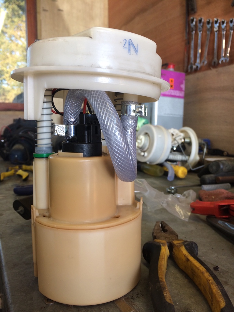

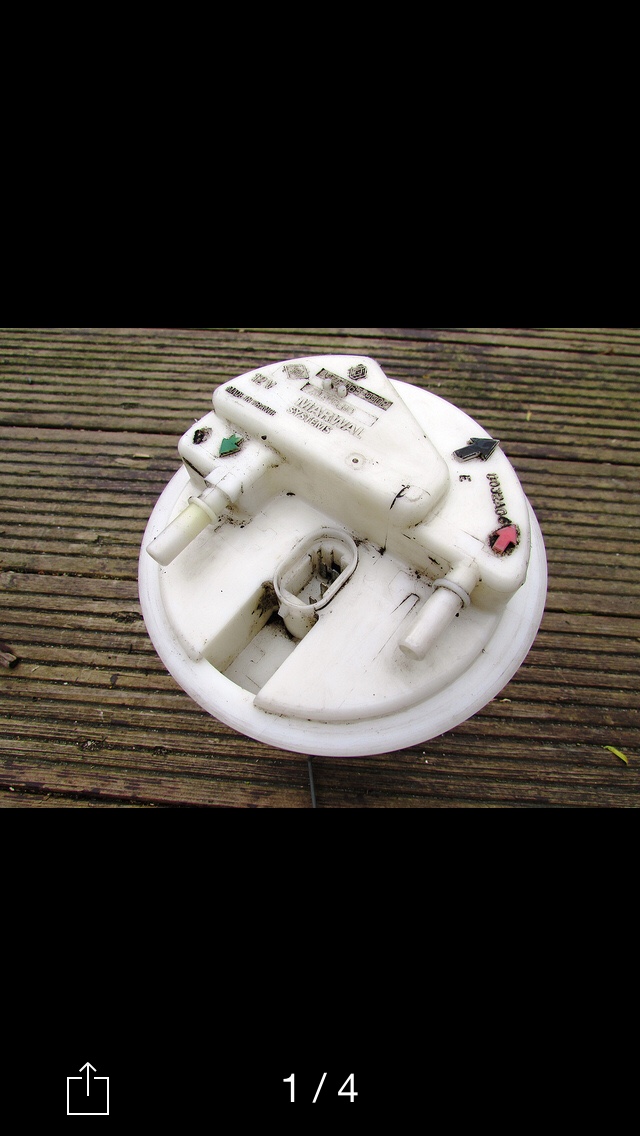

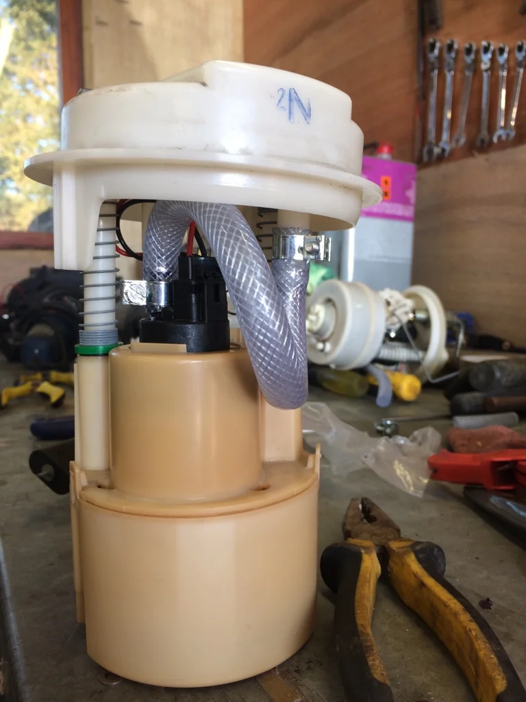

phase 1 fuel rail, pump and return line
Make sure you take this advice, I changed mine to this and now i have no surge issues and can run under half tank. Fitted a walbro just to be safe.
I bought a 1.4 sender, and fitted walbro.
The return puts fuel back into the bottom of standard swirl pot.
