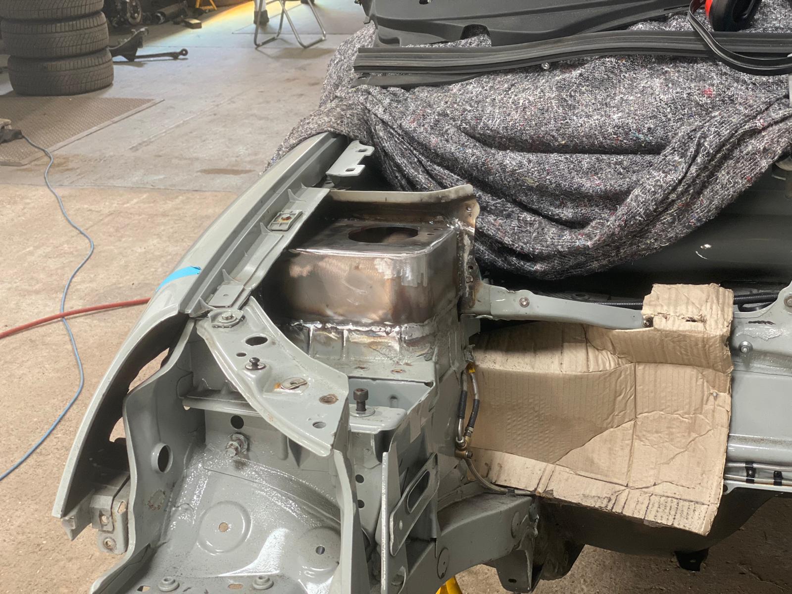

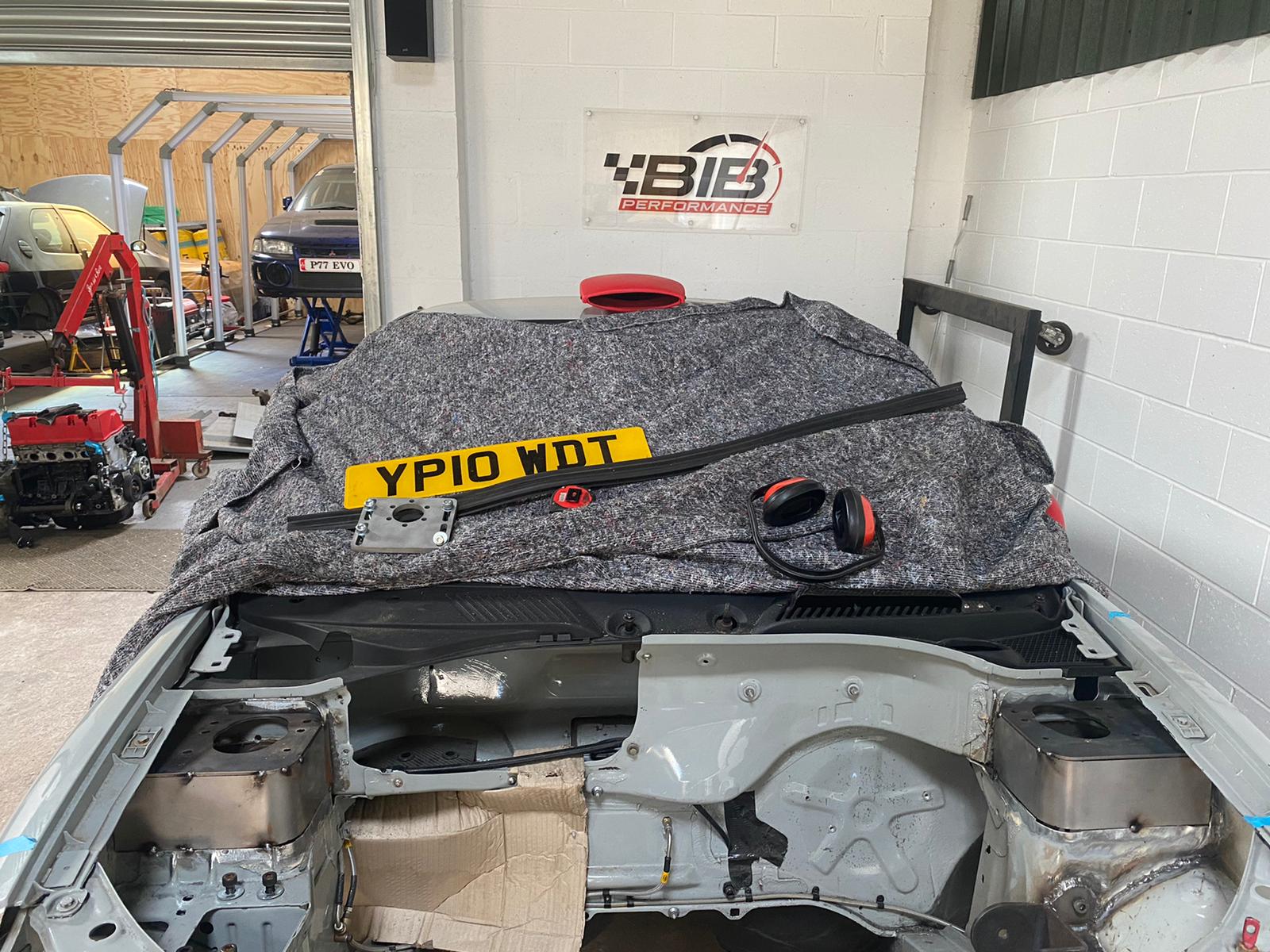

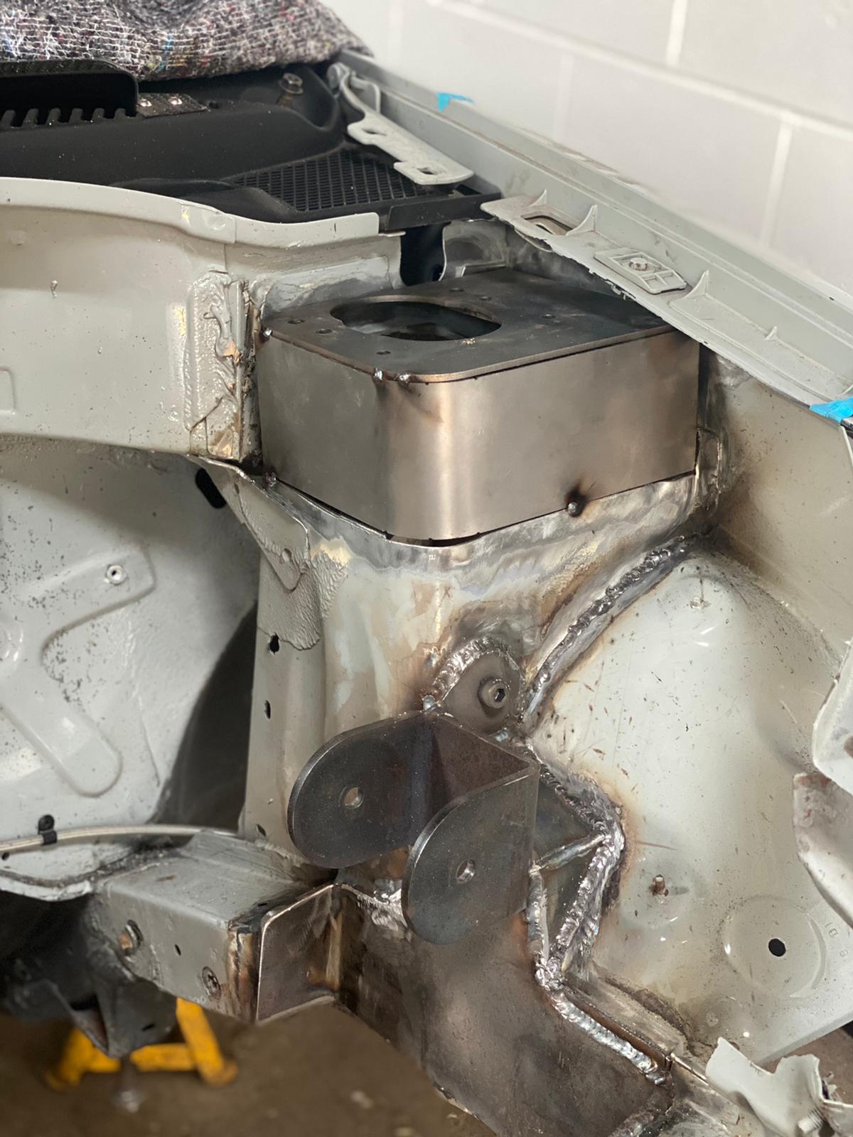

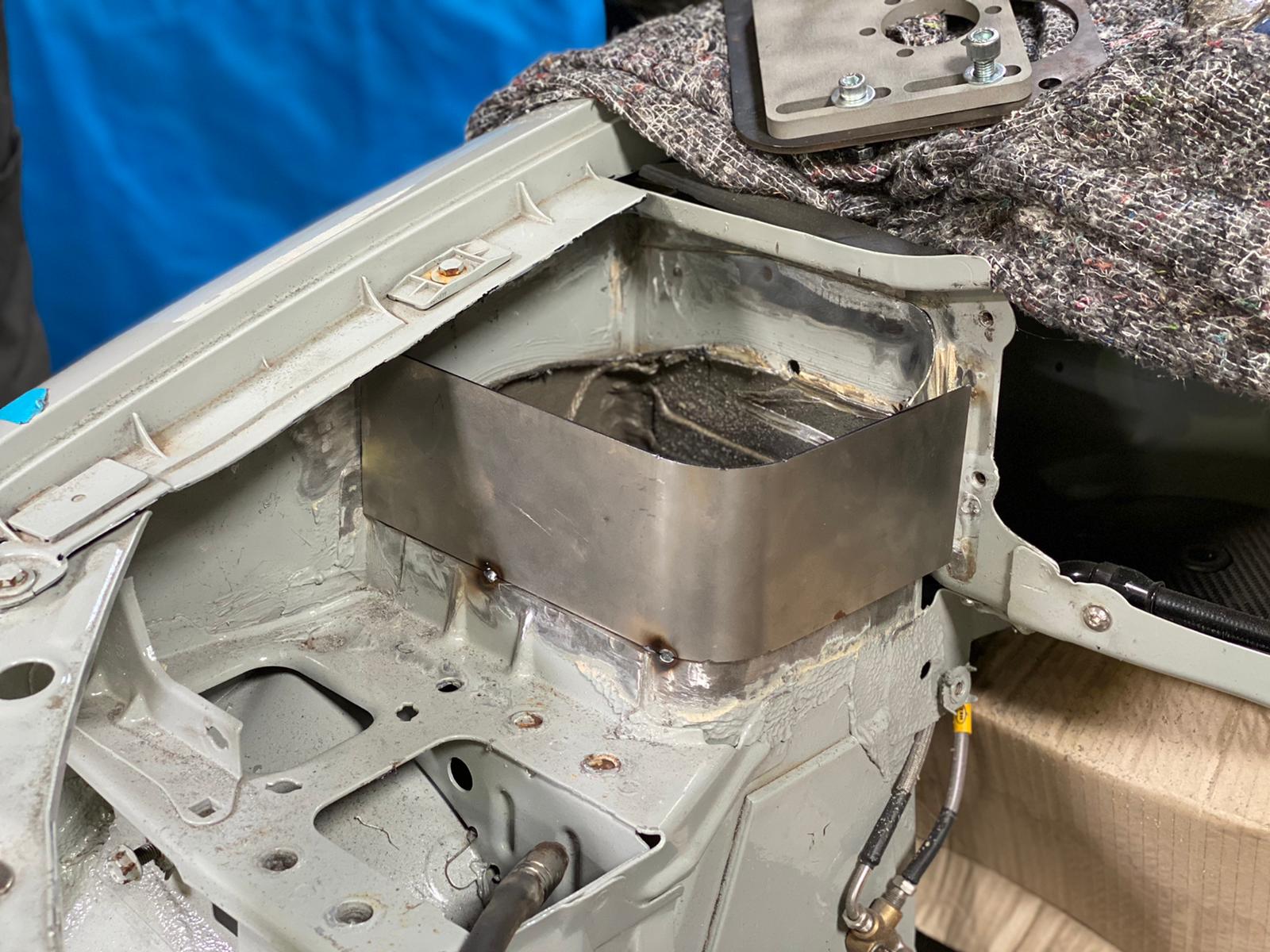

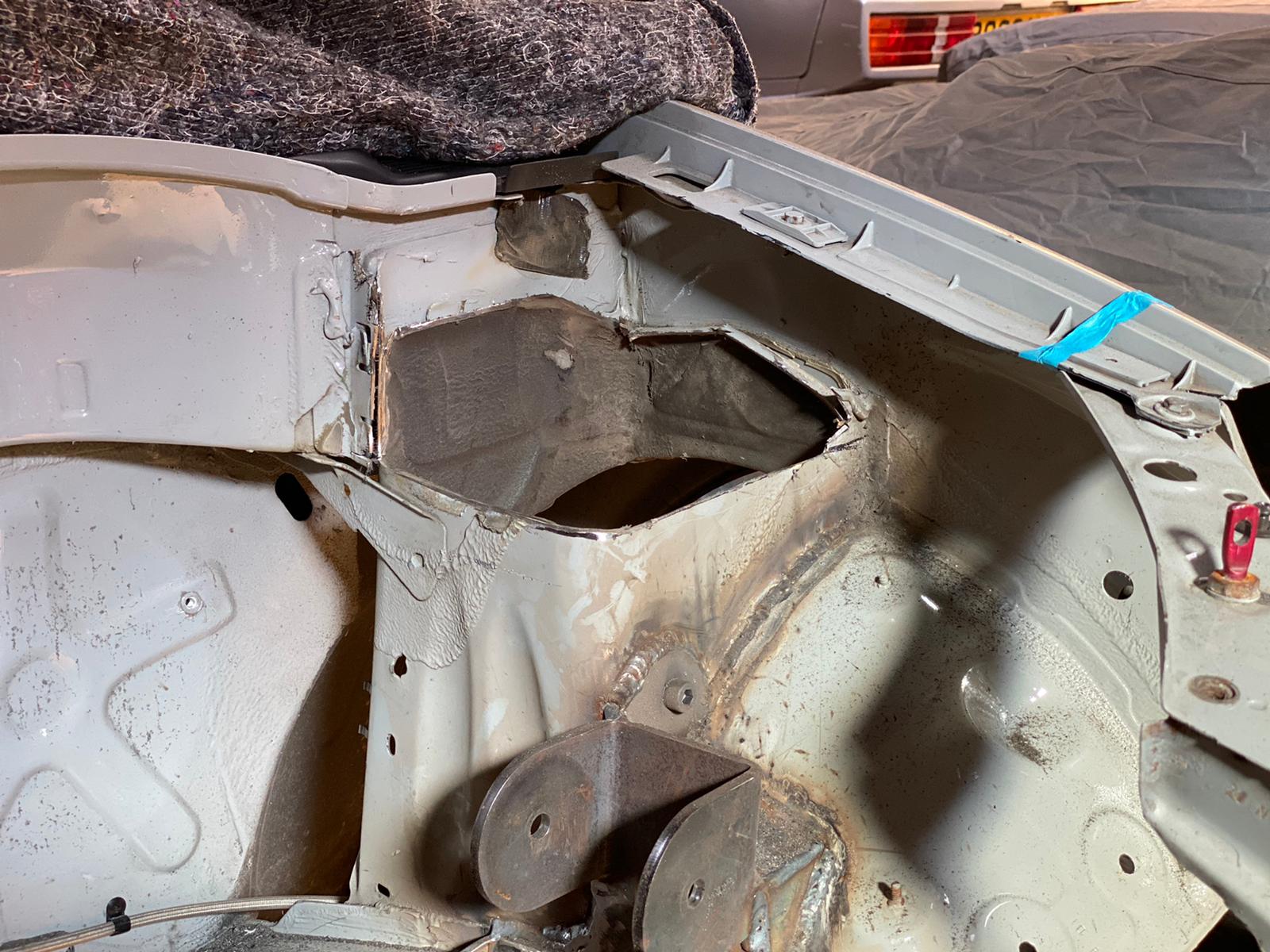

Pure motorsport weld in castor adjustable top mount kit.
Chambers_RS
  Clio 172 Cup&Leon K1
A lot of work but easy if you can weld.
Chambers_RS
Ideal, thanks mate. Luckily yes I can weld! Was exactly what I was after in terms of how much cutting etc required. Still not sure about cutting into my car but may do it! [emoji106]
Go for it. Should make a good difference.
I had to cut my chassis leg 🙈😂
incy-spider
[emoji30][emoji30] will be worth it though!
Did it take a fair bit to cut at the back of the turret? I have a plasma cutter.. also did you do any of it from inside the turret?
Mickb
  van low and 1.6 16v
Didn’t @Mickb fit it to his yellow van? Or am I thinking of something else
Yeah I did. Was nervous doing as there wasn't much pictures showing it.
But tbh it's straight forward to do. Once you've got them fitted you just measure up for the brace.
Plasma cutter will make quick work of it.
