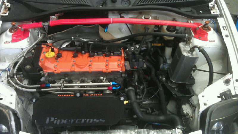

Only 2 pipes, one in, one out to breather filter.
Can see in this pic
Ahh I see, that helps a lot, so the out pipe to breather filter can be located anywhere right, where have you located yours?
