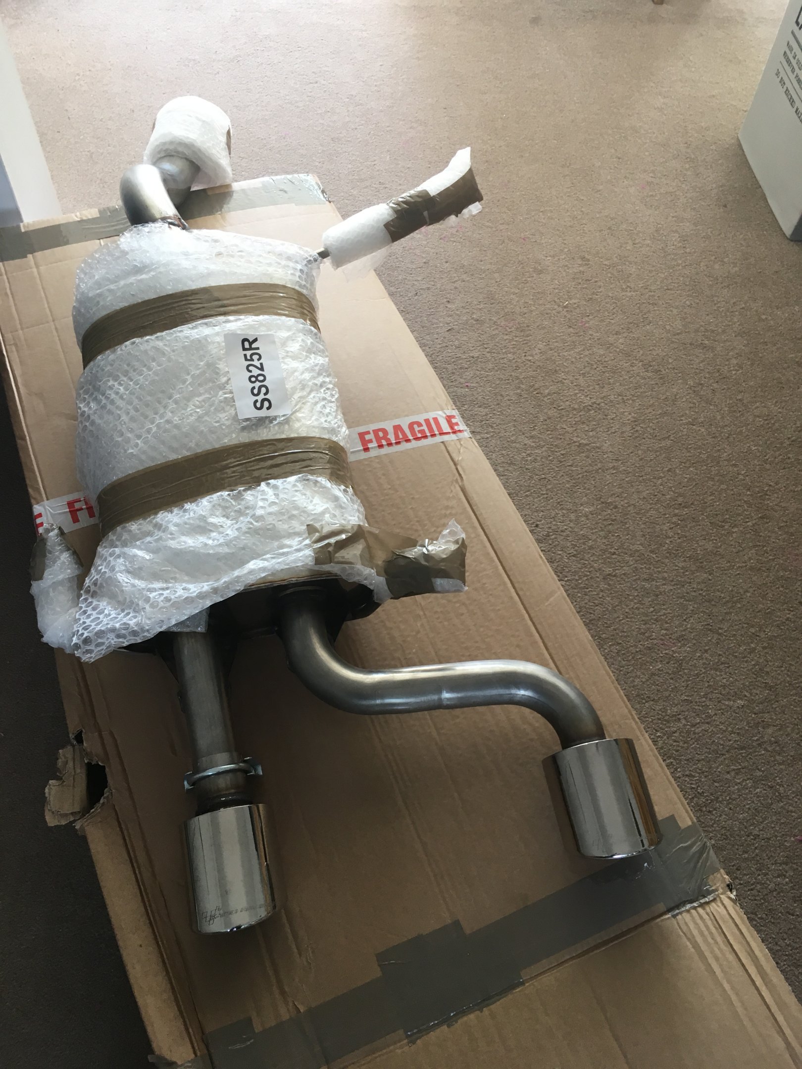

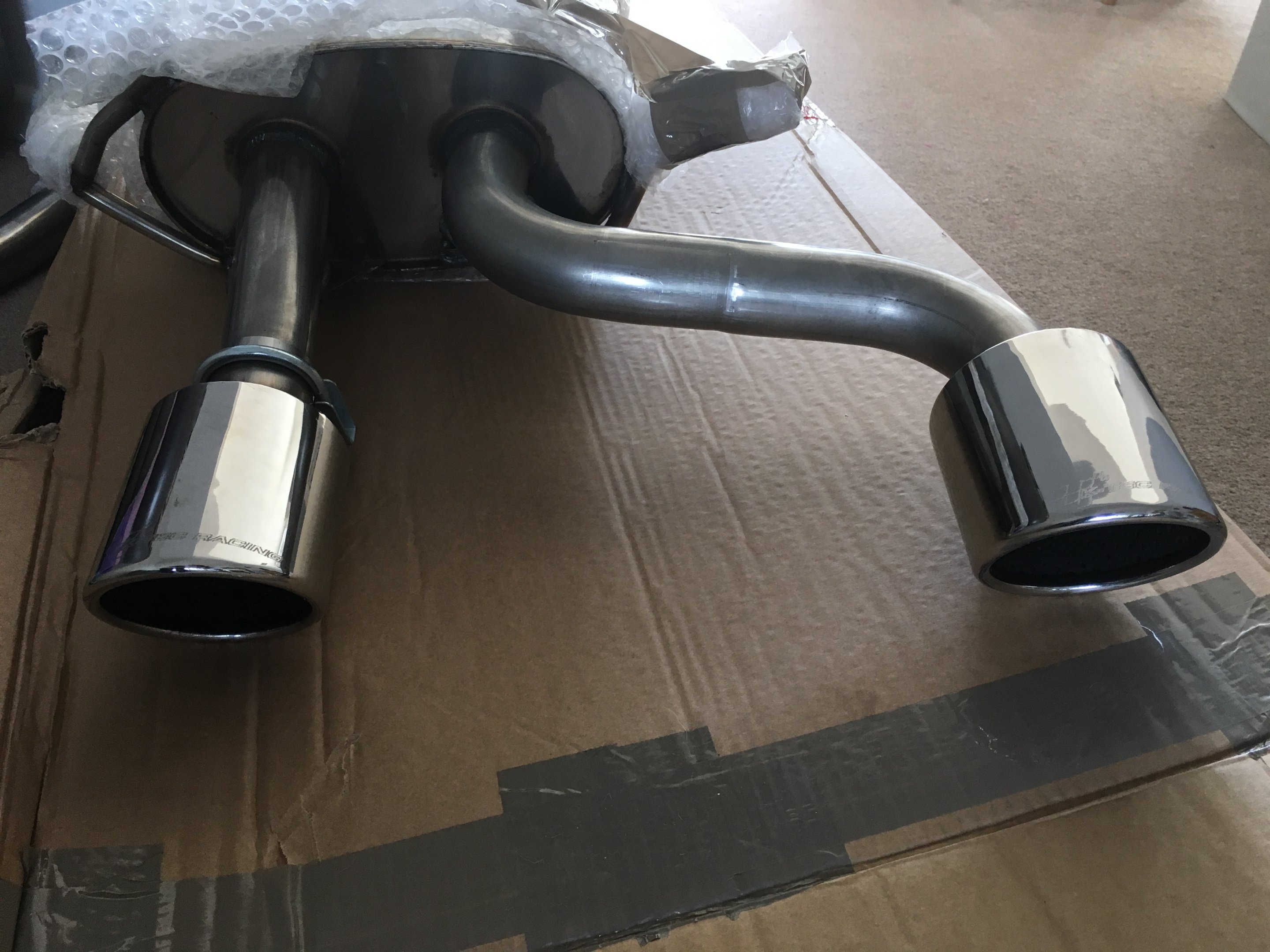

This arrived today..
Thanks for all the input lads
