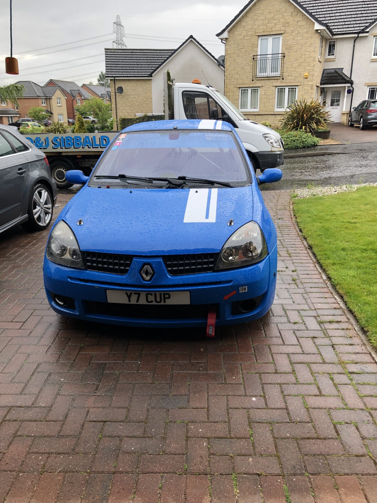

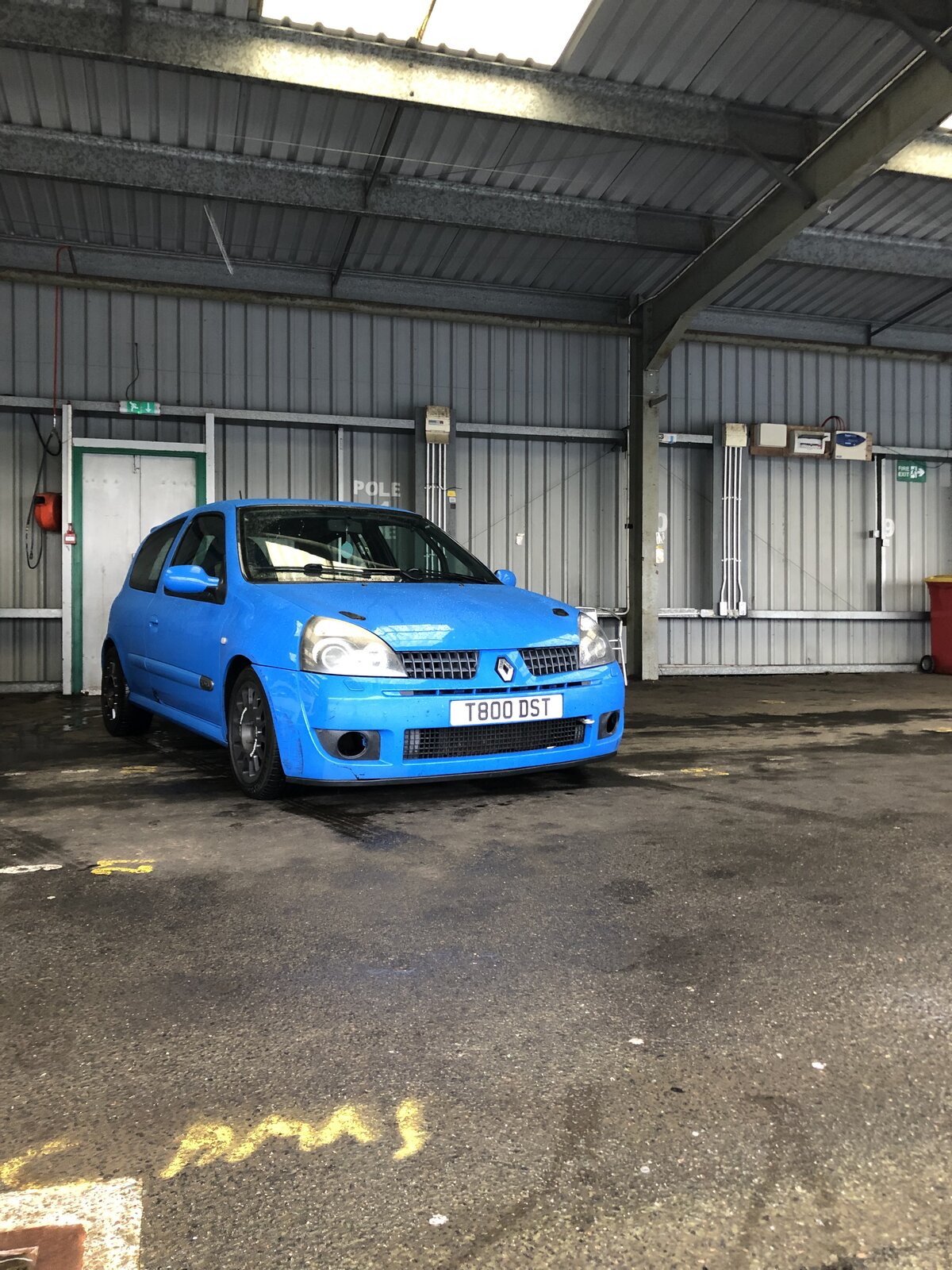

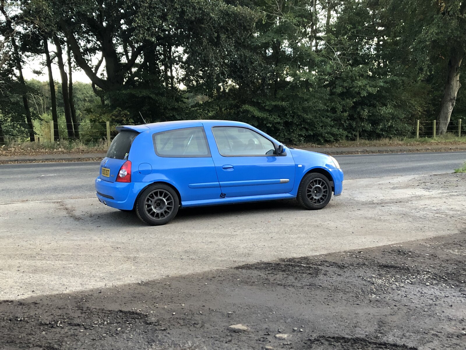

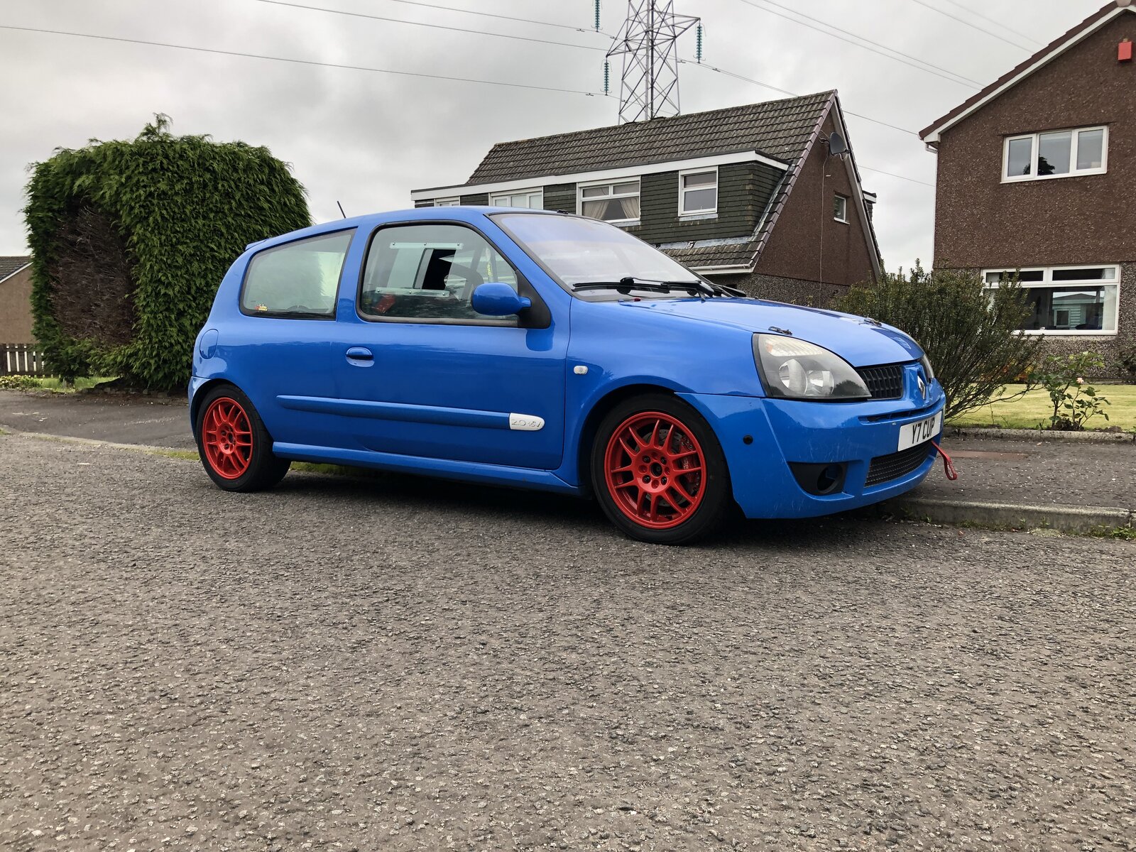

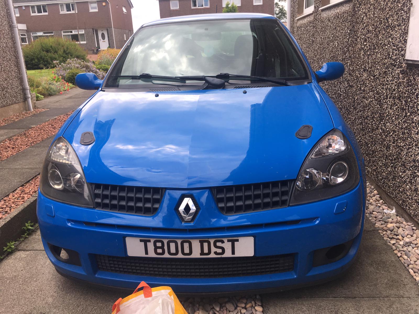

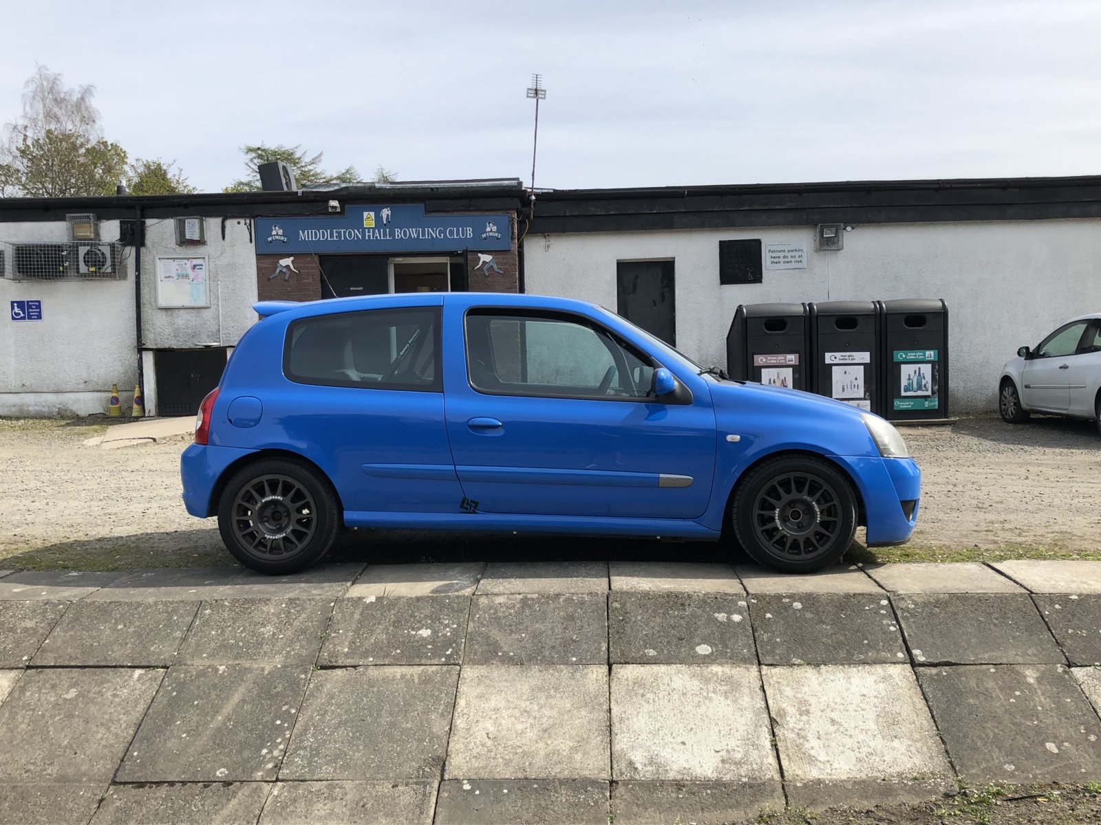

For now I’ve a couple of pictures of the car as it sits before it gets a bit of a remodel.

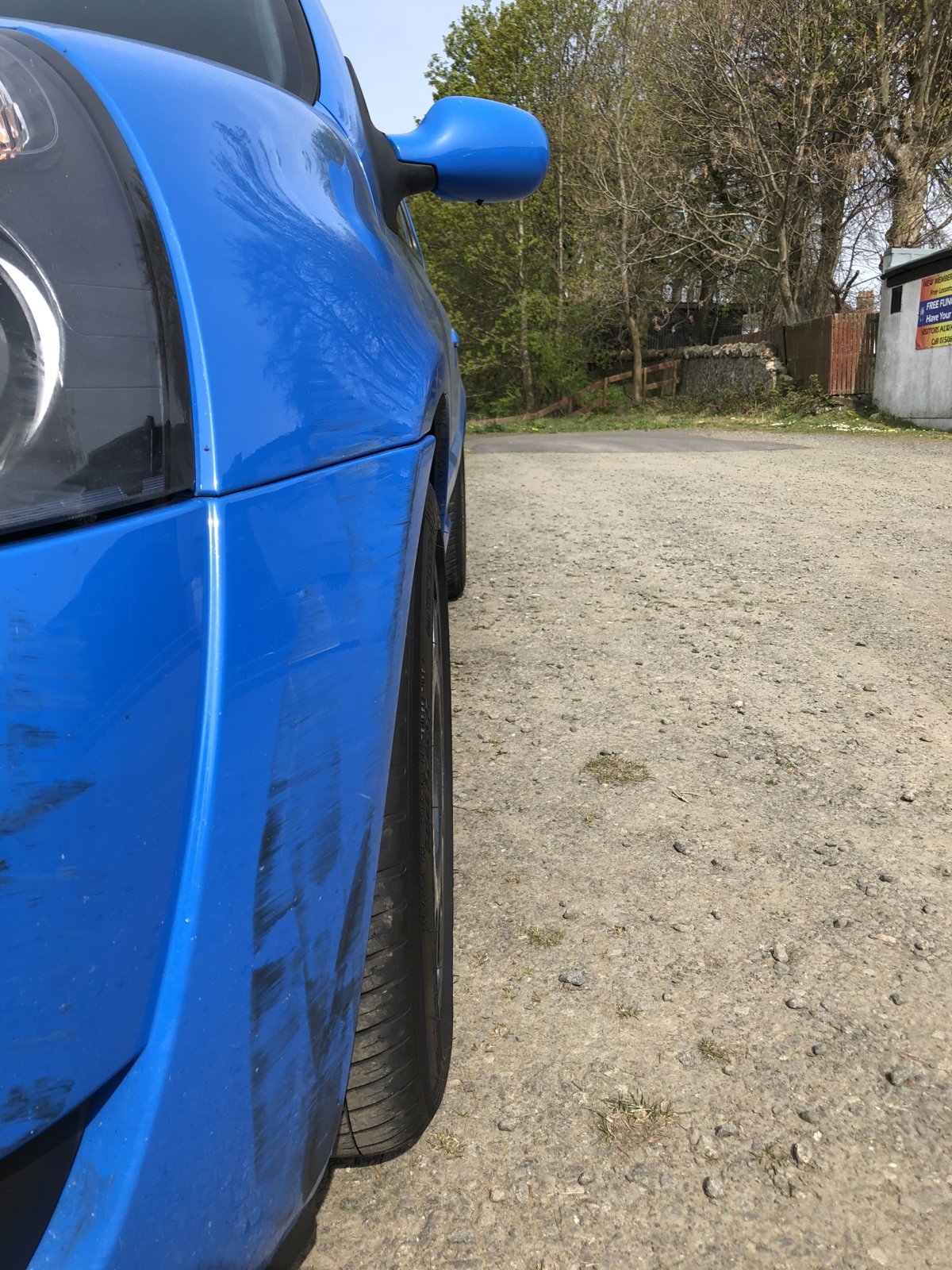

Not a huge lot happening with Tboost atm. A few bits and bobs happening being the scene. Cars currently with John while he works on his 197. He kindly polished up the headlights while I was on holiday, removing some marks from clipping cones and some bad haze on the drivers side.

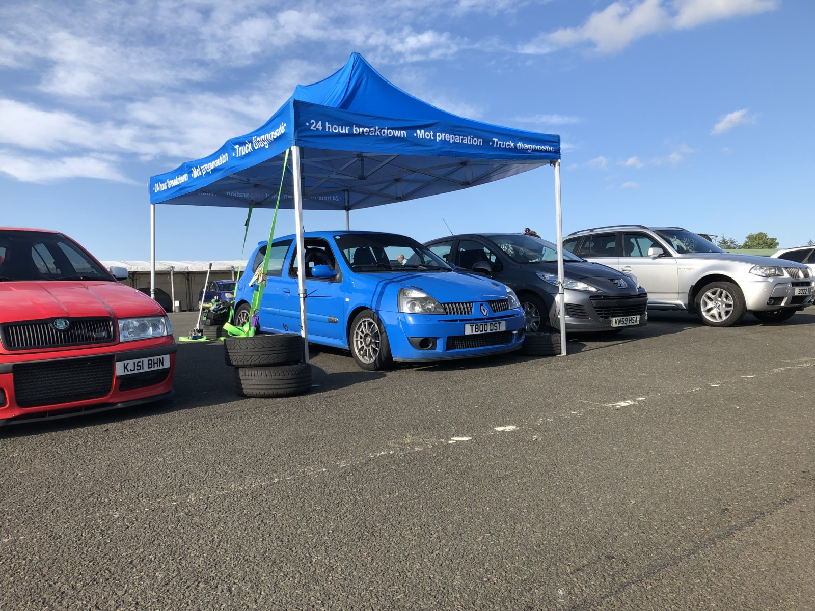

2Hour open pit evening at Knockhill.

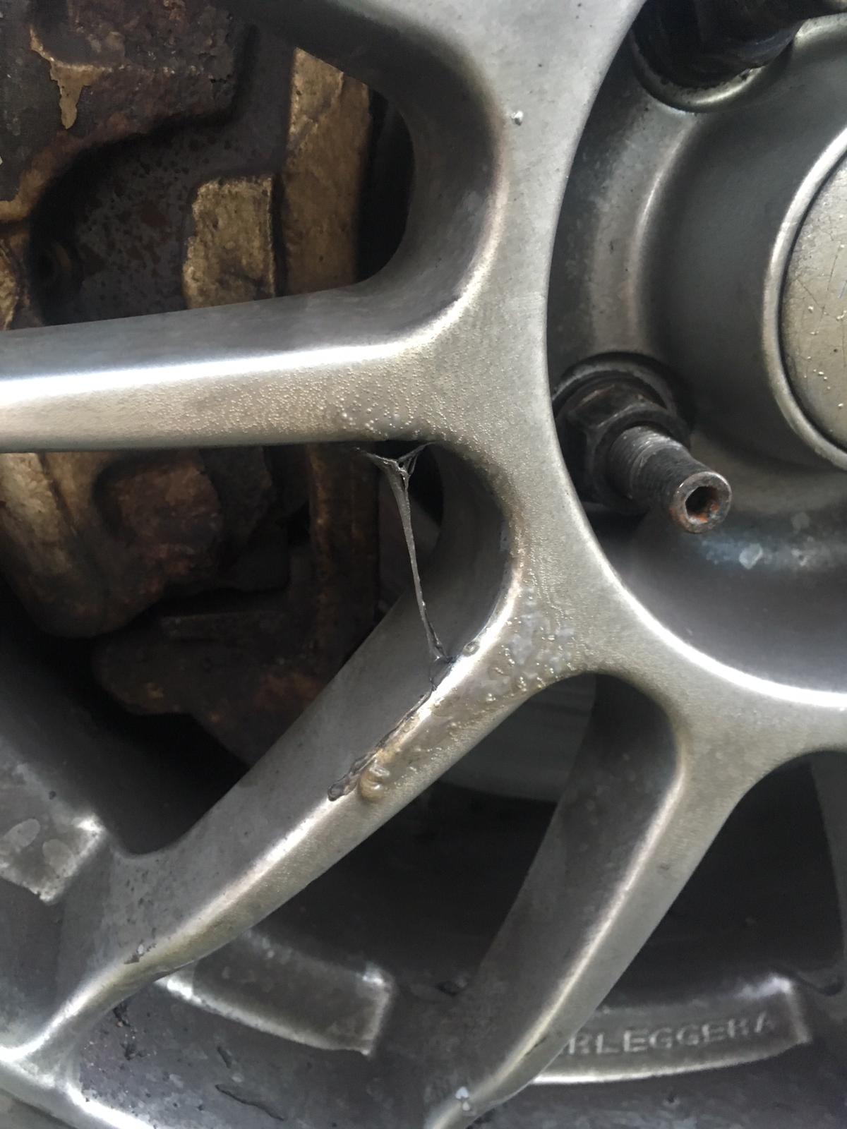

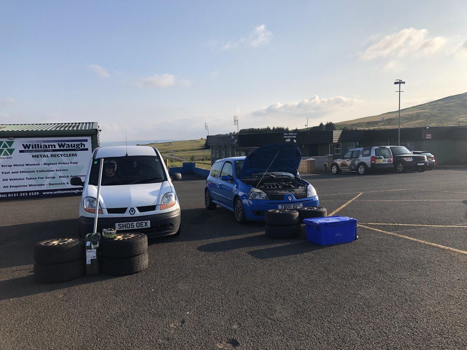

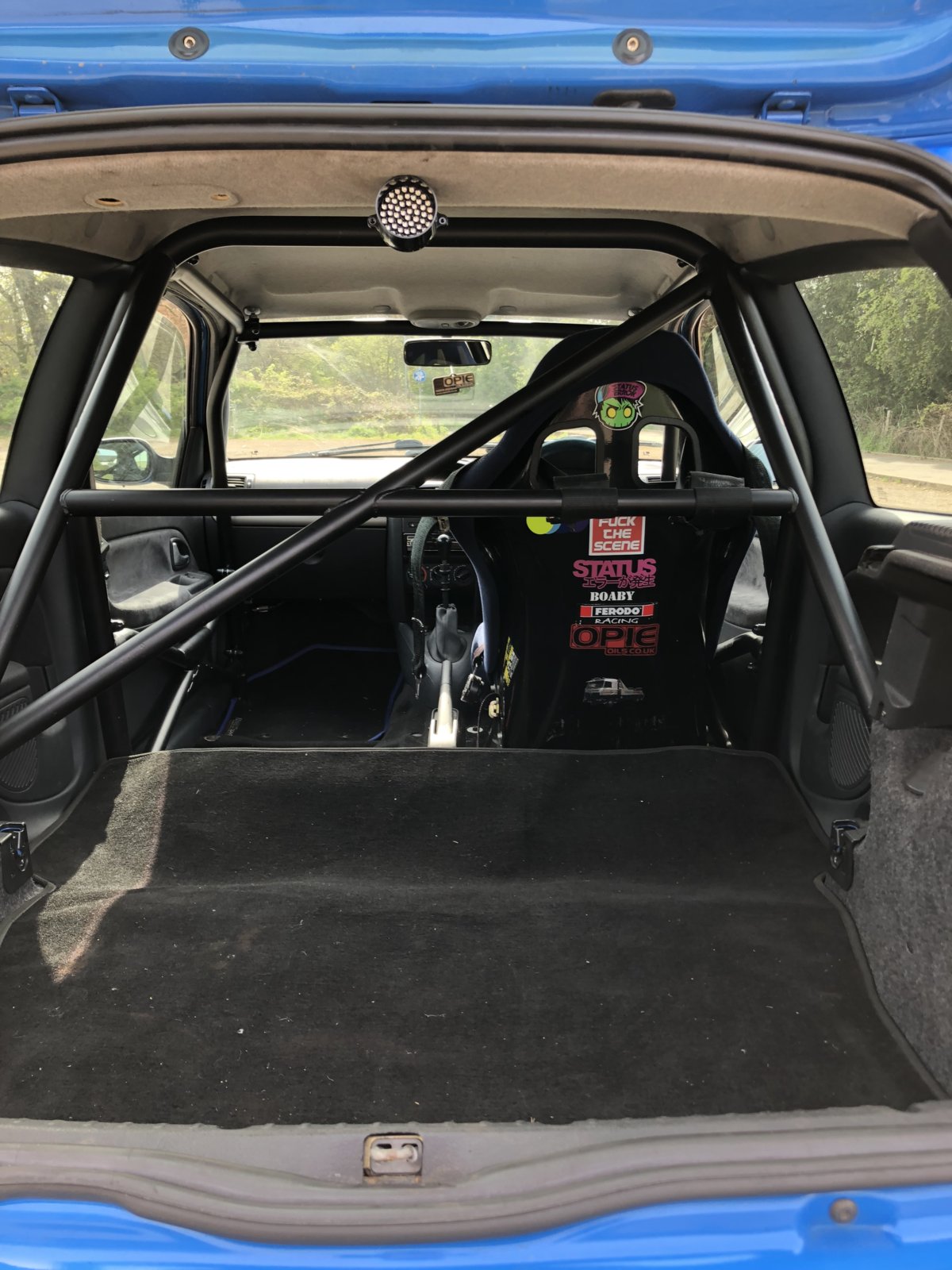

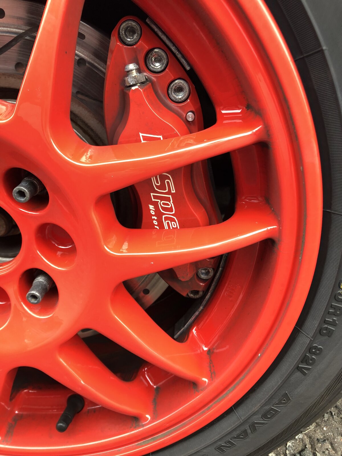

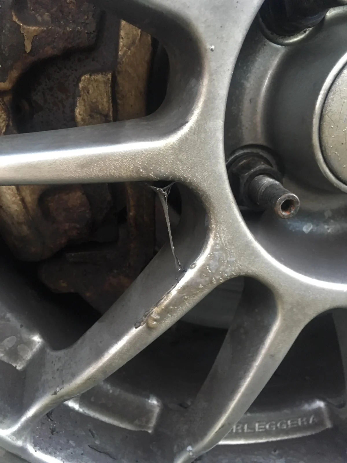

Ran with a standard pass seat and belt to give John and cousin Mark a few passenger laps (usual only run the drivers seat). The extra weight is fairly noticeable when pushing on, the car feeling much slower and brakes having to work a lot harder. Managed to melt/bubble the powdercoat on the front wheels this time out.

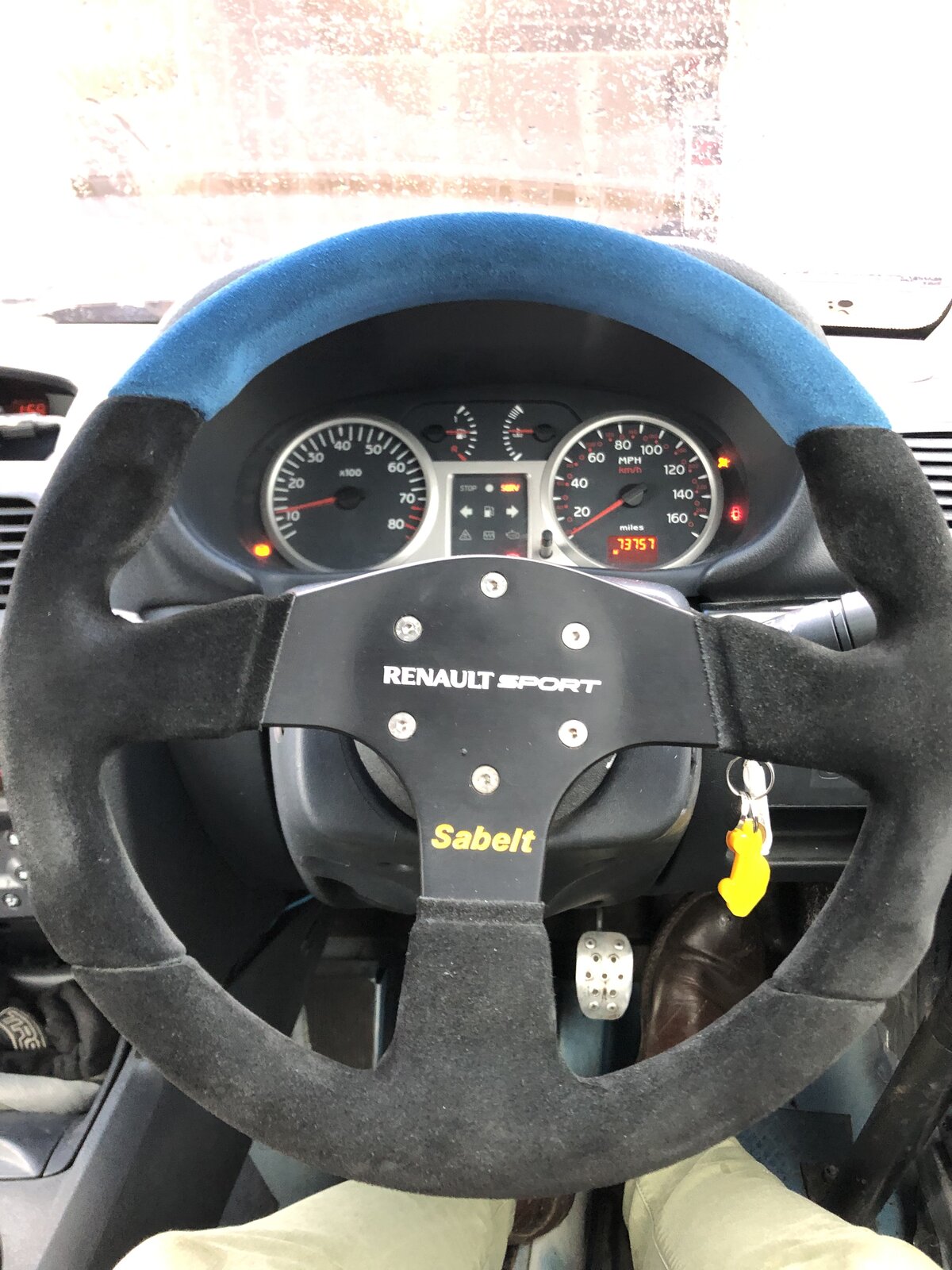

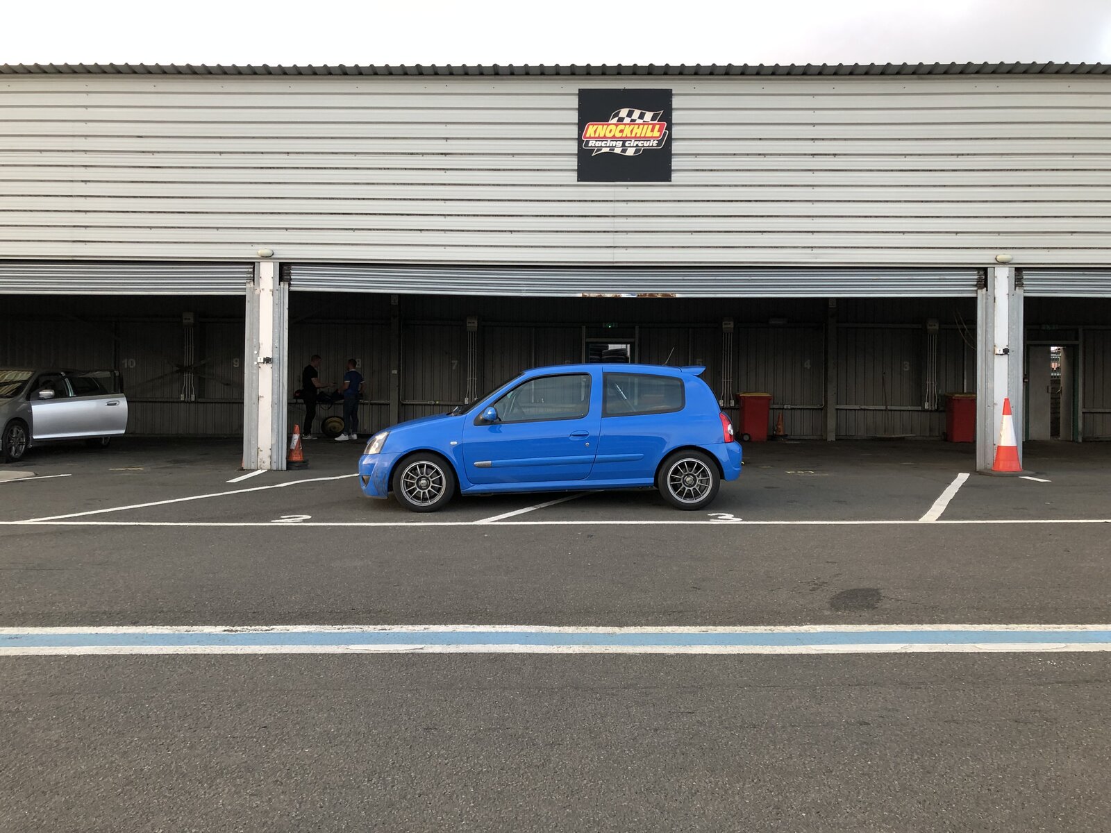

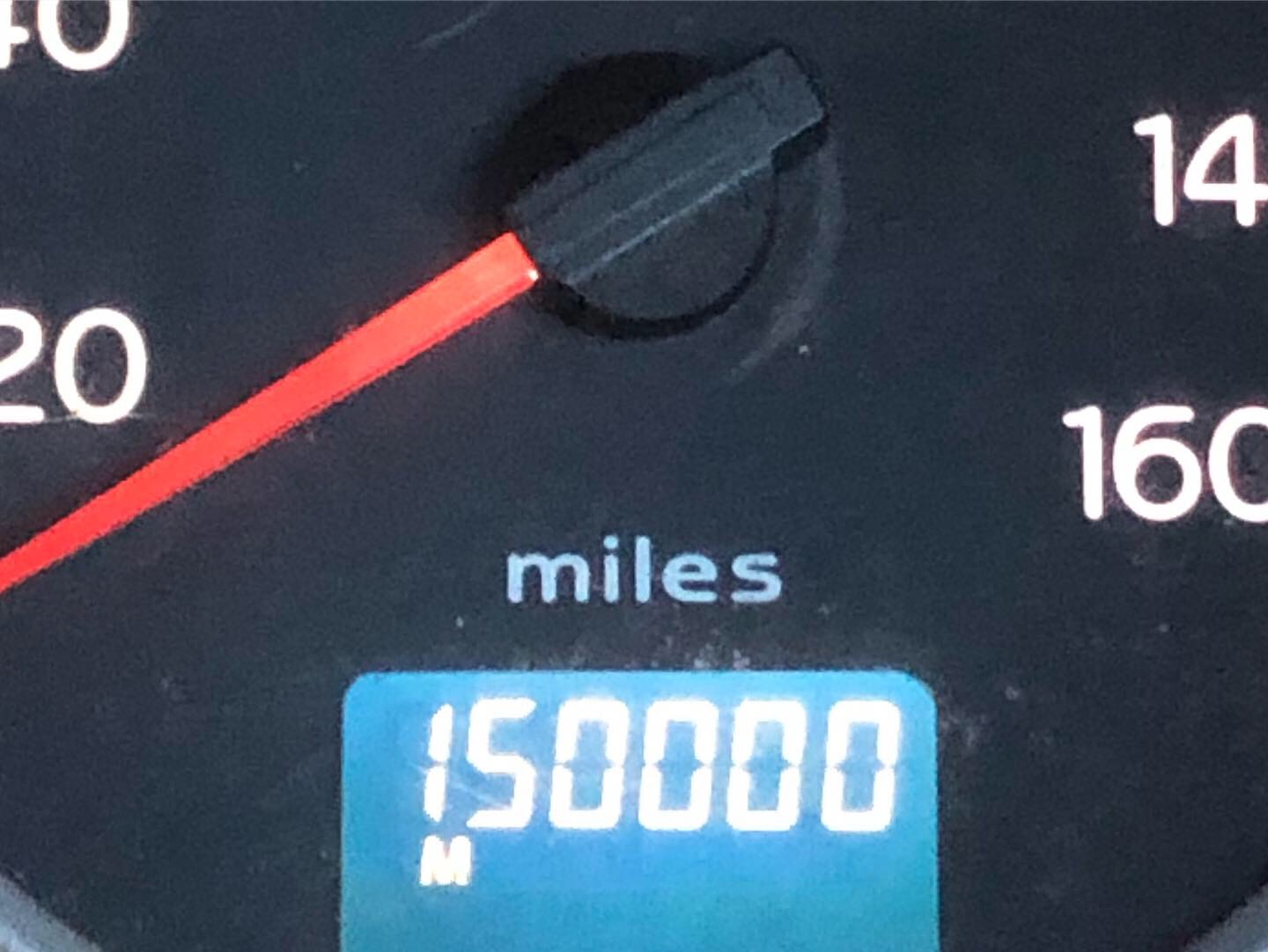

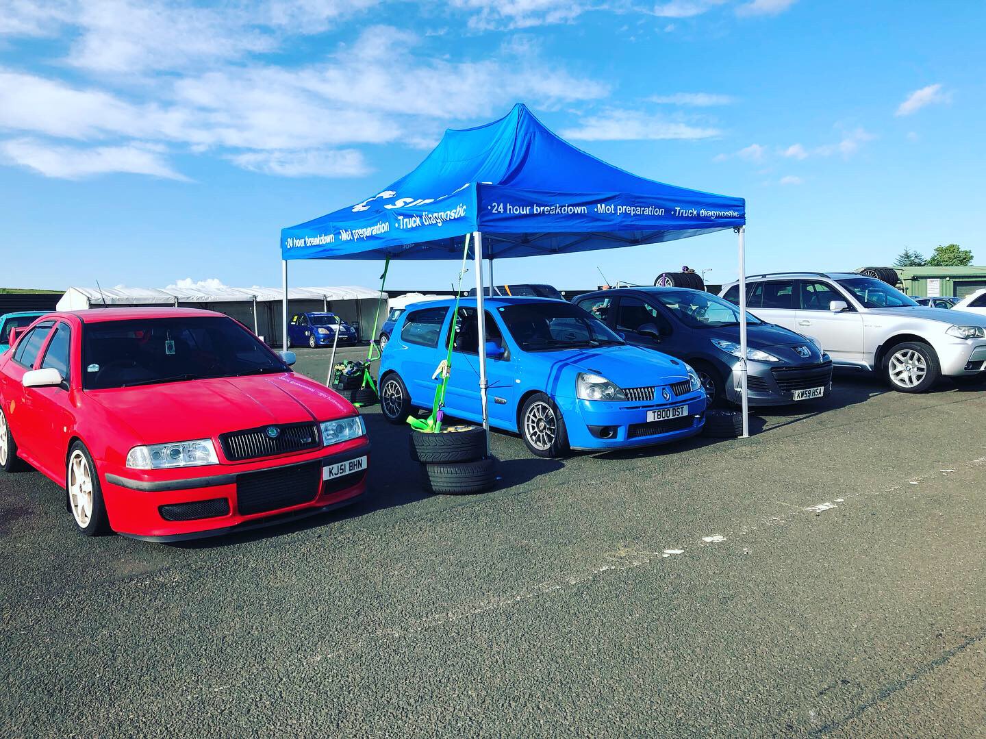

No on track pictures. Just a few from the paddock and one of a milestone mileage. ?

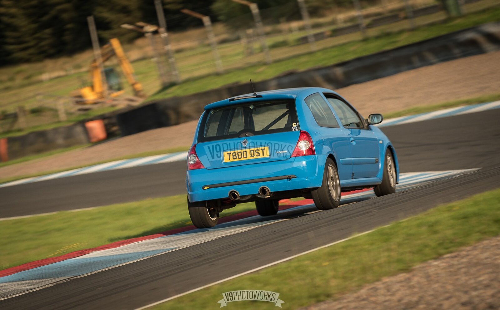

26/8 2 Hour OPL reverse direction - Knockhill
After a few sighting laps I remember just how odd it is going around Knockhill in the reverse direction. But as the evening went on I gradually fell into a good rhythm. I tagged onto the back of a friends Mini Cup car as he put in some testing for an up and coming SMRC race. Following his lines and breaking points was very interesting but good to get a different approach, they’re very aggressive on turn in.

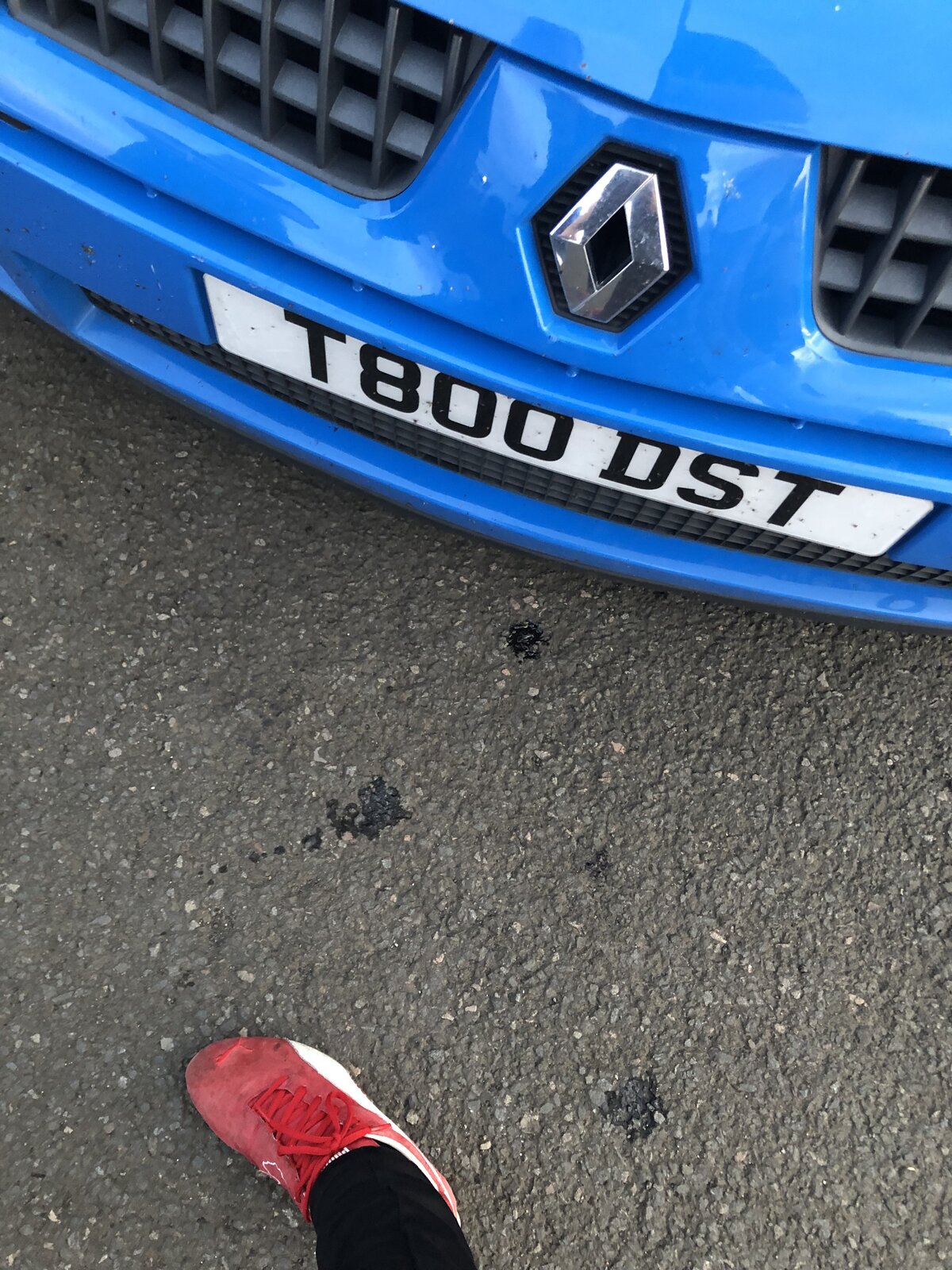

Once off track I noticed some drops of oil on the ground, something I’ll need to have a proper look into.
In total I did 58 track miles on the night. Car still feels pretty good all round. 💙

An impromptu 1 hour track evening appears on the horizon 02/09/19. As part of being a track day club member with Knockhill we get a free hour track evening once a year. It was really badly publicised, with details being realised the Friday before. Not one to miss a freebie I decided to give the car a quick check over and go play. The oil leak that had appeared on the last evening seemed to have came down from the rocker cover, it’s had a minor leak there for years but it’s progressively getting worse.

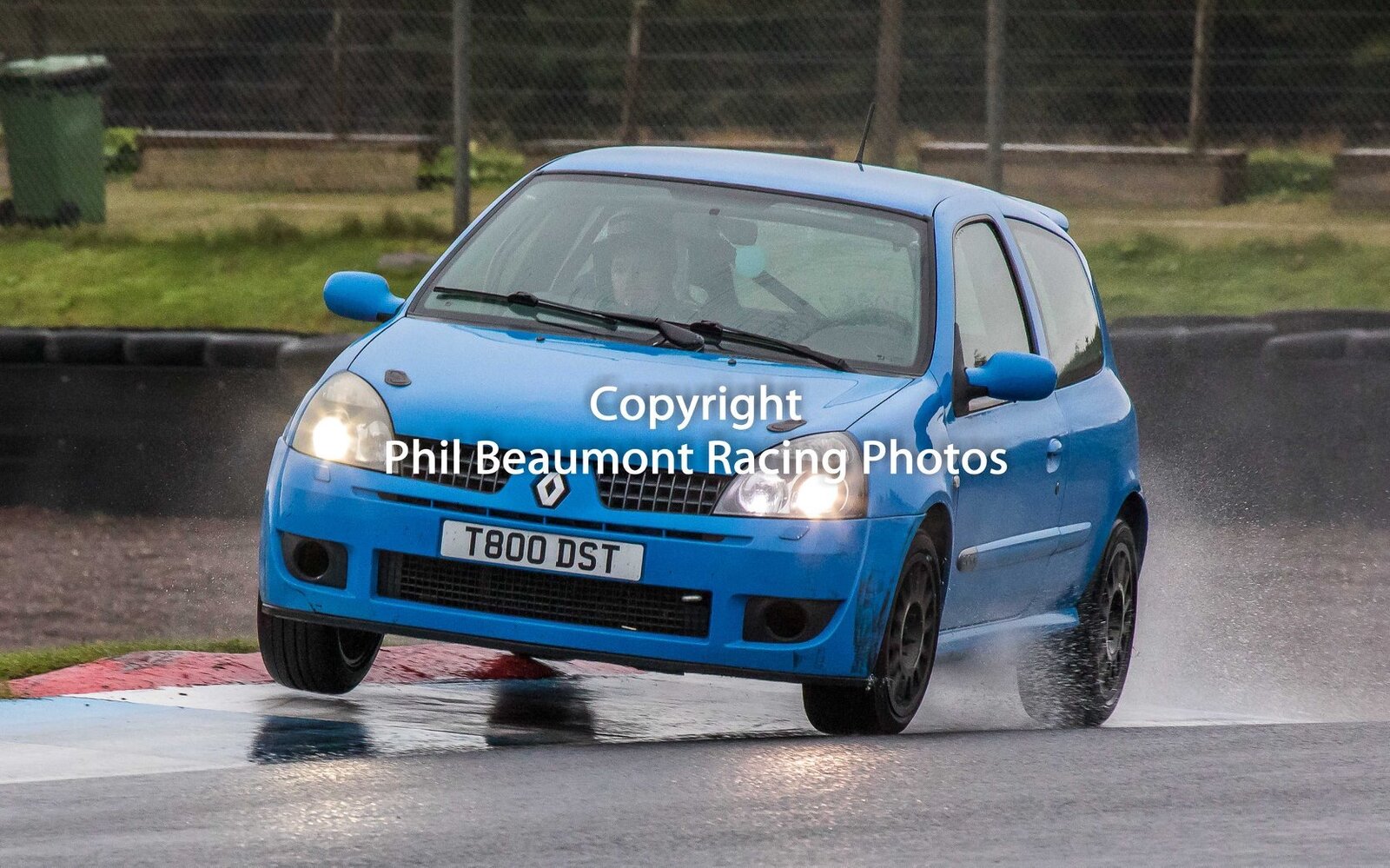

02/09/19 Normal direction - 1 hour OPL -wet
Weather conditions were pretty poor, unpacked in the pit garages to shelter from the rain. Staying on my road wheels and PS3’s was the only choice. I really enjoy a wet day, I’ve a lot of confidence in the car in the damp conditions. So managed to go out and put in some great laps. Totalled up a nice 50 track miles in the hour.

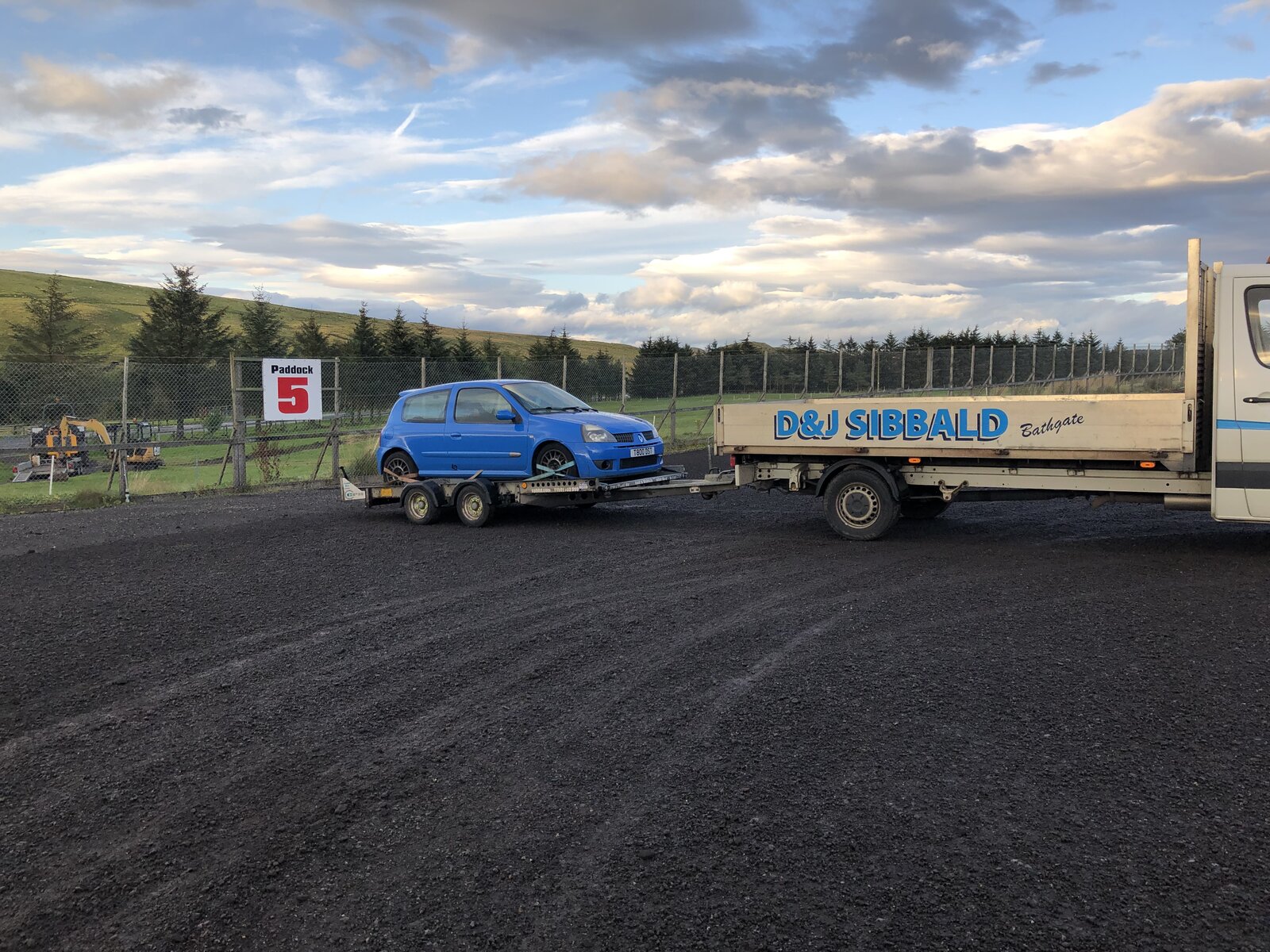

Broke hard at the hairpin and down into second, bang, instant smell of oil. Luckily I managed to dive straight into the pits. A quick look underneath confirmed that was my evening over.
Quickly alerted the marshals for the possibility of dropped oil, but luckily there wasn’t anything to be concerned about.
Looking back over the thread the box had started making noises at Donnington in 2018 so I’ve had fair warning to have it sorted. But it’s decided it’s had enough this time.
I’ve towed it back to my work and I’ll get a plan rolling for the next part of its evolution. 💙💙

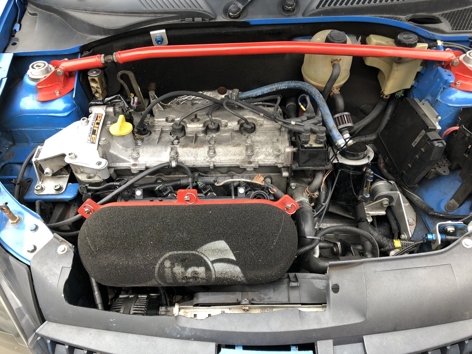

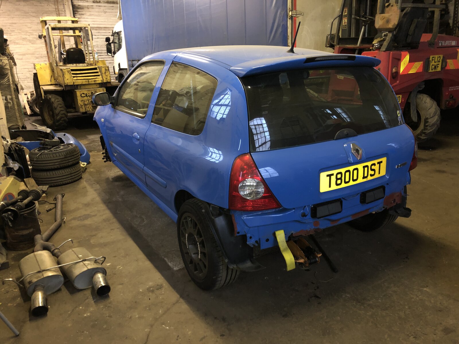

Been quietly working away in the background with this one. A well spec’d car came up for sale that was owned by a good friend of mines, I jumped at the chance and paid the asking price. I had bought this to purely to replace my RB as it’s a very well spec’d car with fairly low mileage.
Unfortunately after looking over a few of the issues it had I decided that I would be best off breaking it for spares - sell on a lot of the fancy bits with the hope to break even and keep some items.

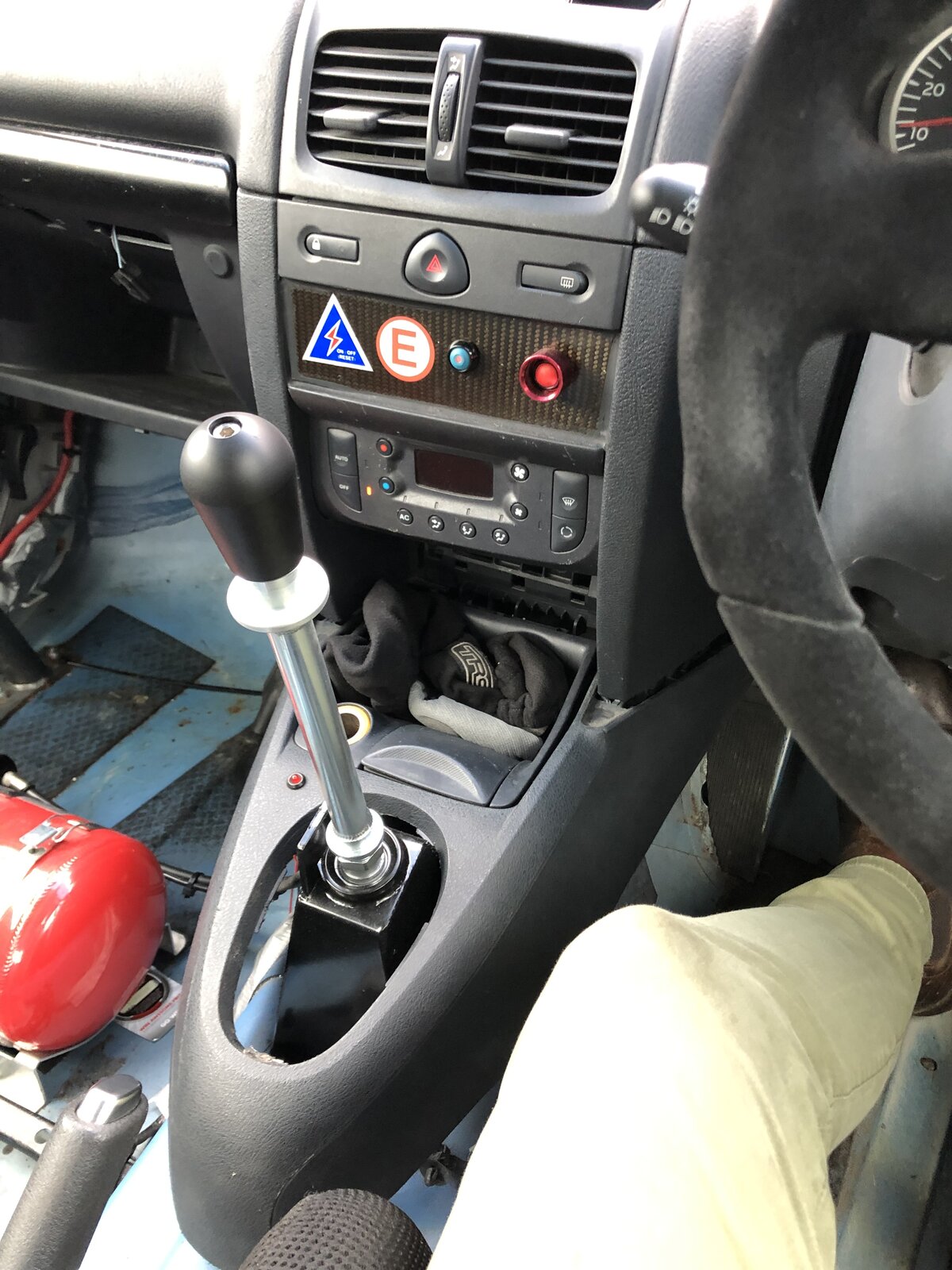

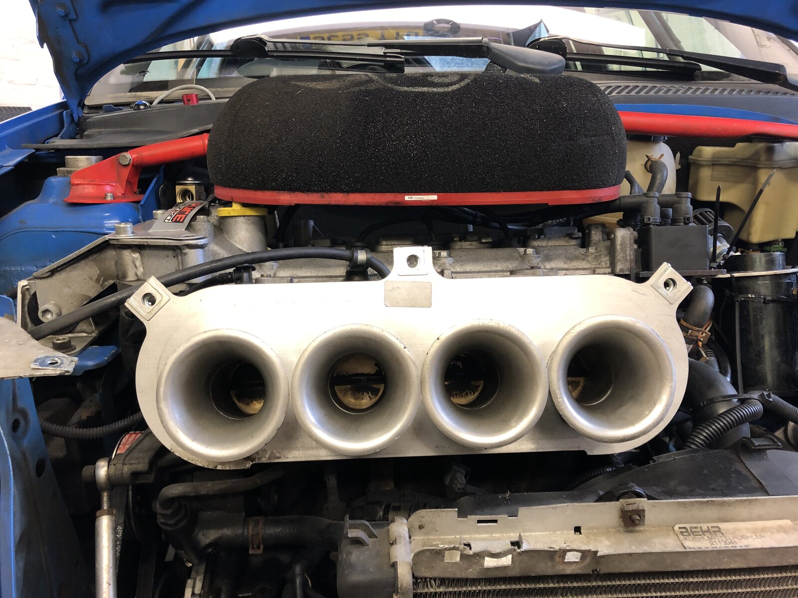

Items I’m keeping and transferring over to my shell will be: Battery & cage : ITB’s & Gen90 : Engine : PMS shifter : few other shiny bits as well.
The car has been stripped and the shell is now in a trailer at my work out of the way for the time being. I’m unsure as to what I’ll end up doing with this spare.
I’m hoping to get cracked on over the next month or so to have the engine and gearbox all swapped over at a reasonable pace before the winter really sets in.

If you end up breaking it I might be interested in the rear bumper and a wing if they're in good condition. The radiator too
It's already broken into its component parts. The rear bumper had a rain light and the front bumper was ripped off on track.
I might have a really tidy rear bumper for sale soon.

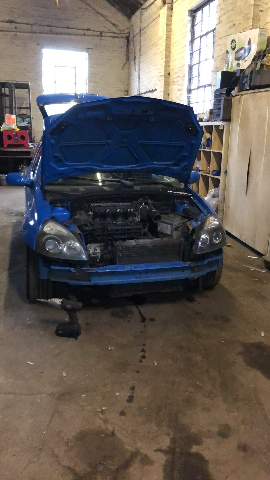

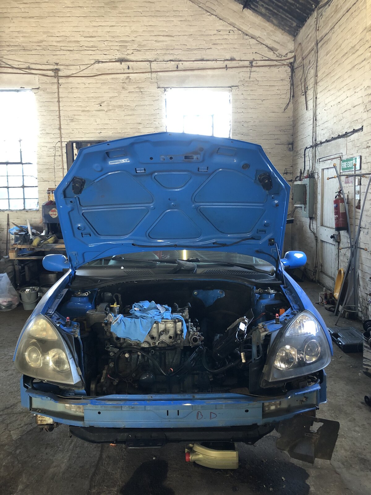

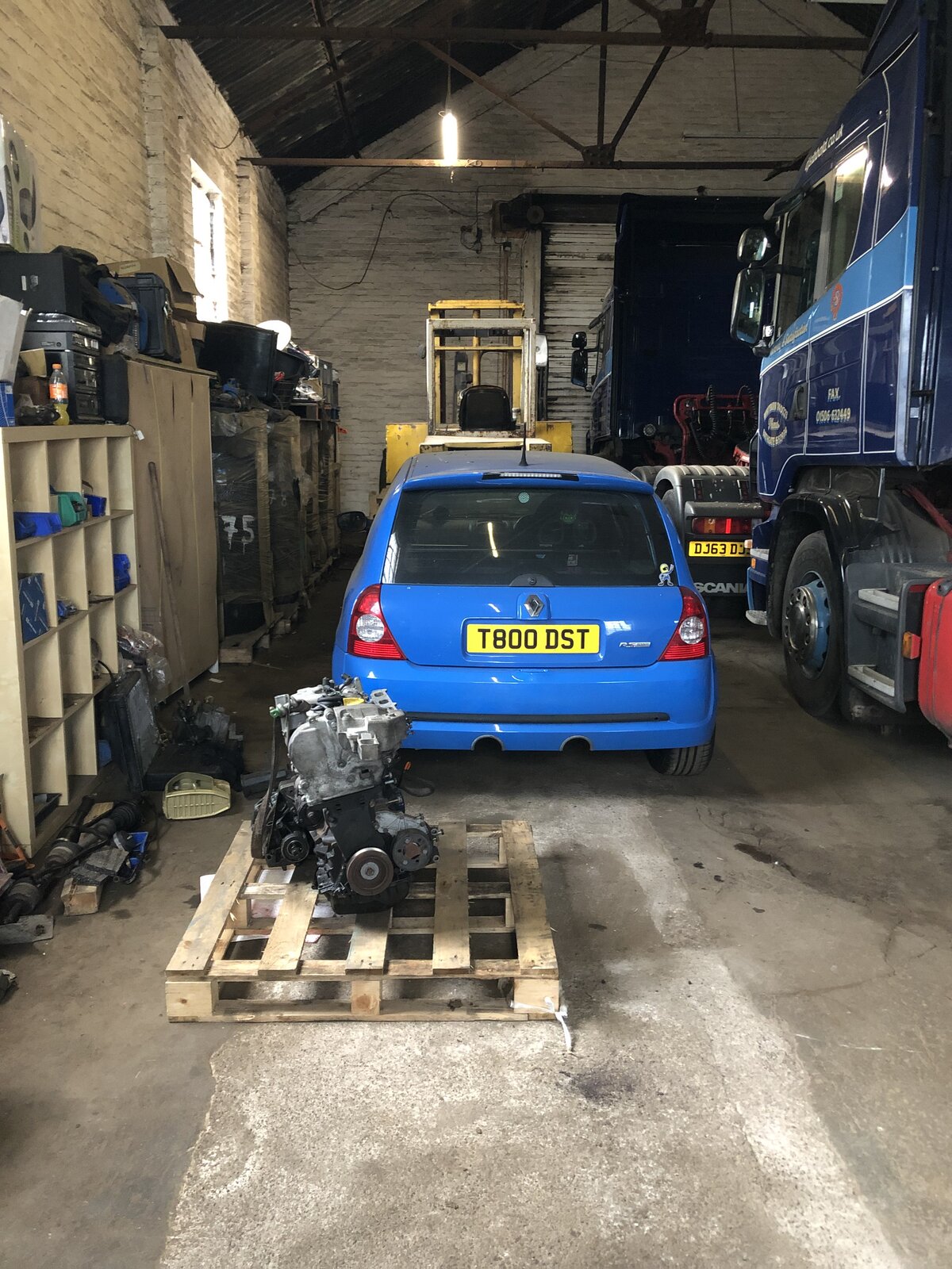

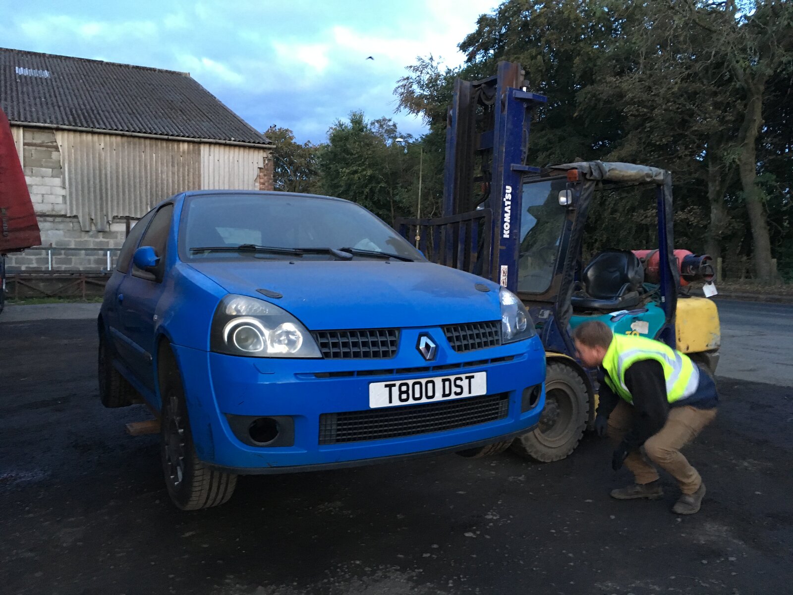

Been steadily pottering away on the car every other evening after work, an hour here and there. Got it all stripped down to get started on the engine and gearbox swap.
There’s a couple of areas of rust underneath the car that’s a bit of a concern so I’m hoping to address these before I stick the new engine and box in.
Thanks @djwjohn for coming over and helping lift everything out the bay. It’s much nicer doing things on cars before the snow falls I have to say.

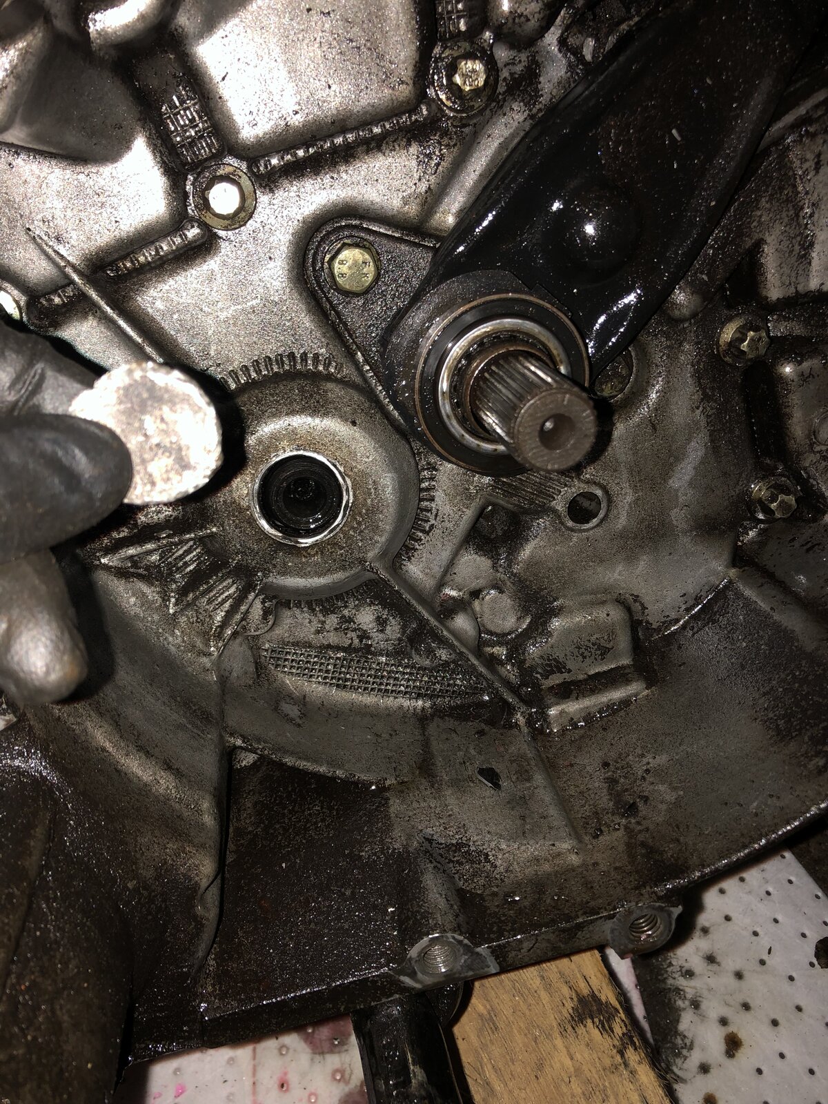

Spare few hours after work this week saw me splitting the box to check the hole (out of interest tbh). Haven’t seen one fail there before. It’s done well for the abuse it’s had in this car and in Johns flamer over the years. @NorthloopCup is this a common issue?

Yeah see mainshaft bearing failures all the time now mate!

Its only whined for the last 15 months or so.
That came out the flamer at about 120k so I would guess its done 135k, 20 odd trackdays and quite a lot of drag racing. I'm disappointed the hole is so small!

mines whined in first gear since I bought it 7 years 100k and 2 trackdays ago, flol!

They start to whine as first gear rubs on the crownwheel. They then just become a ticking time bomb. I’d imagine it’ll need a new mainshaft looking at the damage there mate.
It whined in most gears for a while, unsurprisingly the new oil i stuck in recently didn't help much. I've another box to throw in so ill stick this one in the scrap pile.

It's been a trooper of a box, cant argue at all. I really wanted a huge hole as well, not a £1 coin sized one. For the Insta innit.
