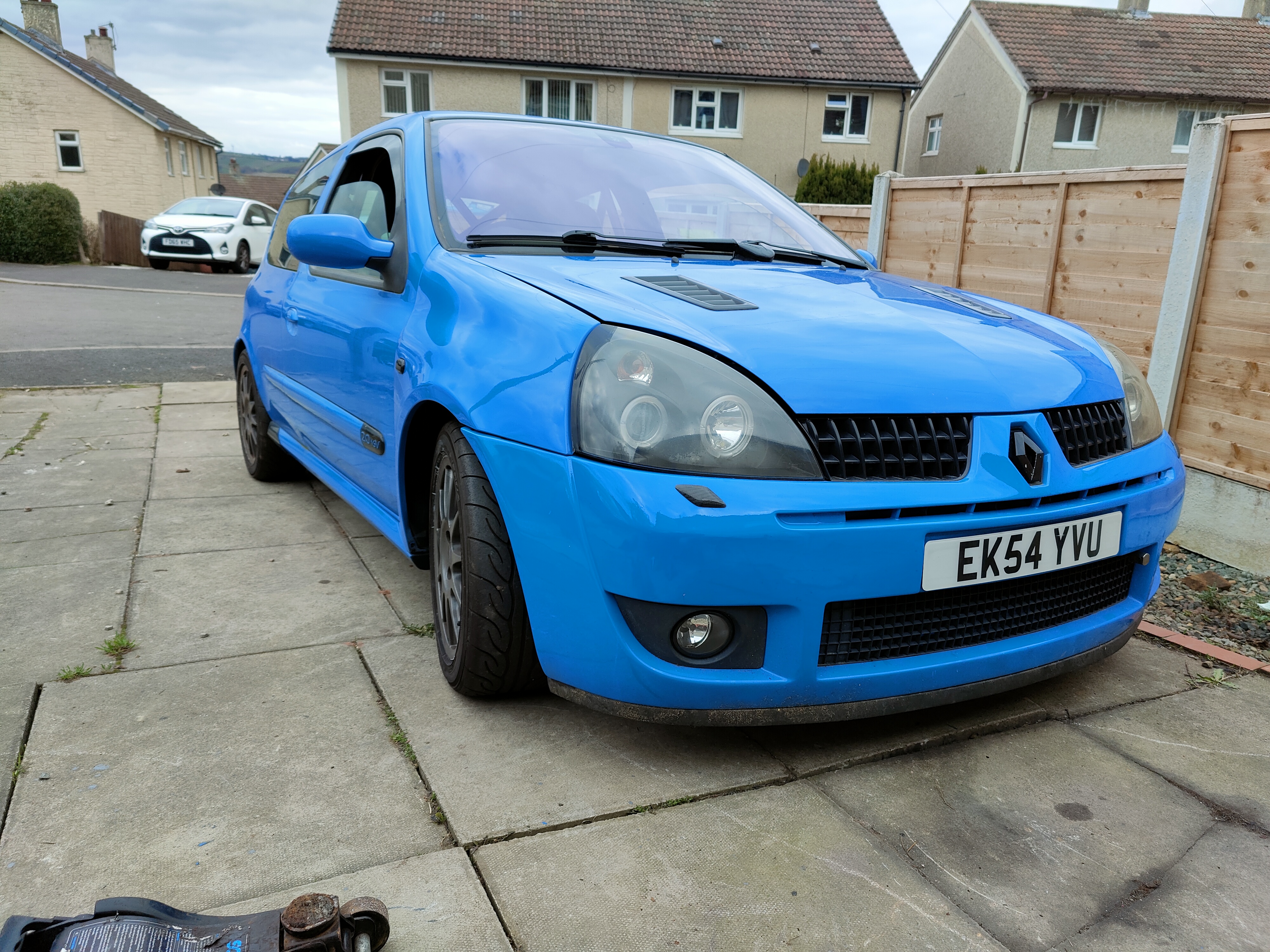

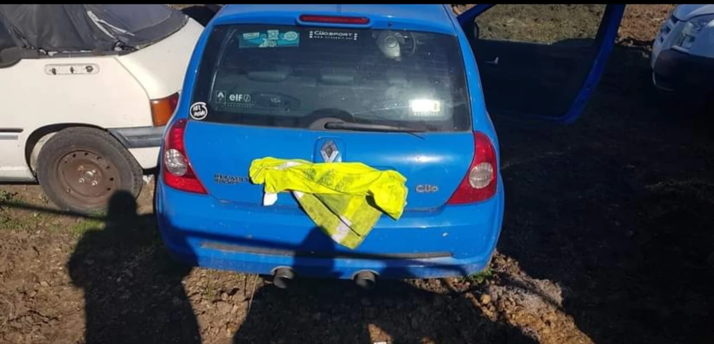

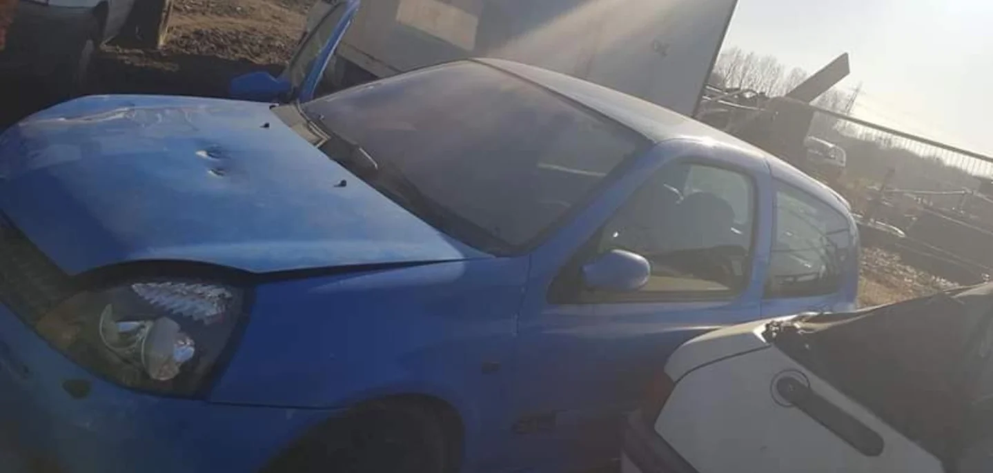

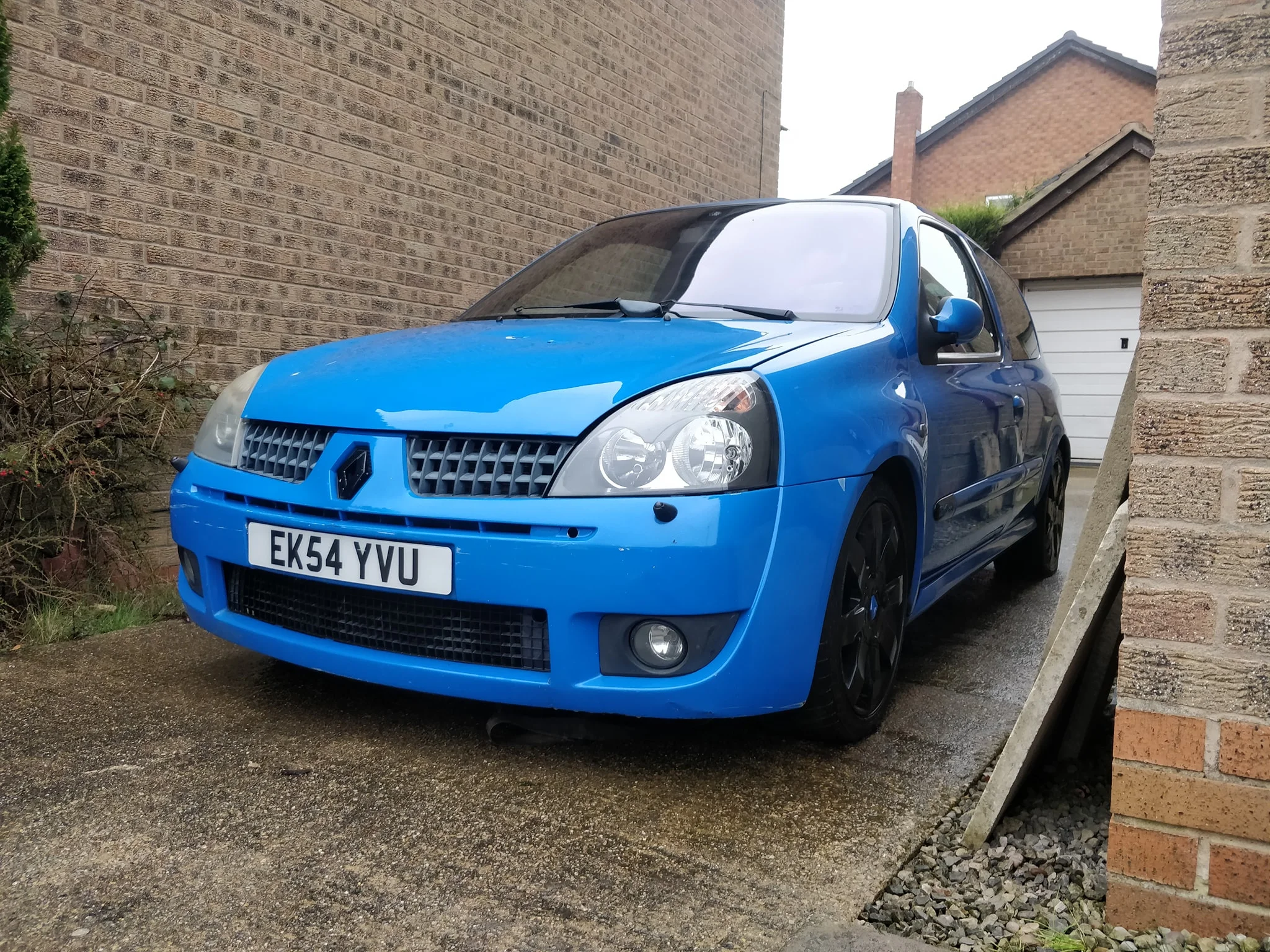

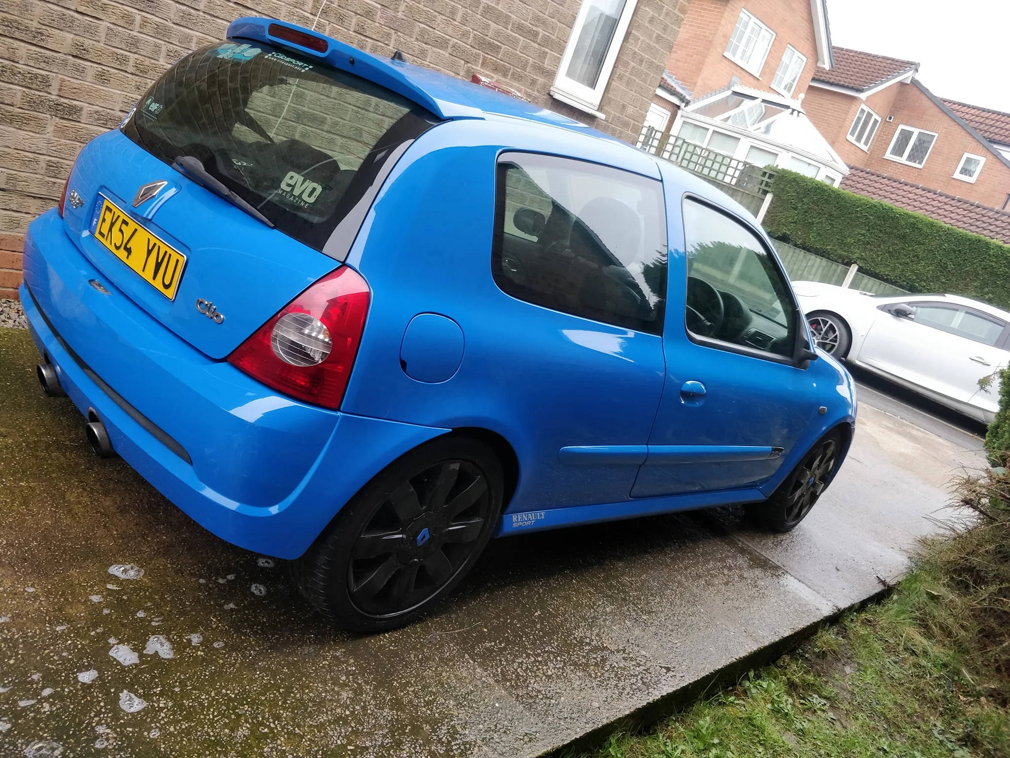

As you can see from the condition of the car, it had been sat for just over a year. I bought it blind, wasn't too sure what I was taking on but when it turned up I was very supprised. Seem to have struck abit of gold in my eyes! No outside visible rust arches were spotless and behind fuel cap also!
Had to get it washer up immediately! So I did.
I liked this angle, you couldn't see the dent on the bonnet 😁
I was very happy with how well it turned out.

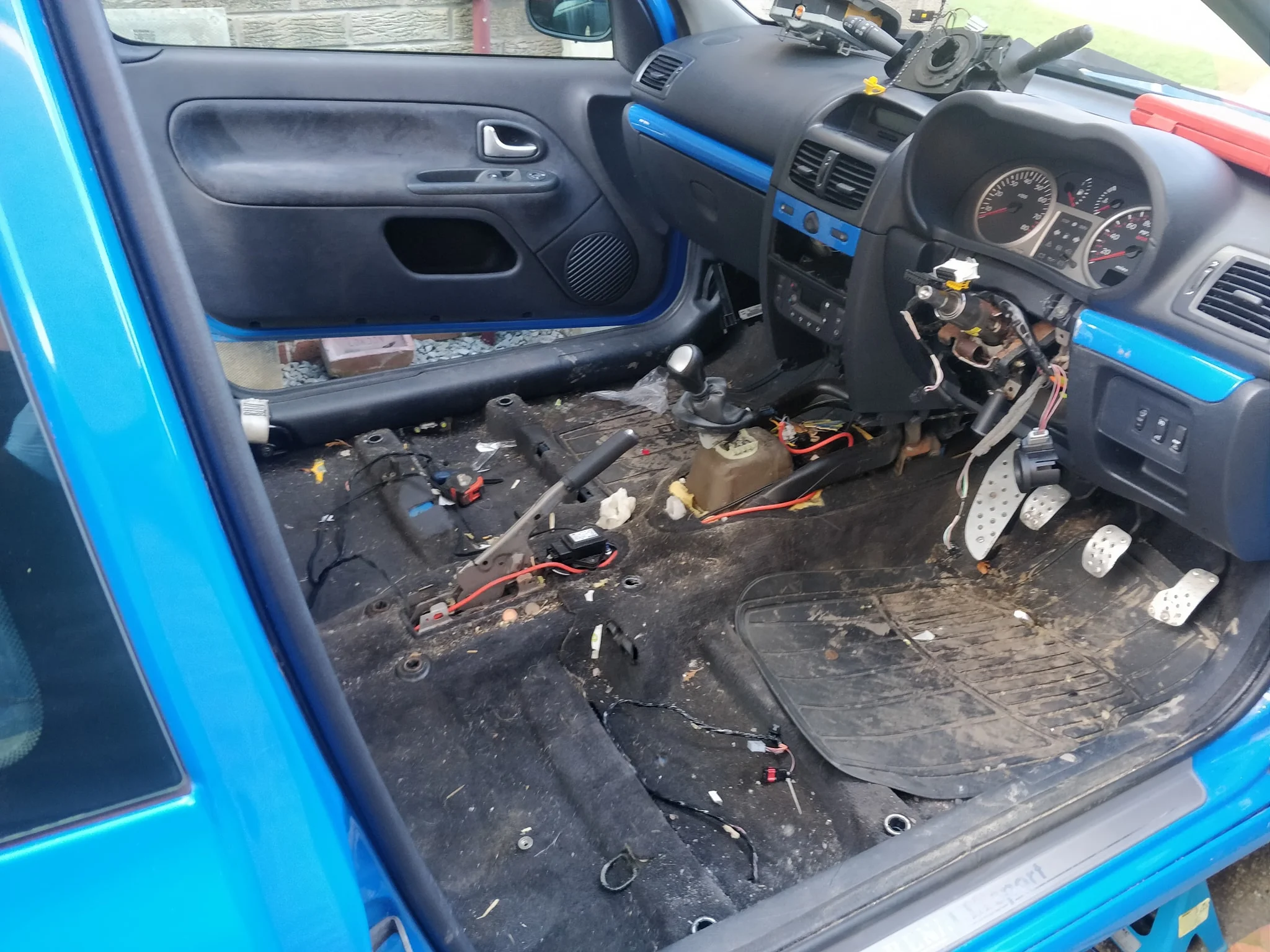

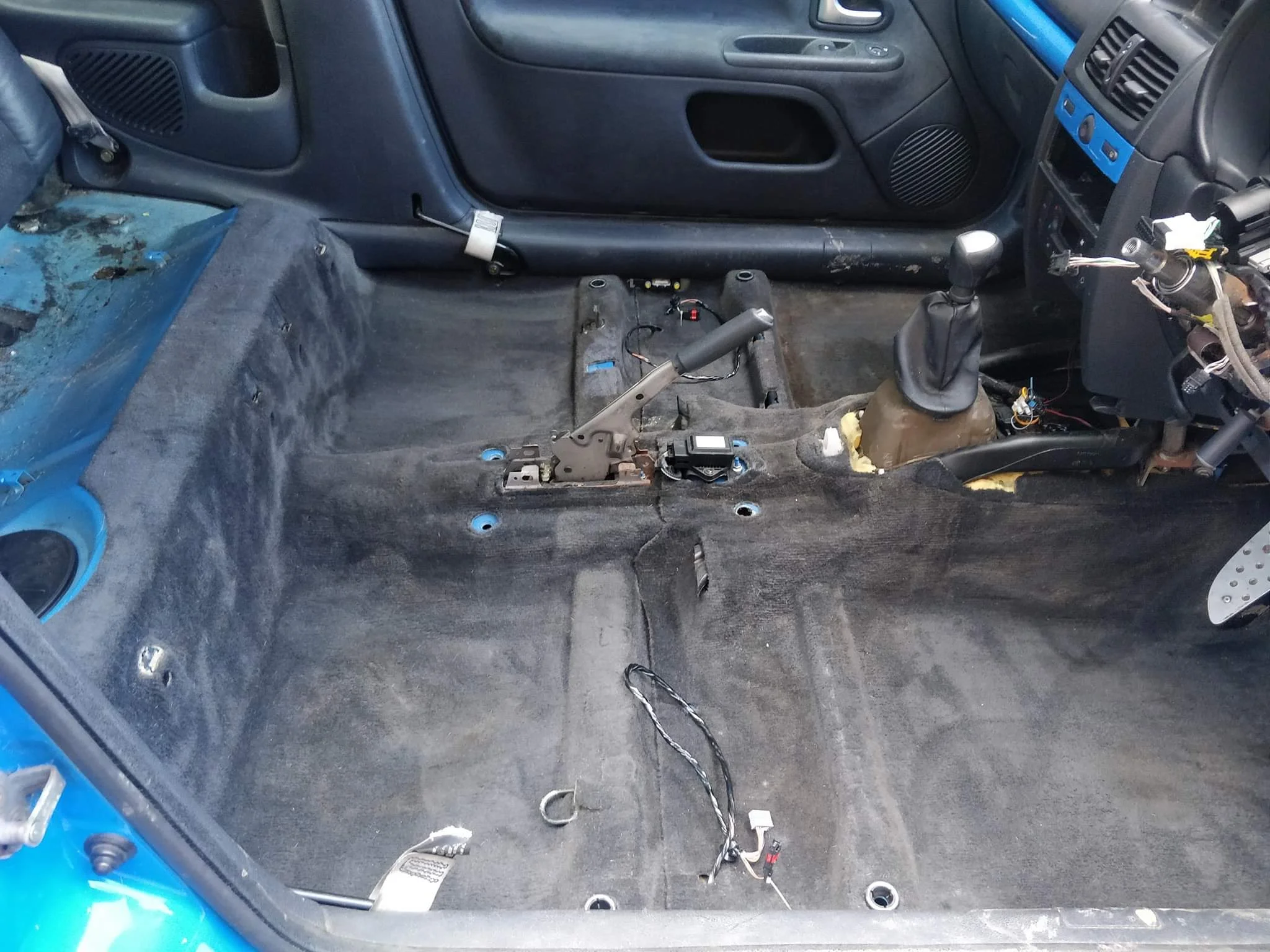

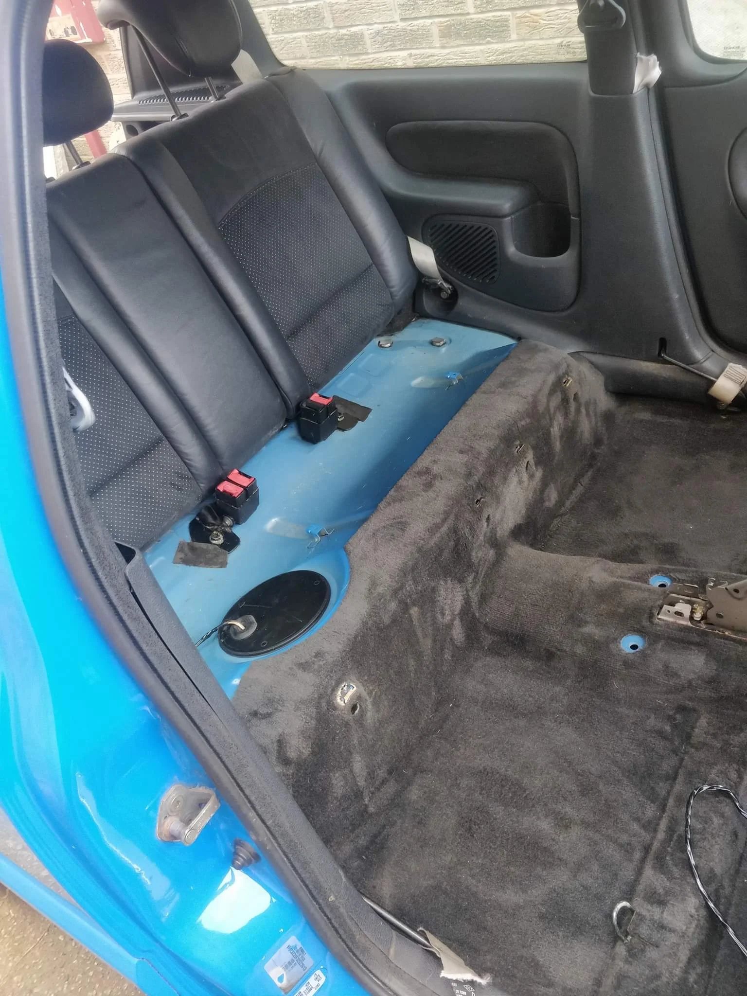

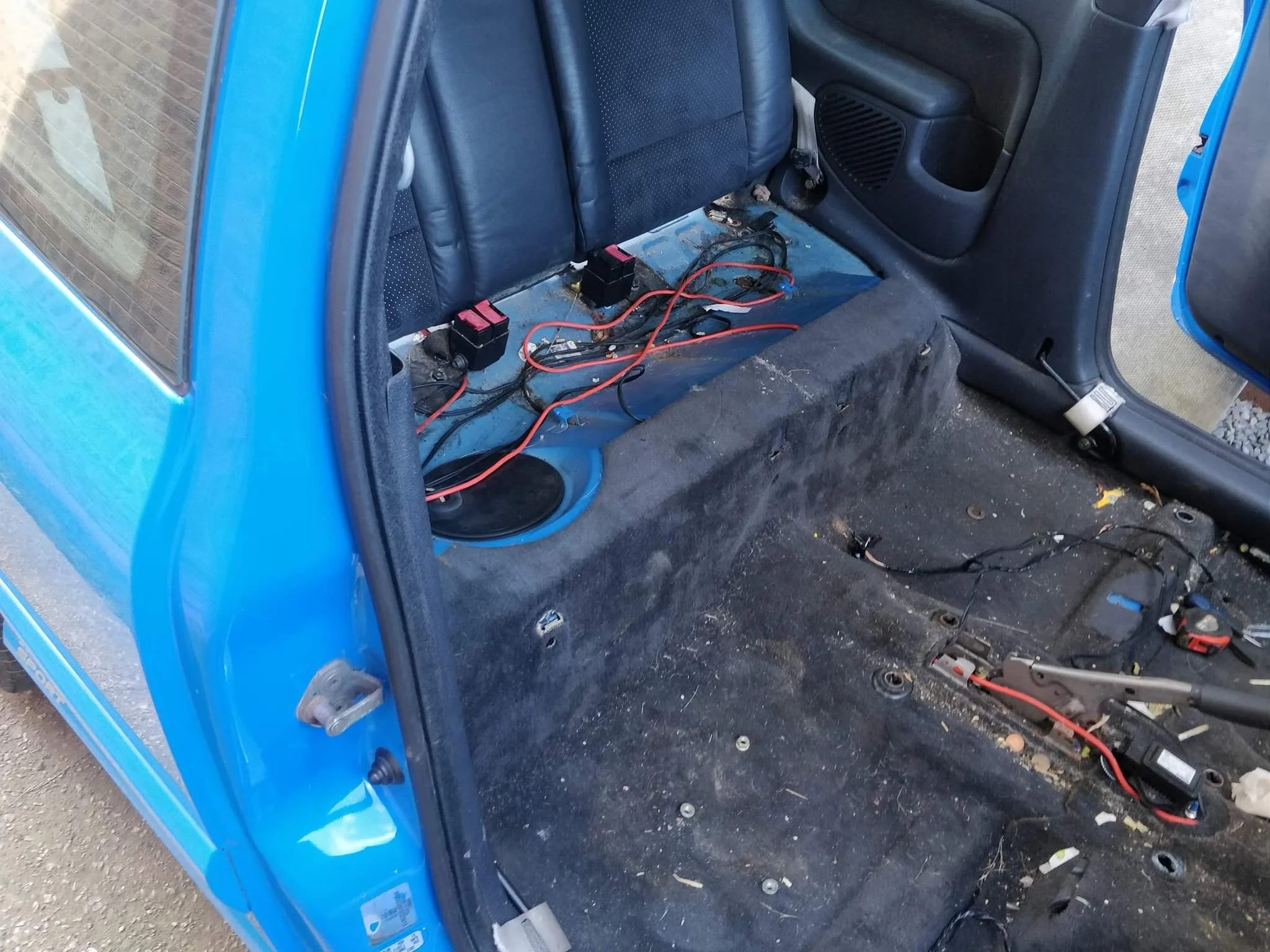

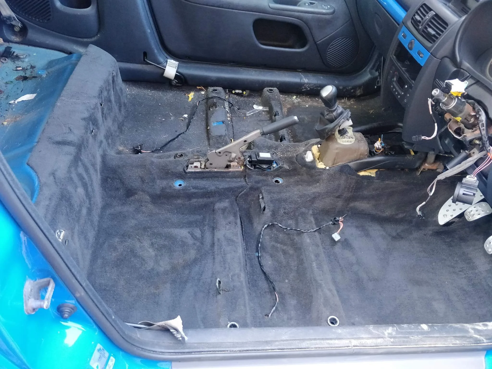

So Next I set upon cleaning the interior ;D

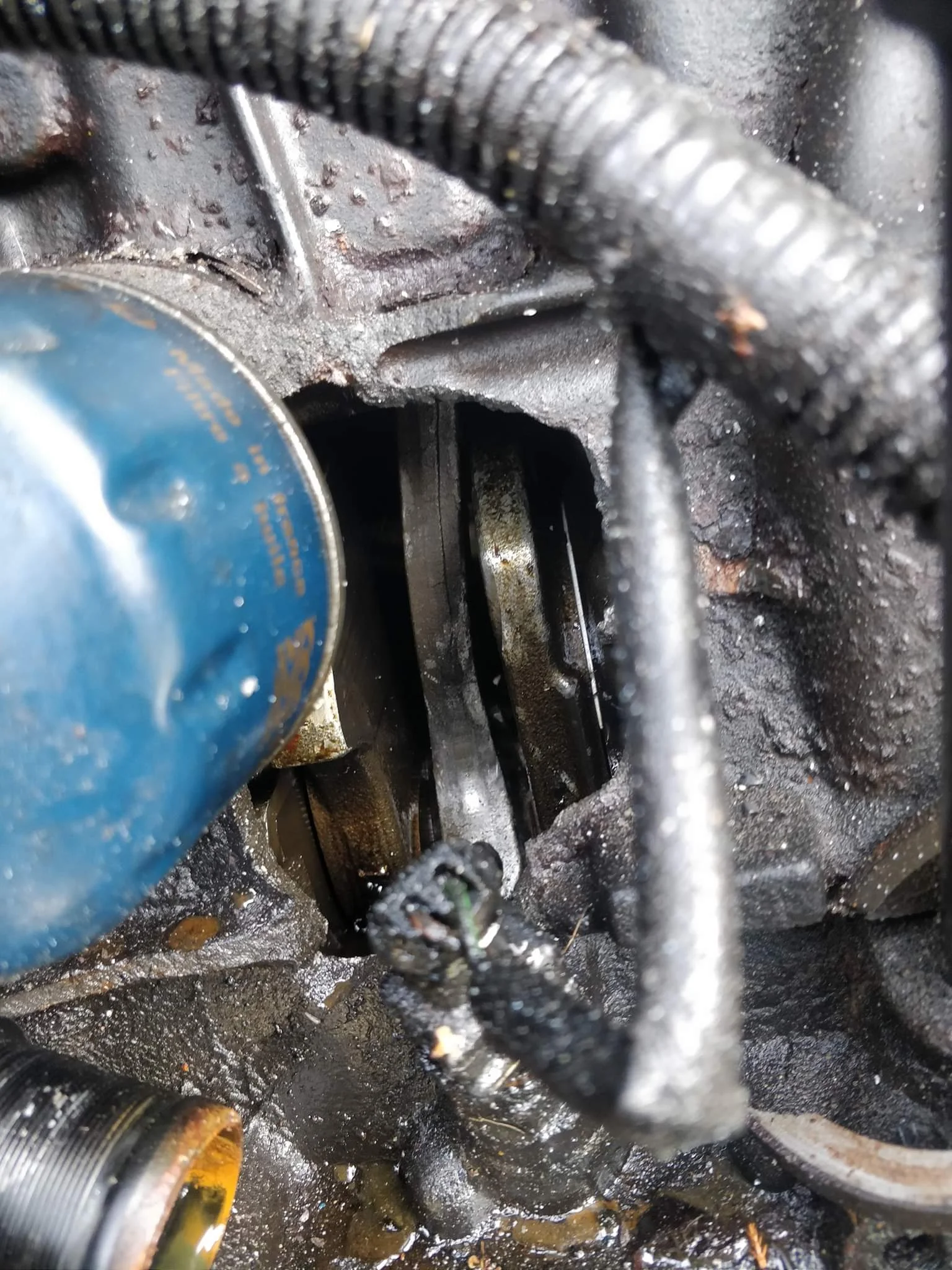

Looking good eh? Once all the interior was refitted I made a start on the engine and looking at the damage was clear, ill let the pictures do the talking...
Seems the piston didn't want to be part of the F4R any more.. this wasn't overly a huge problem at the time as luckily I had a spare engine to hand. You can say it all fell nicely for me.

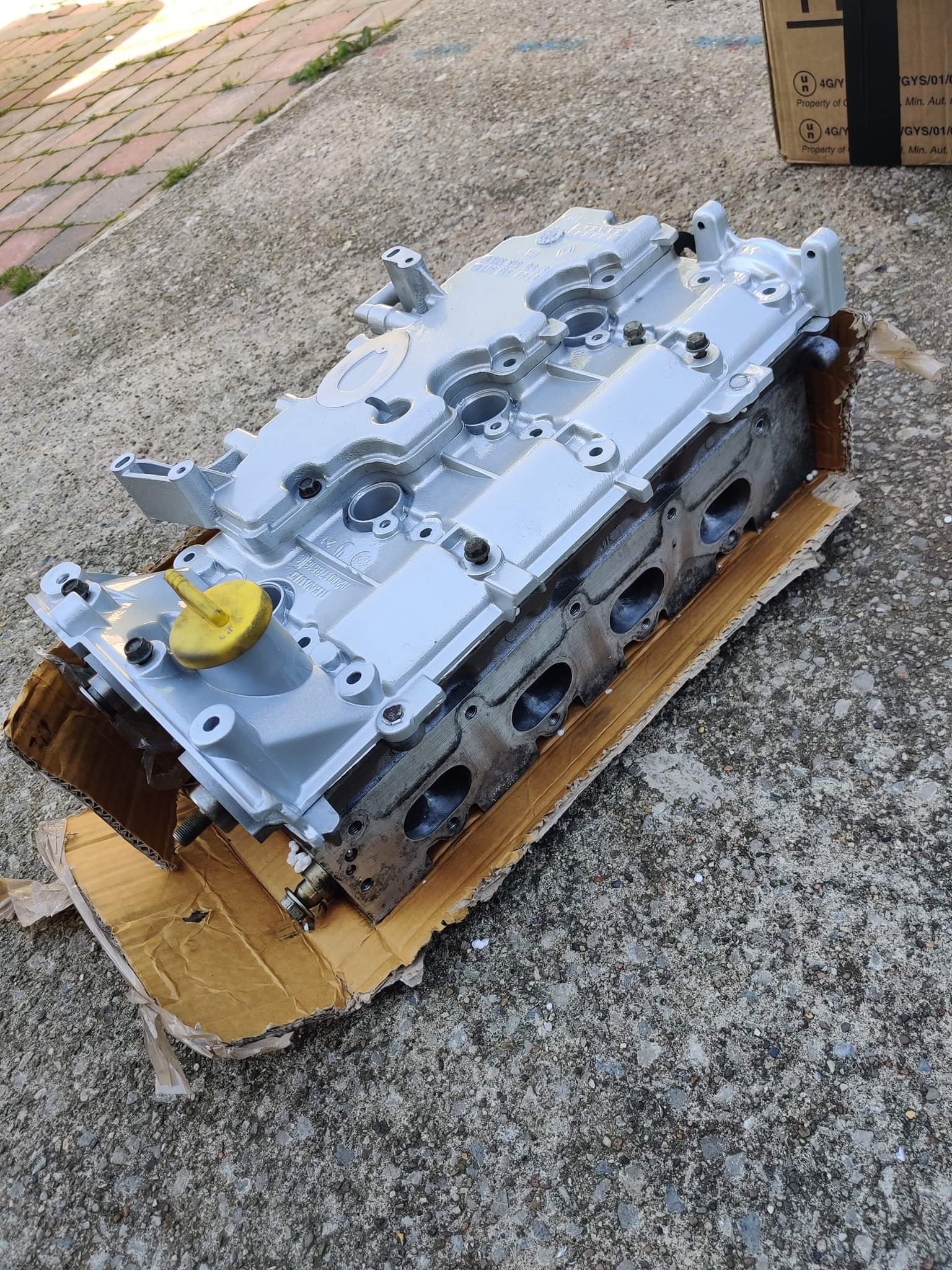

I wasn't sure on the condition of the JC5/130 but I did know they are alot stronger than the previous circlip type so I took the gamble.

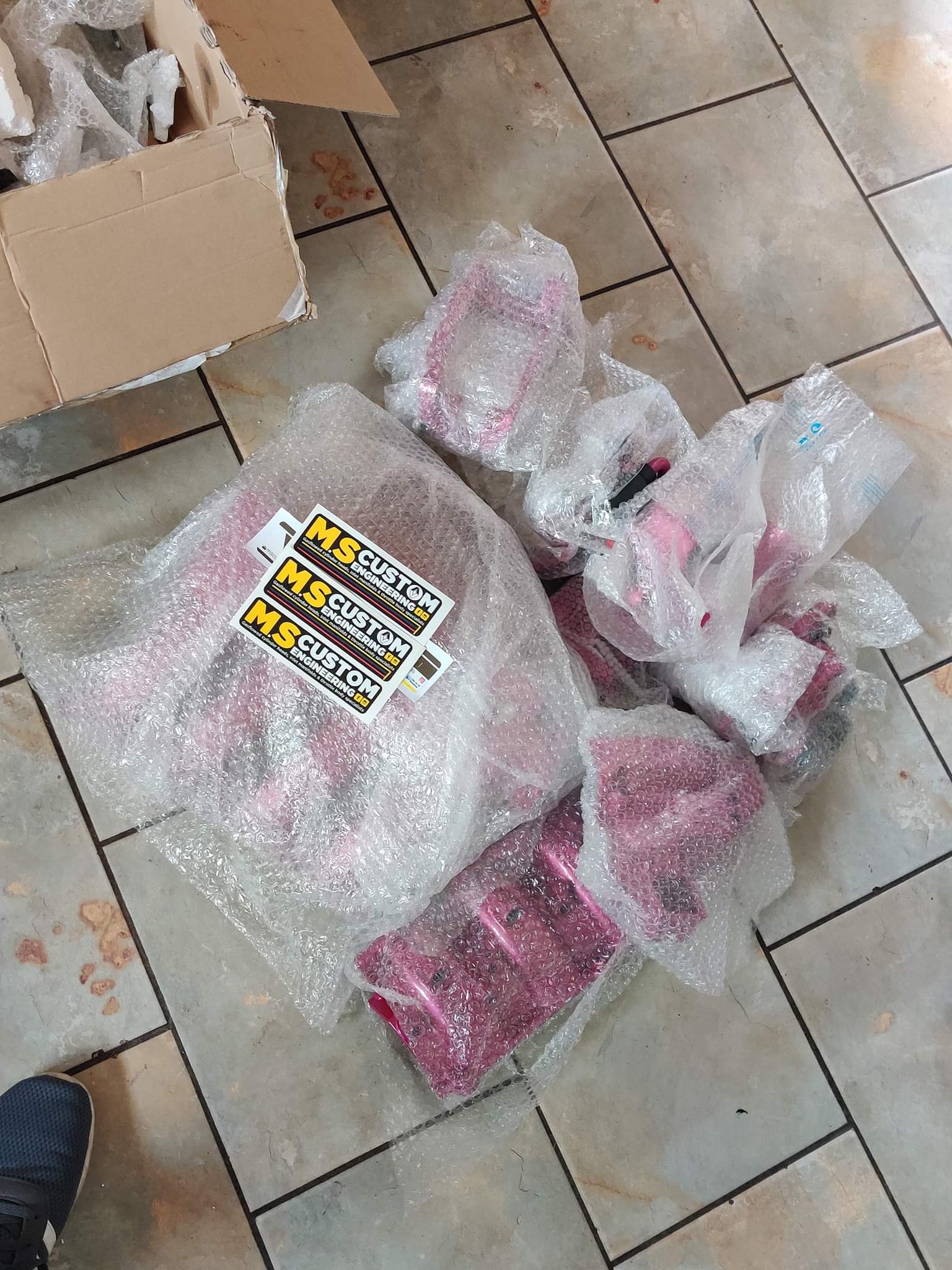

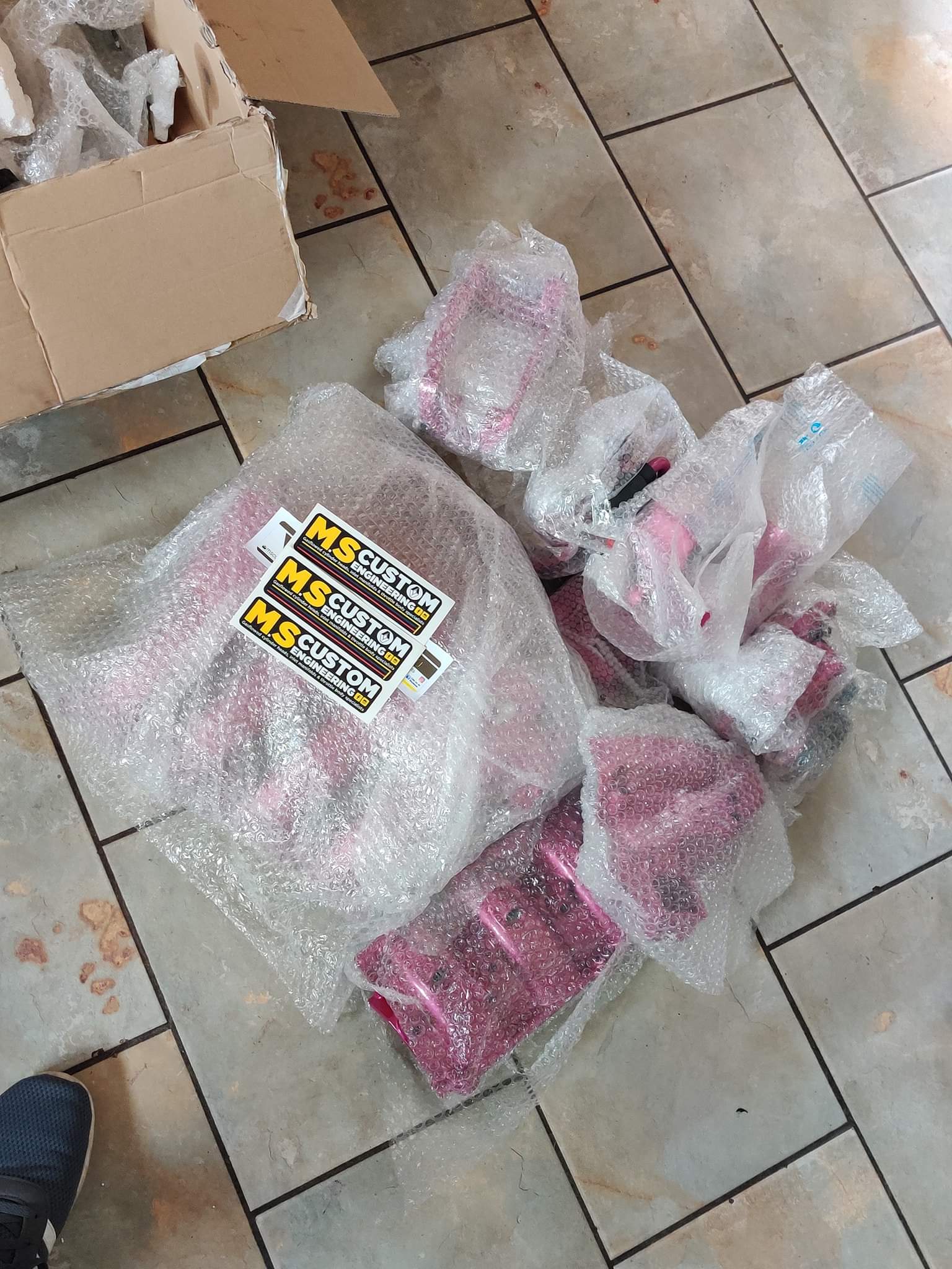

I then went and bought a ported head with some 197 camshafts, got some very nice inlets made up by m.s custom engineering, he also refurbed my brakes as you'll notice later in the post...
A few other bits popped up also when I wasnt looking but I couldn't help myself and had to buy, like this stunning Yozza system!

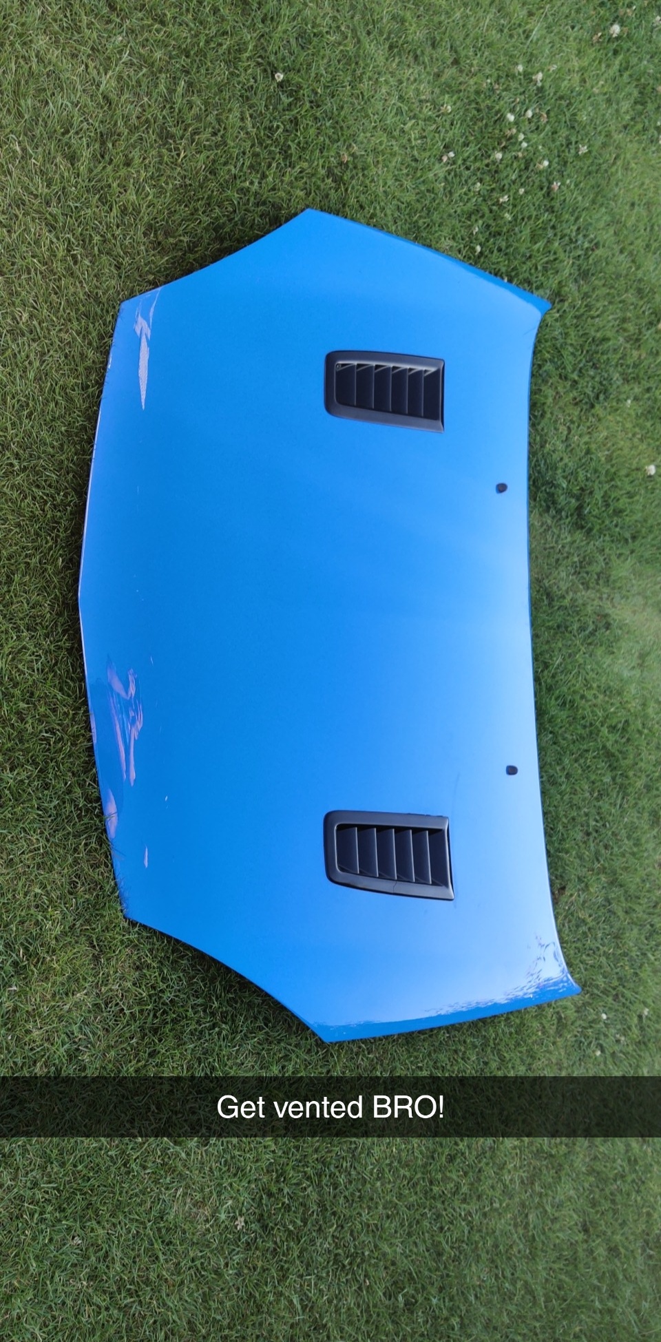

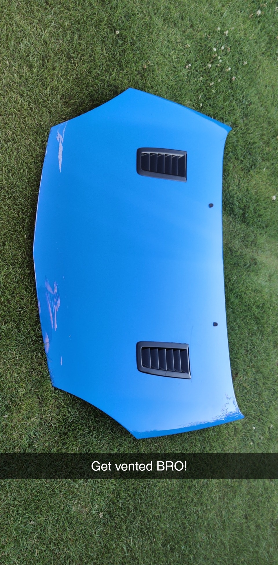

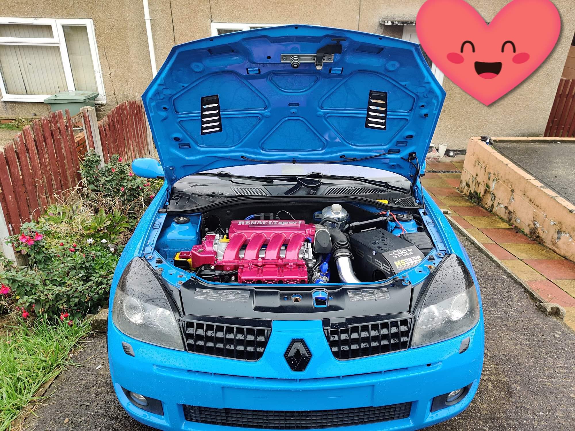

So I then saw another bonnet, I decided I'd change it up abit, to stand out more.
We did it, we got vented....

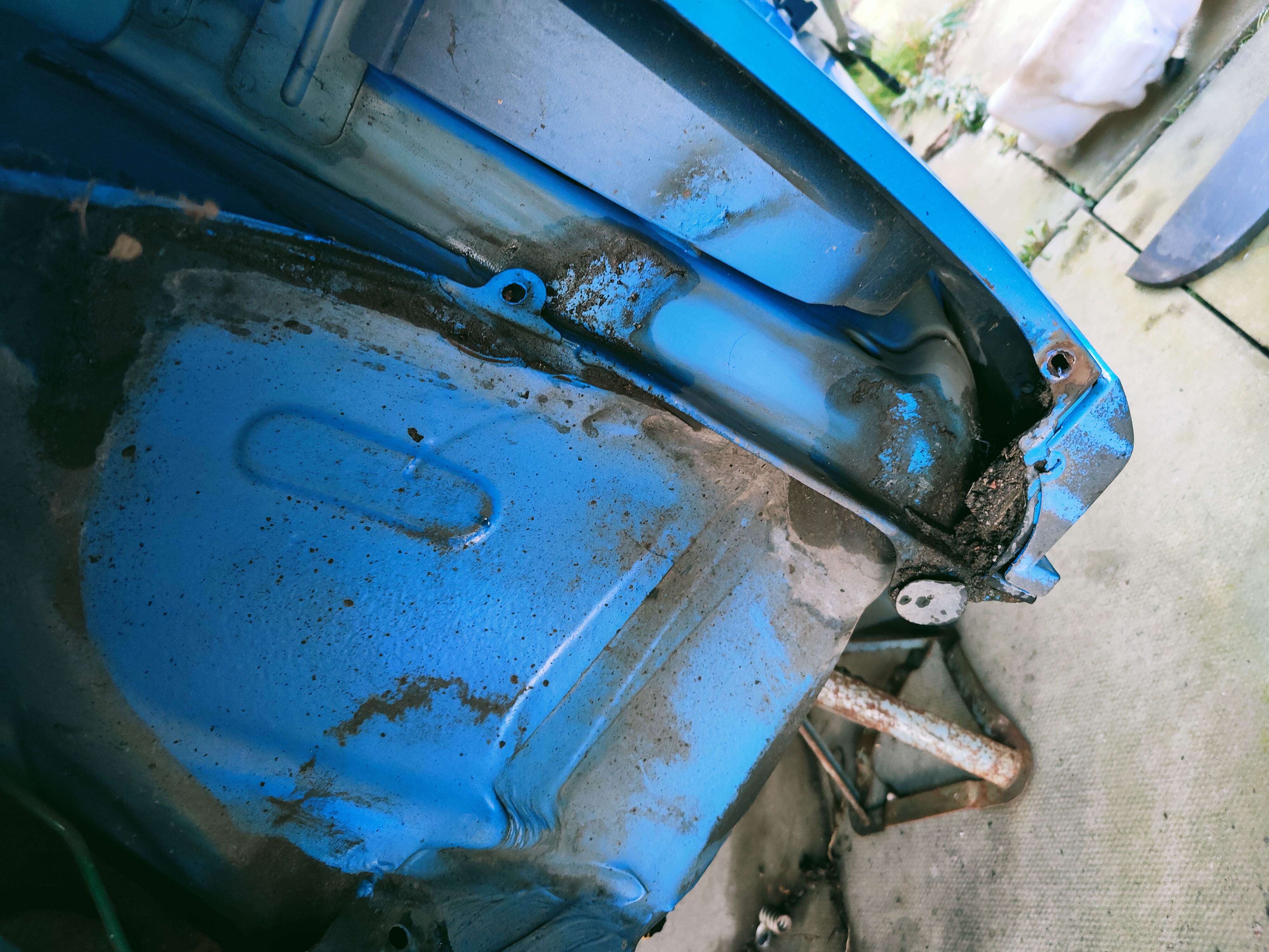

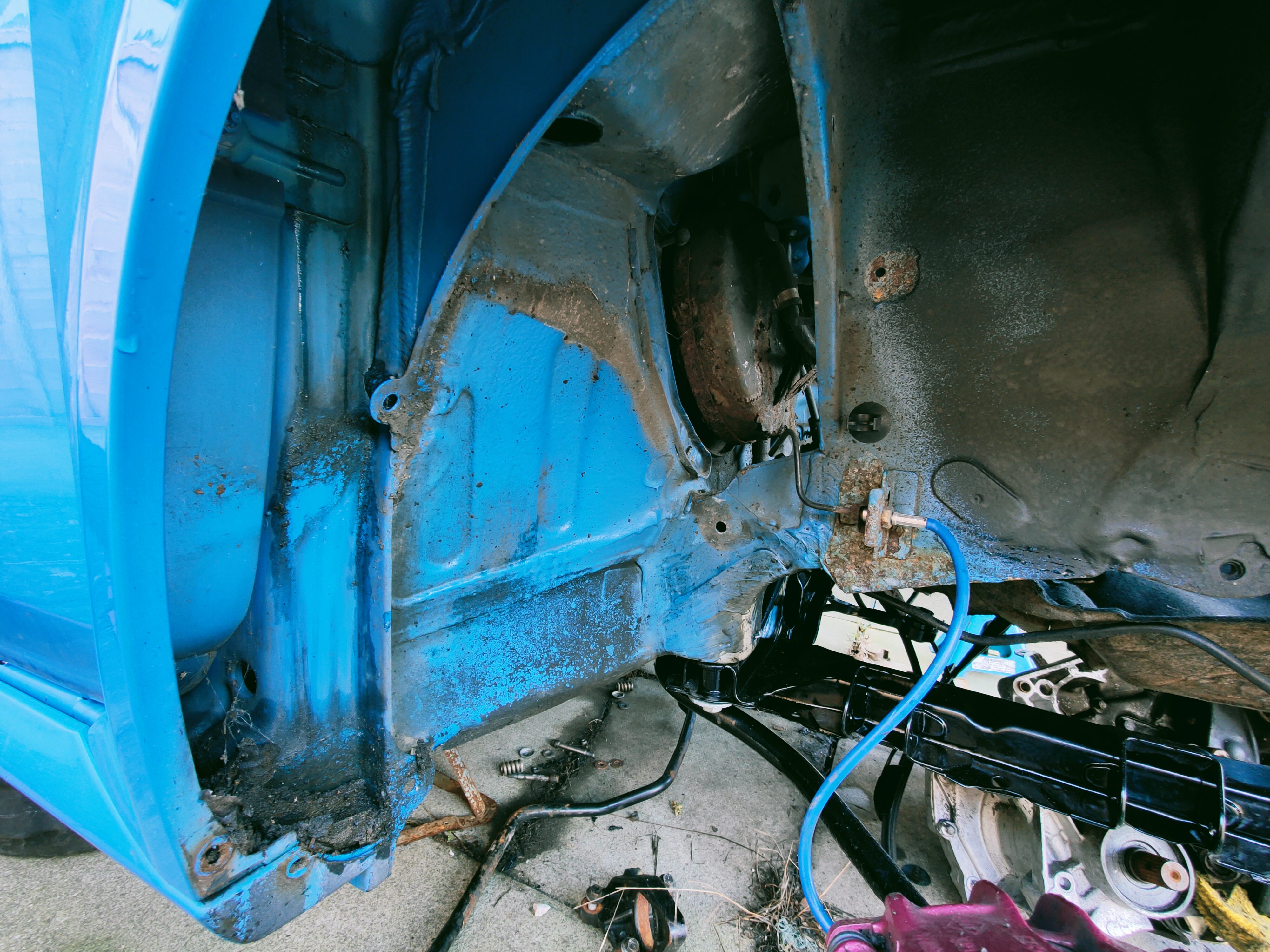

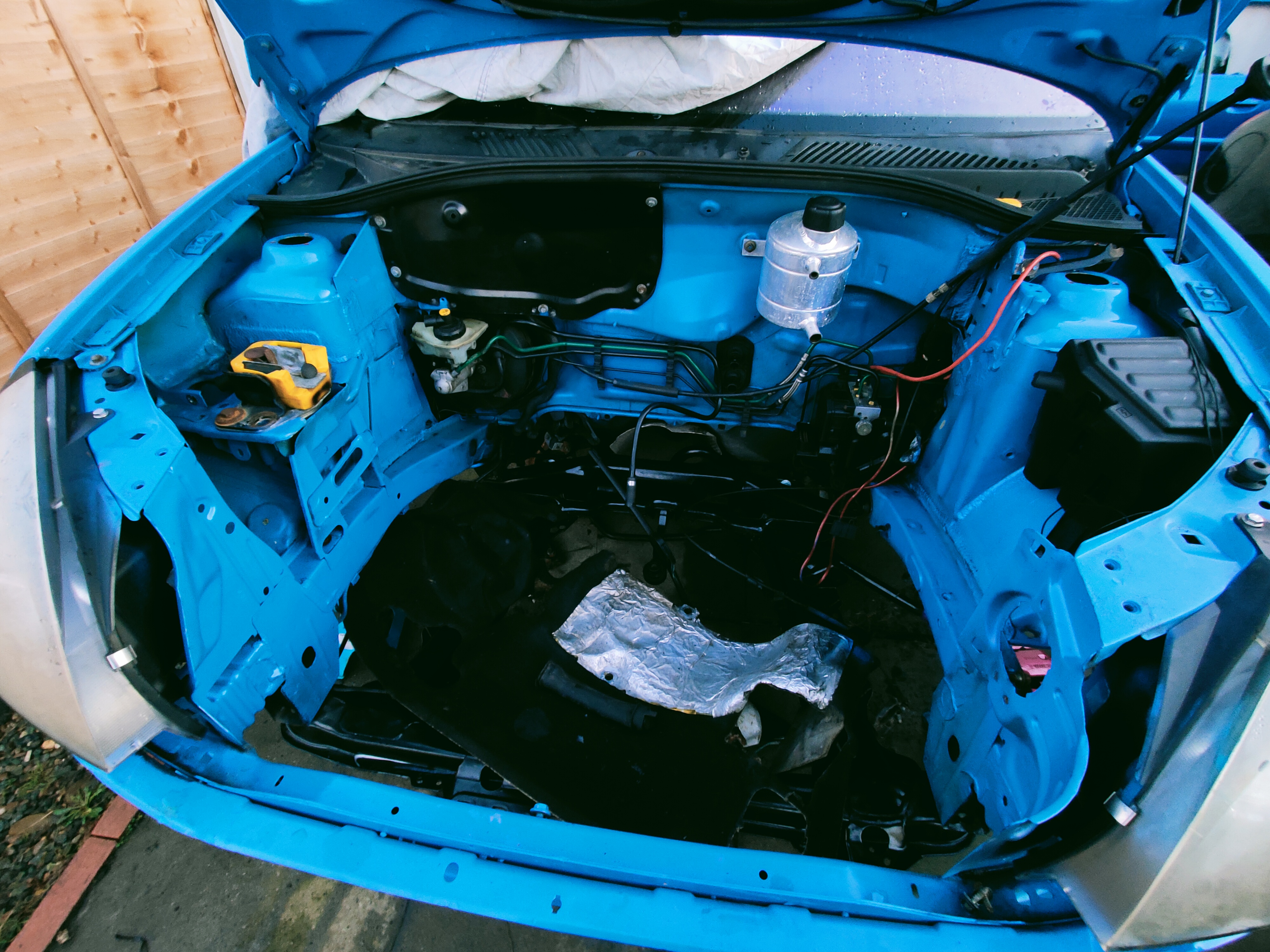

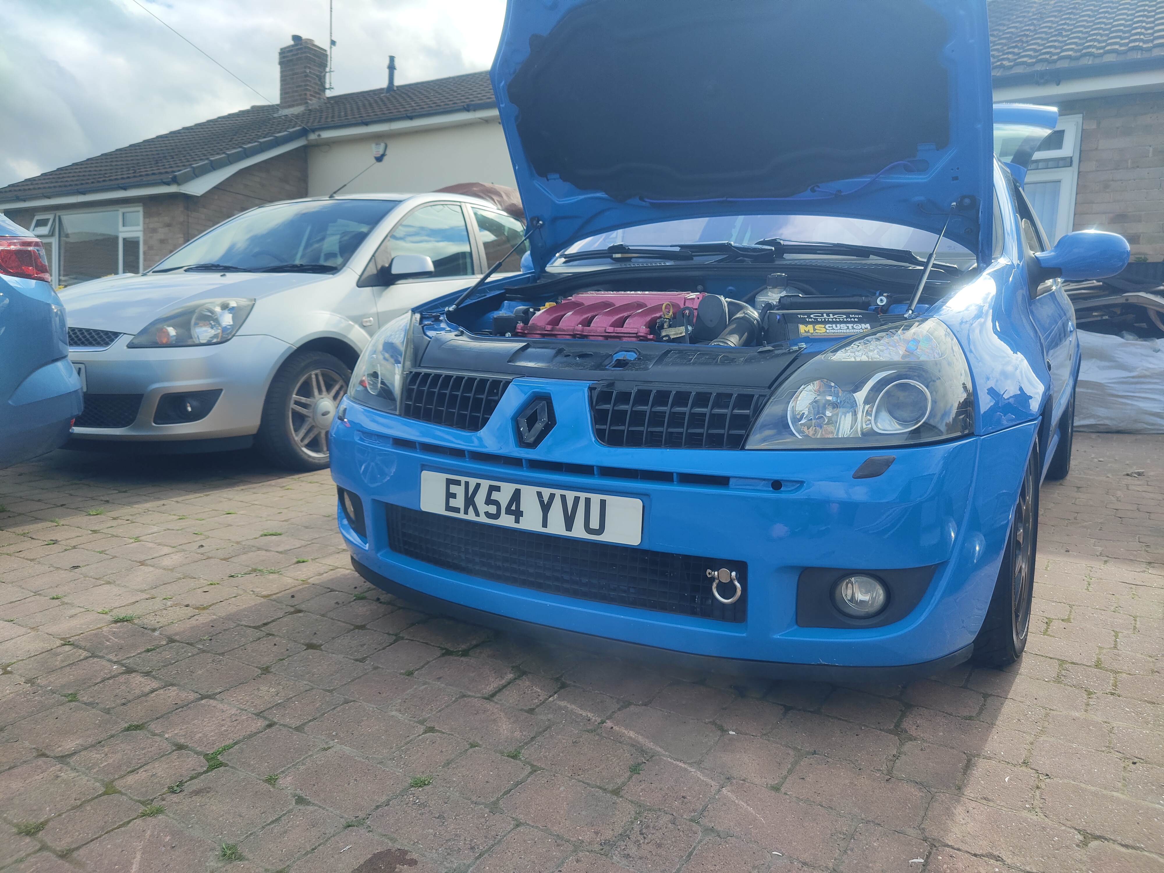

So this summer of 2020, pretty much stuck inside I decided I wanted to fully rebuilt the front end. Full subframe got all the blasted and powder coated,

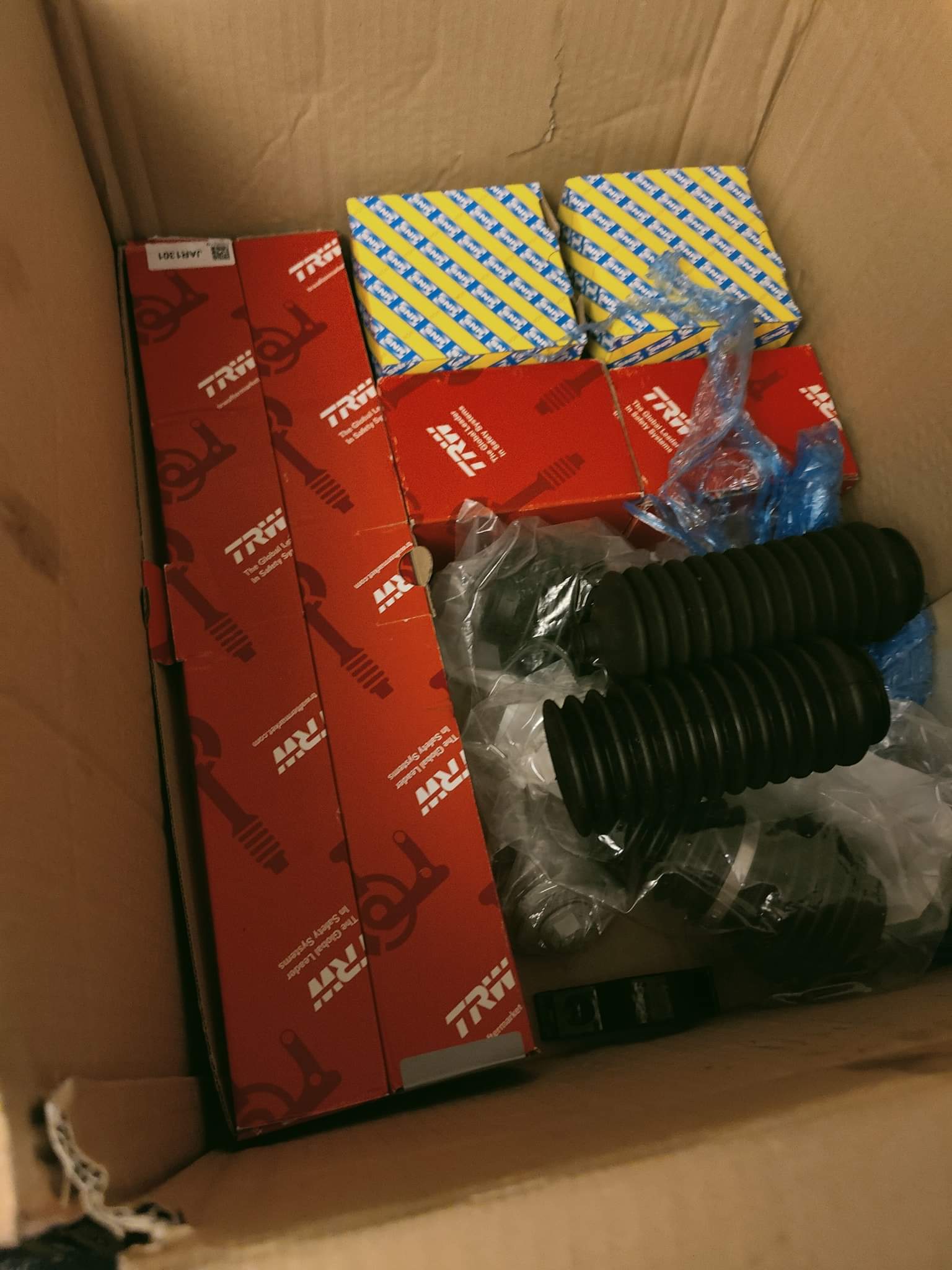

New wishbones with powerflex bushes all round,
New ball joints,

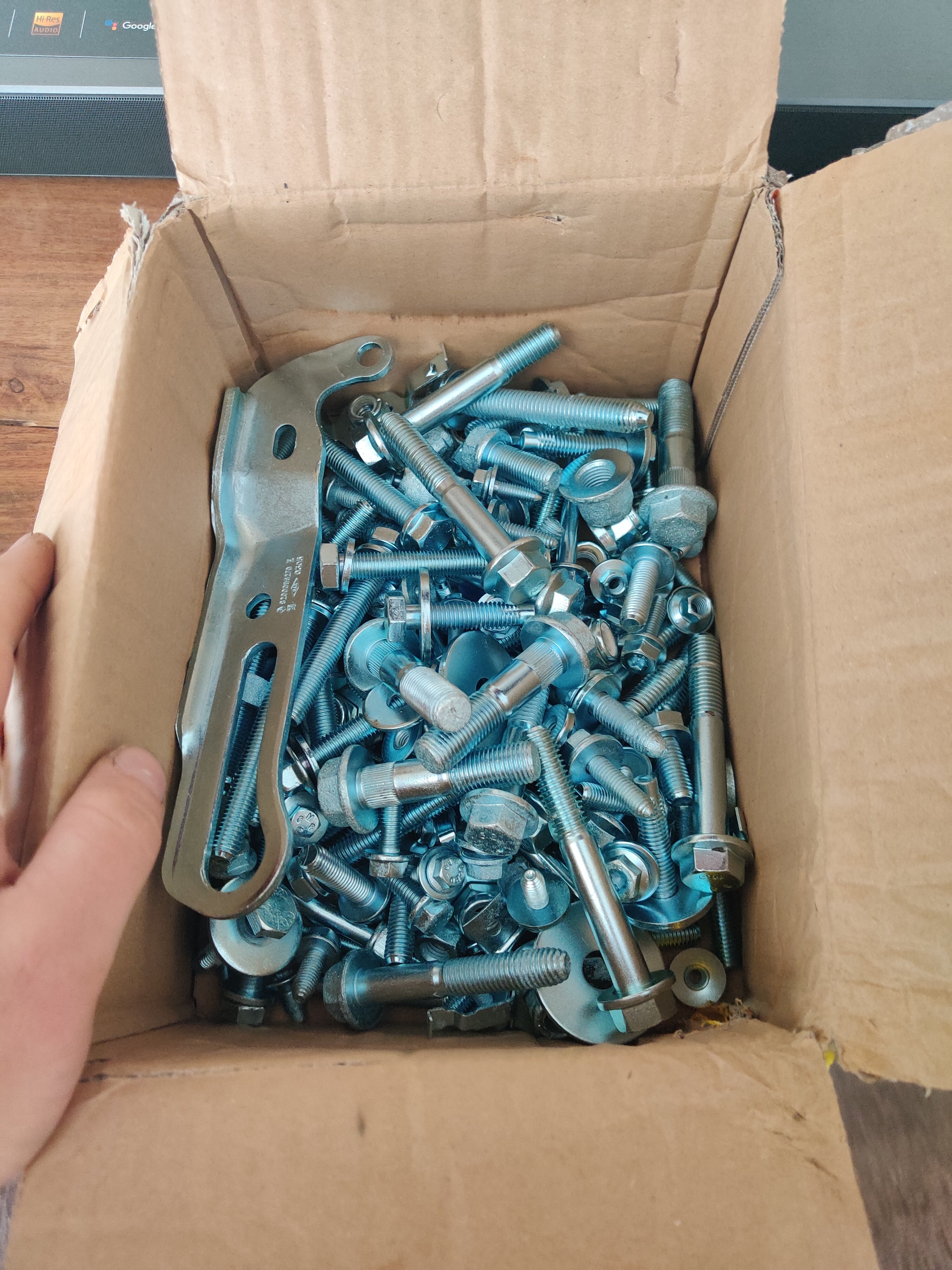

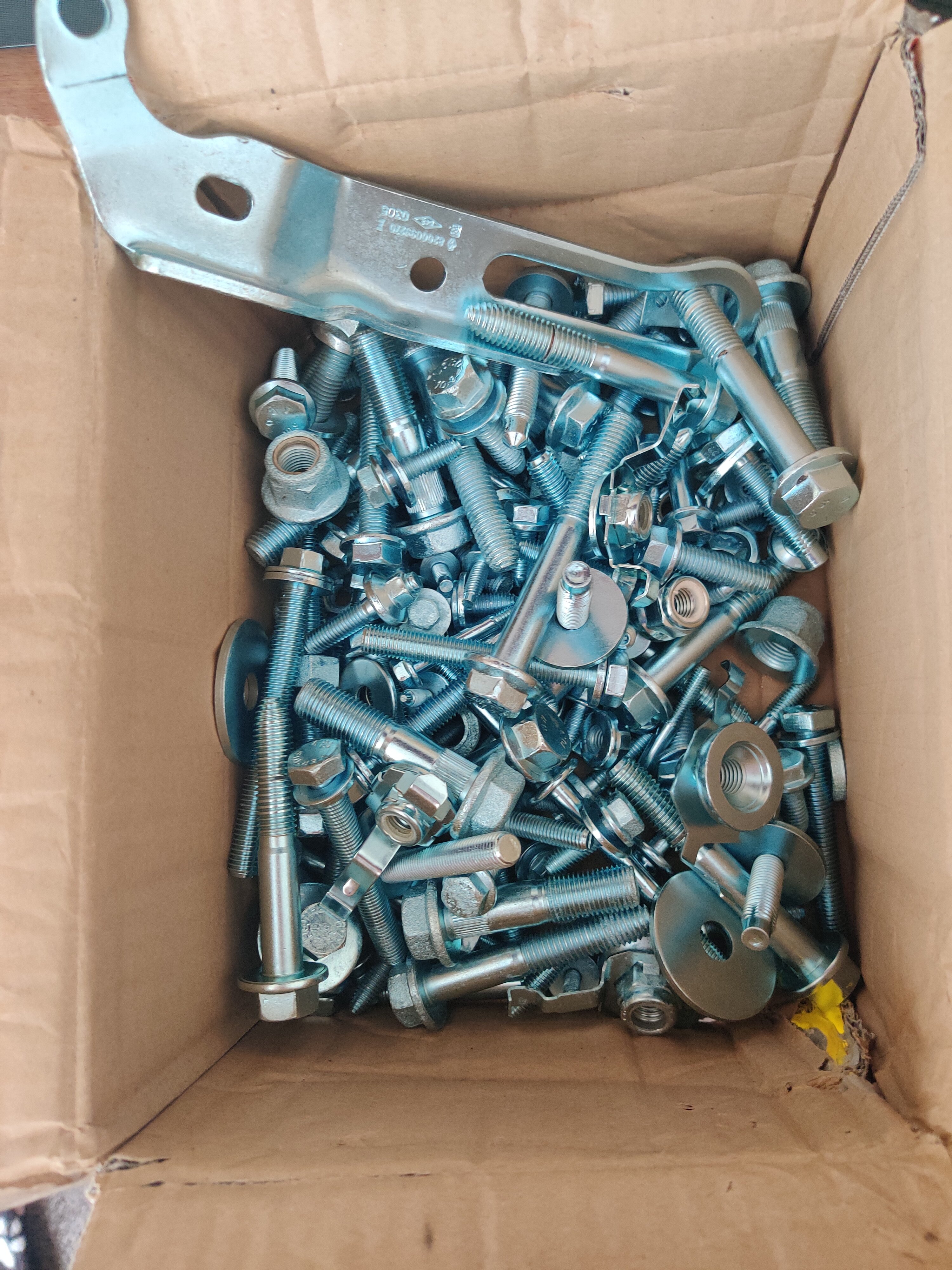

Every single exterior bolt off another car I had blasted and zinc plated.
Wish me luck working out what goes where... This wasnt even half of them xD haha....

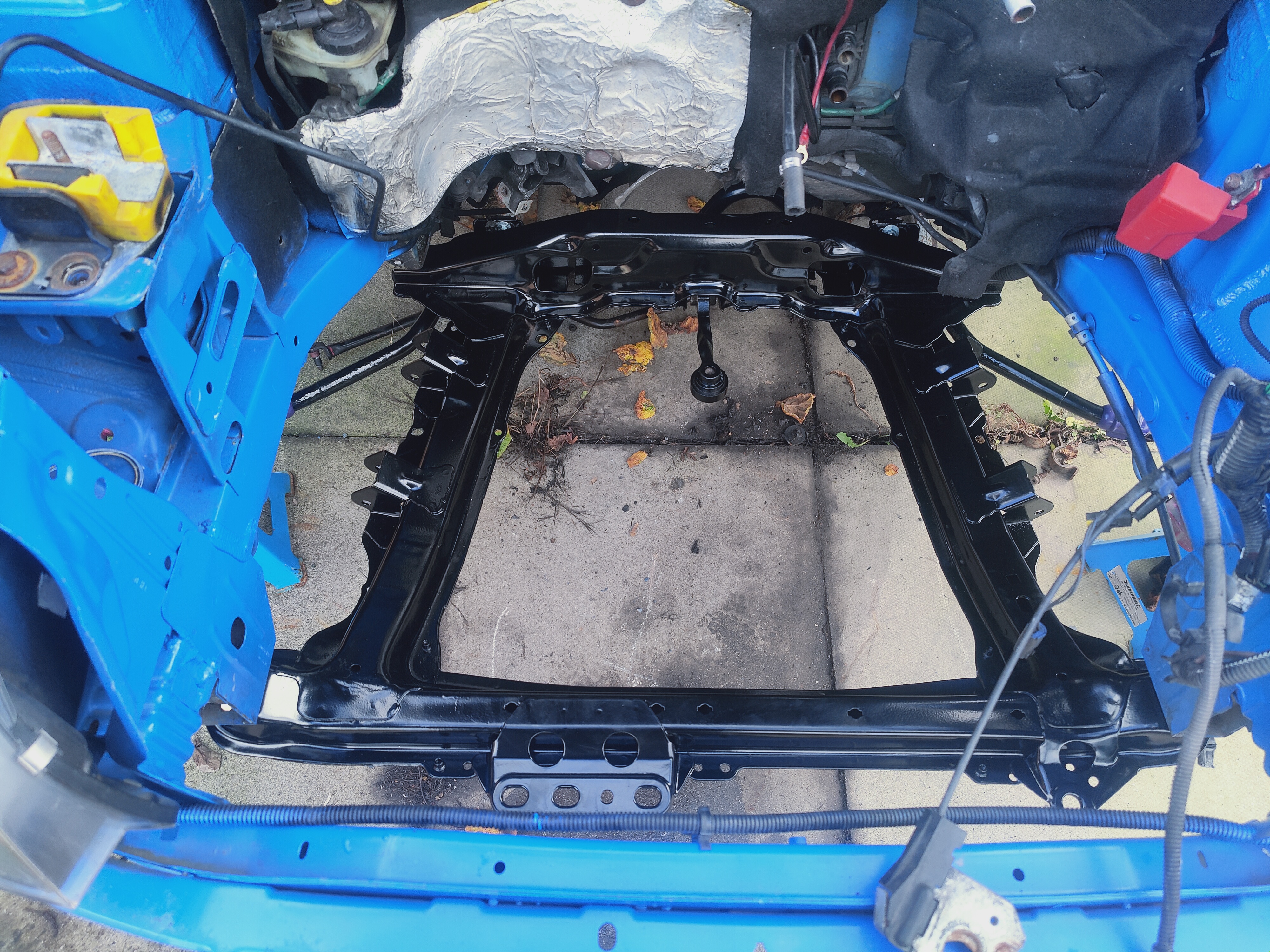

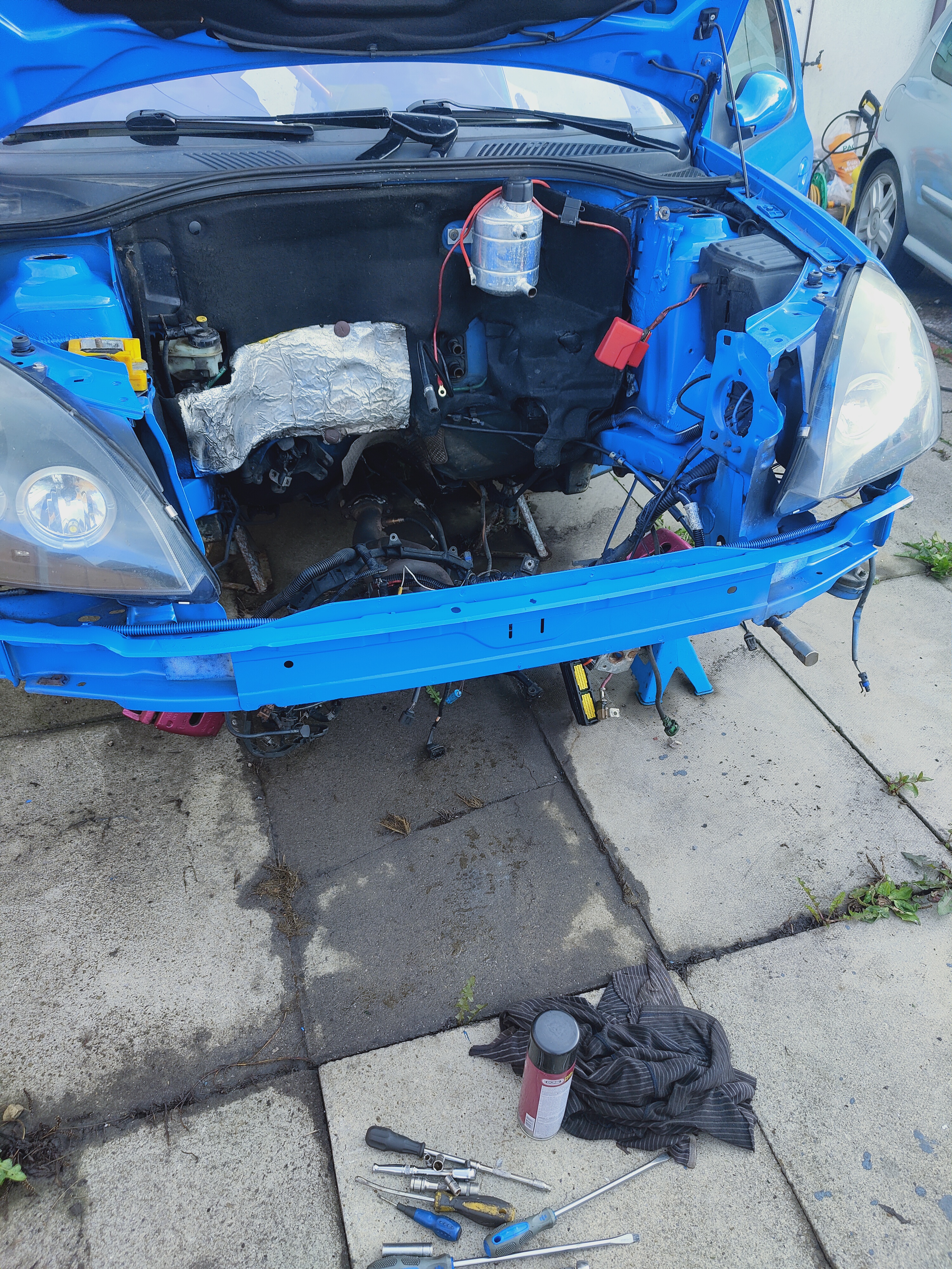

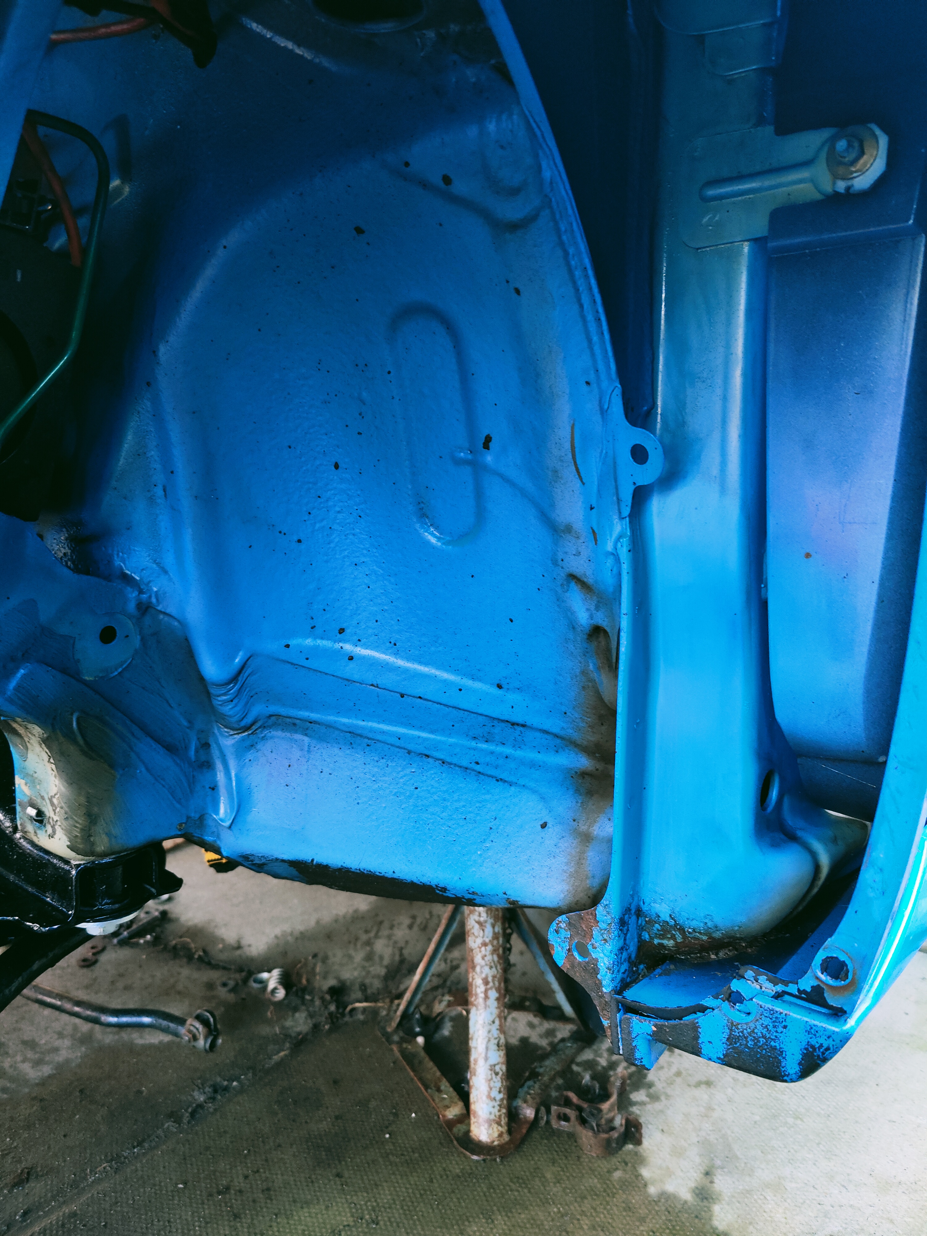

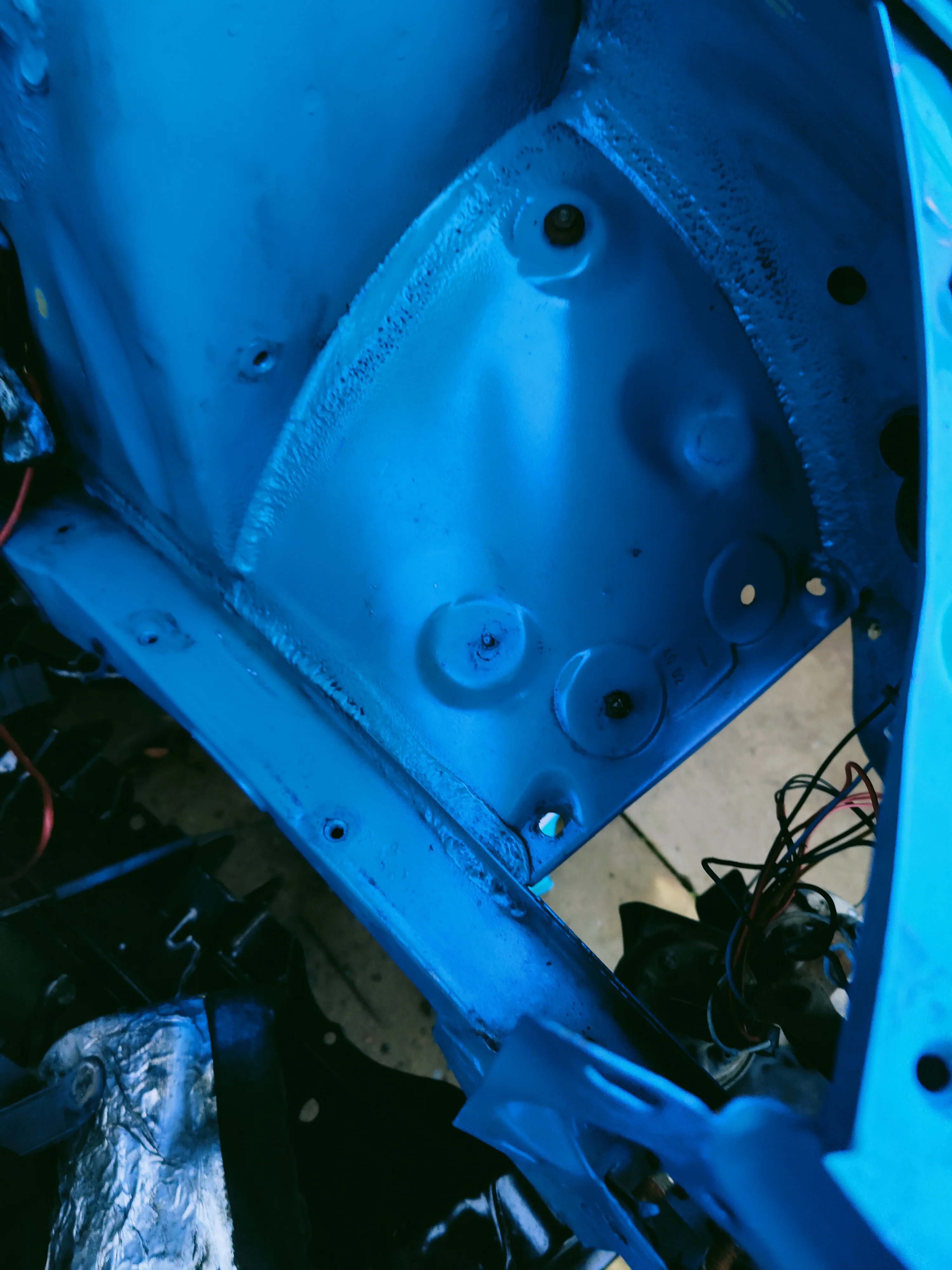

So we made a start , on the car, everything was stripped off it.... Again (hope this is the last friggin time)

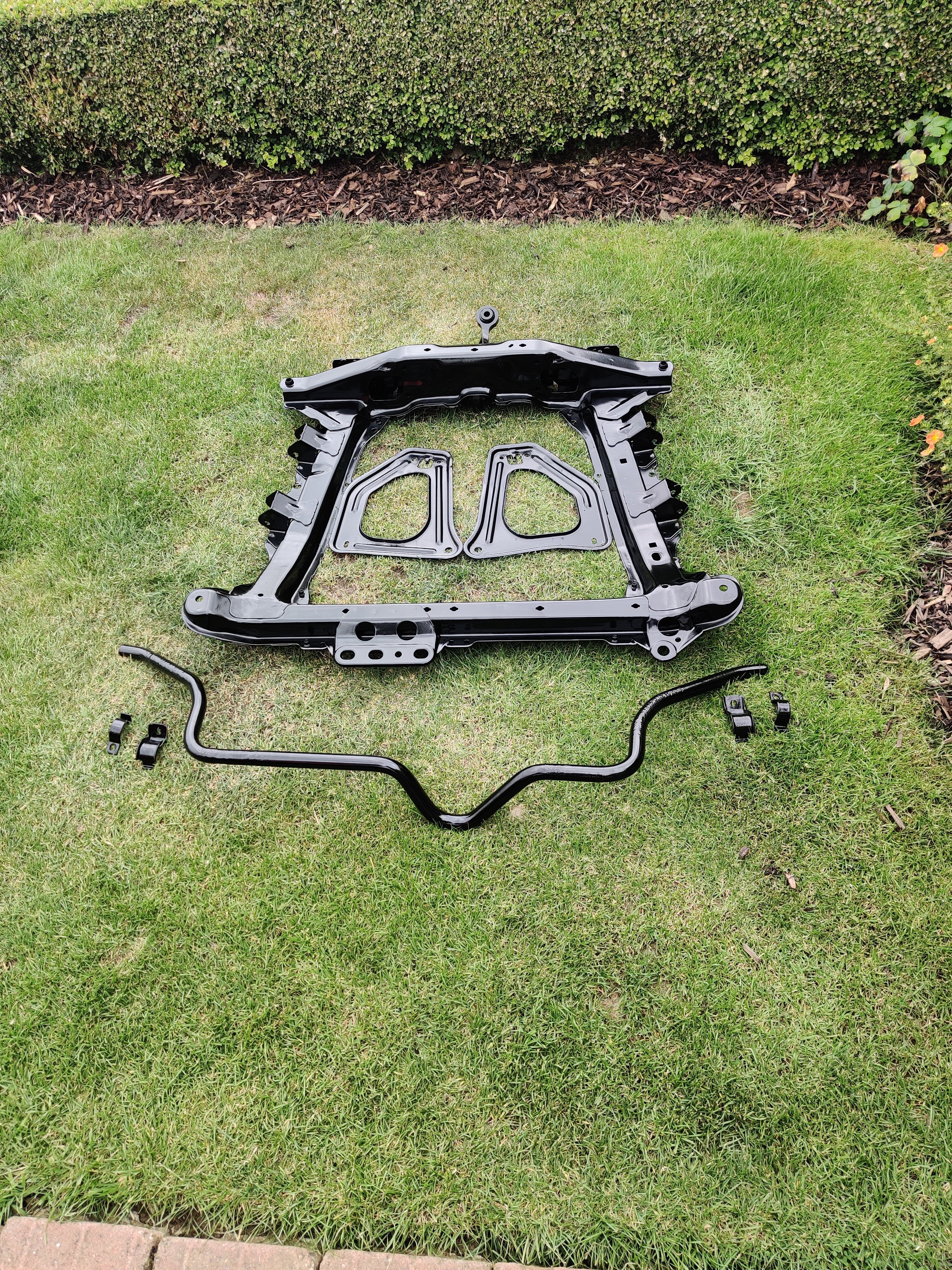

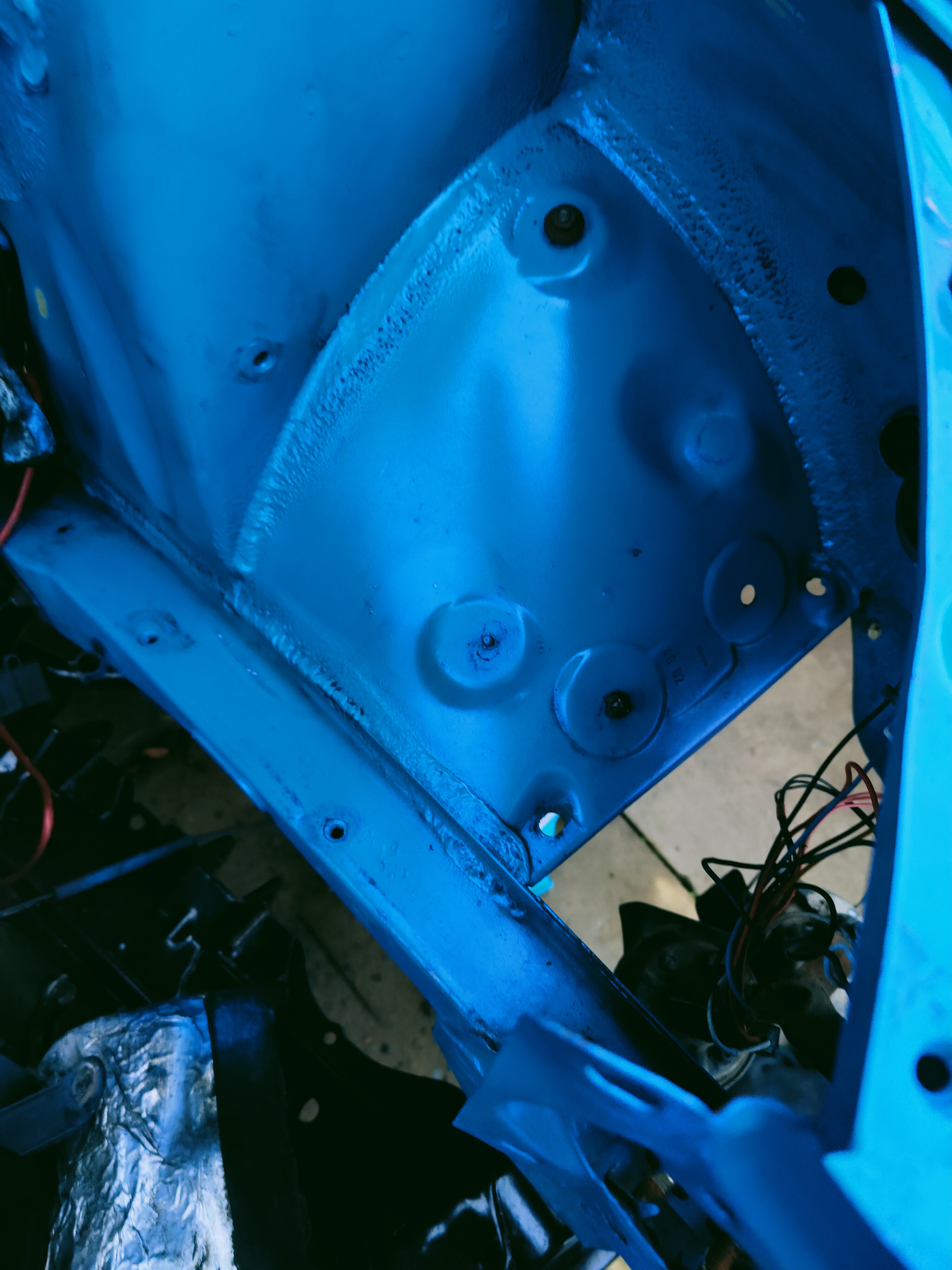

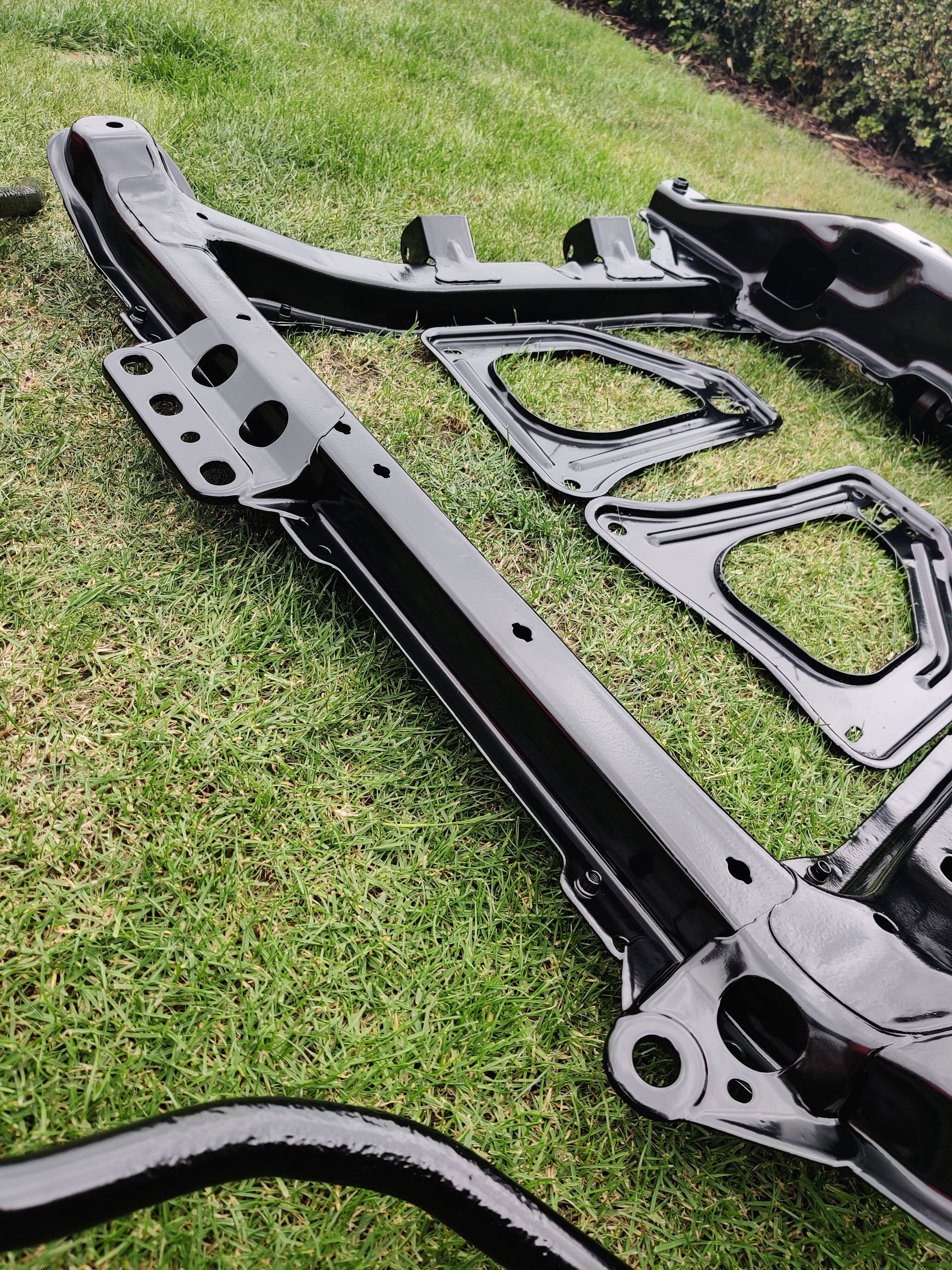

The engine bay was cleaned and then repainted, the subframe then took its place, the arches are next on the list to be cleaned and treated.

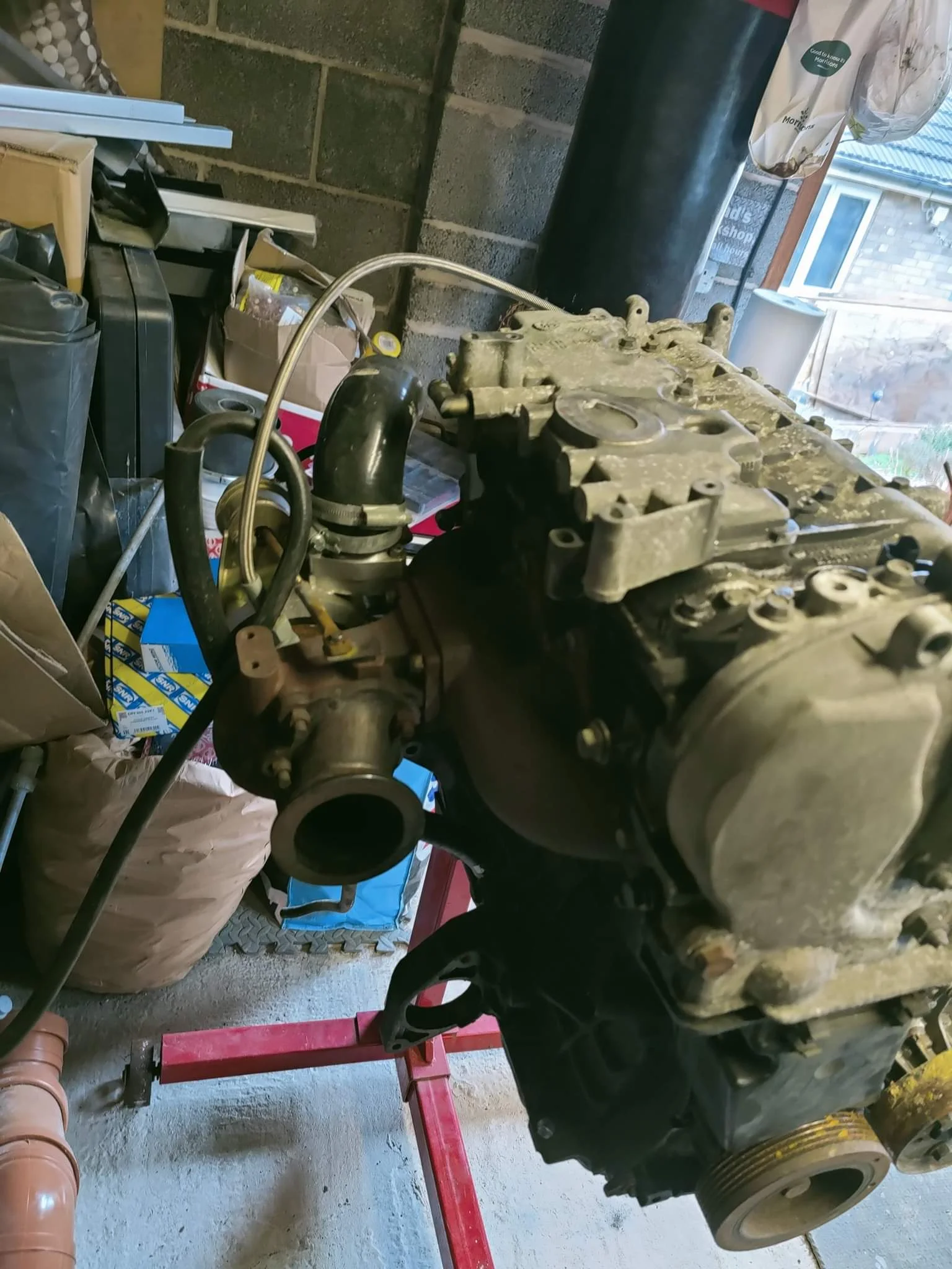

But then this project took another turn, because I then bought a low boosted car (purely for the engine)

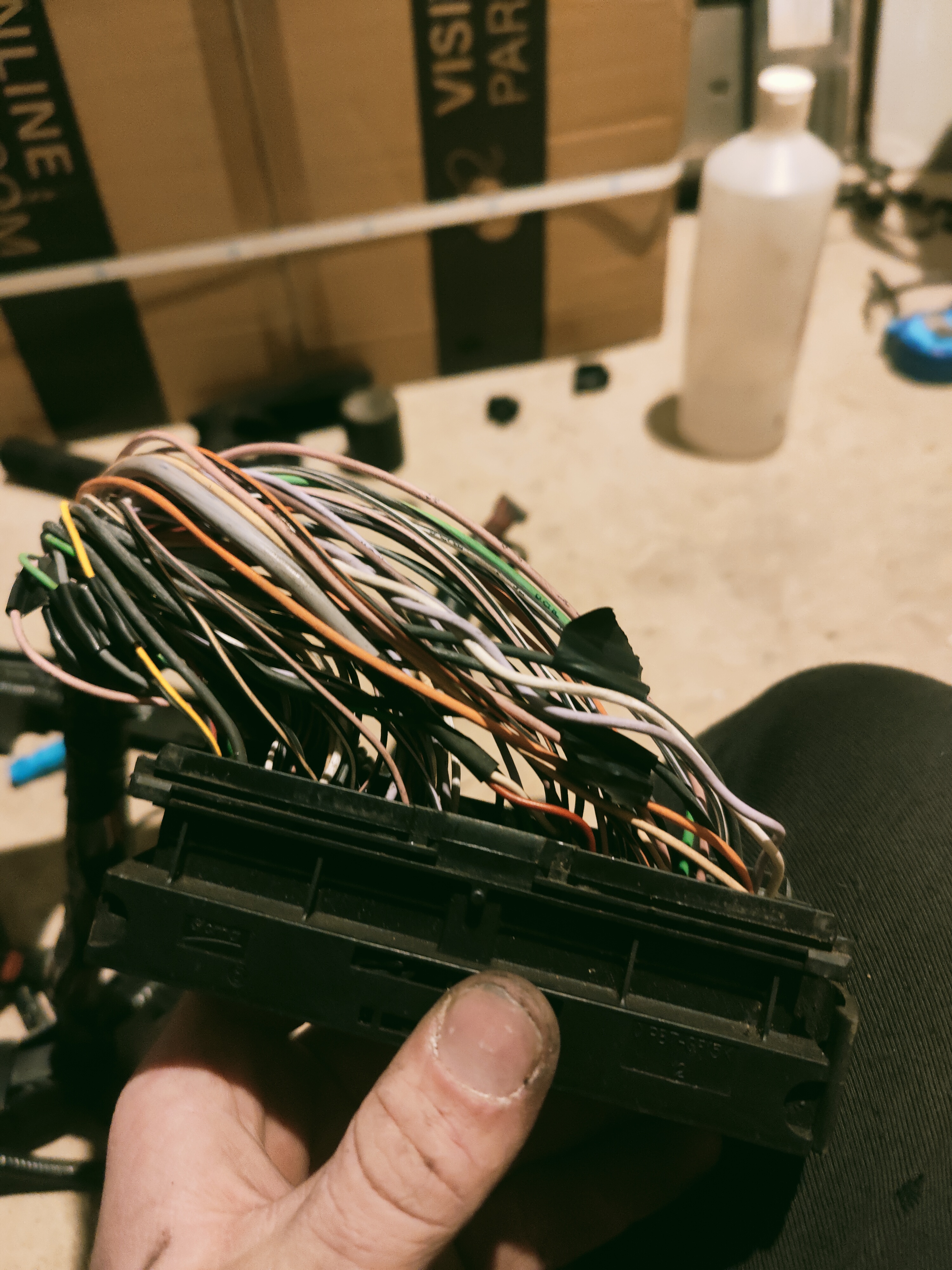

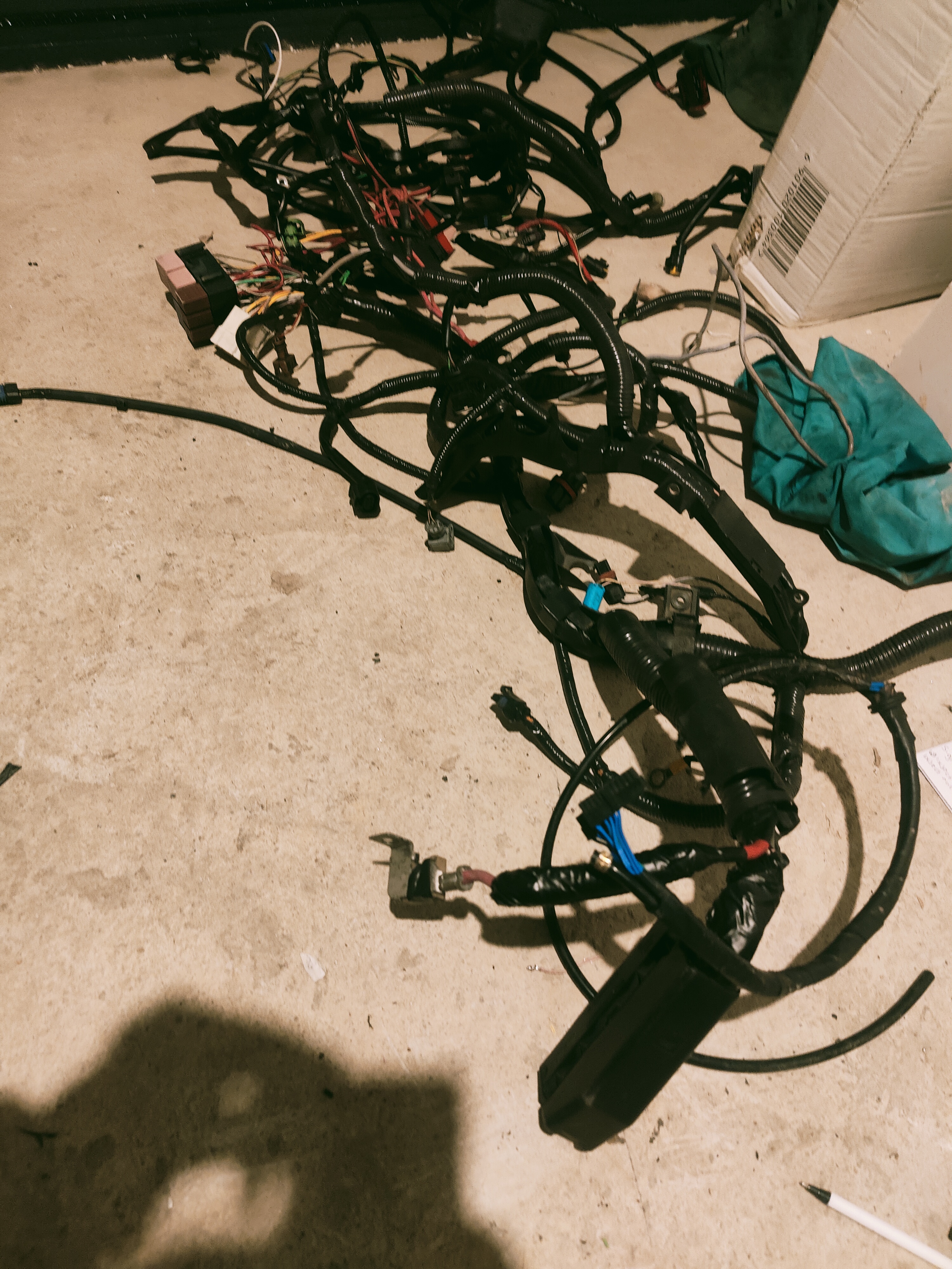

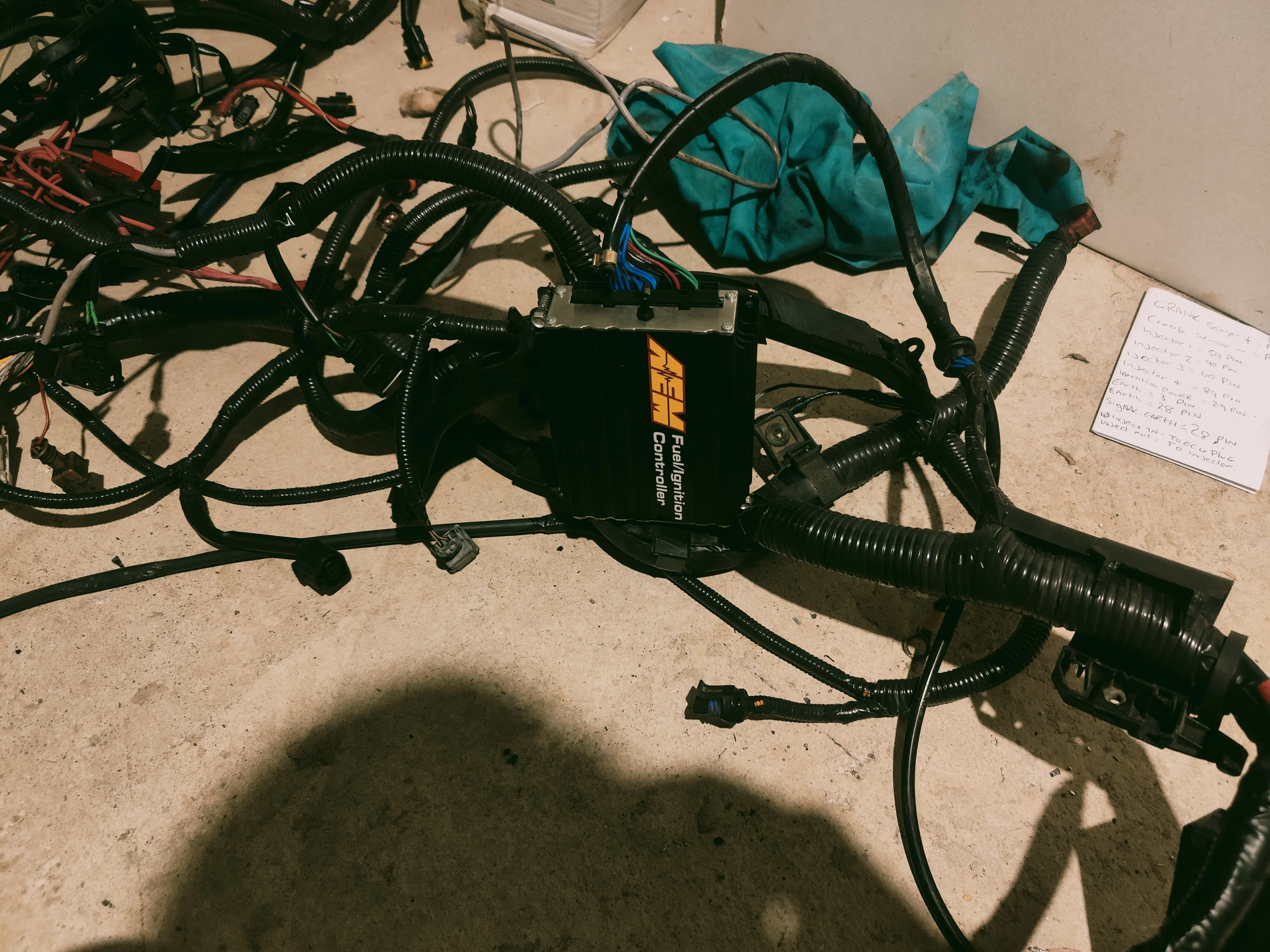

So now, I removed the loom to tidy it up and wire up the AEM fuel and ignition controller, to date, this is about where we are.
So now your upto scratch, this is now going to be my Low Boosted Racing blue project. Hope you enjoyed the read. And I will update this as I do stuff if it's of interest.

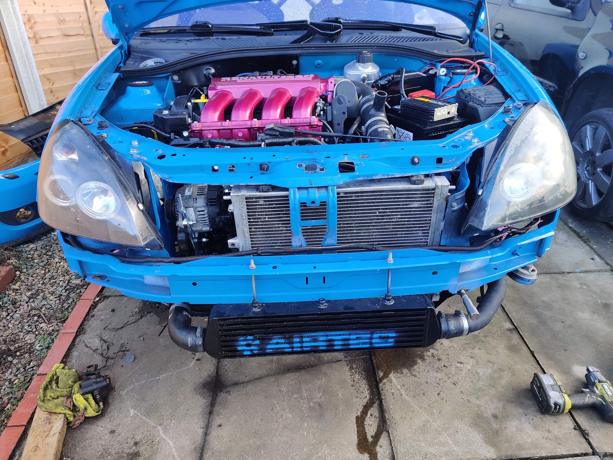

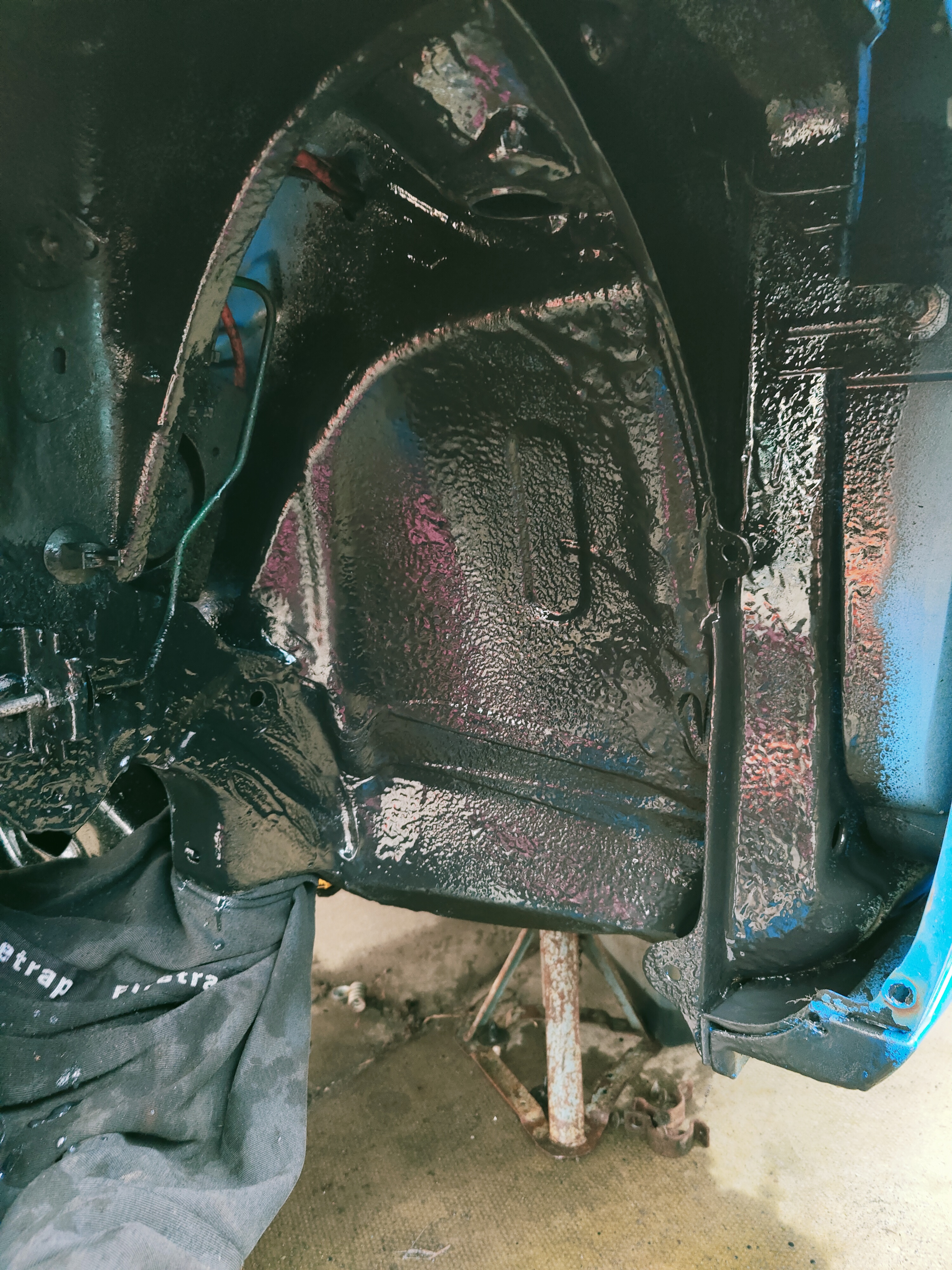

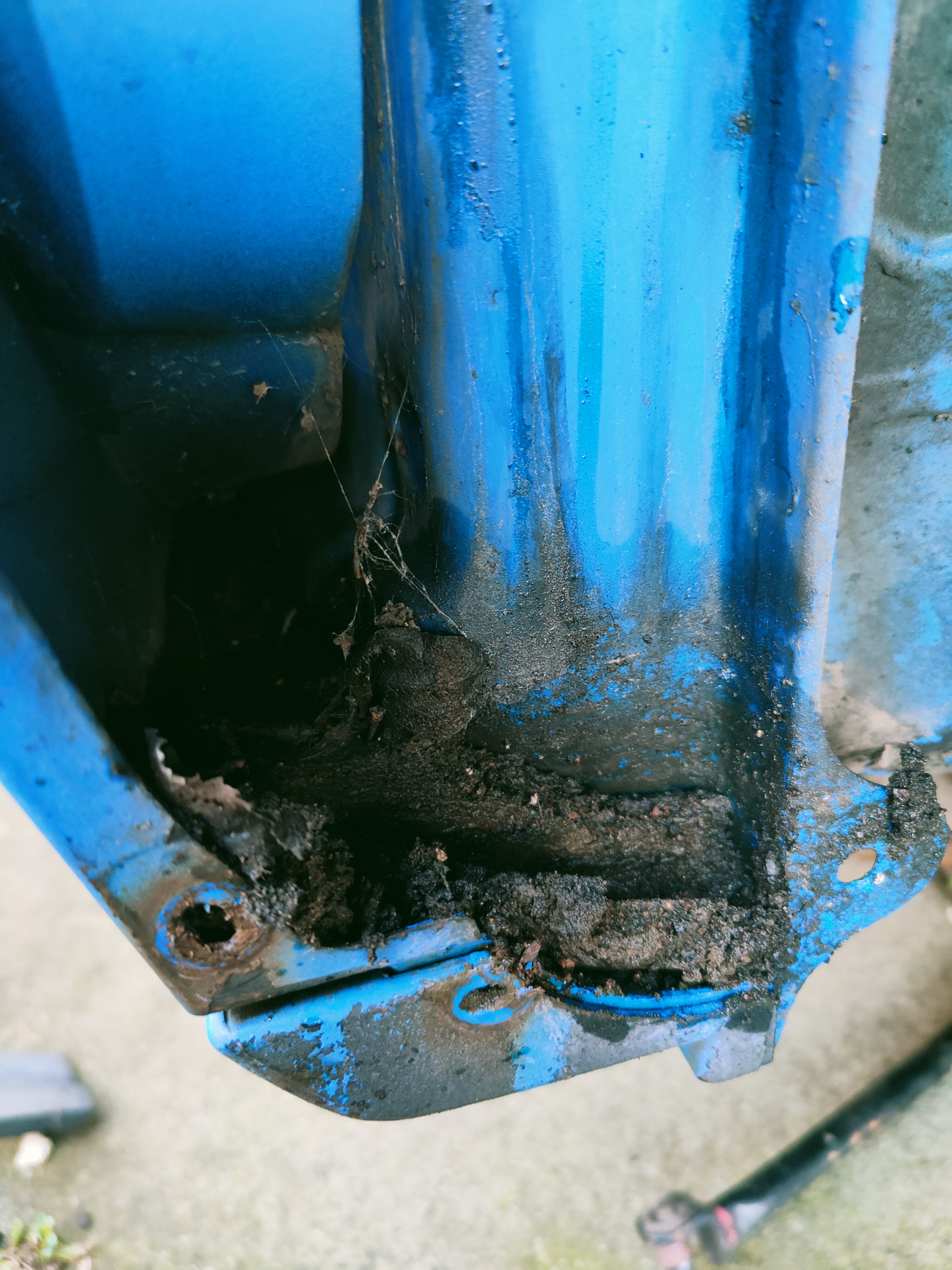

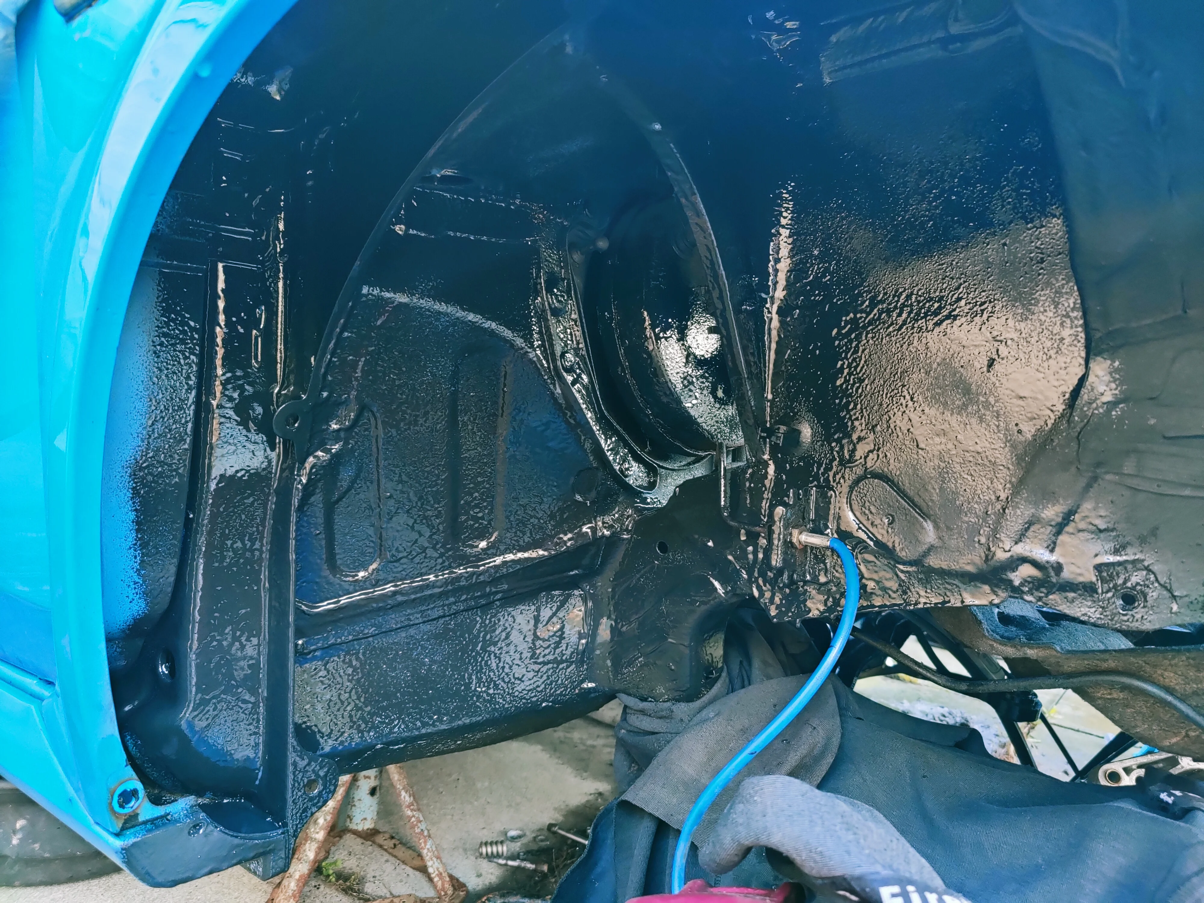

Update, let's start with update #1! Under sealing, managed to find bit of time to get the arch liners out and clean it all up behind there, got brand-new arch liners on the way just missing one side of the rear half, found them all with a bit of digging, last ones £70 delivered for 3 parts! Bargin again!.
Anyway it's starting to look abit fresher now!
Next job for me is to fit the wiring loom back inside along with the wishbones and hubs, followed by the steering rack and shocks :D .
Slowly slowly it's getting there.. :)

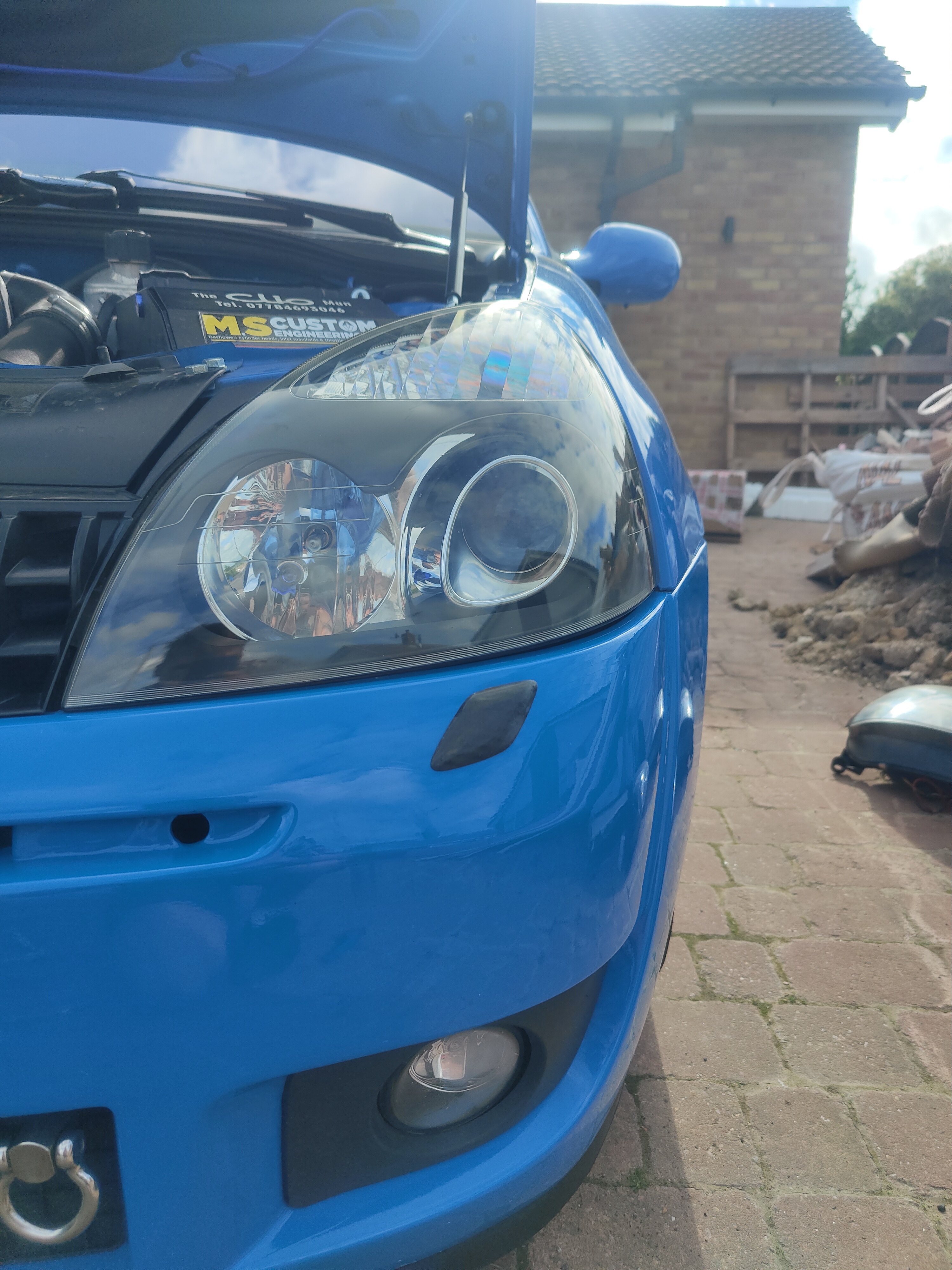

looking good matey and top find that! glad you saved it!
Pud is right though, those headlights....nope! lol!
Cheers mate, it's getting done, and not you aswell🤣 they're nice 😜 maybe one day ill put some brand new xenon's but till then, nah! Hehe
jameswrx
I think there’s some crossed wires. I’m assuming (op?) the weird painted bad boy ones were on it, he’s fitted ‘new’ ones. Pud’s comment was at the crap ones and OP thought he meant ‘old headlights’ as in the ones he’s just changed to need to be fresher.
edit...
Just zoomed in on the new ones, angel eye. No crossed wires. WTF were you thinking lol
edit...
Just look nice at night haha xD

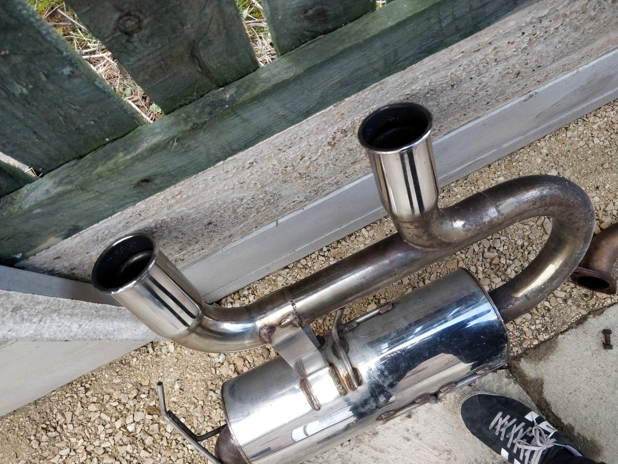

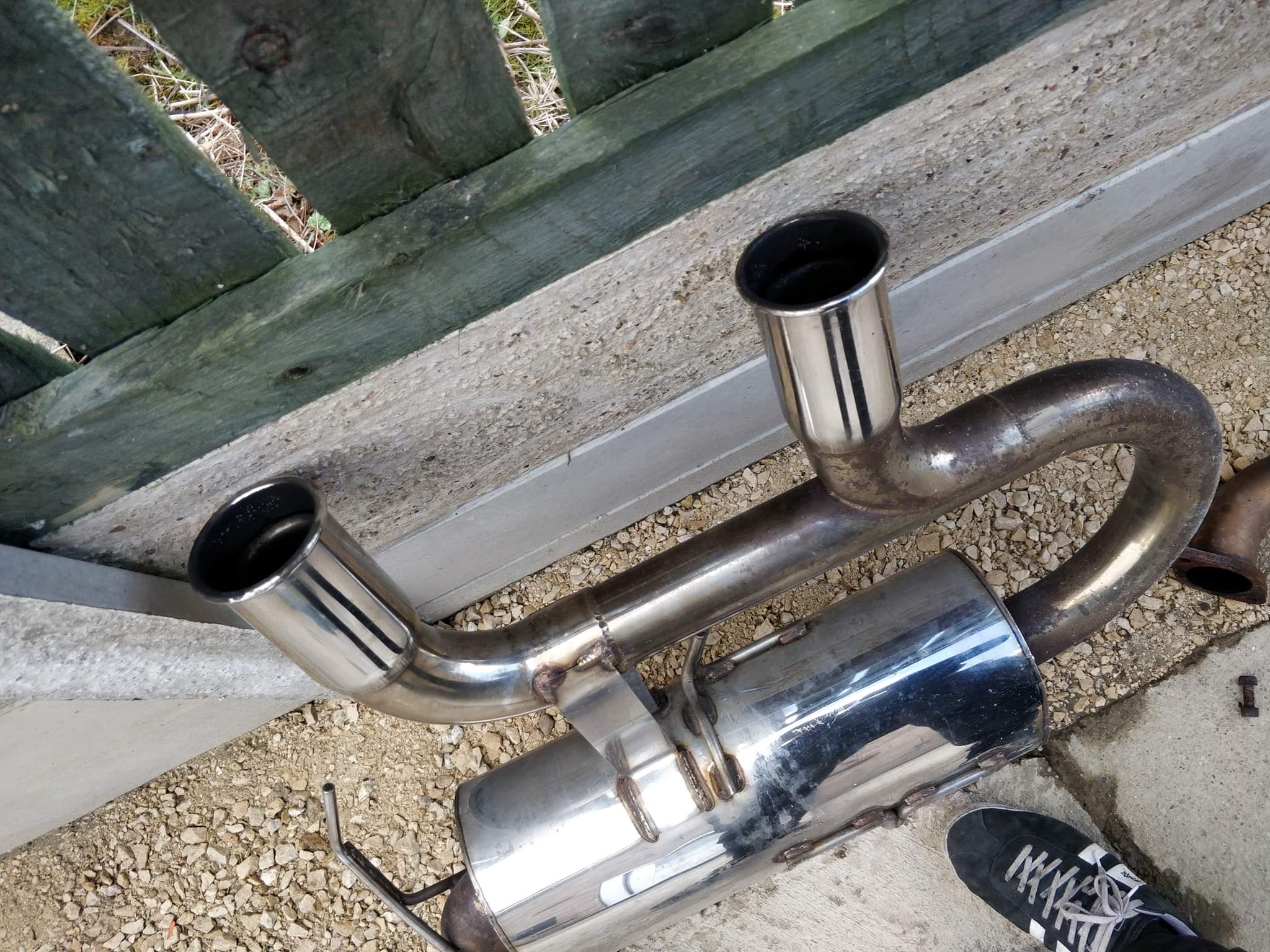

I do the like rolled tips on the yozza systems

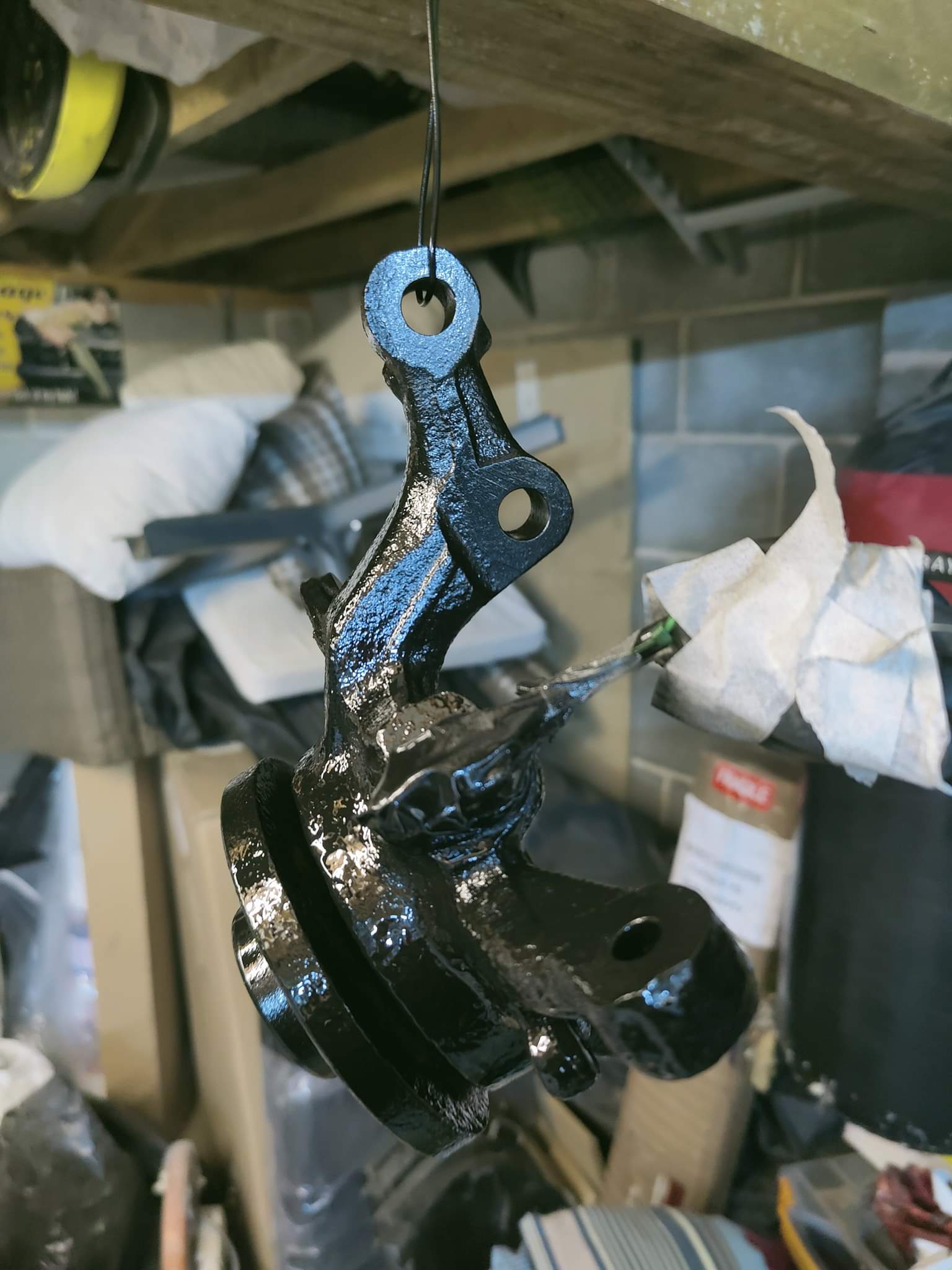

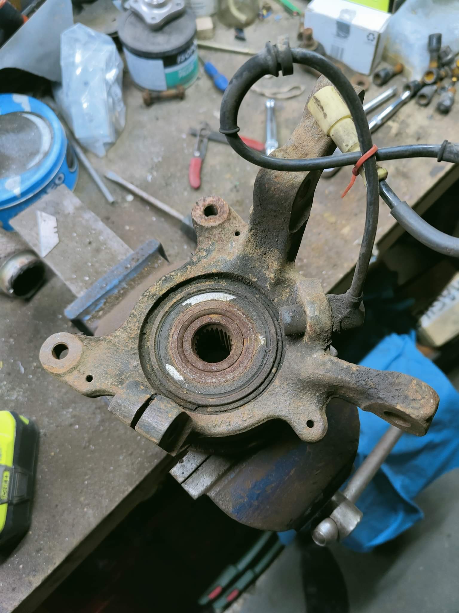

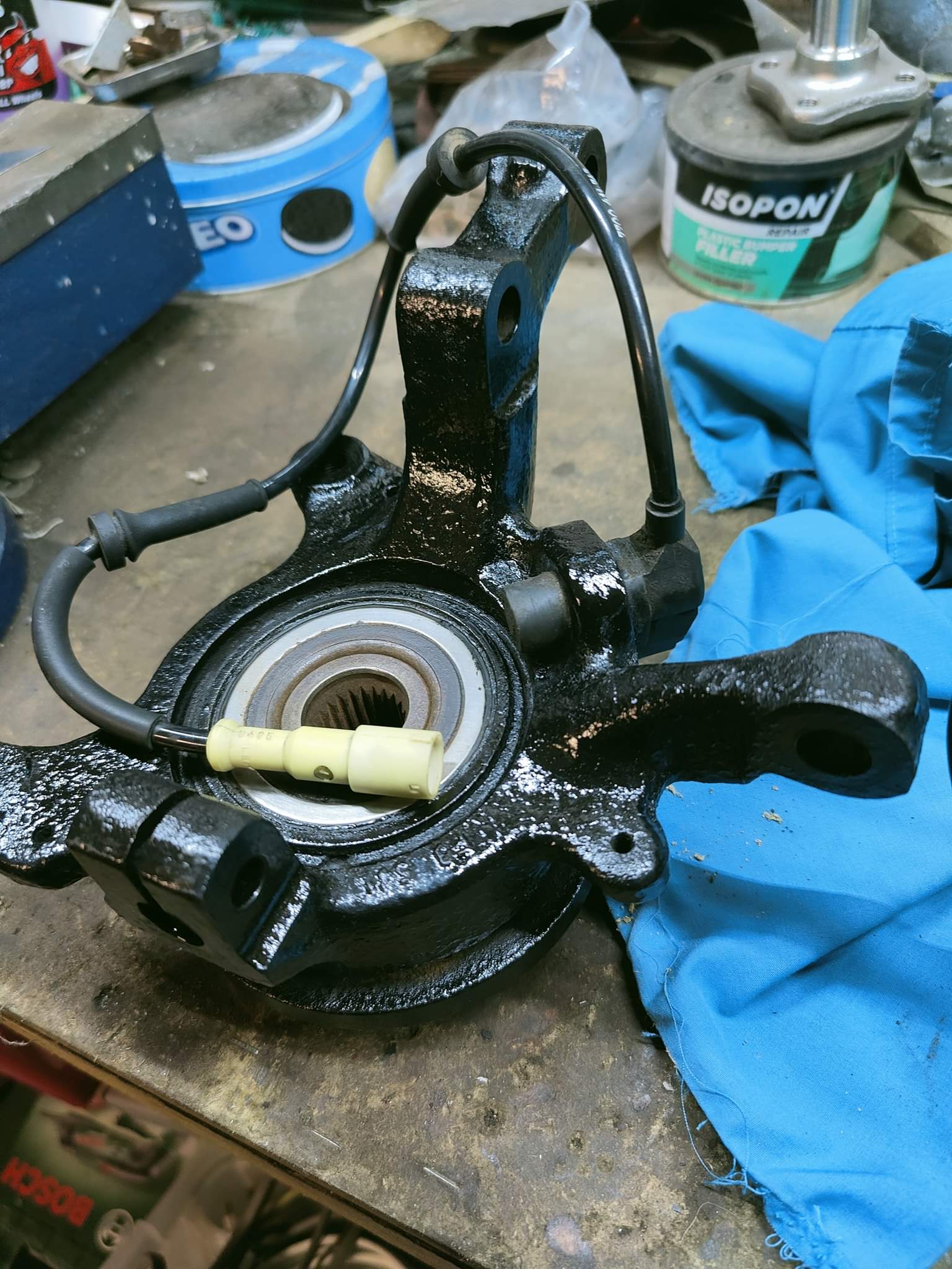

So I've not updated this thread in a whole we're a whole lot closer than we was before. So starting from where we left off, I got the gearbox back home to clean it up and all the other bits this was covered in shitty paint from last time I did it. Cleaned it up and lacquered it. Loooked very nice. FB_IMG_1613931730814.jpgFB_IMG_1613931760844.jpgFB_IMG_1613931762965.jpgFB_IMG_1613931765858.jpg

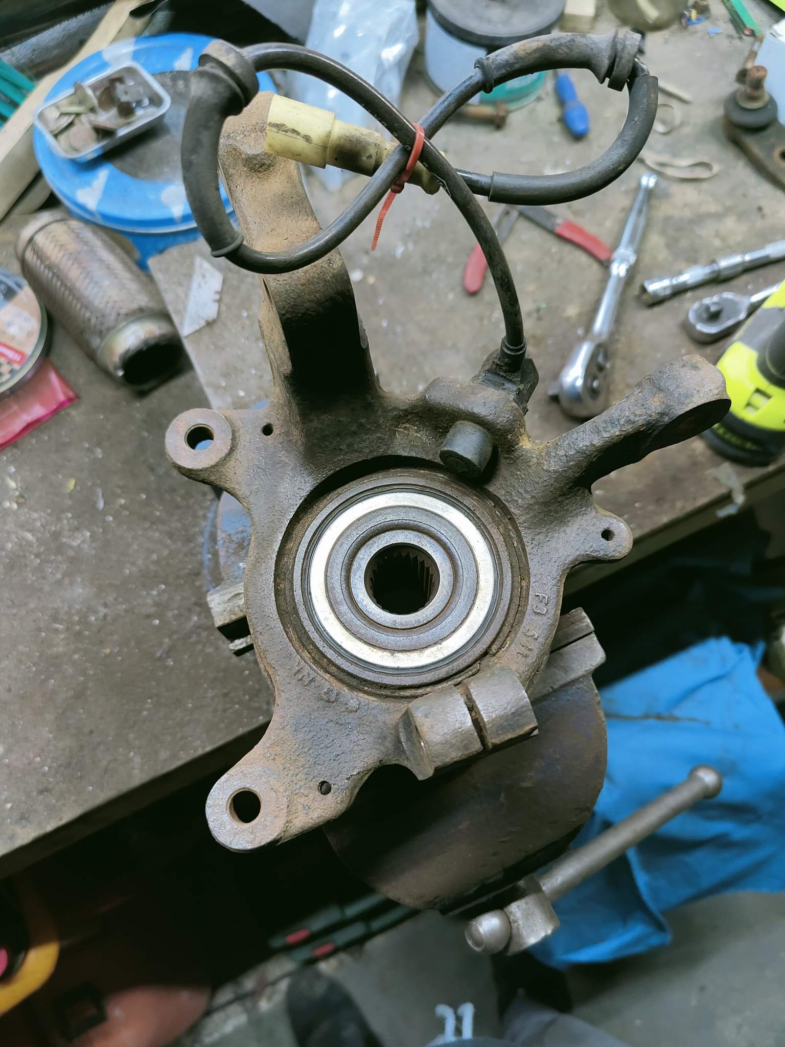

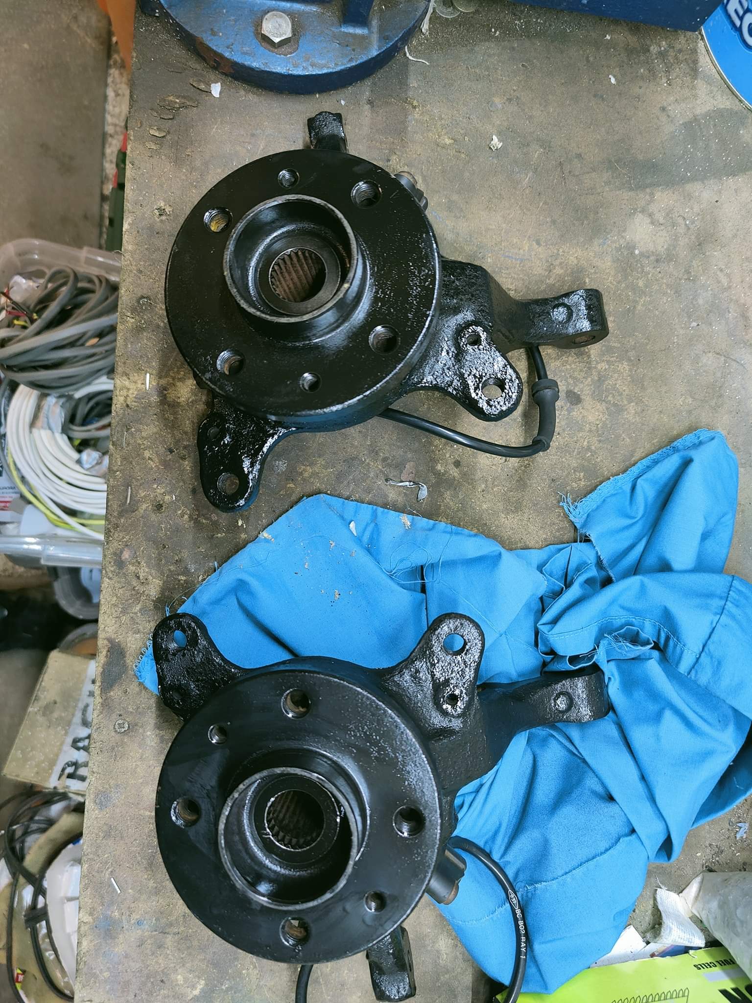

Then I made a start on all the other bits Hubs and other parts.

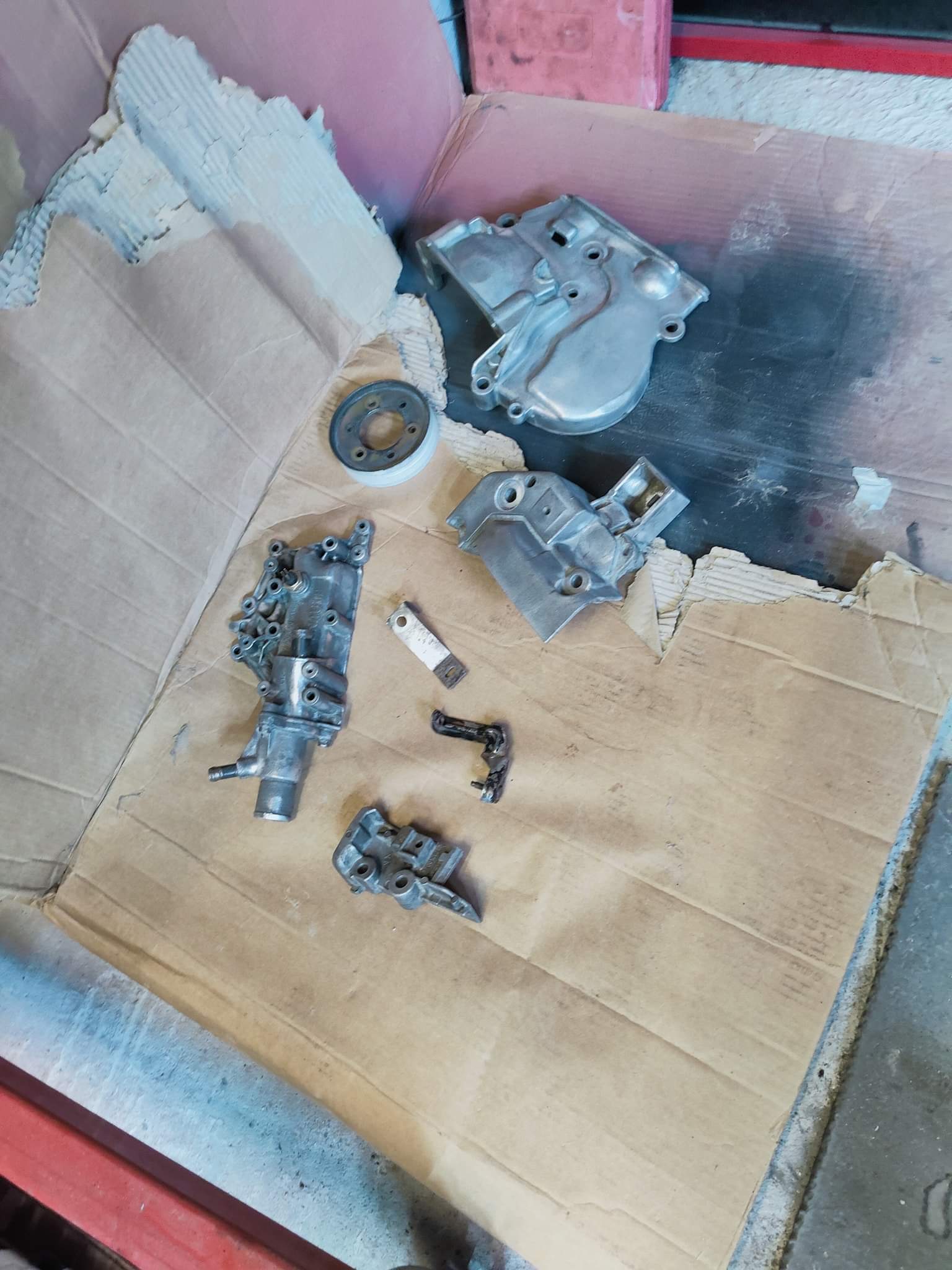

Following on with the hubs-

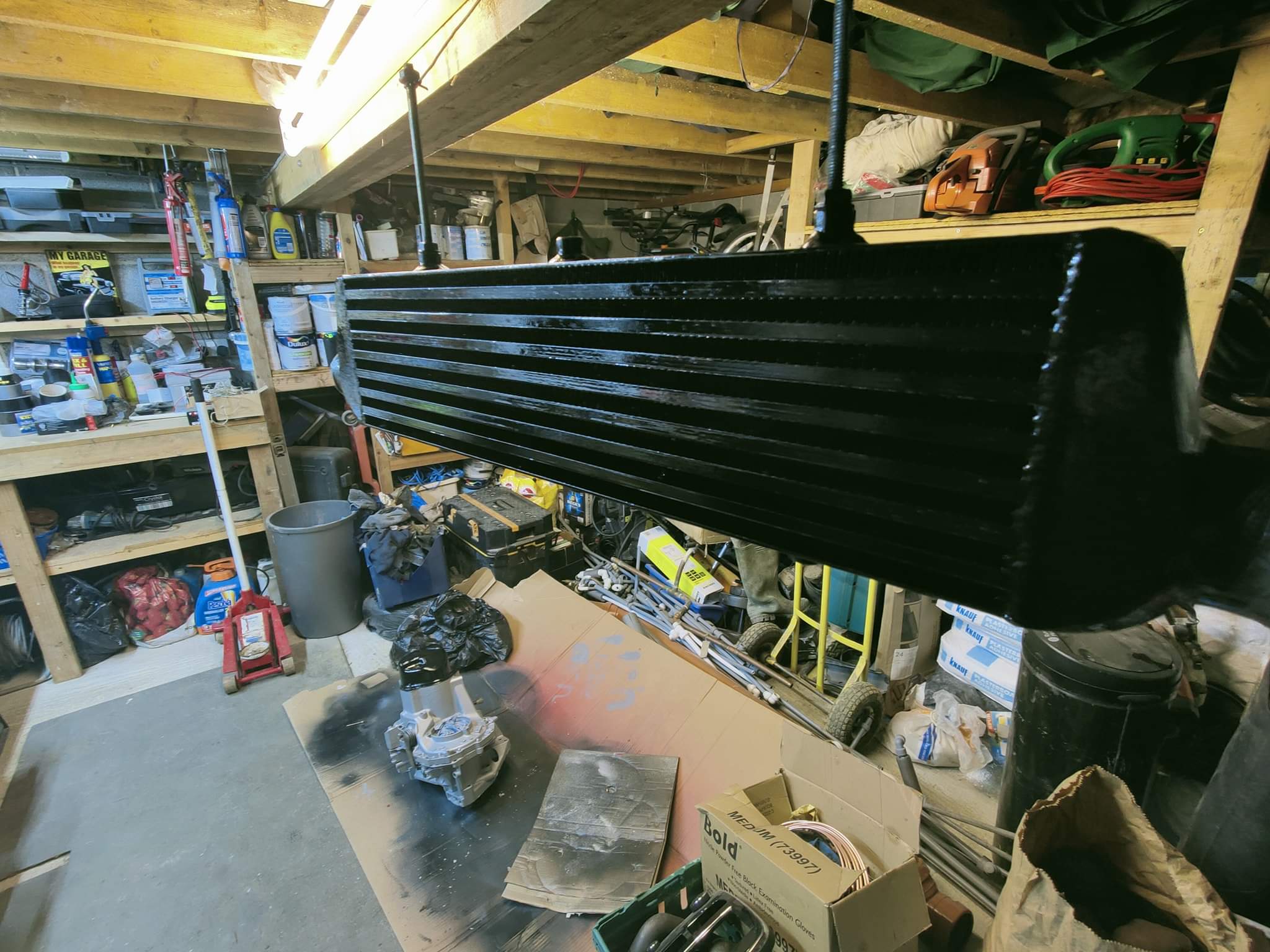

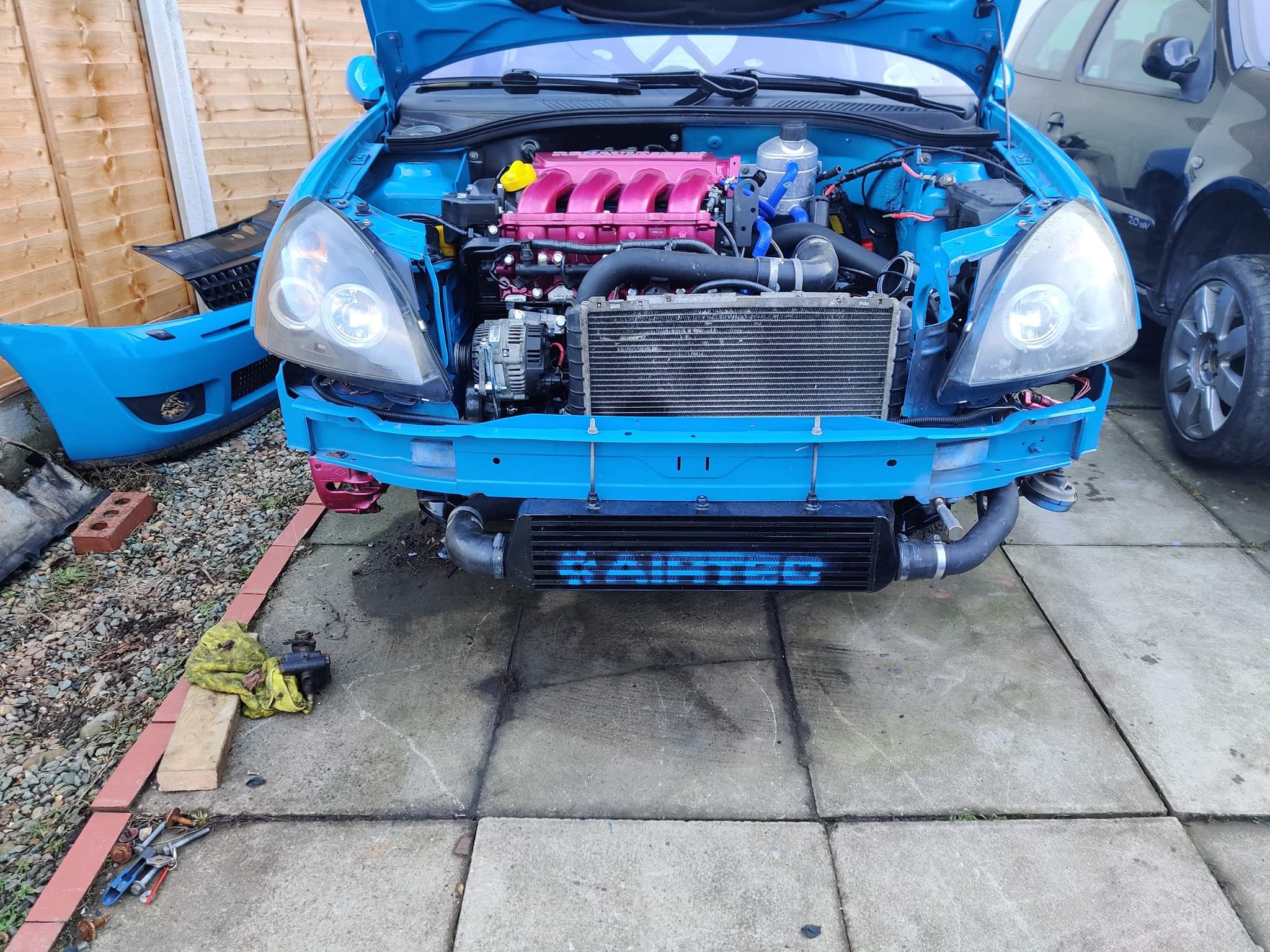

I then bought the intercooler back and spiced that up abit!
Not the best and wish I turned out better but :&( wasn't as easy as I thought....

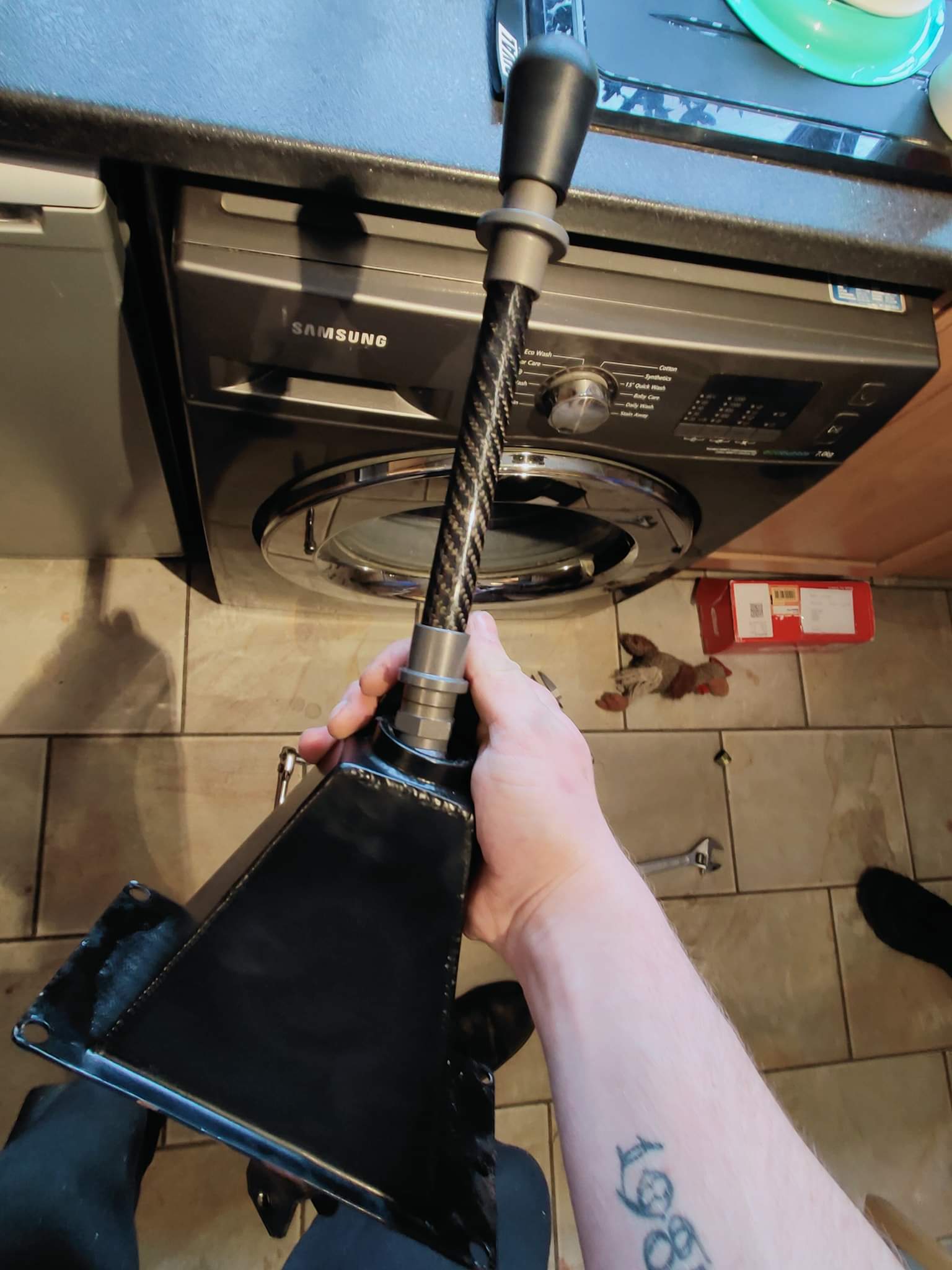

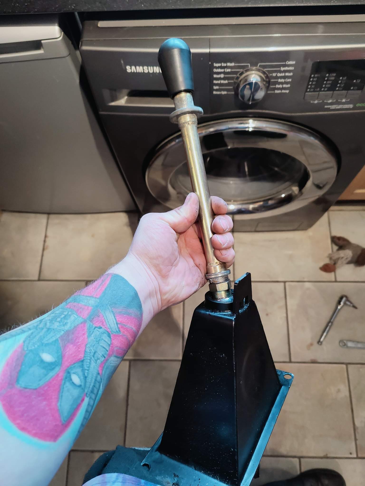

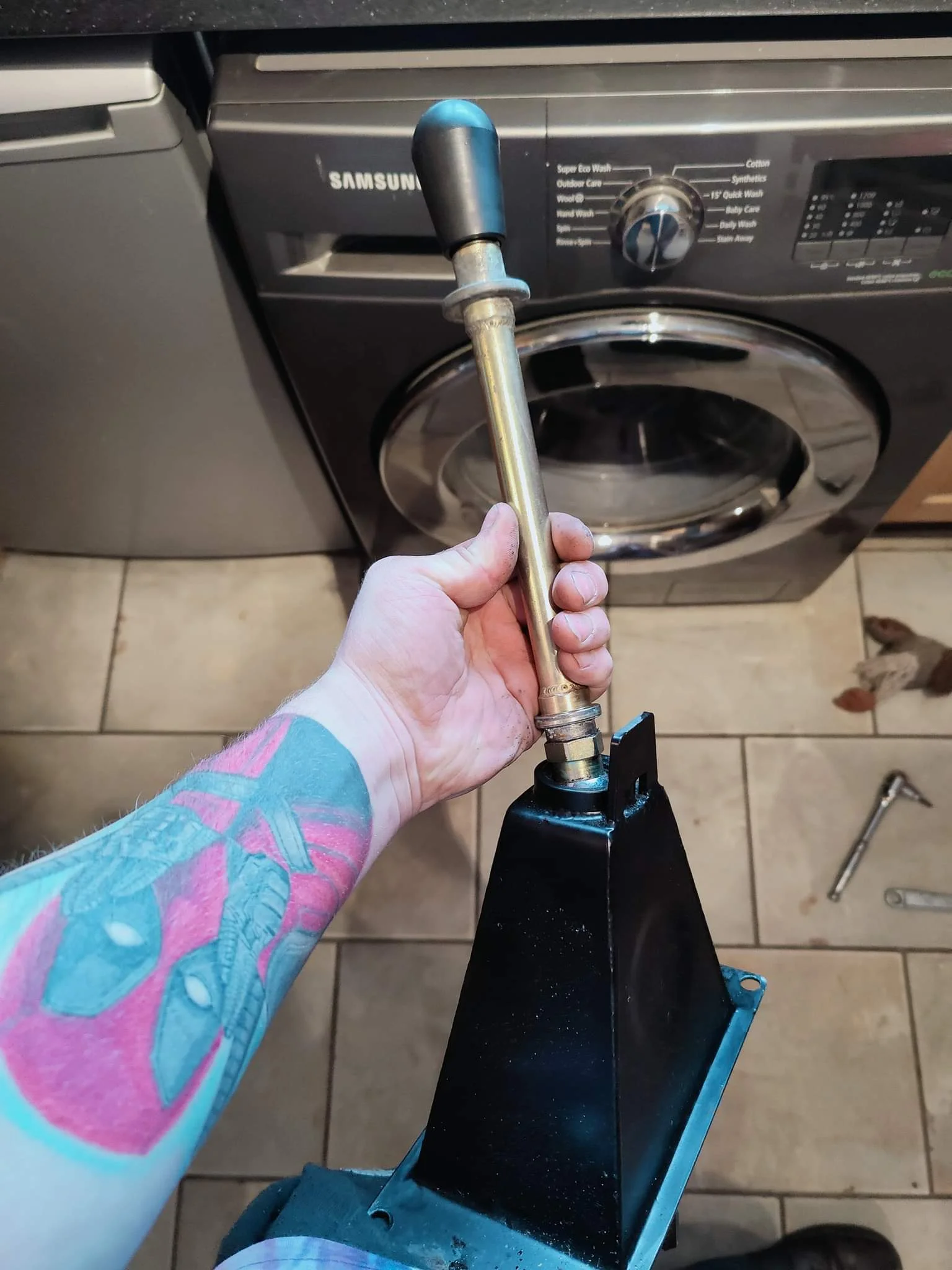

Few other little modifications with the shifter and got the hubs fitted...

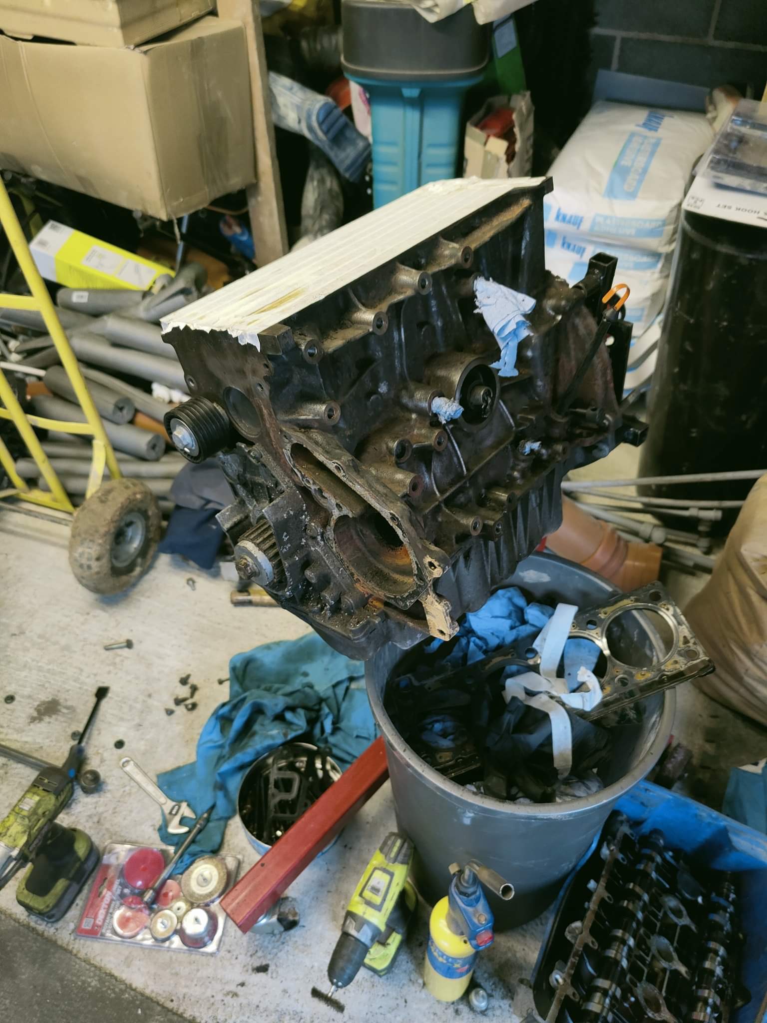

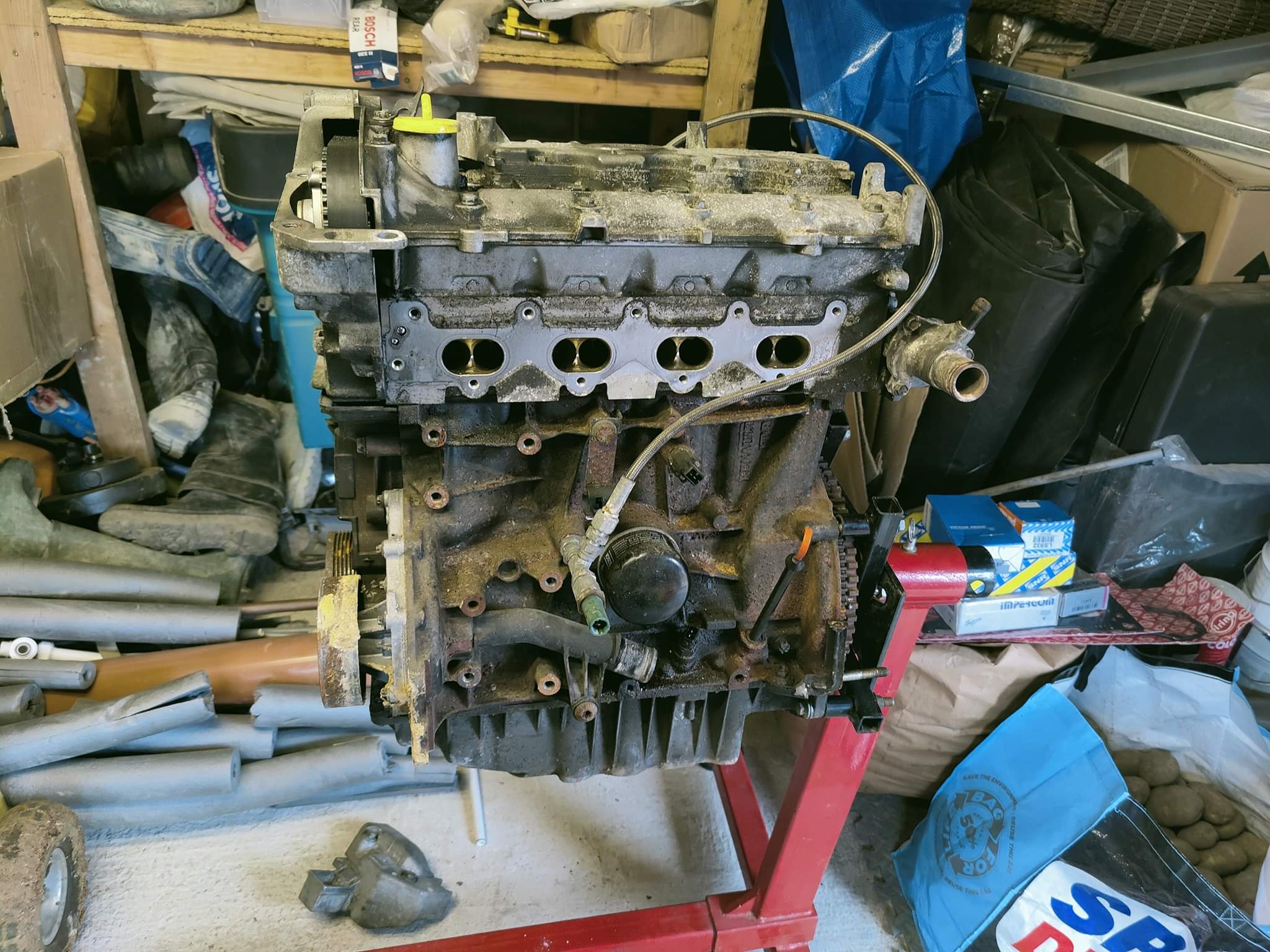

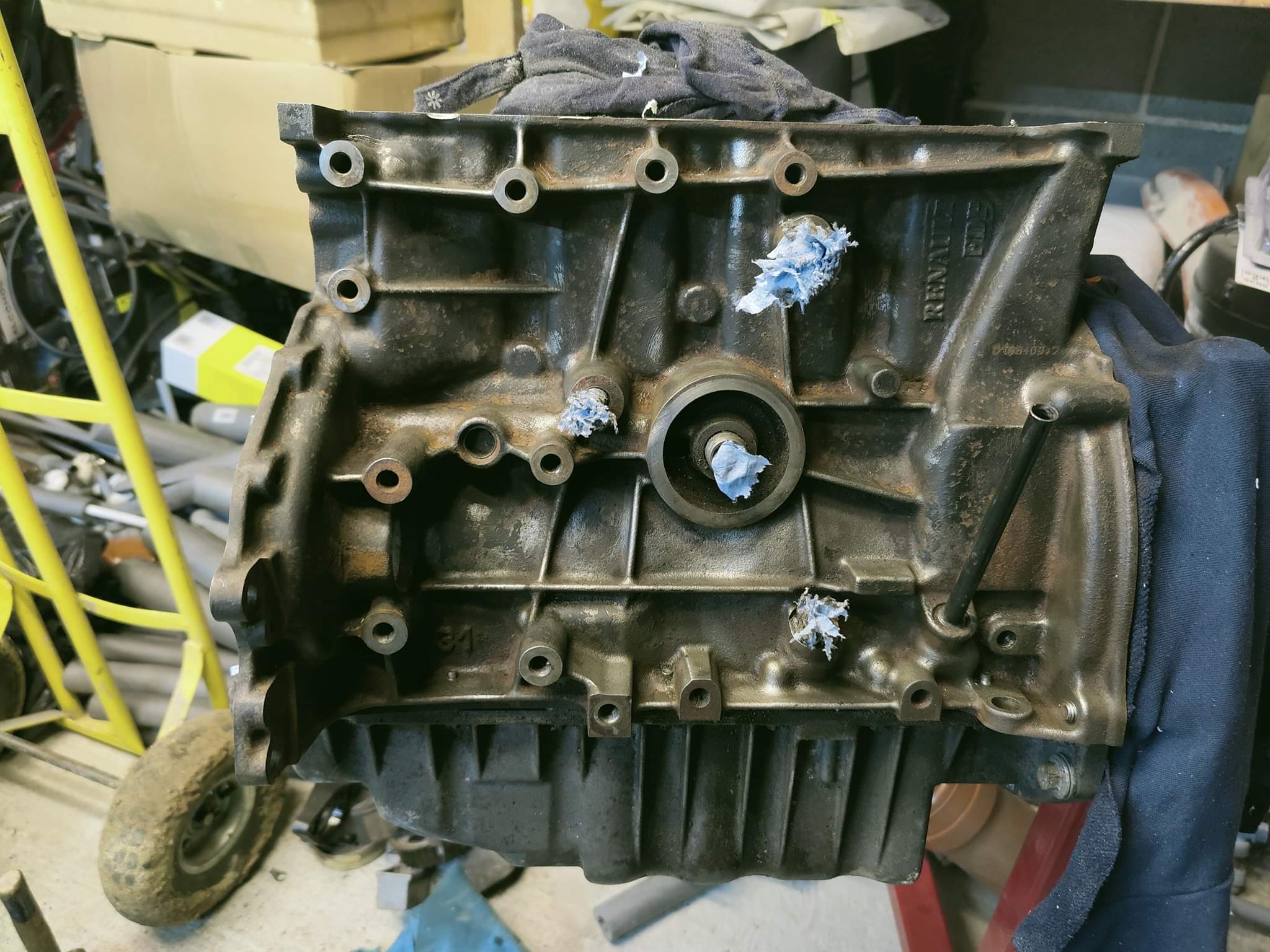

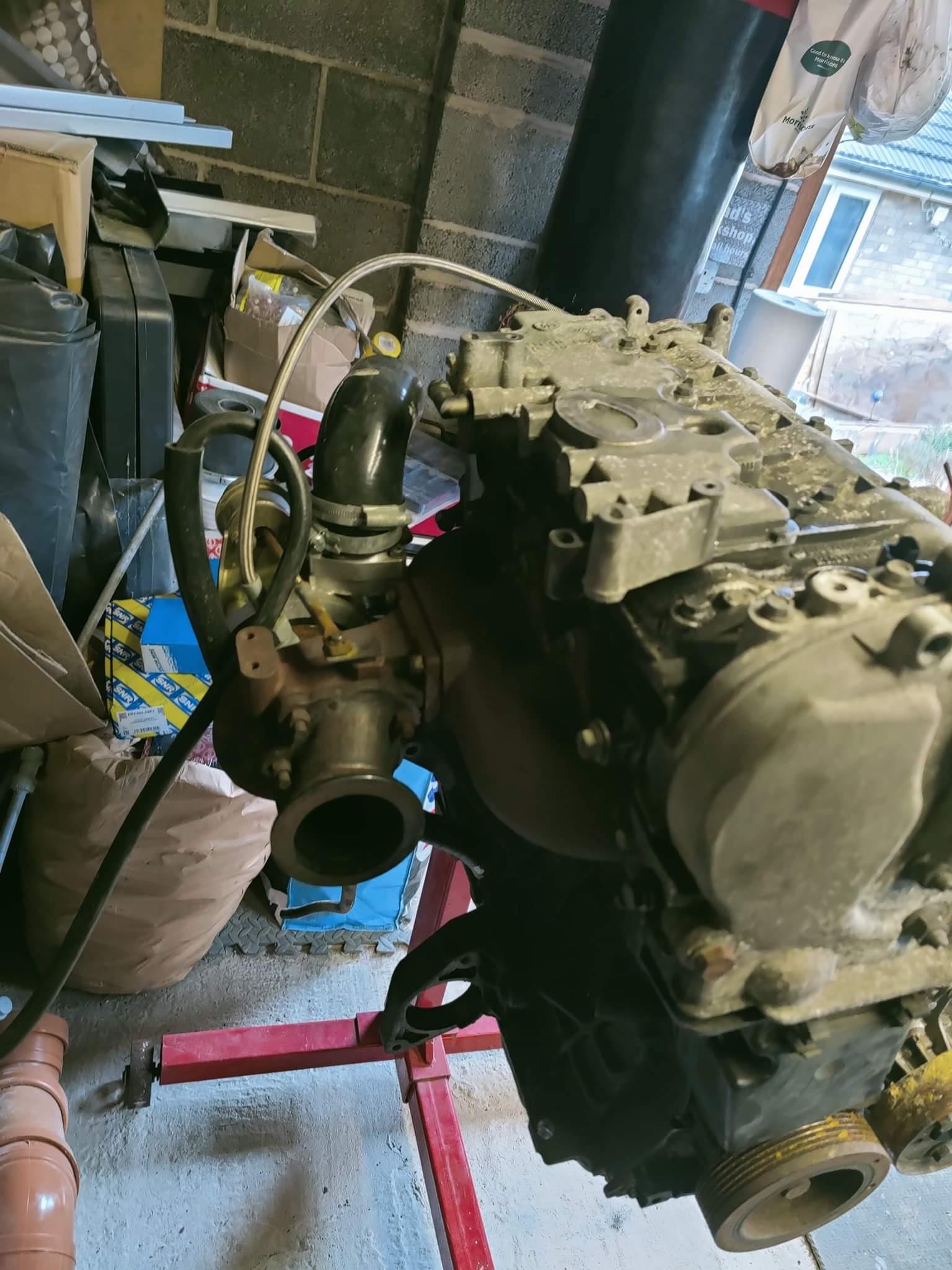

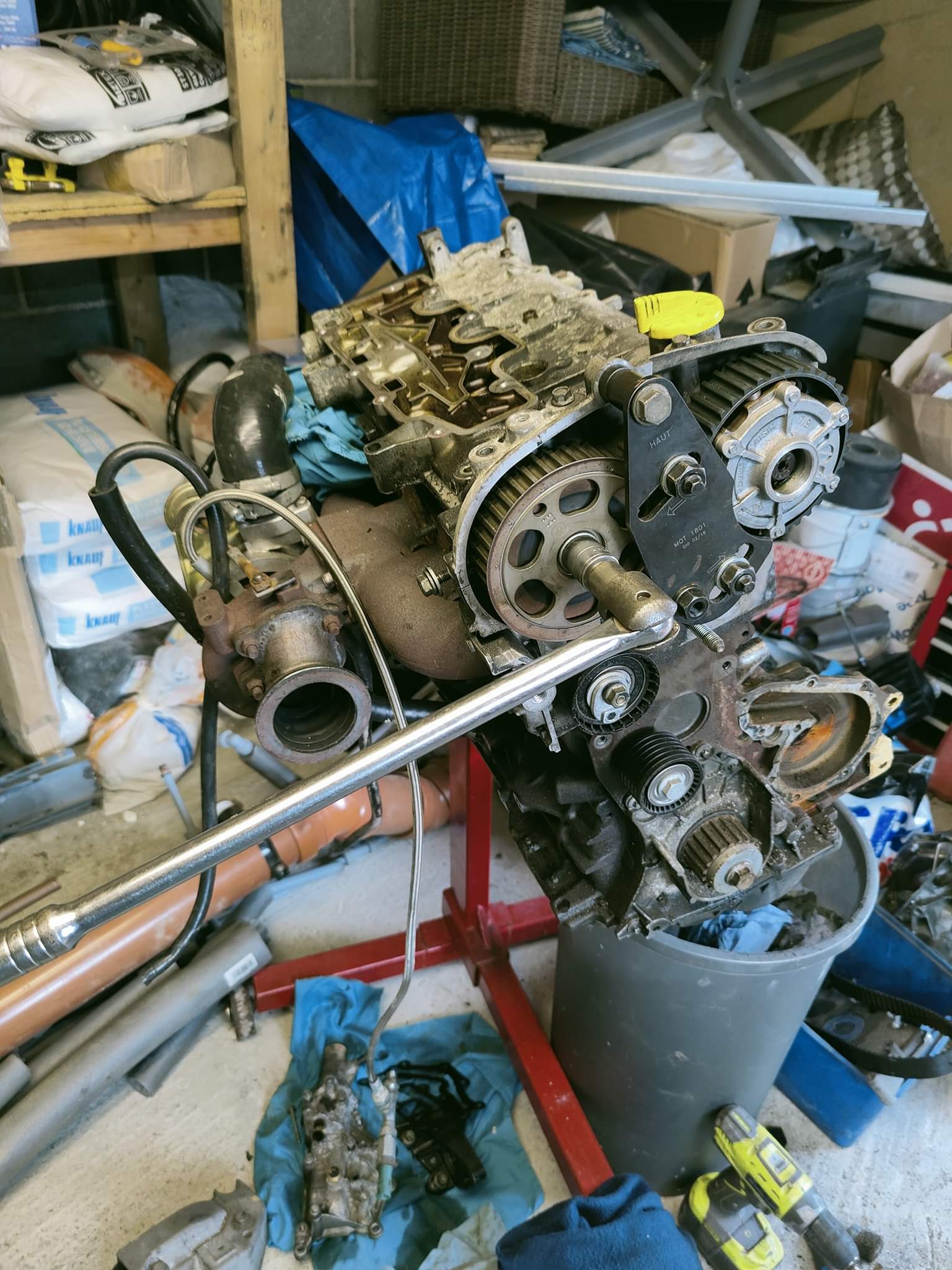

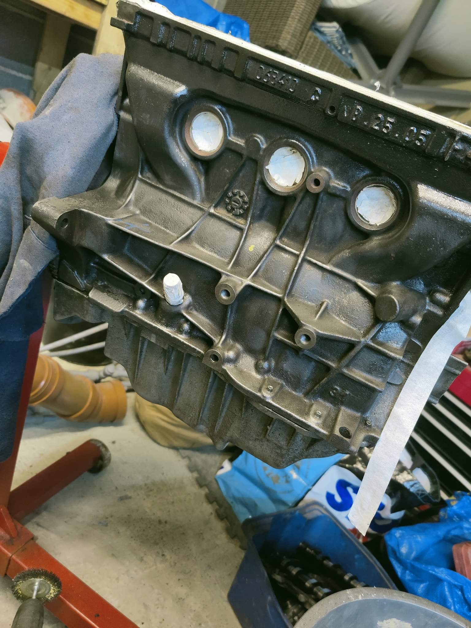

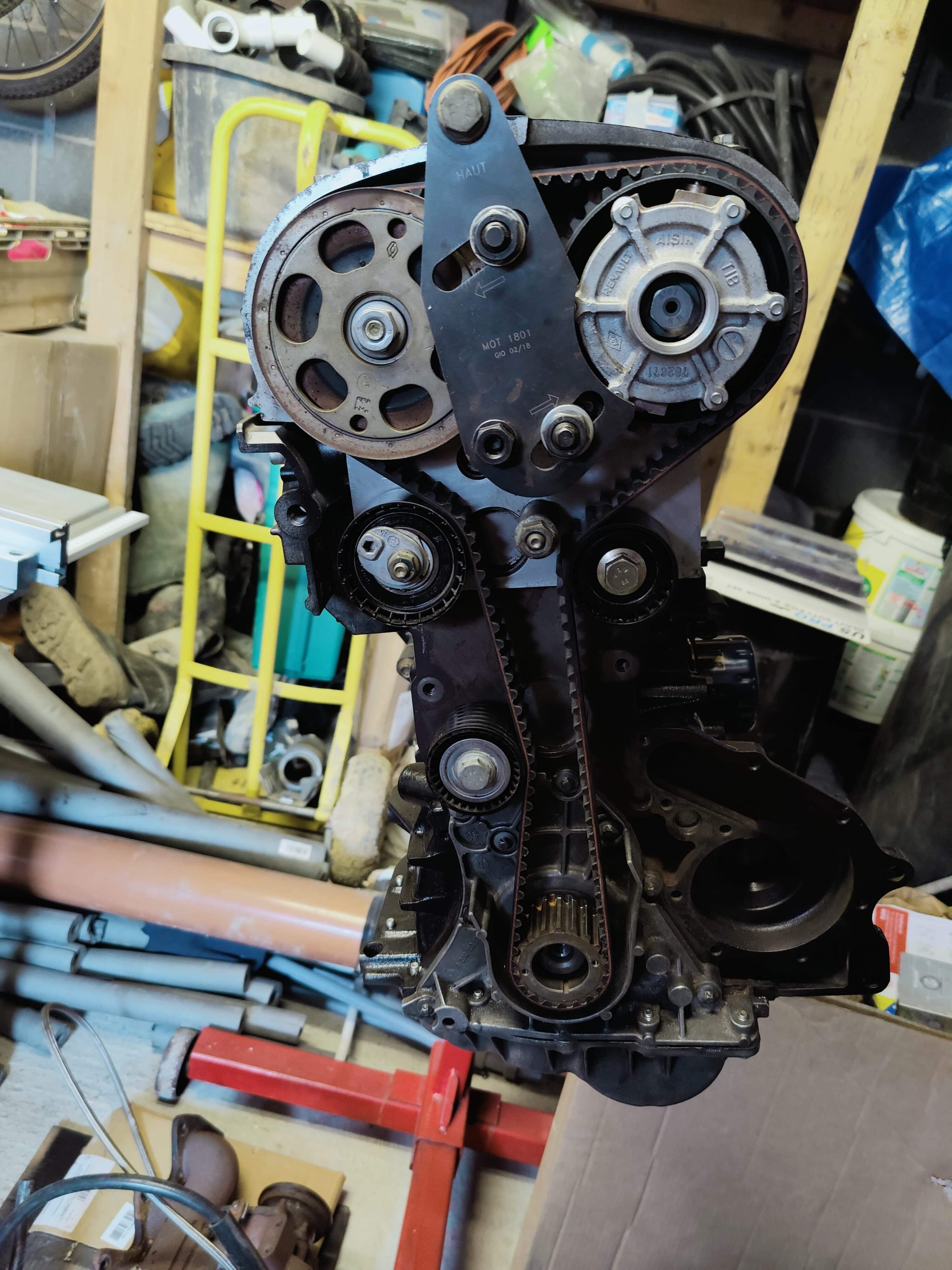

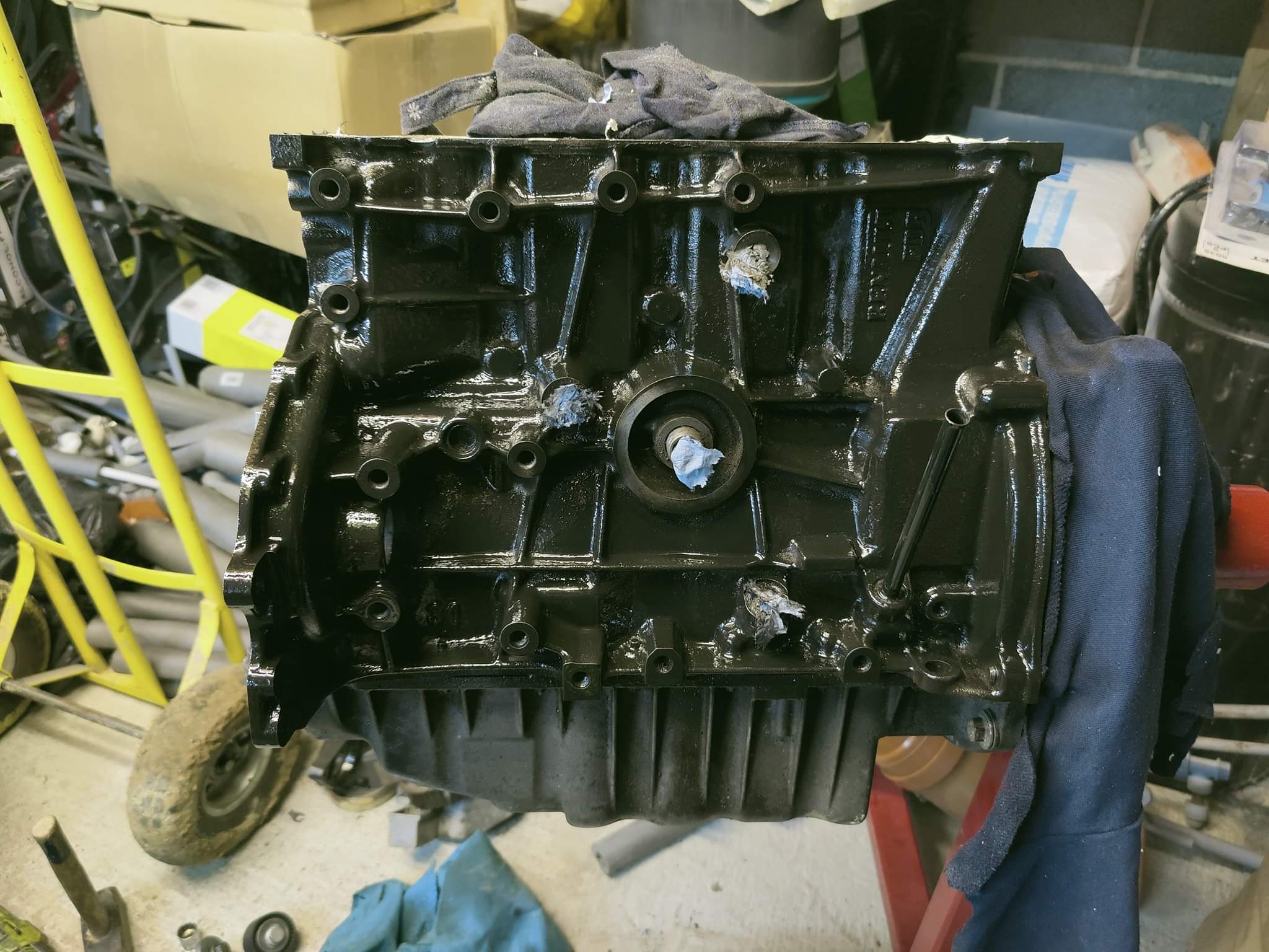

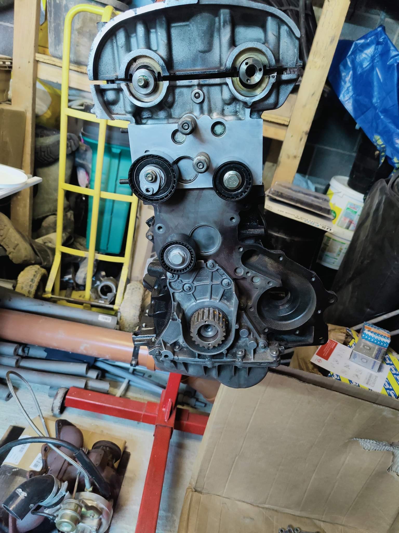

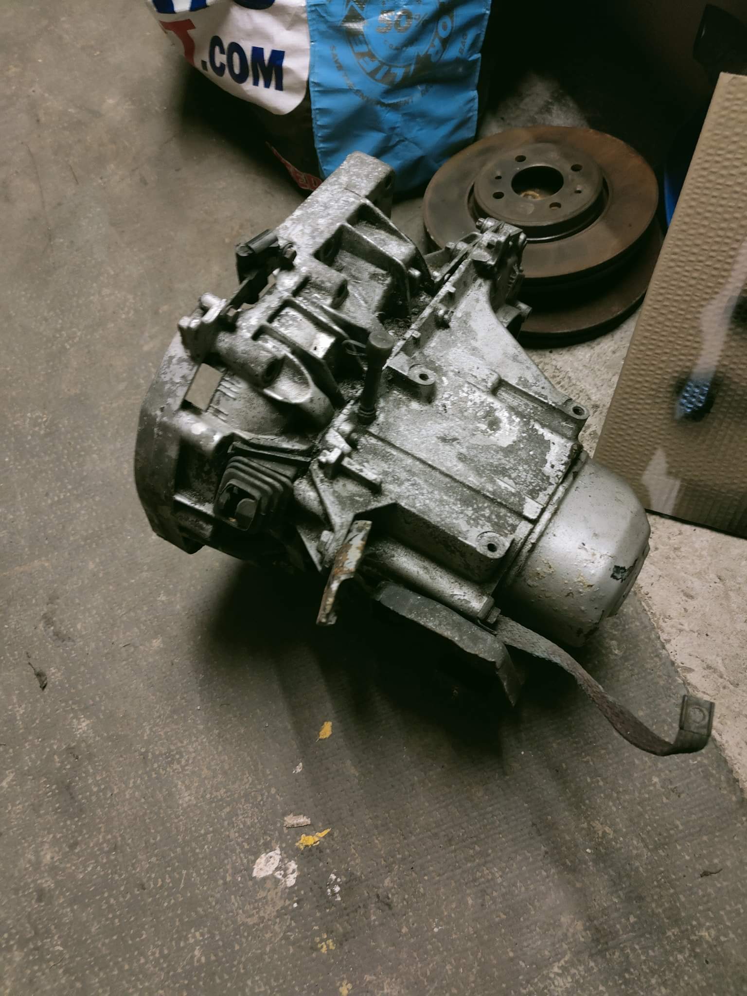

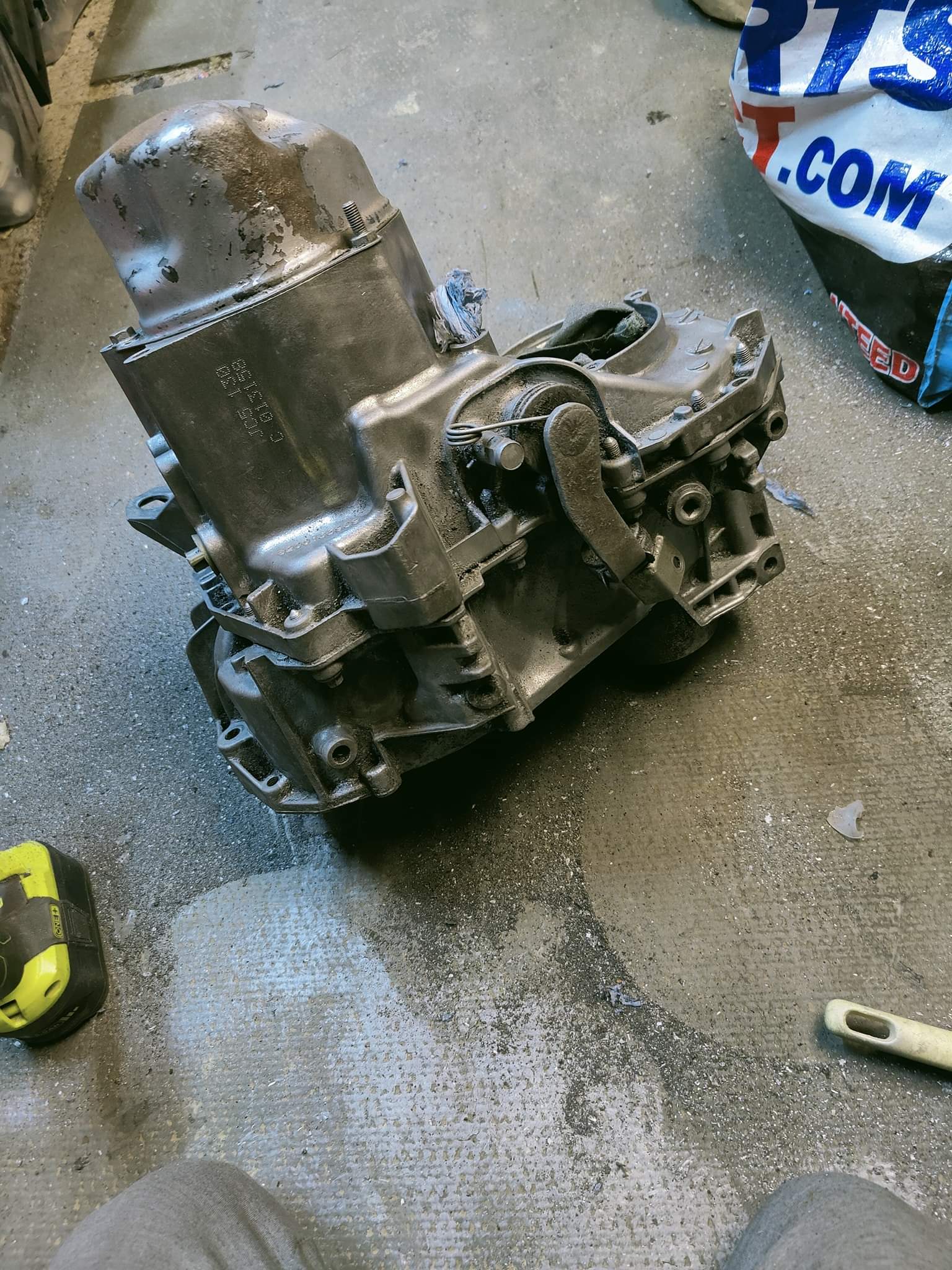

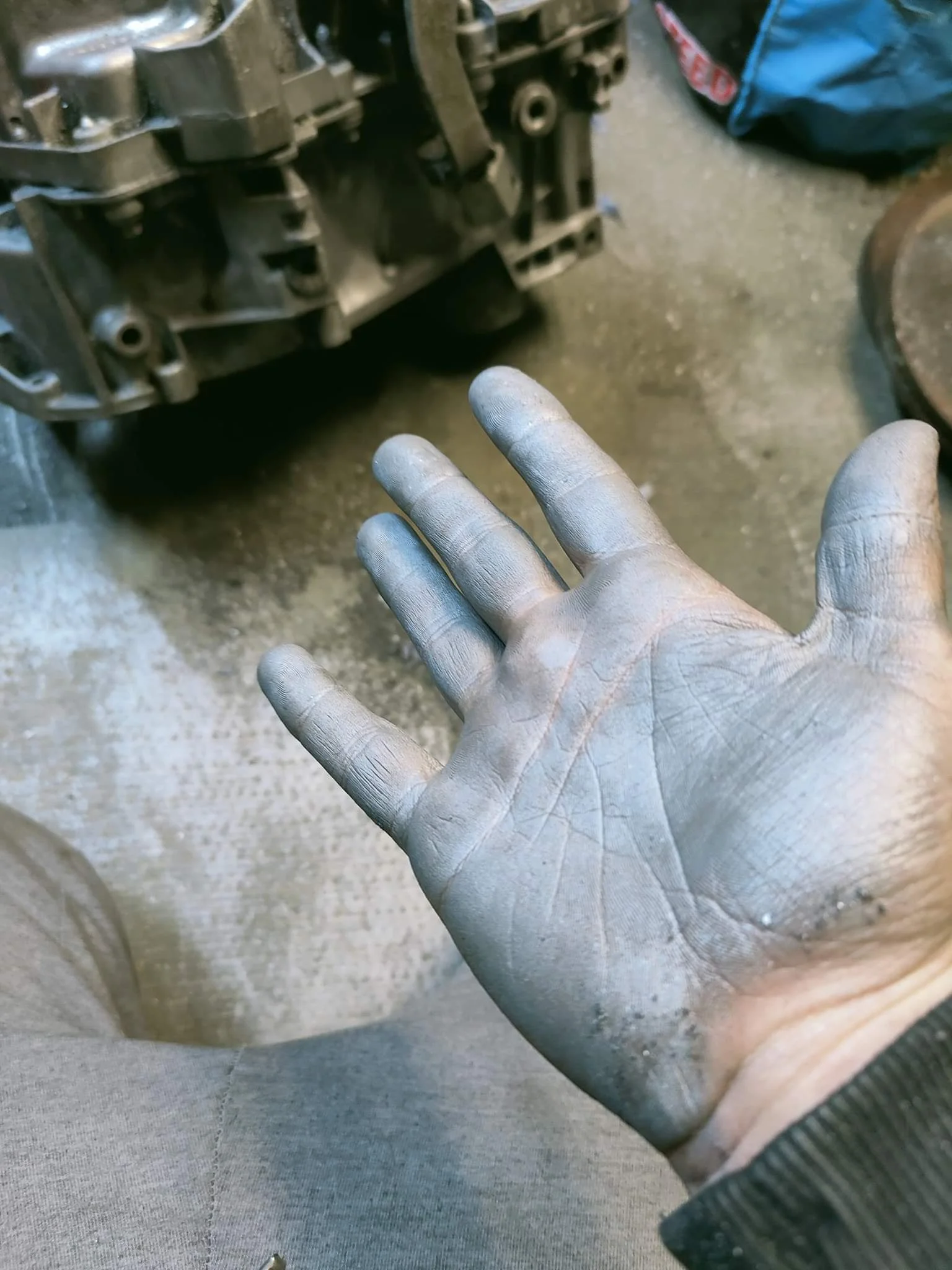

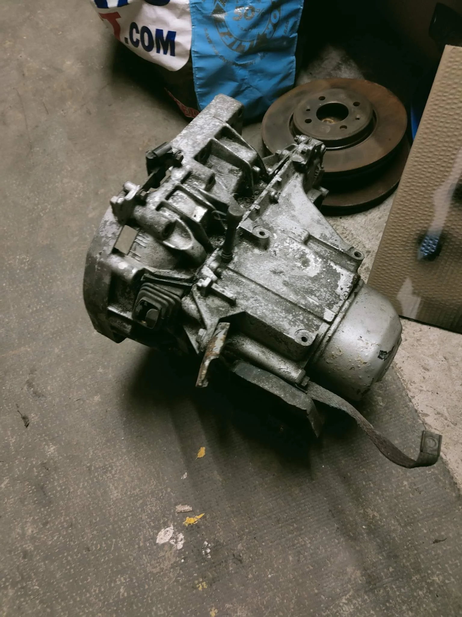

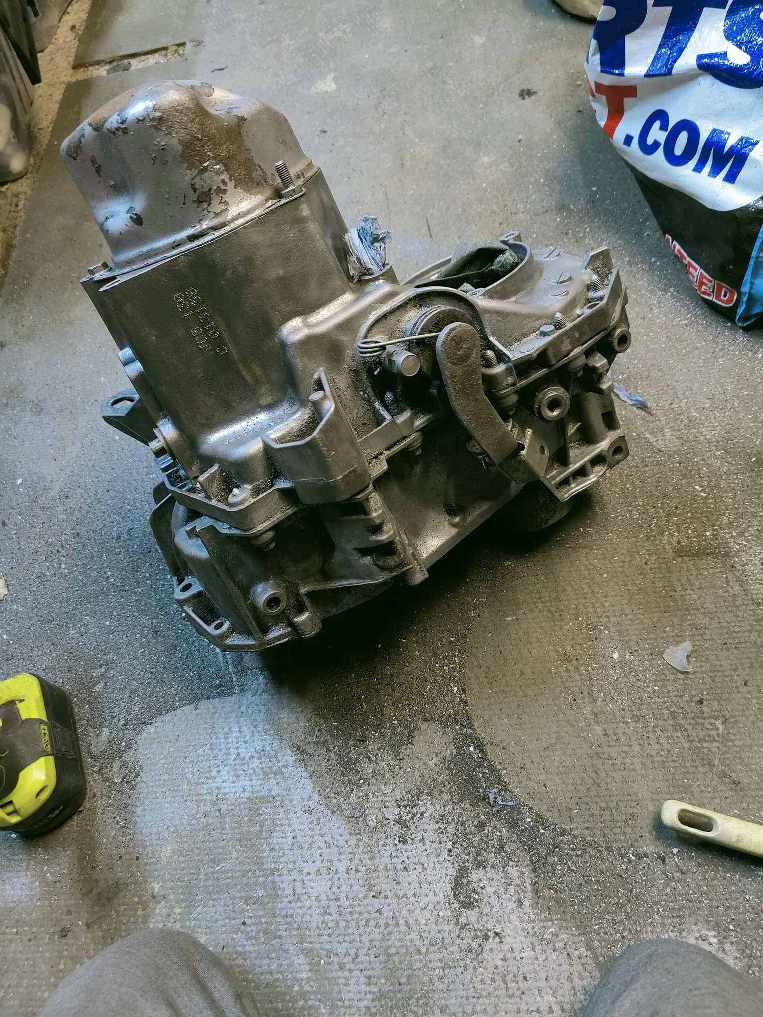

So I finally got my brother to give me a hand with this loading it onto the car back home to put onto the engine stand. Let's say, sh*t about to get sexy!

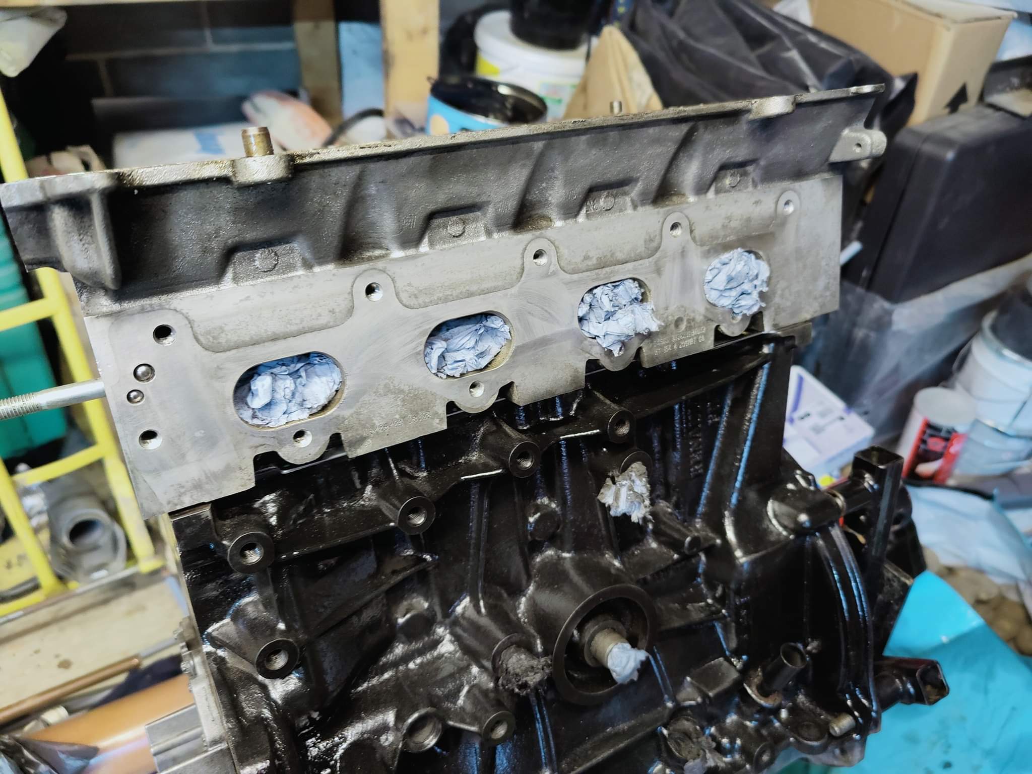

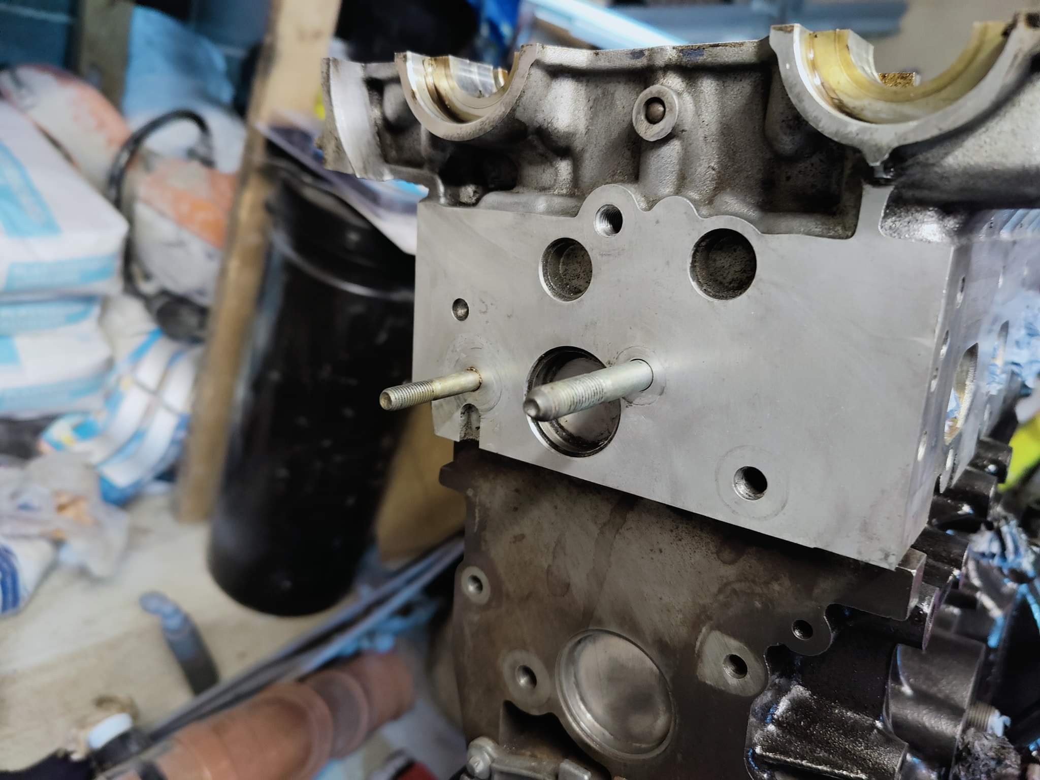

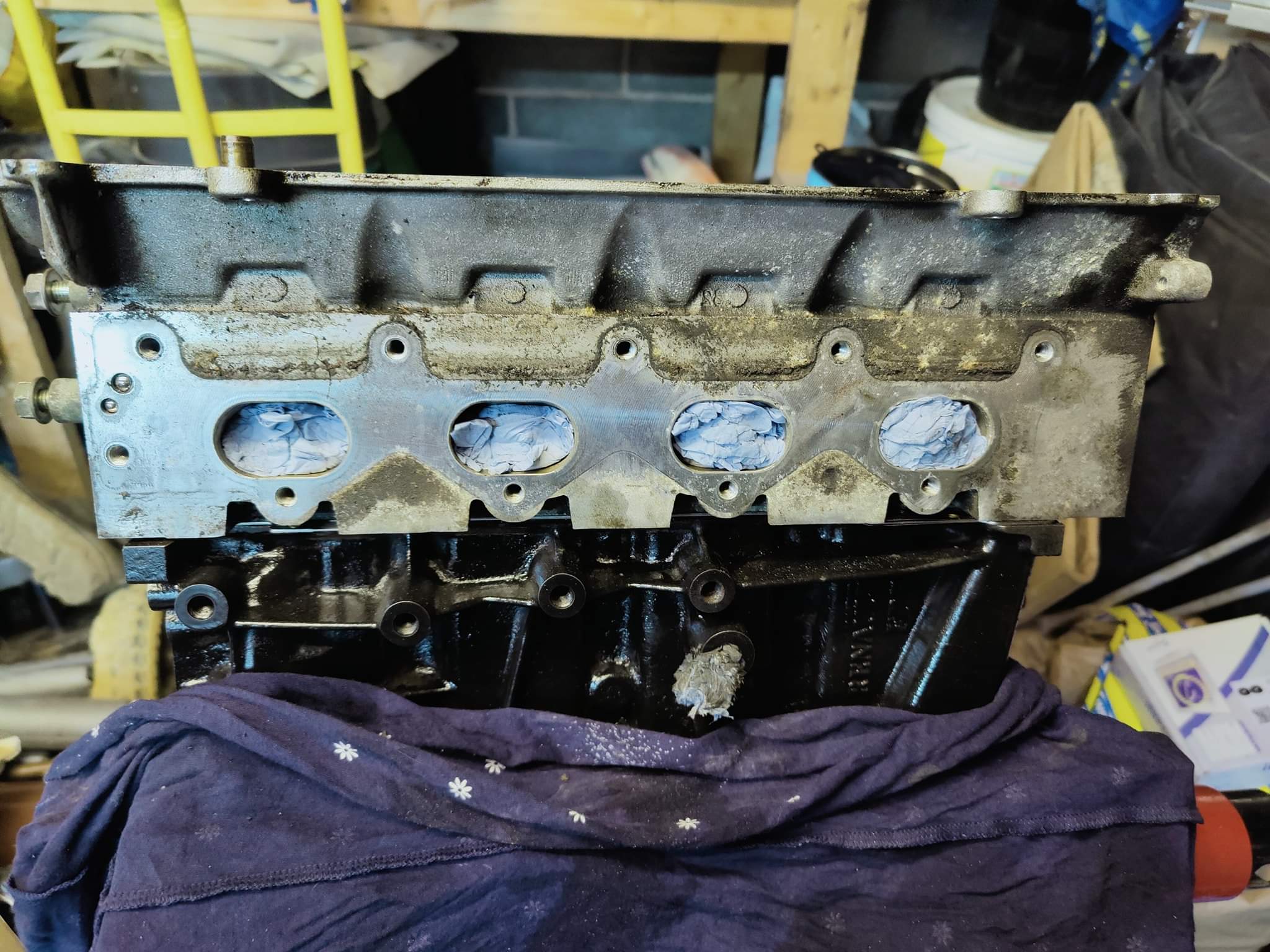

First I started by removing the head, this is my far the tightest nut I ever have met to date... Even my impact gun couldn't do it. I'm still shocked it didn't snap when the previous person did it up lol xD it took some work.
Locking tools in I finally managed to crack it off! So I started with removing the head and cleaning the main block up.
SKINTasPER
  Clio 182/MK4 GT 120

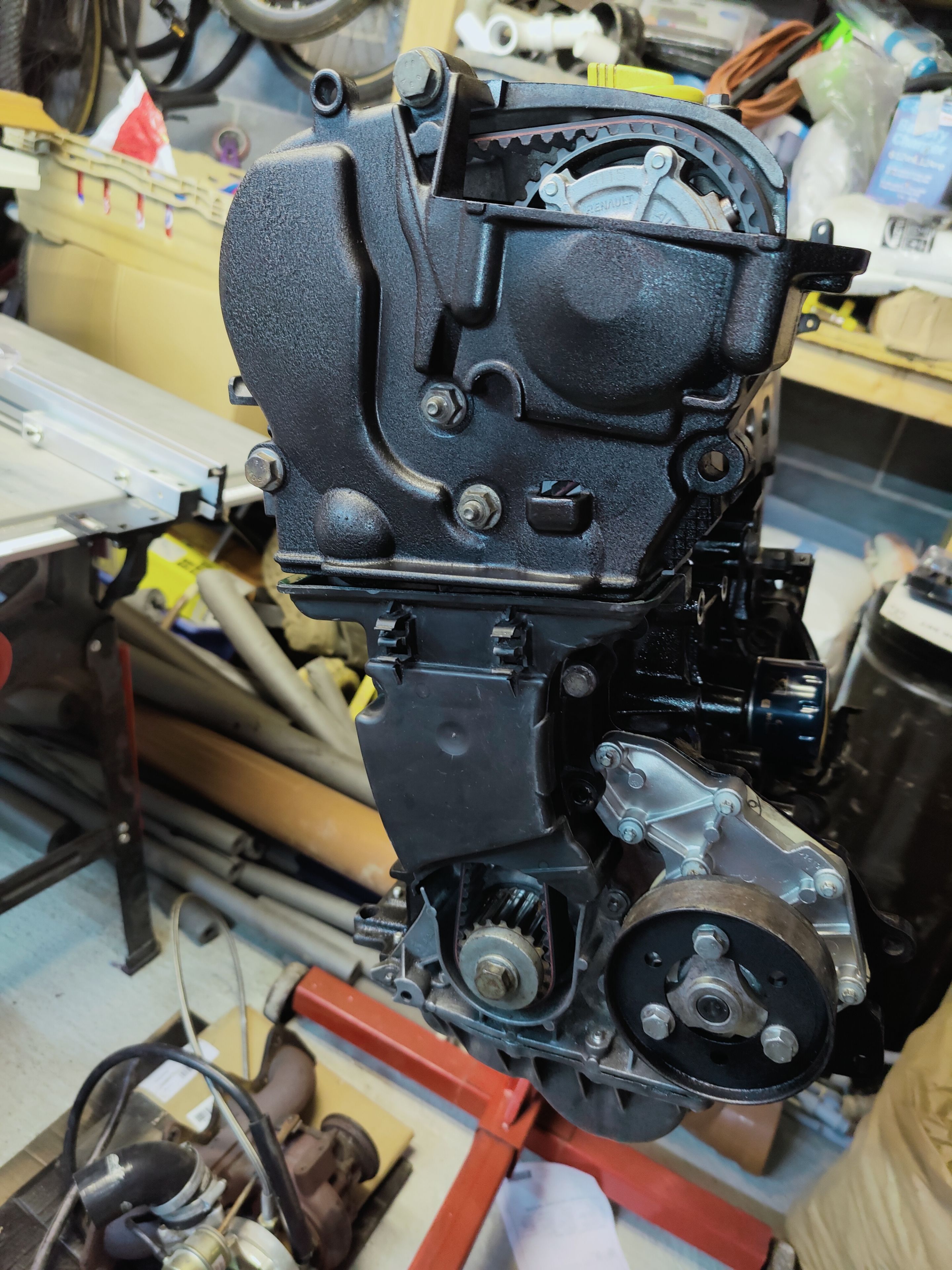

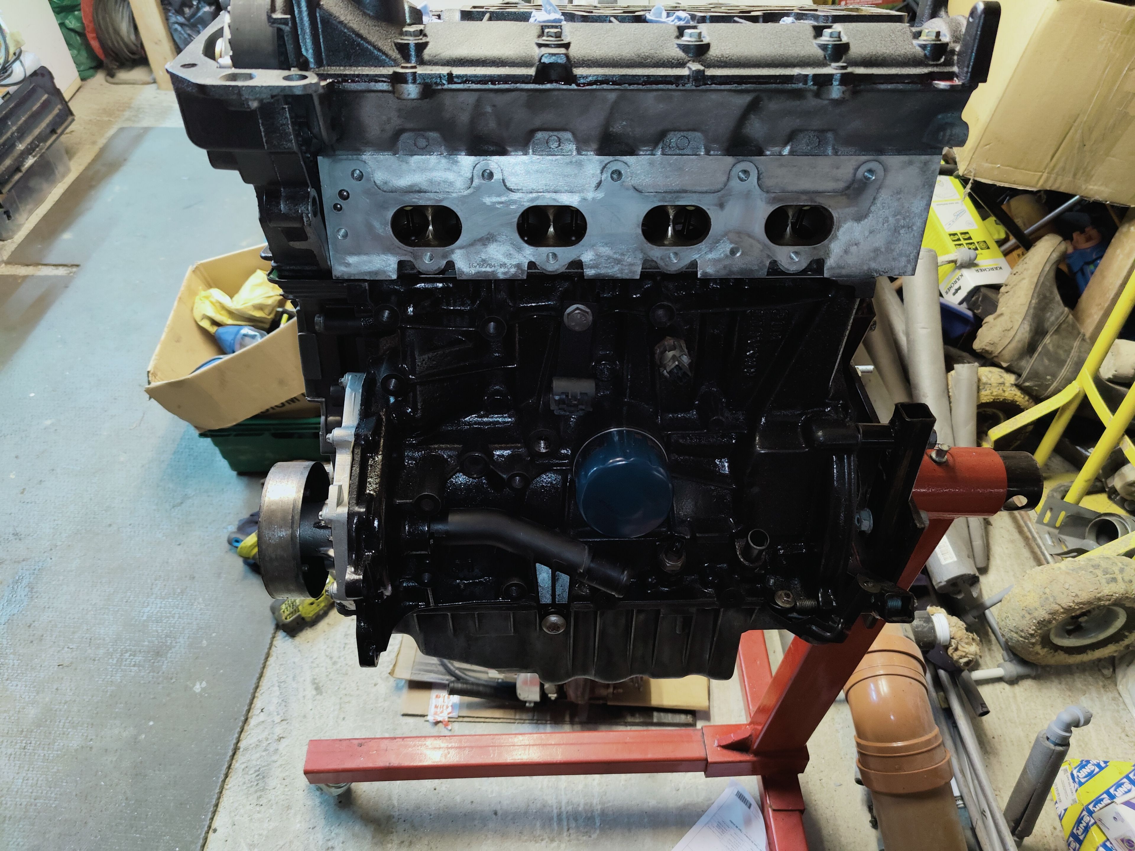

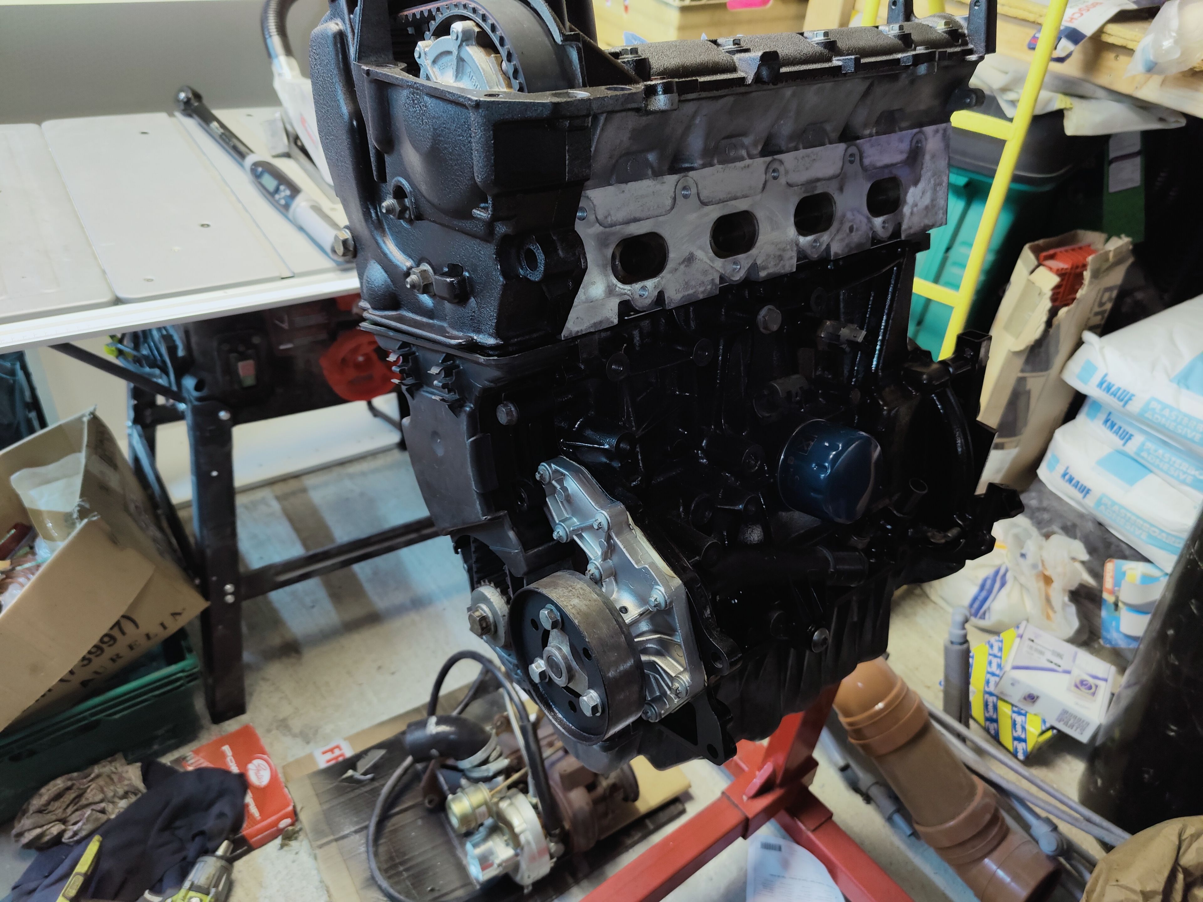

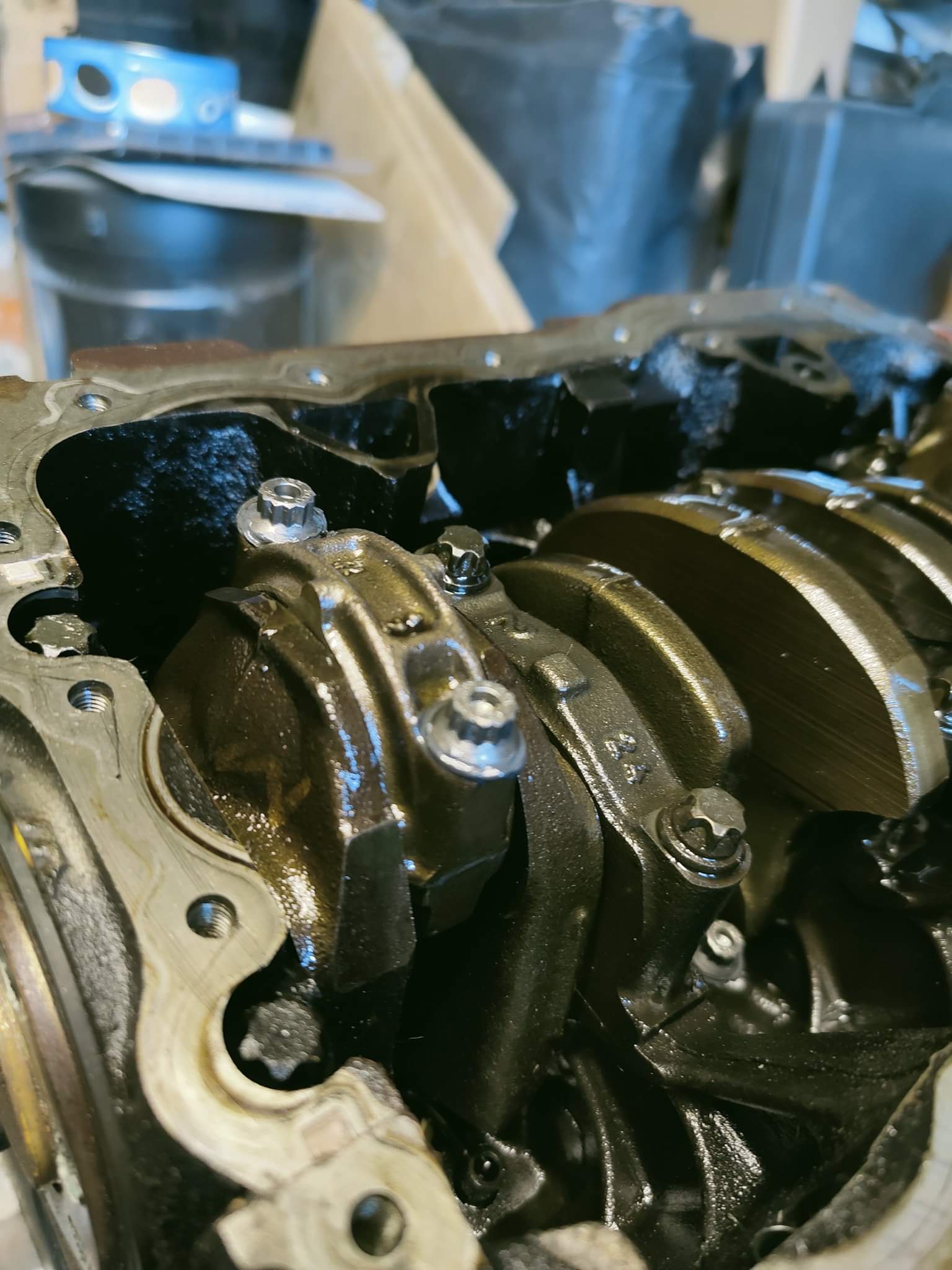

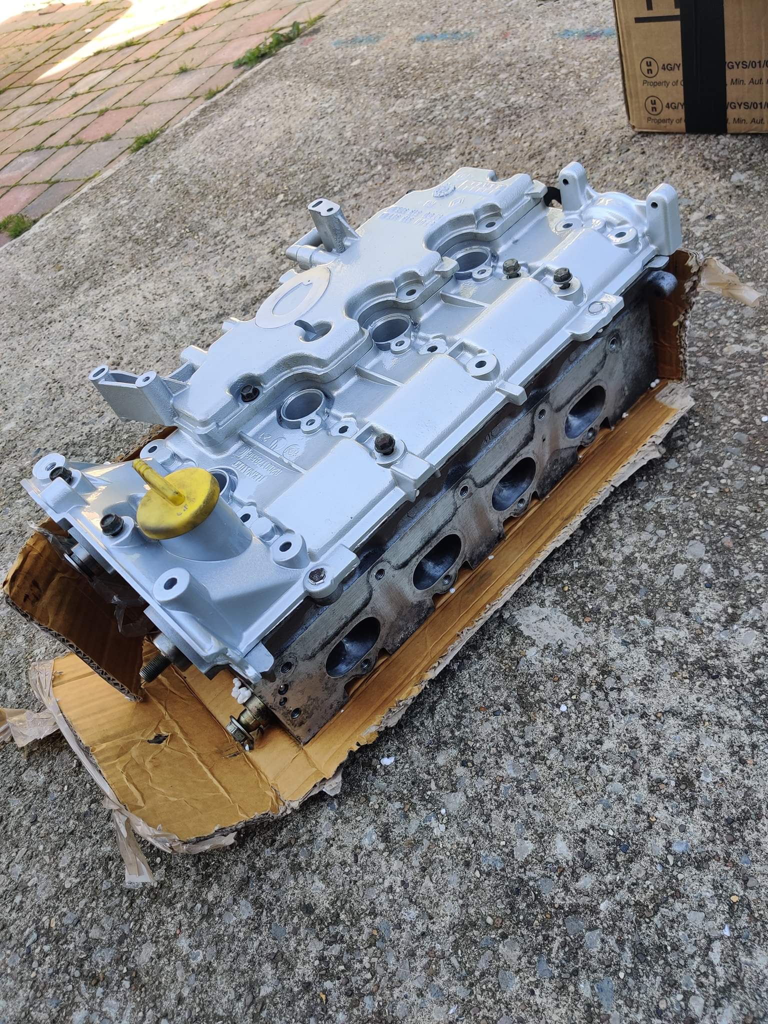

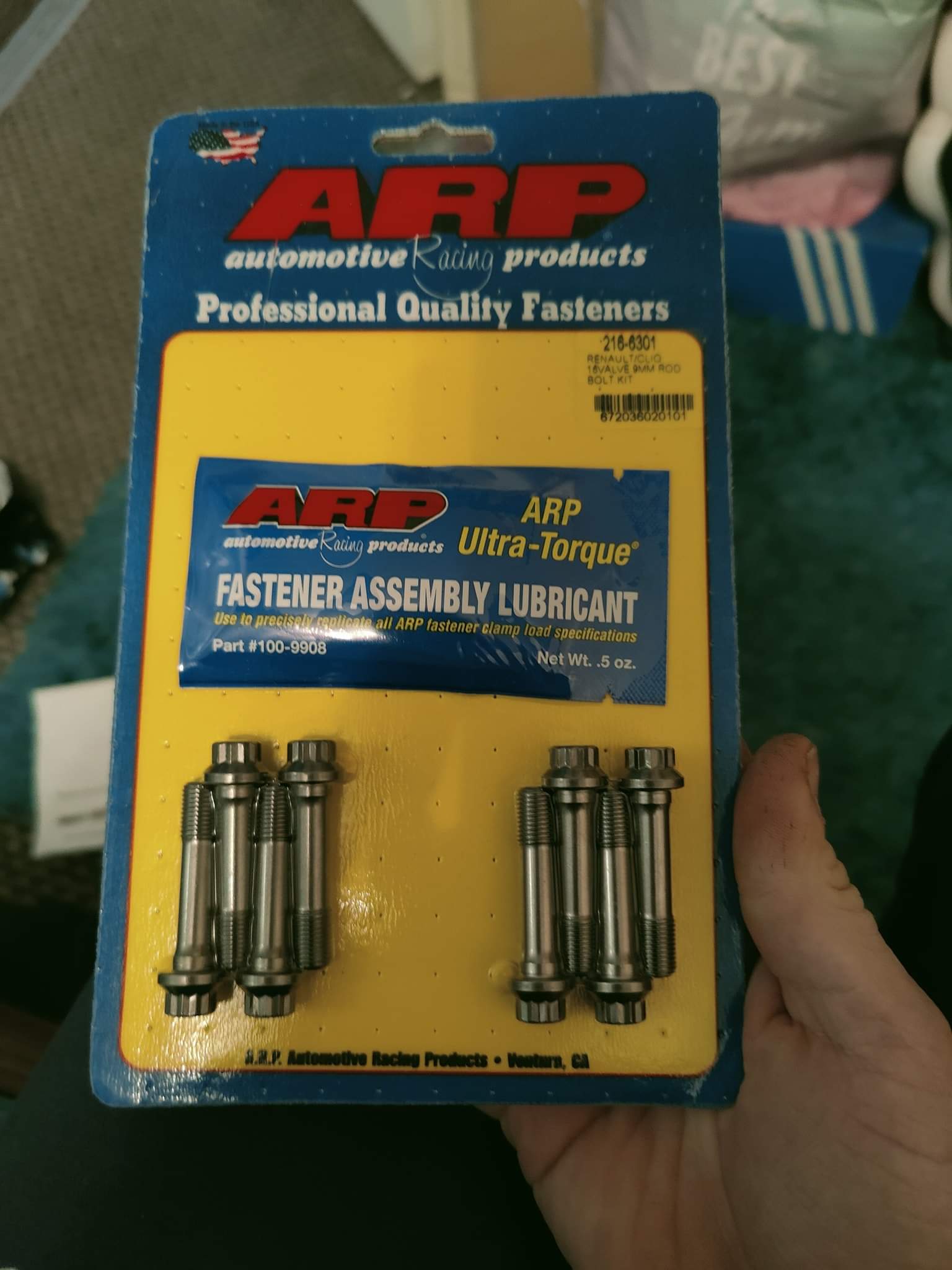

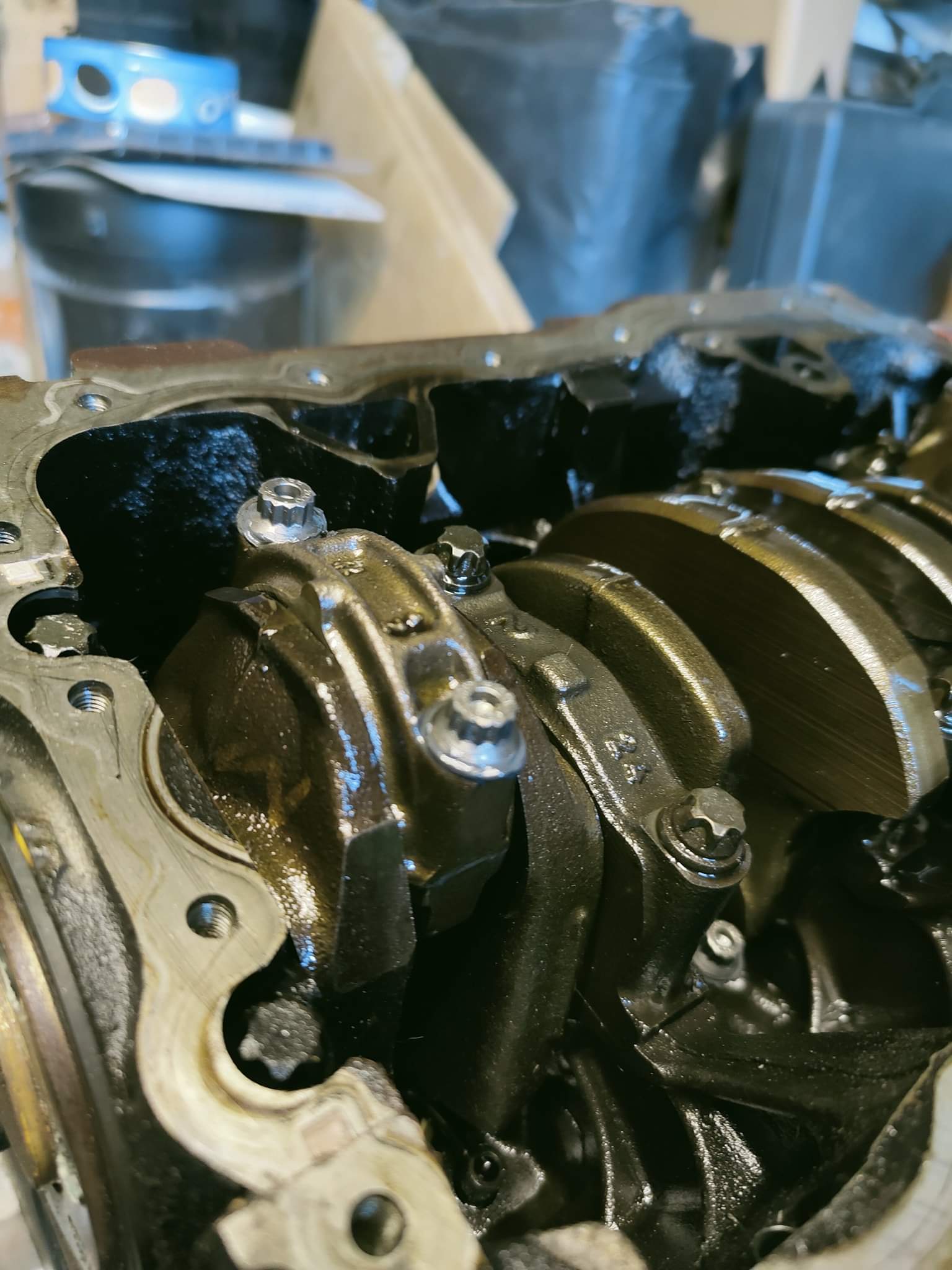

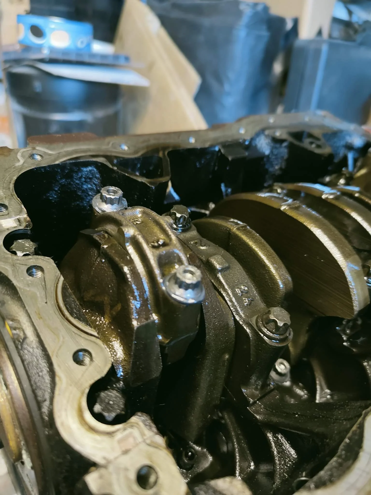

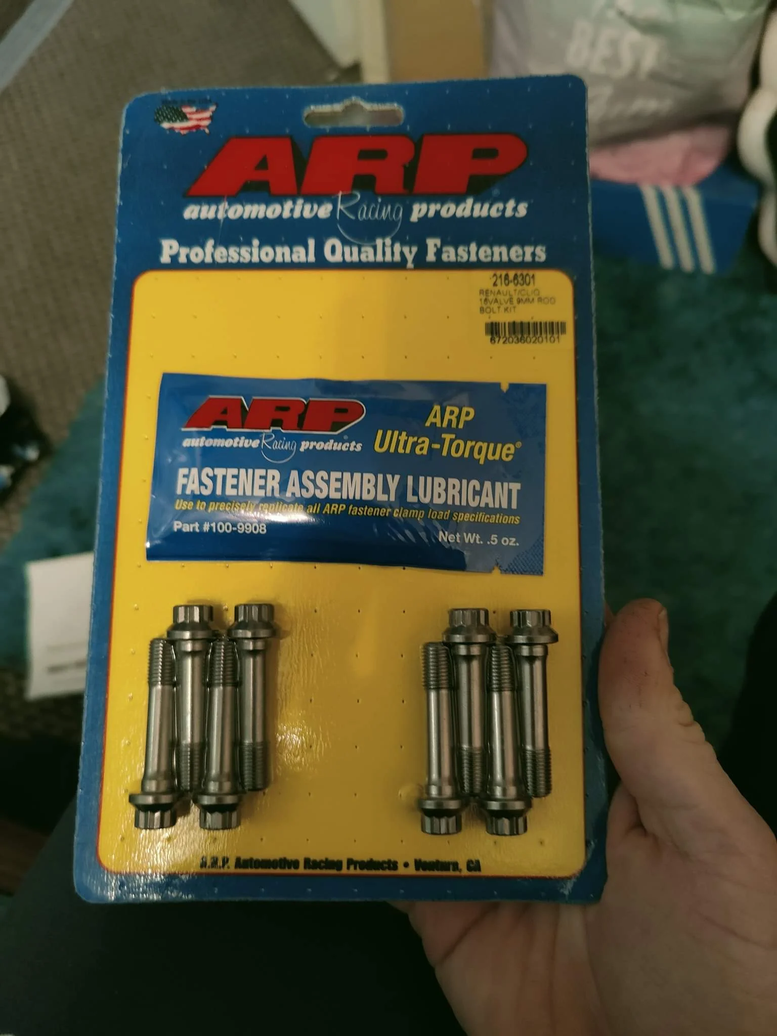

After the block was painted I moved onto the bottom end and fitted the ARP Rod bolts which I had to buy again due to being sold the wrong ones.

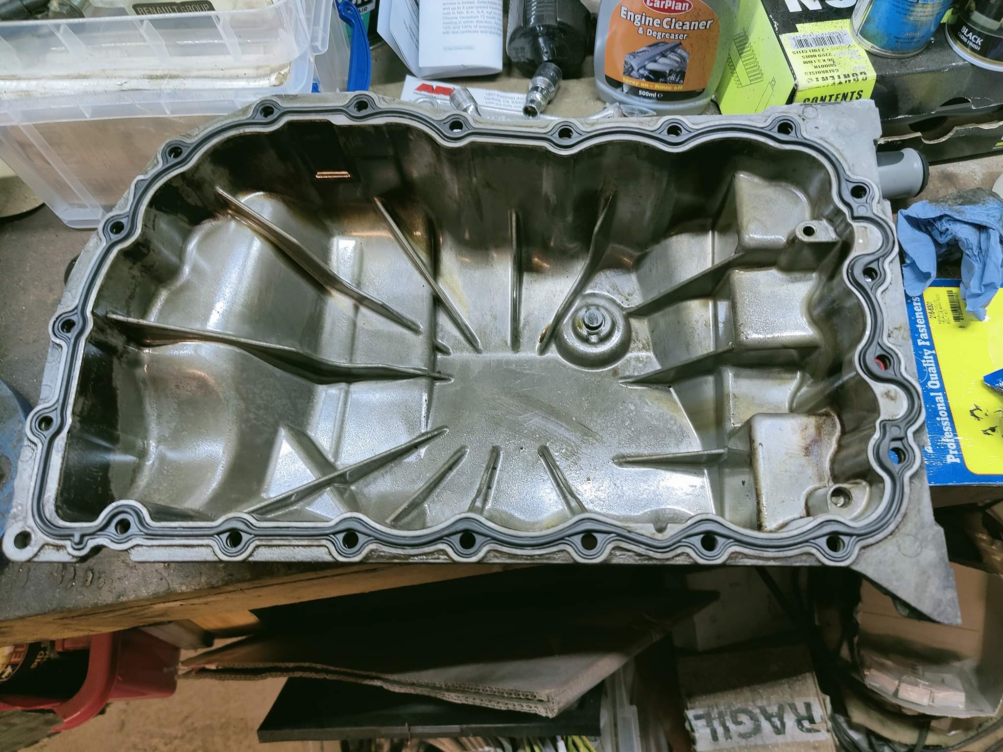

Sump back on with fresh gasket and got rid of the awful torx head bolts
Back to the head, got a Megane MLS head gasket fitted also photos must be on my other phone!

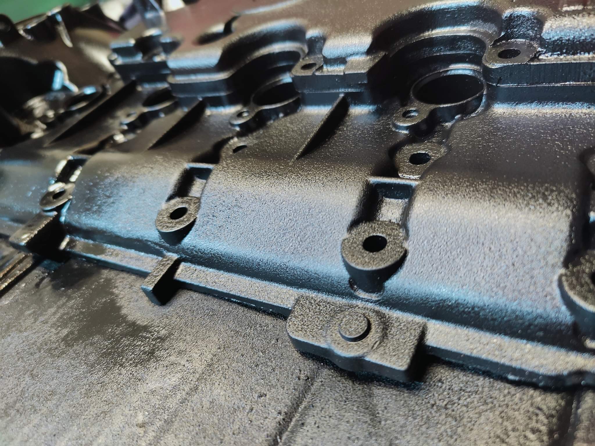

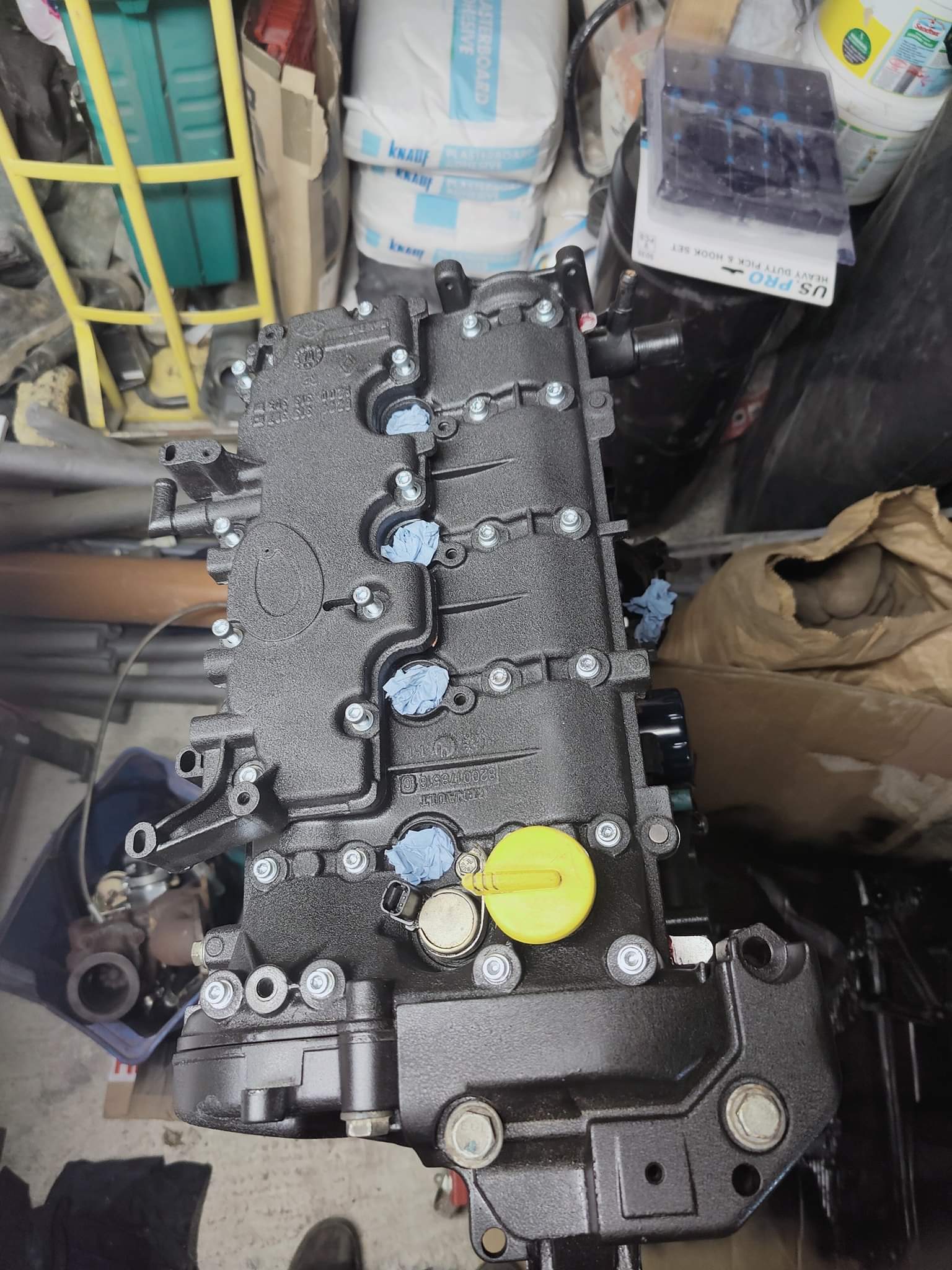

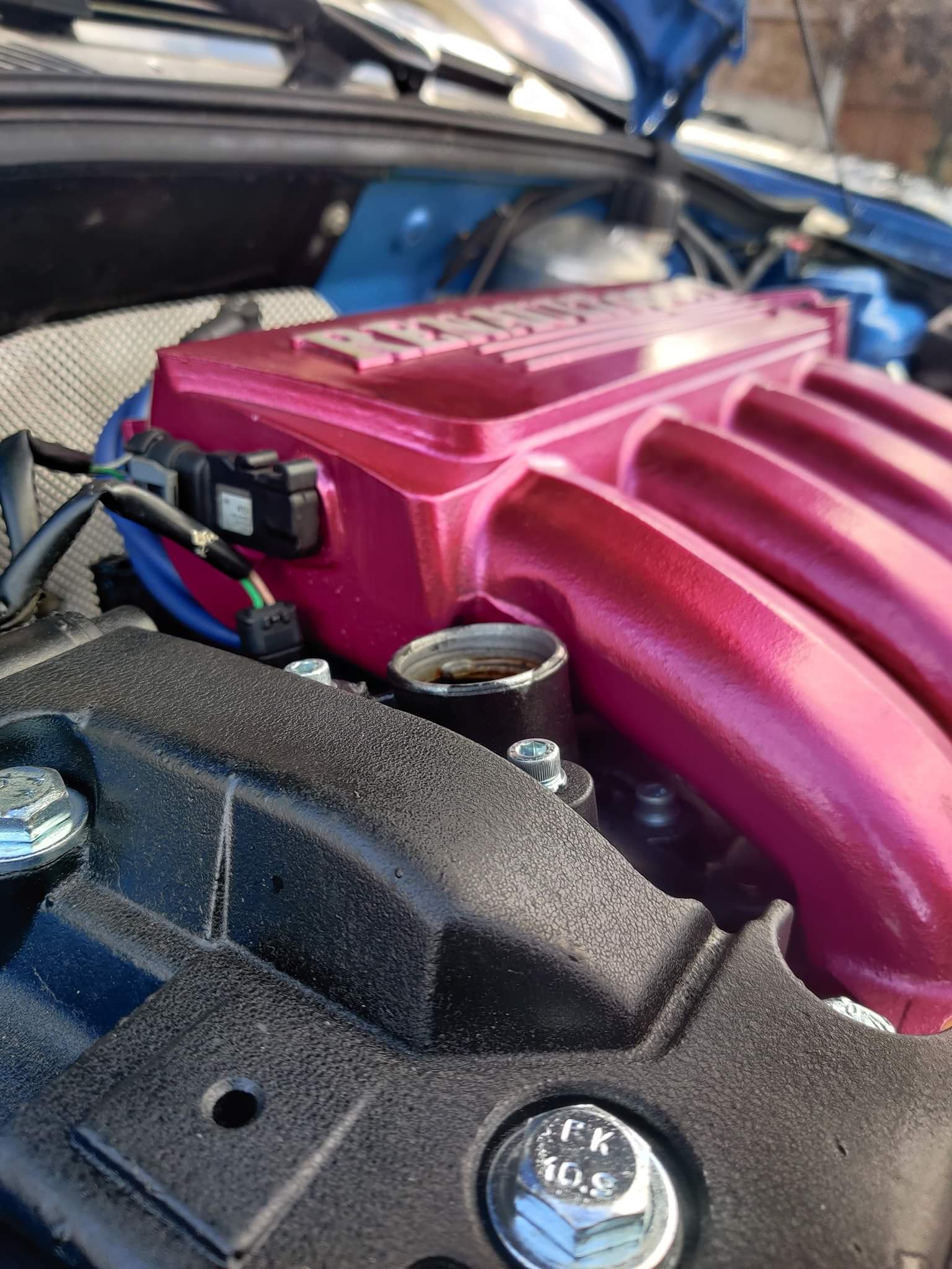

Then I did the cam cover in some gorgeous Wrinkle/crackle paint! Which really made the top of the engine. Looks amazing! Really happy how it turned out, just look at it!!
Ktec cam cover bolt kit finished it off nicely!
SKINTasPER
  Clio 182/MK4 GT 120
Finally it was completed with fresh belts, water pump, oil filter.

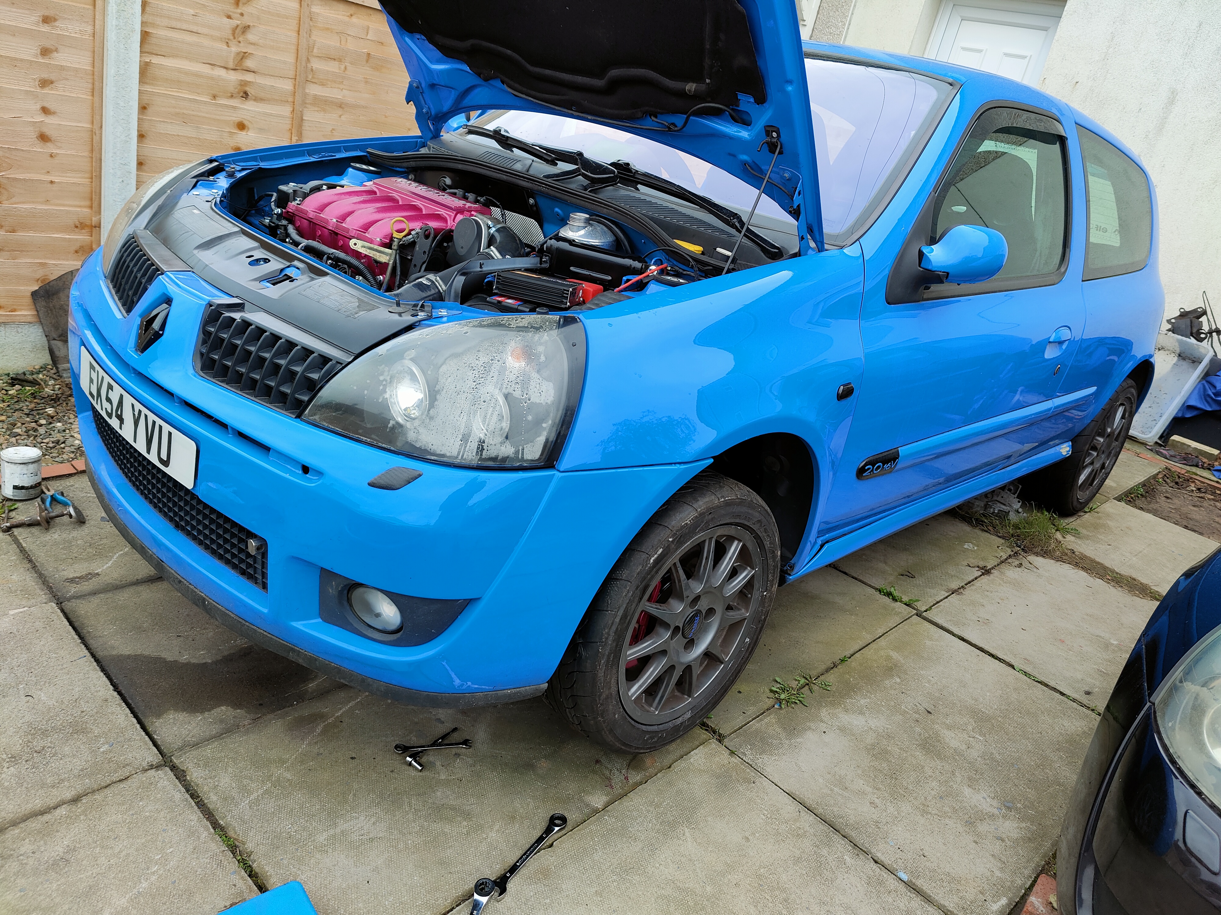

Old rad was swapped for an alloy one I had and were almost done! I did start it up the other day and I started first time! Sprug straight back into life and I'm more excited to drive it than I was before now.

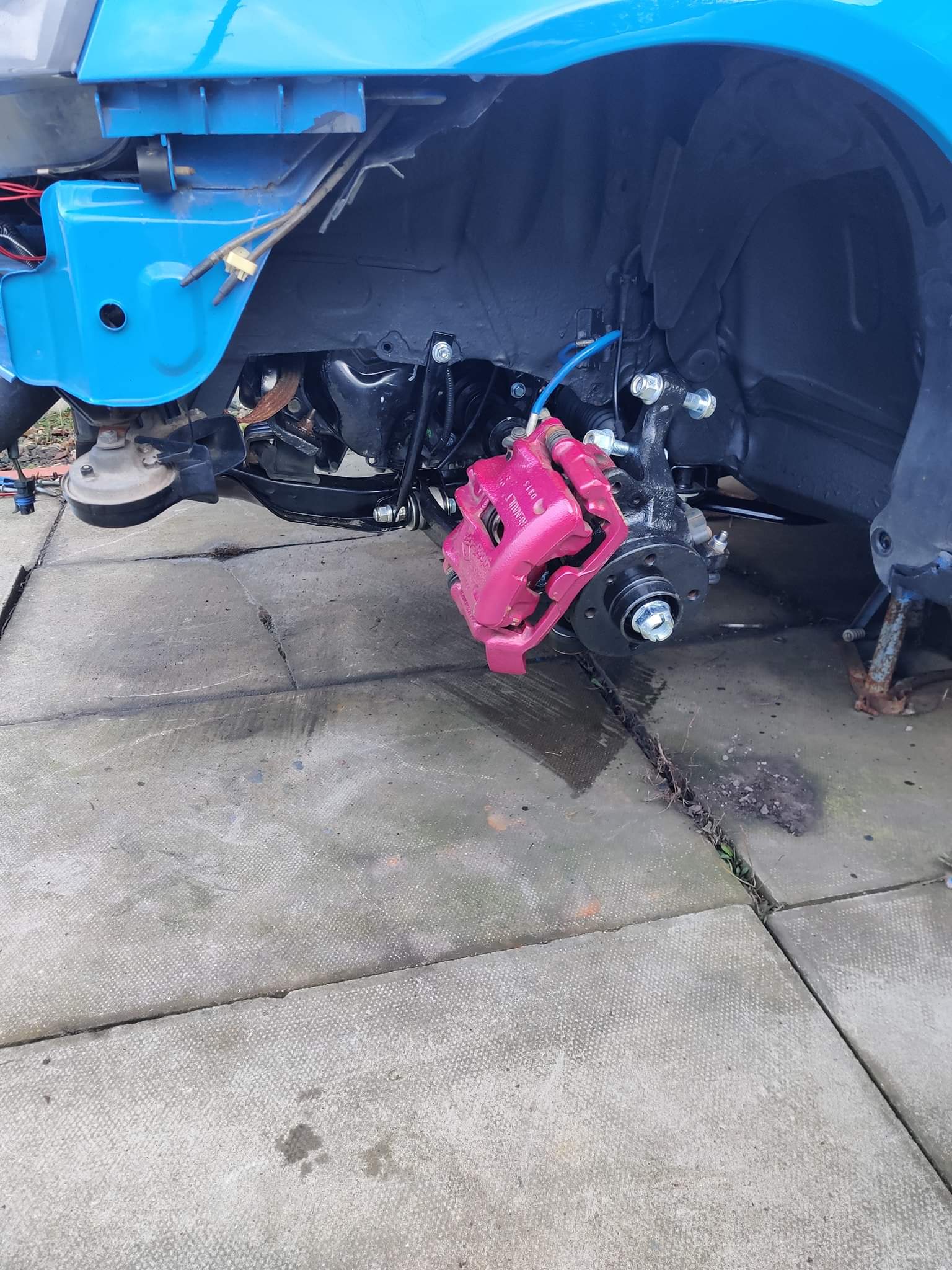

Fit front brakes
Fit the last couple of intercooler hoses get the back tyres swapped over (other waiting to go on)

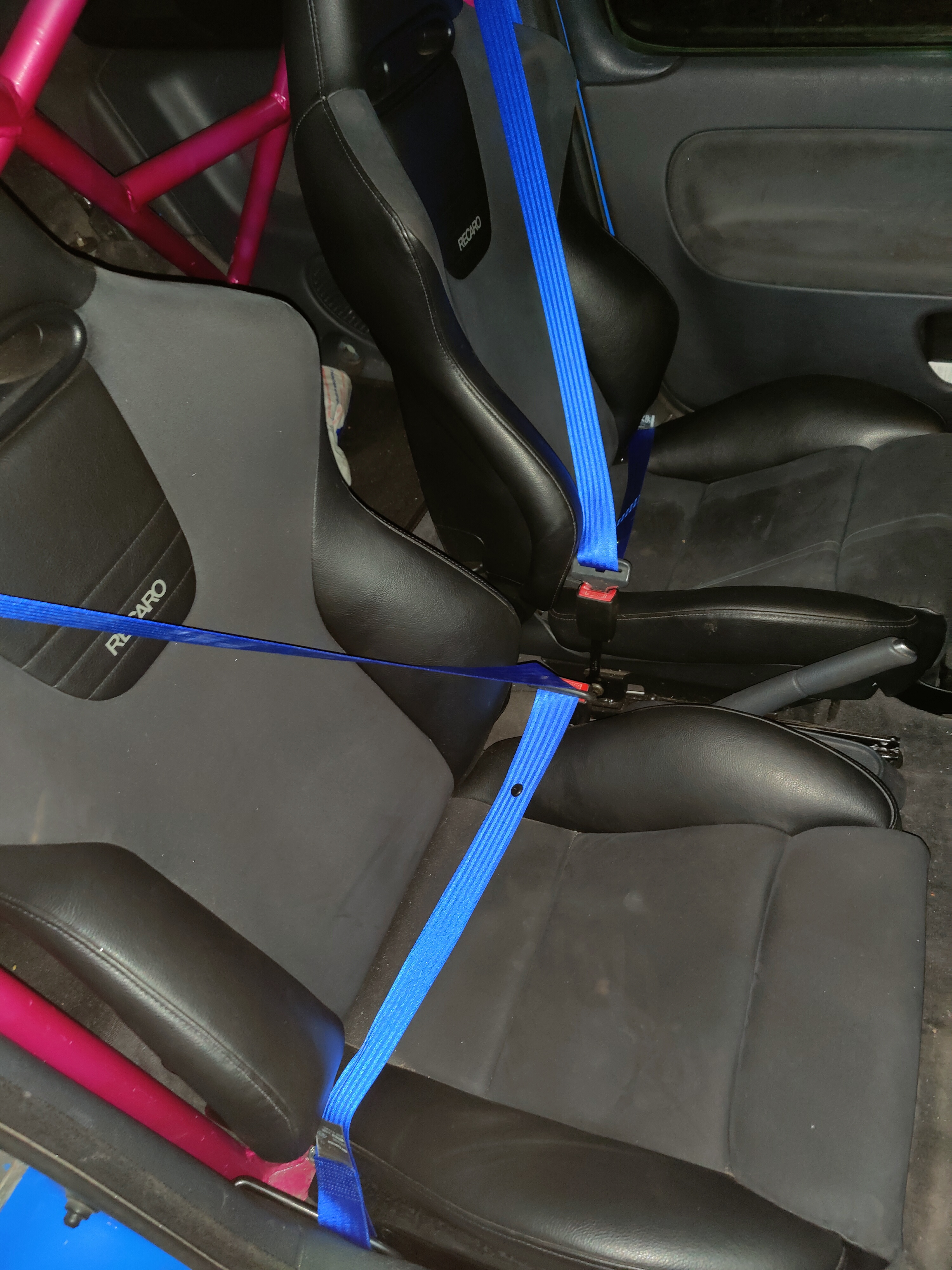

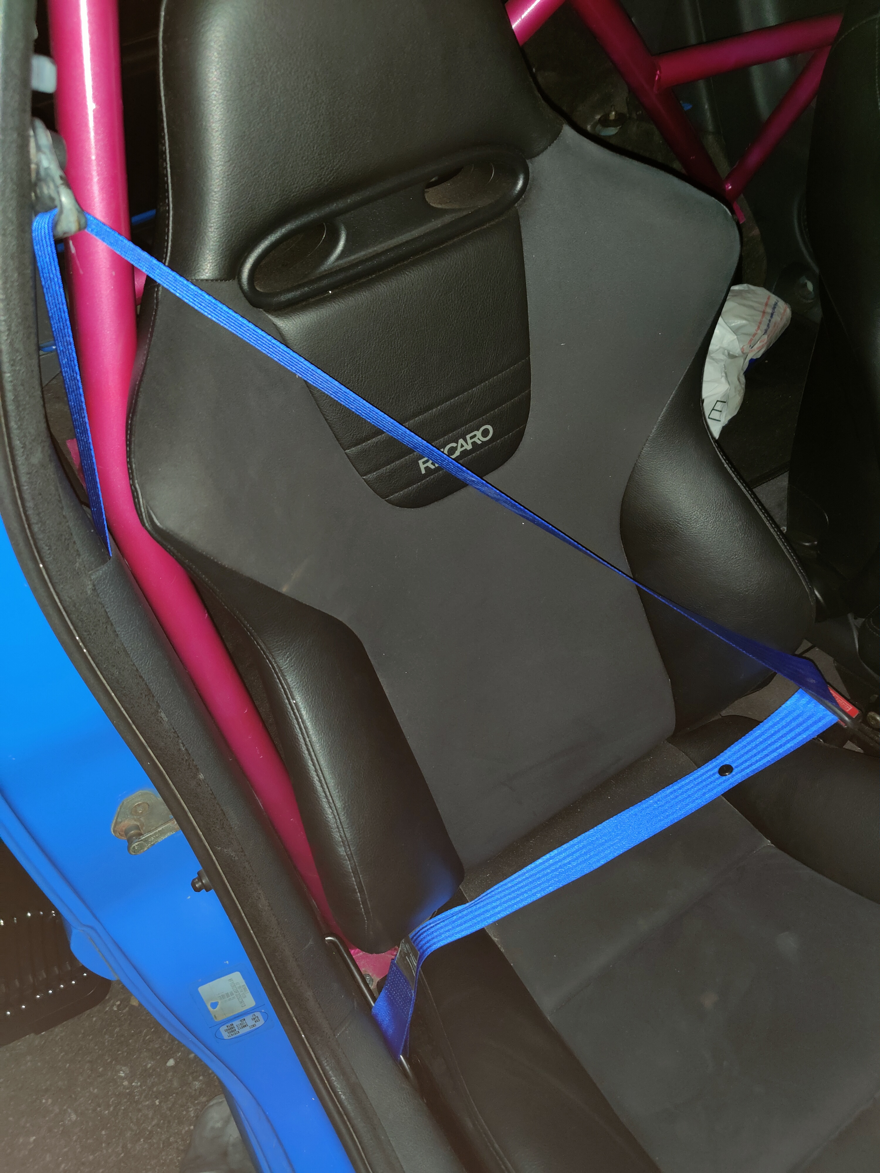

So I thought I would treat her first to some fresh nice blue seat belts, done by KolorKoncepts who are litterally on my door step! There was 2 shades of blue what were close, the other was quite a light blue and although it was nice I opted for this shade as I thought the others would of got dirty real fast.

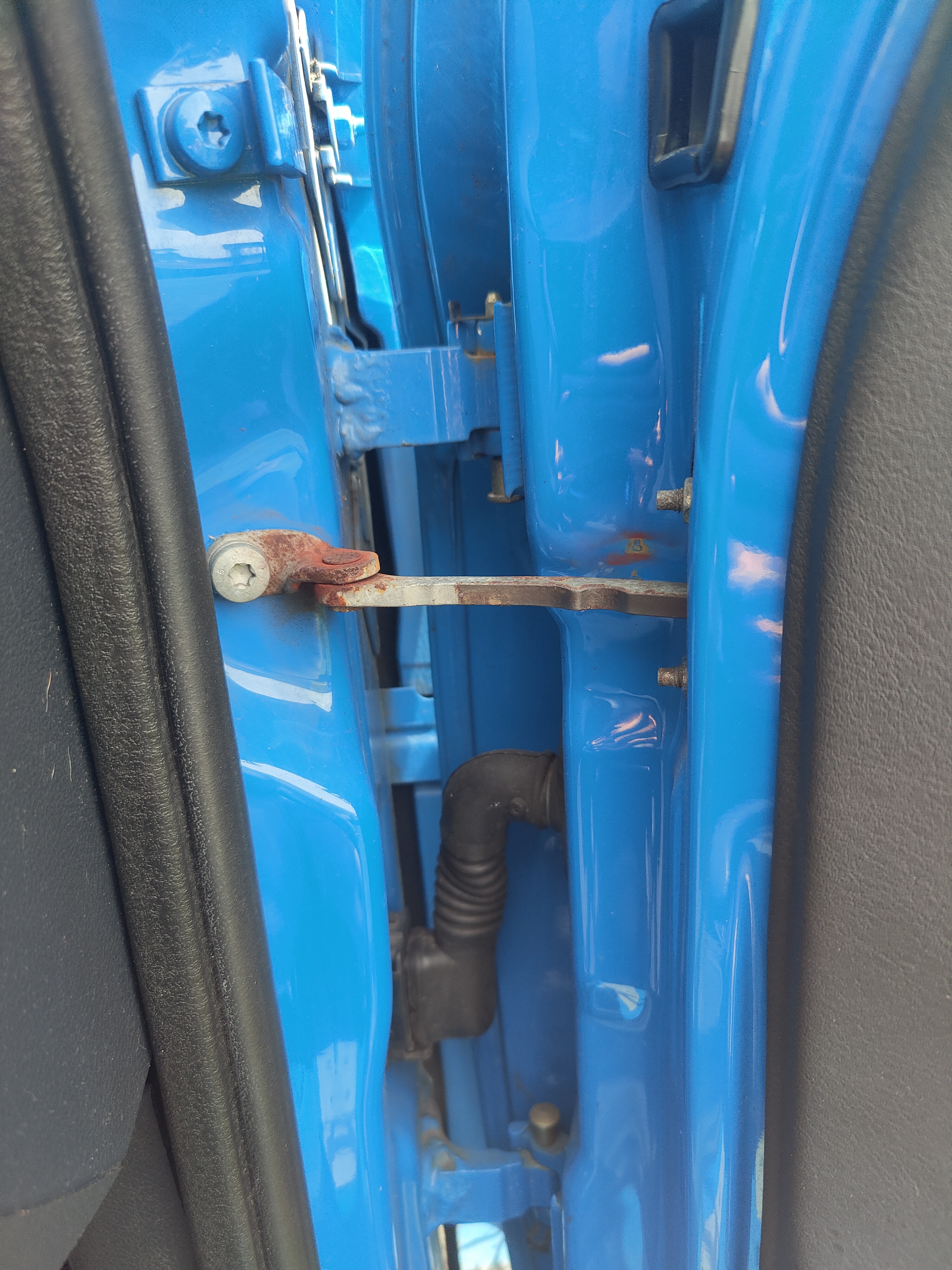

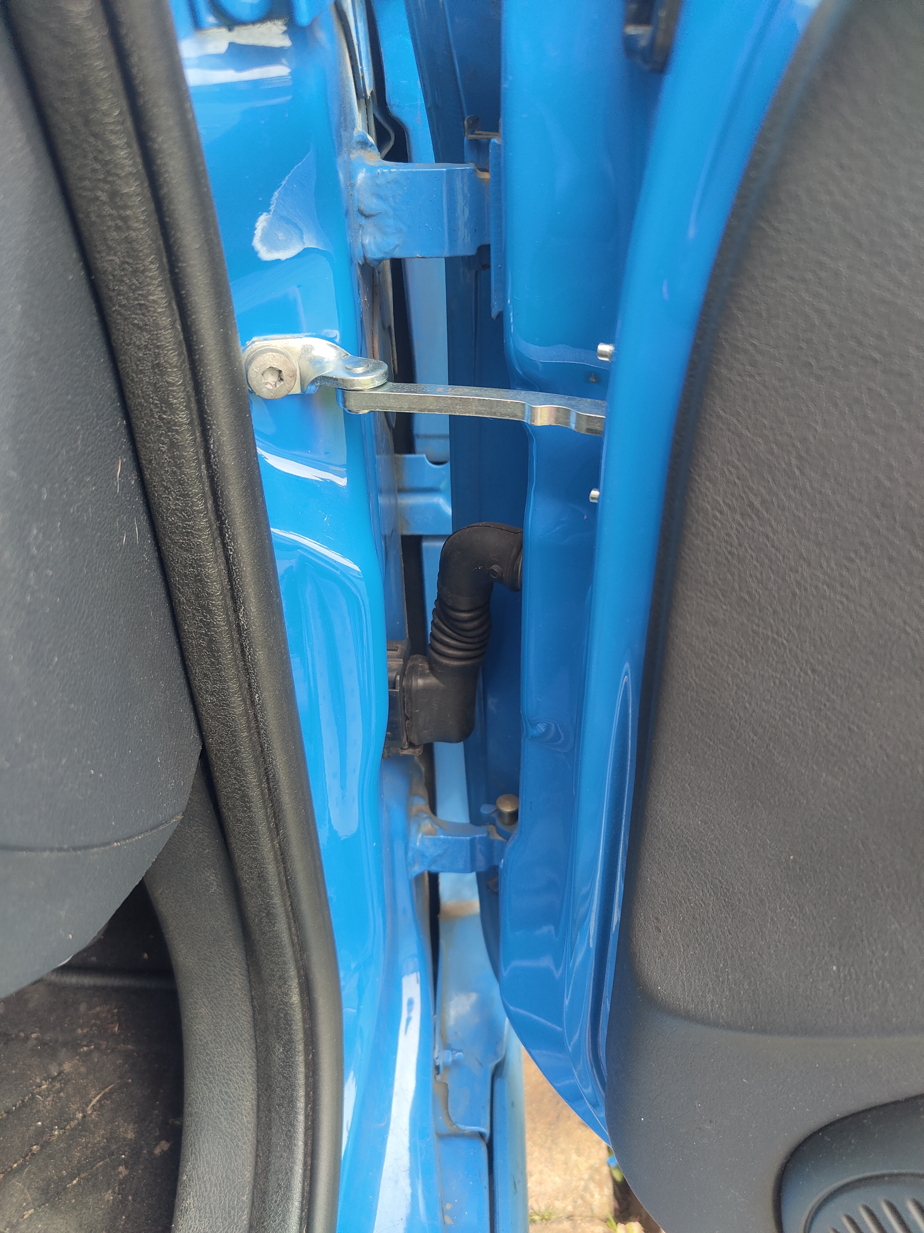

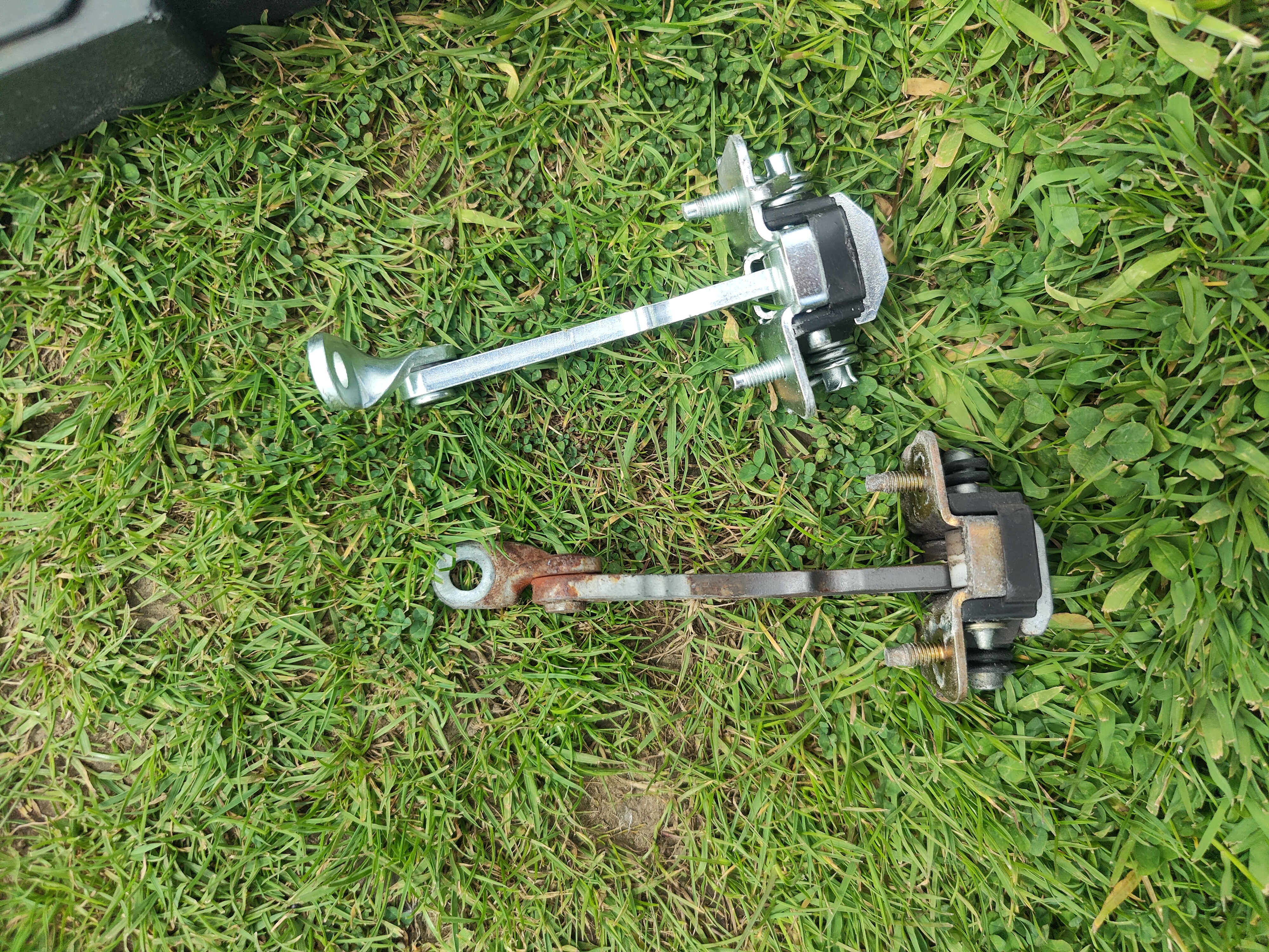

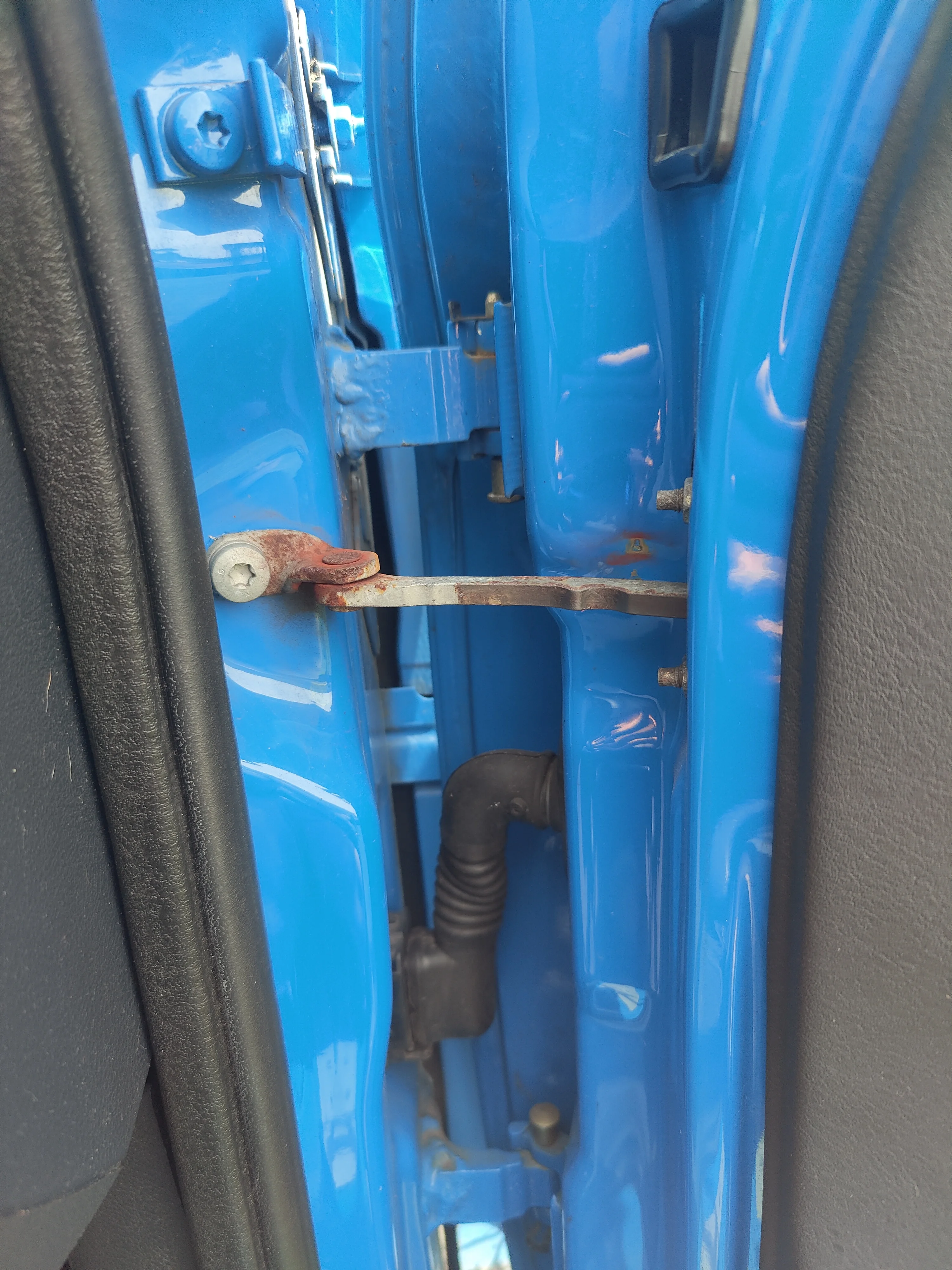

My next job was to replace these horrible check straps which have been bothering me for so long. Rust be gon! How much better does that look now?!
First Full proper valet inside and out she's ever had, lucky for her she will be getting way more now 🤣

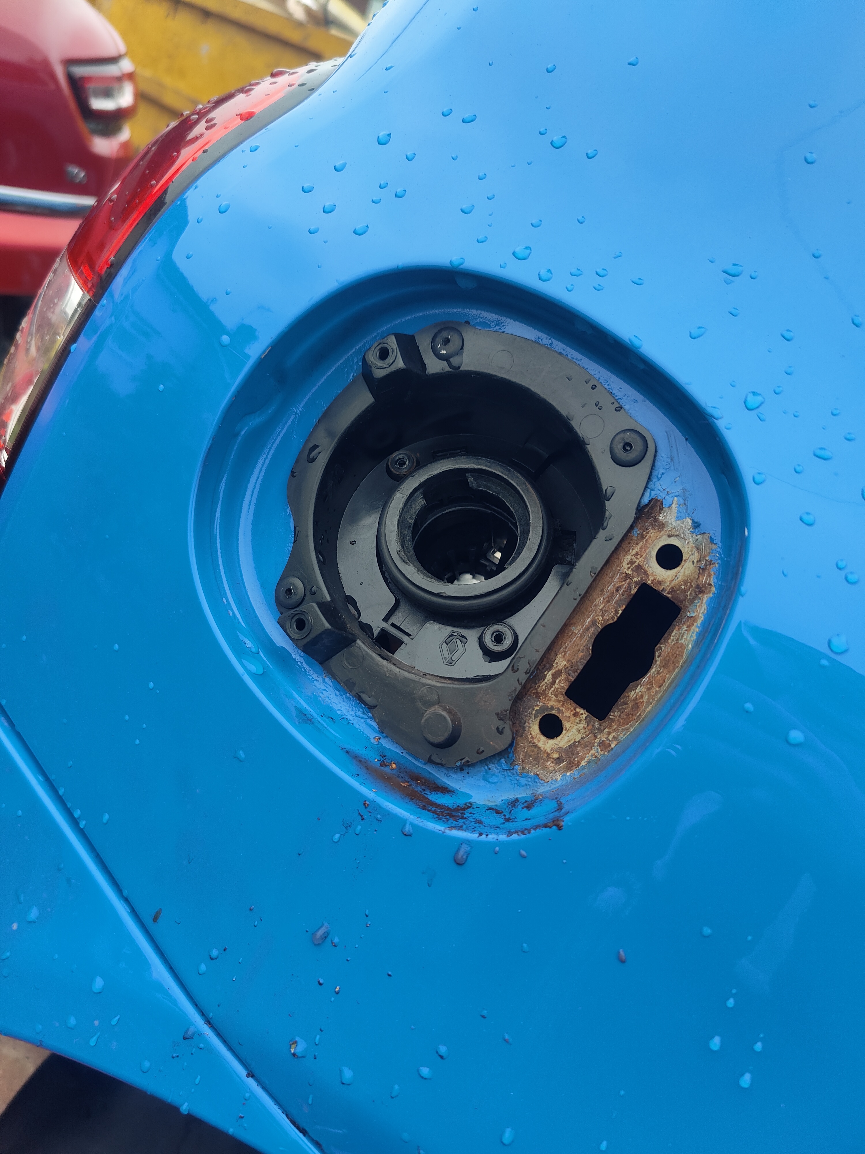

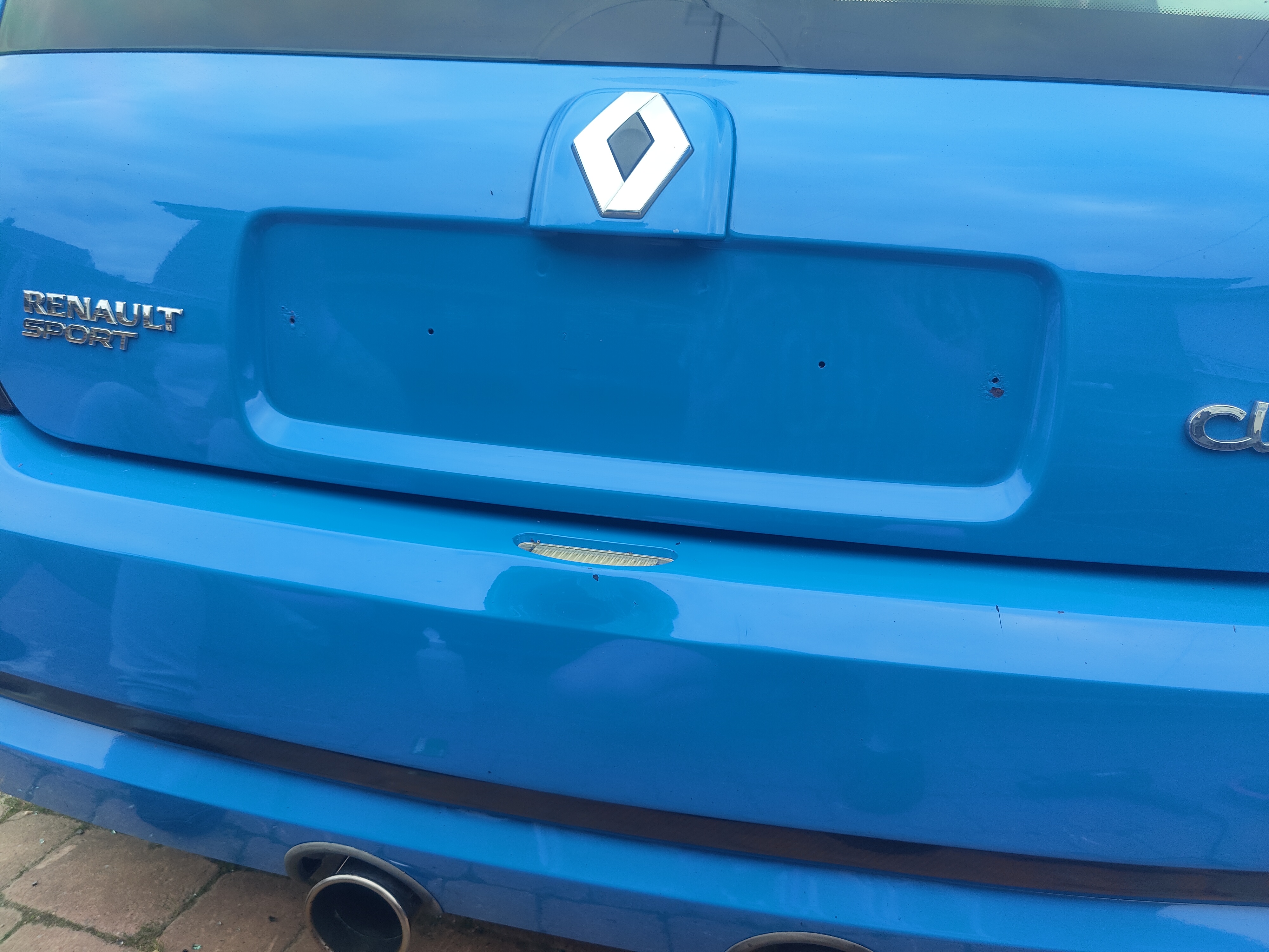

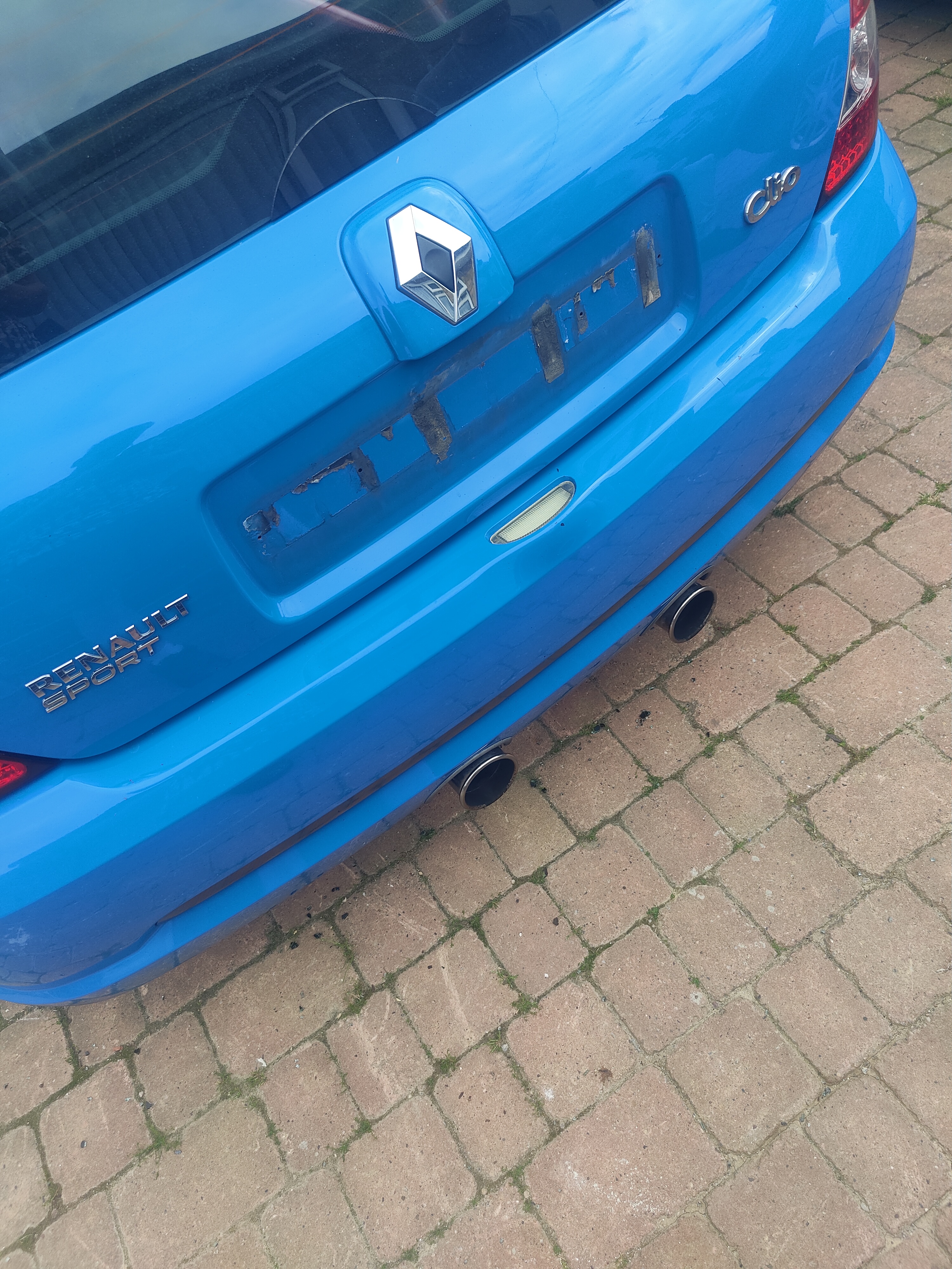

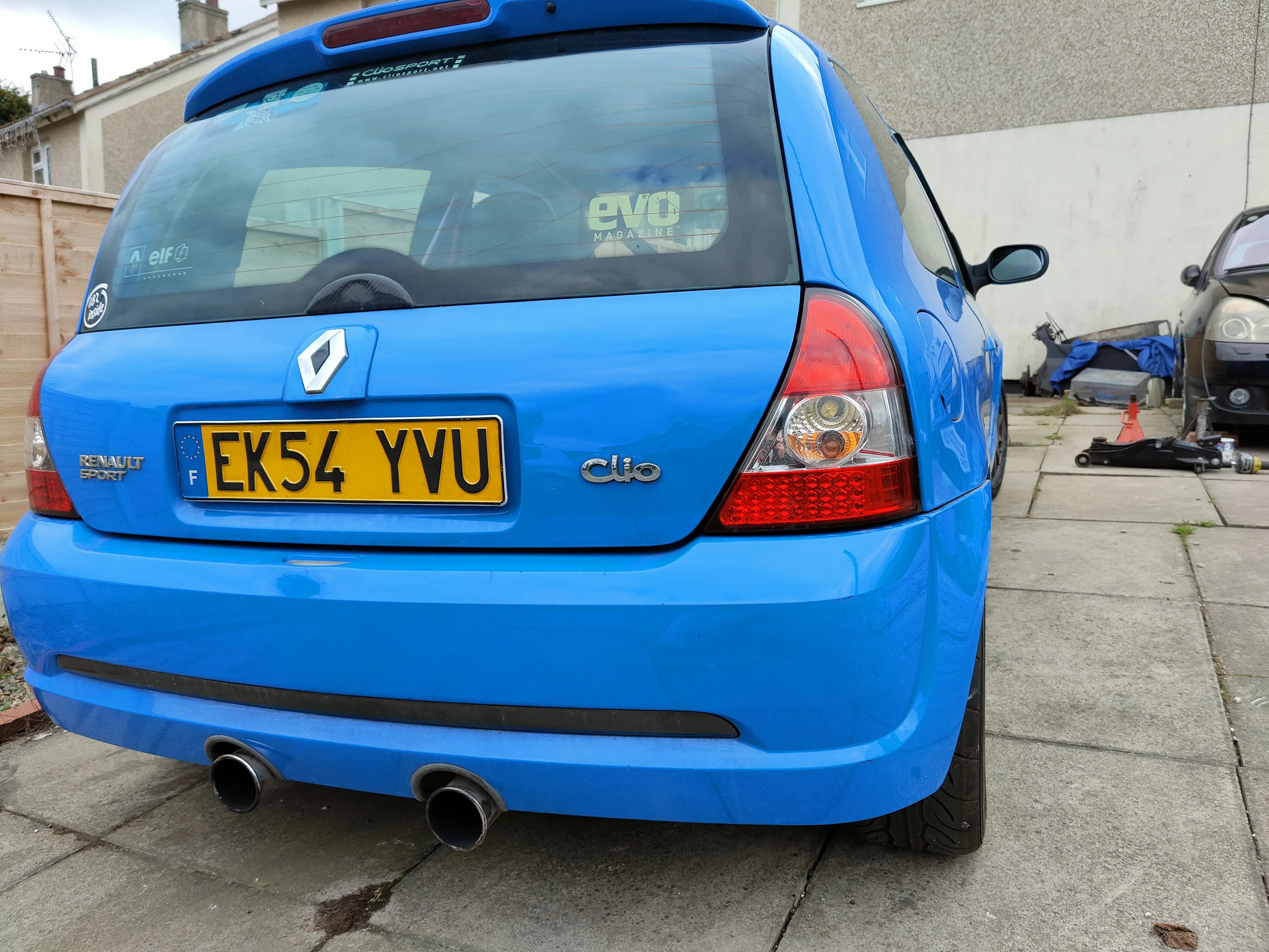

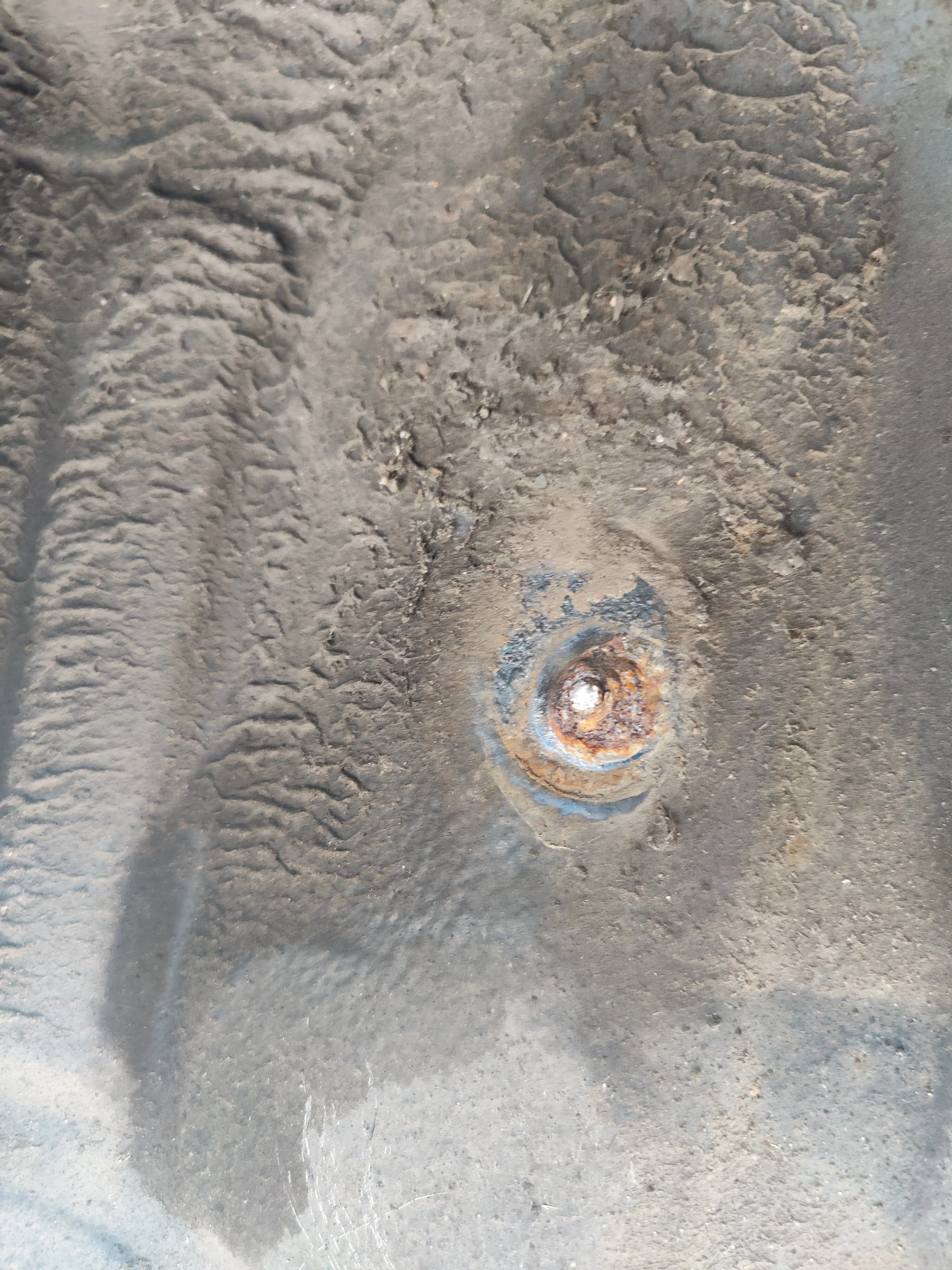

Where there's a Clio there's something to do👀 ha my next job was cleaning behind the rear number plate as I planned to have the place on magnetic strips so I can pull it off for cleaning and switching to show plates.
If you ask me it was hard work shifting that s**t, but it came up well!

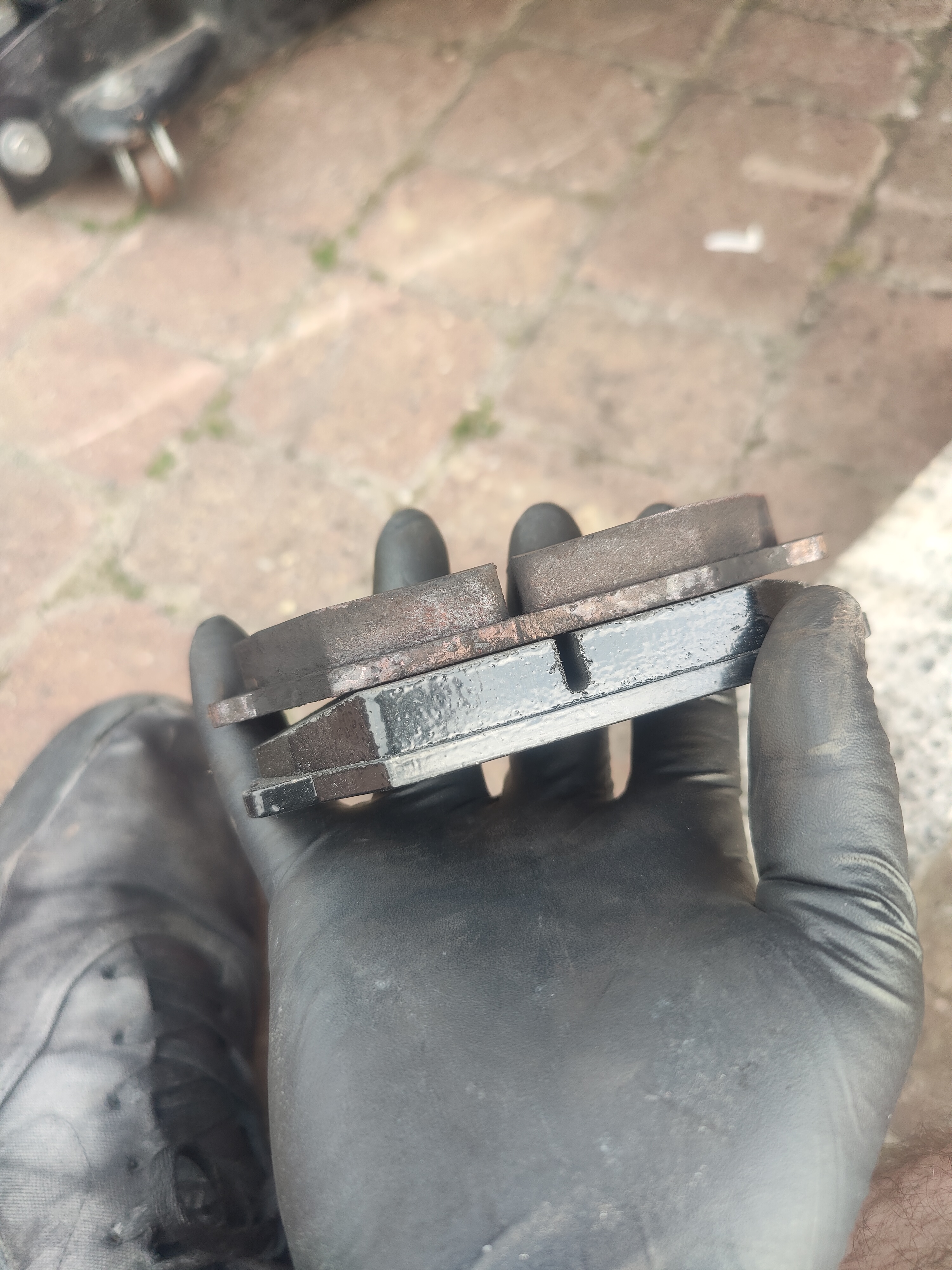

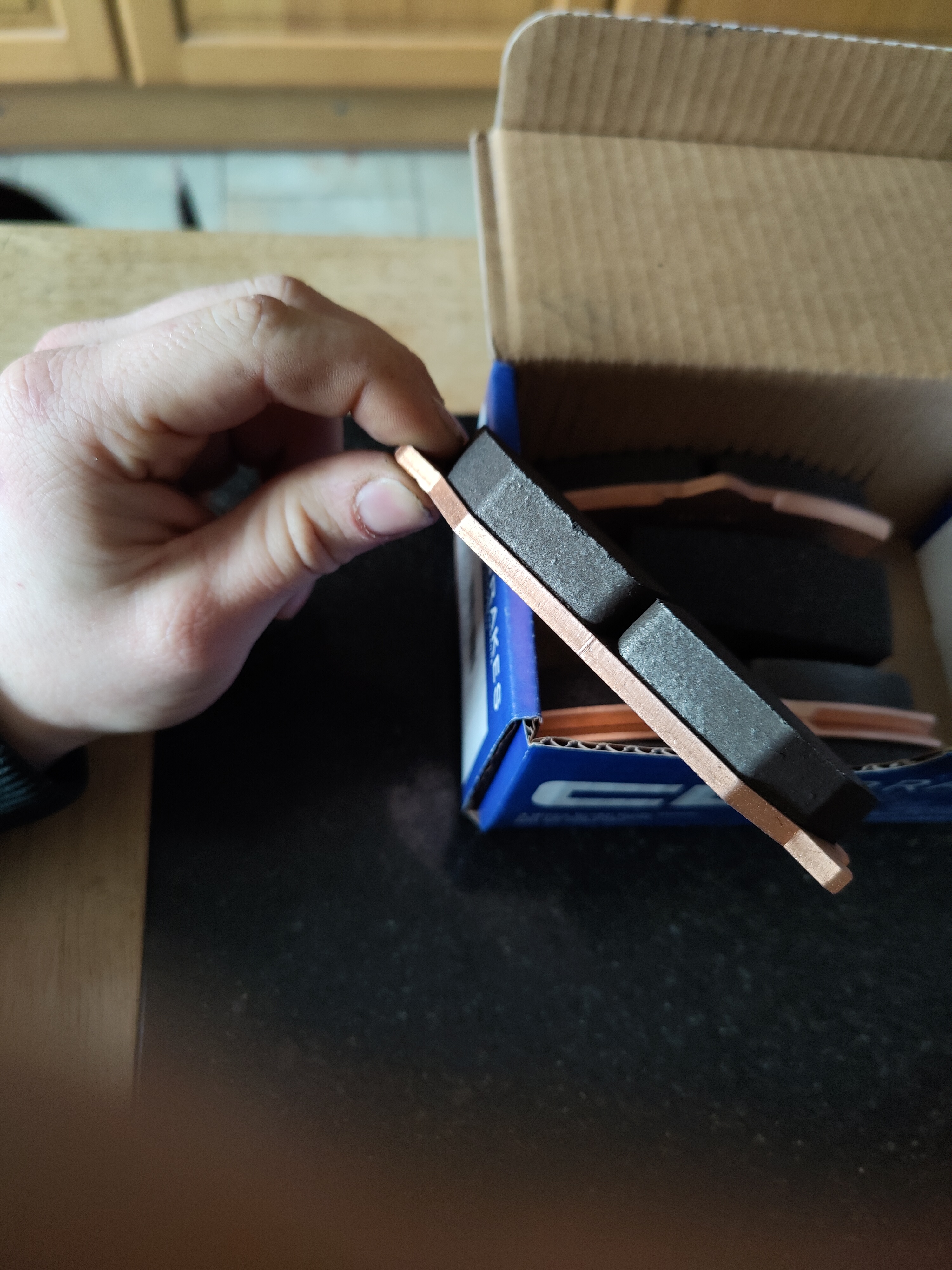

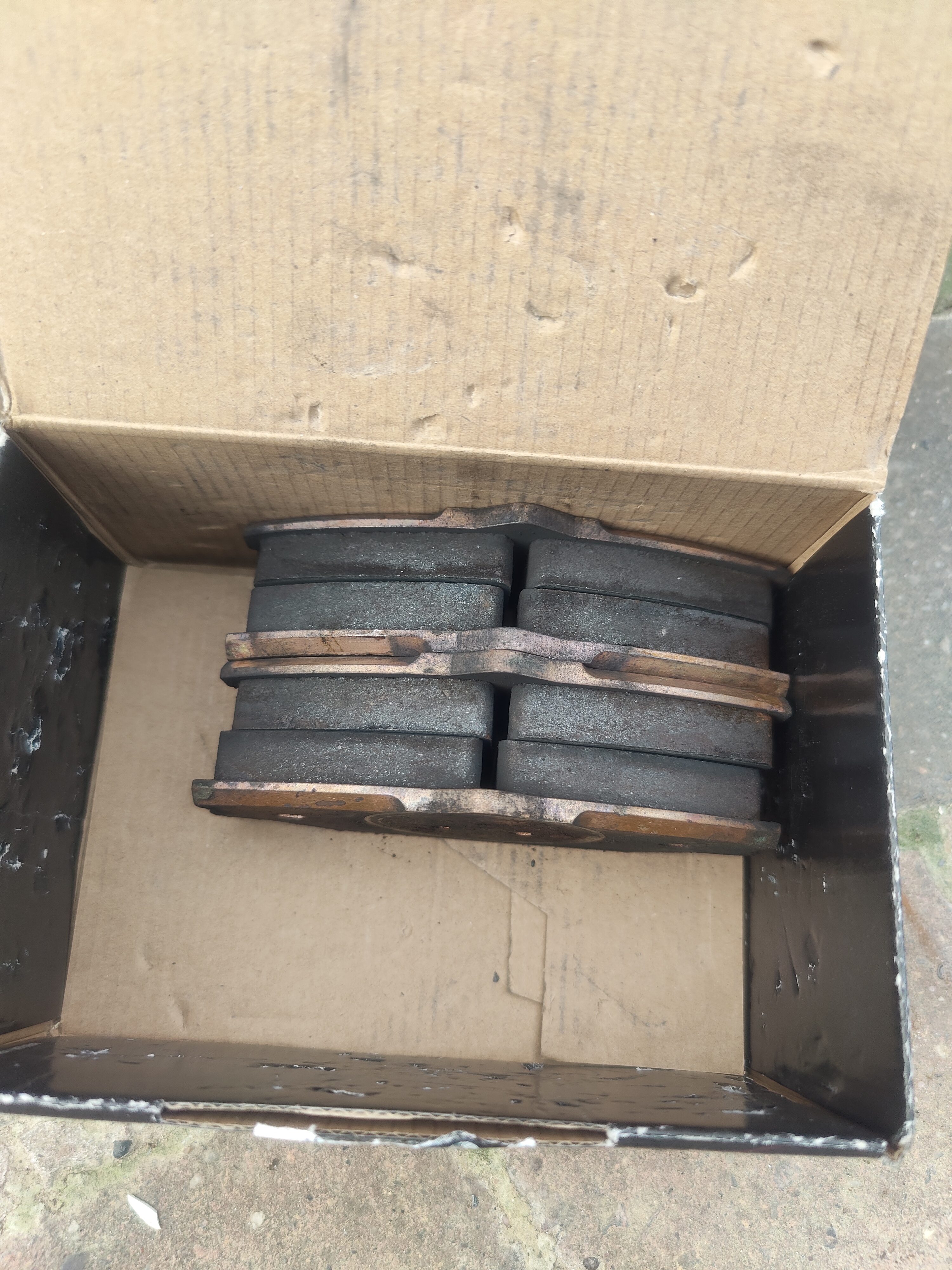

My next job was to swap out the CL RC5 pads no dis but too squeeky for road use lol also for sale if any track hooligans wanna buy em. DM me.
Now running mintex M1144 pads which are also great. Really enjoying them.

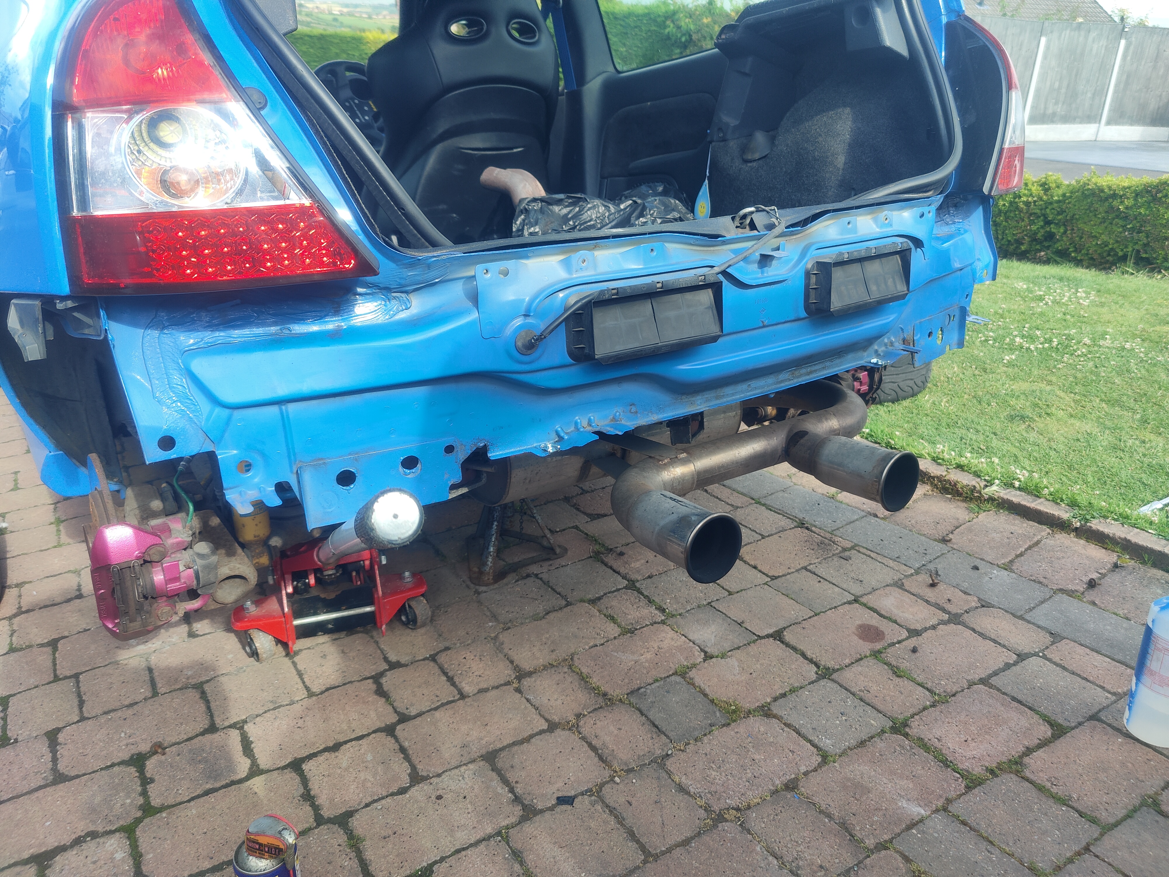

So I removed the rear bumper changed all the fixing for all zinc plated UFO clips and bolts, removed the fuel filter door also to revial rust luckily it was only surface *heart rate resumed to normal bpm* but can I say! No wonder these fail here. The metal is litterally waffer thin like 1mm 🤦‍♂️ this will be cleaned up and treated. New fuel filler door purchased. All rivets and bolts replaced...

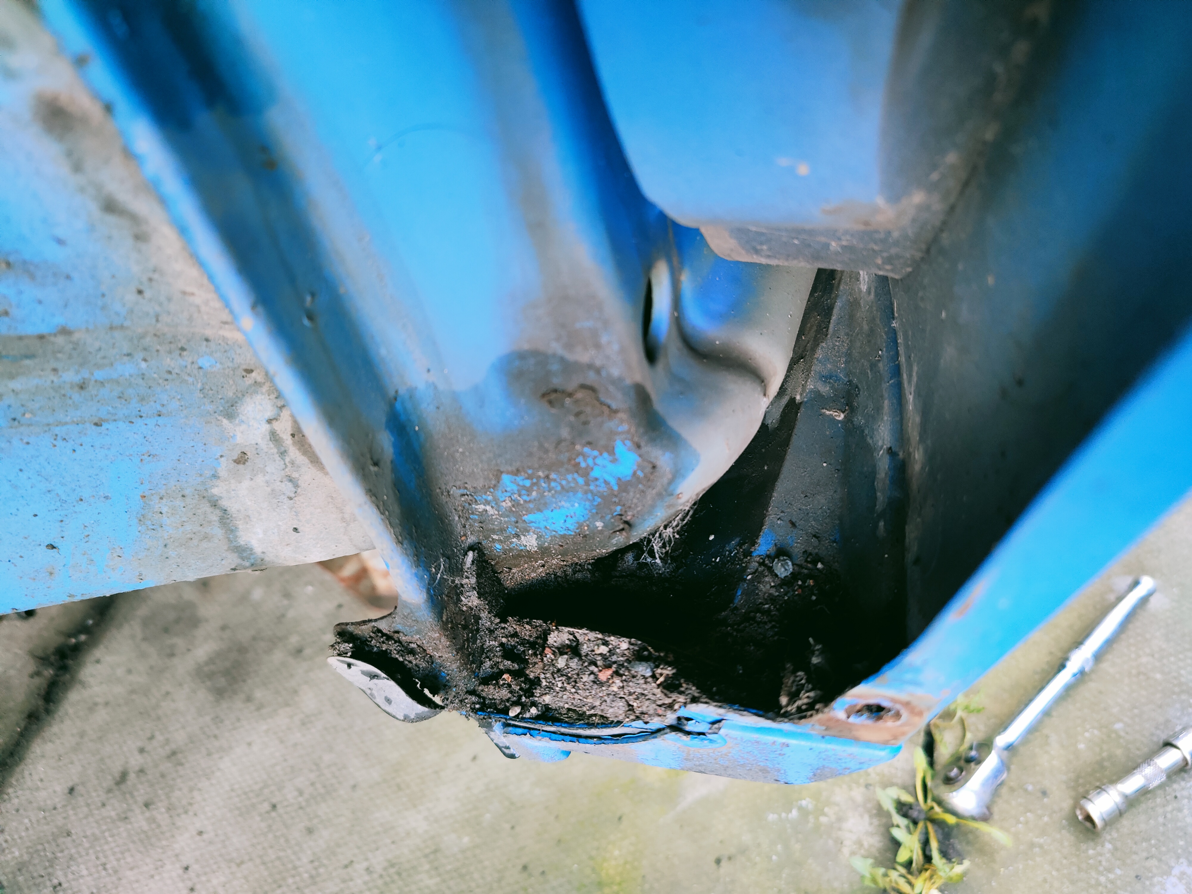

Obviously this job didn't go without its problems and if any bolts/studs where to snap it was definitely Going to be these.. so I fixed it :) much better.

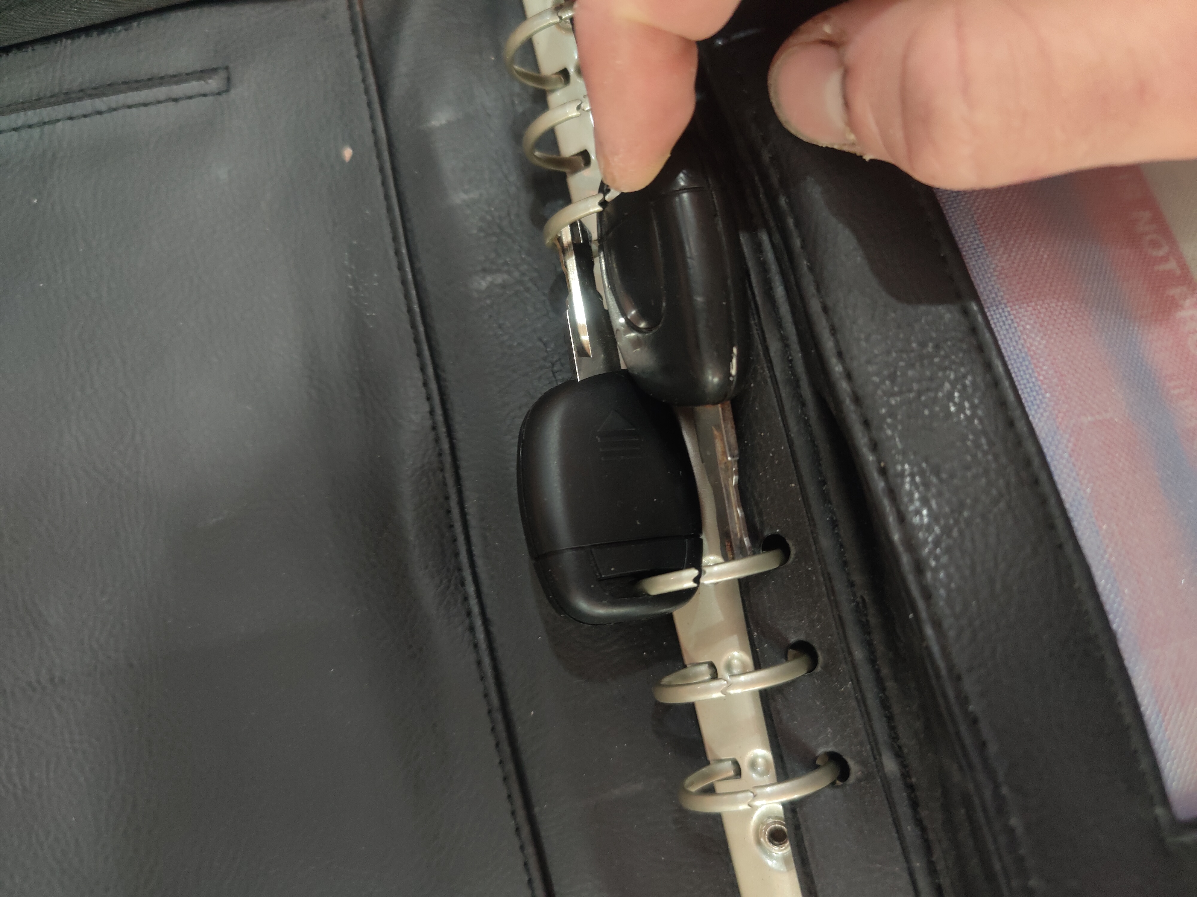

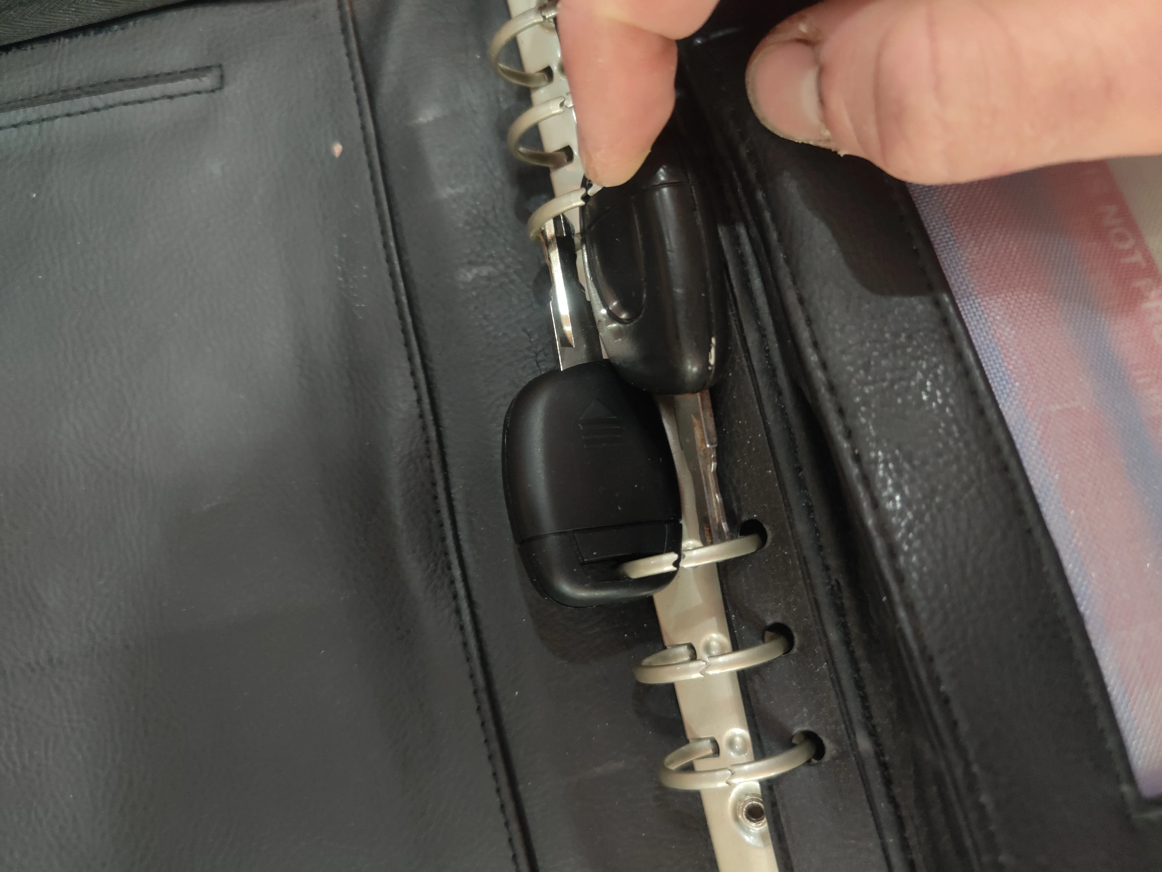

3 Keys 2 programmed. One just blade

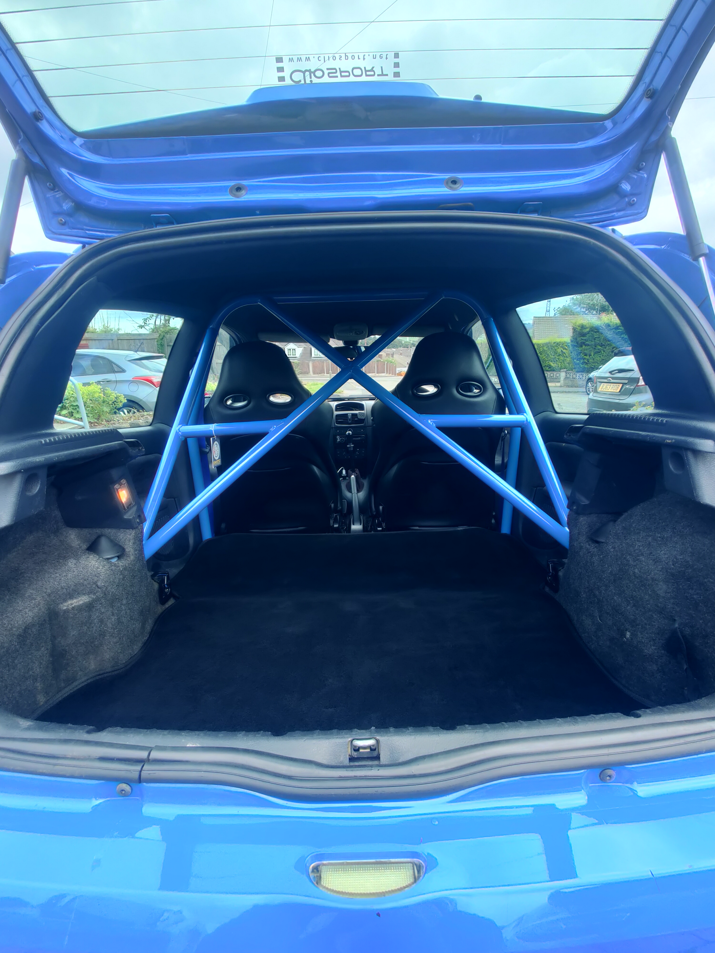

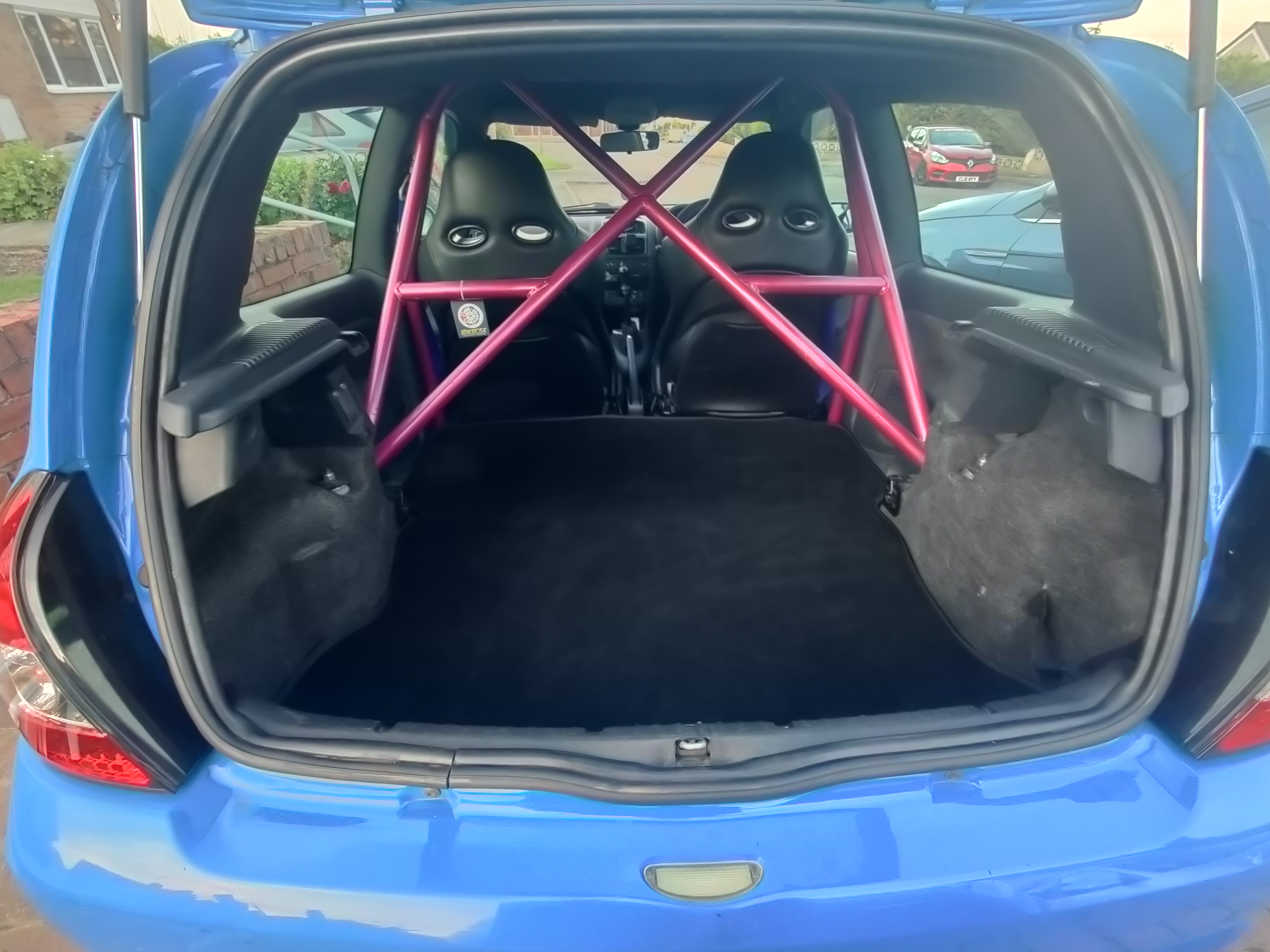

Got the cage and kbrace Powdercoated racing blue (as close as) came up really well, (,kbrace not pictured)

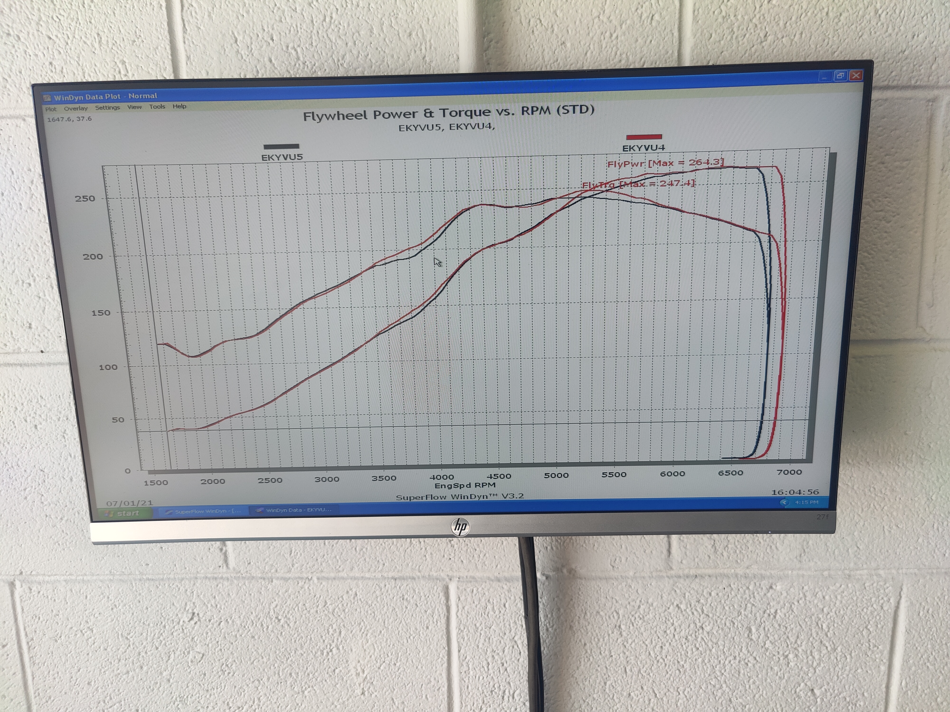

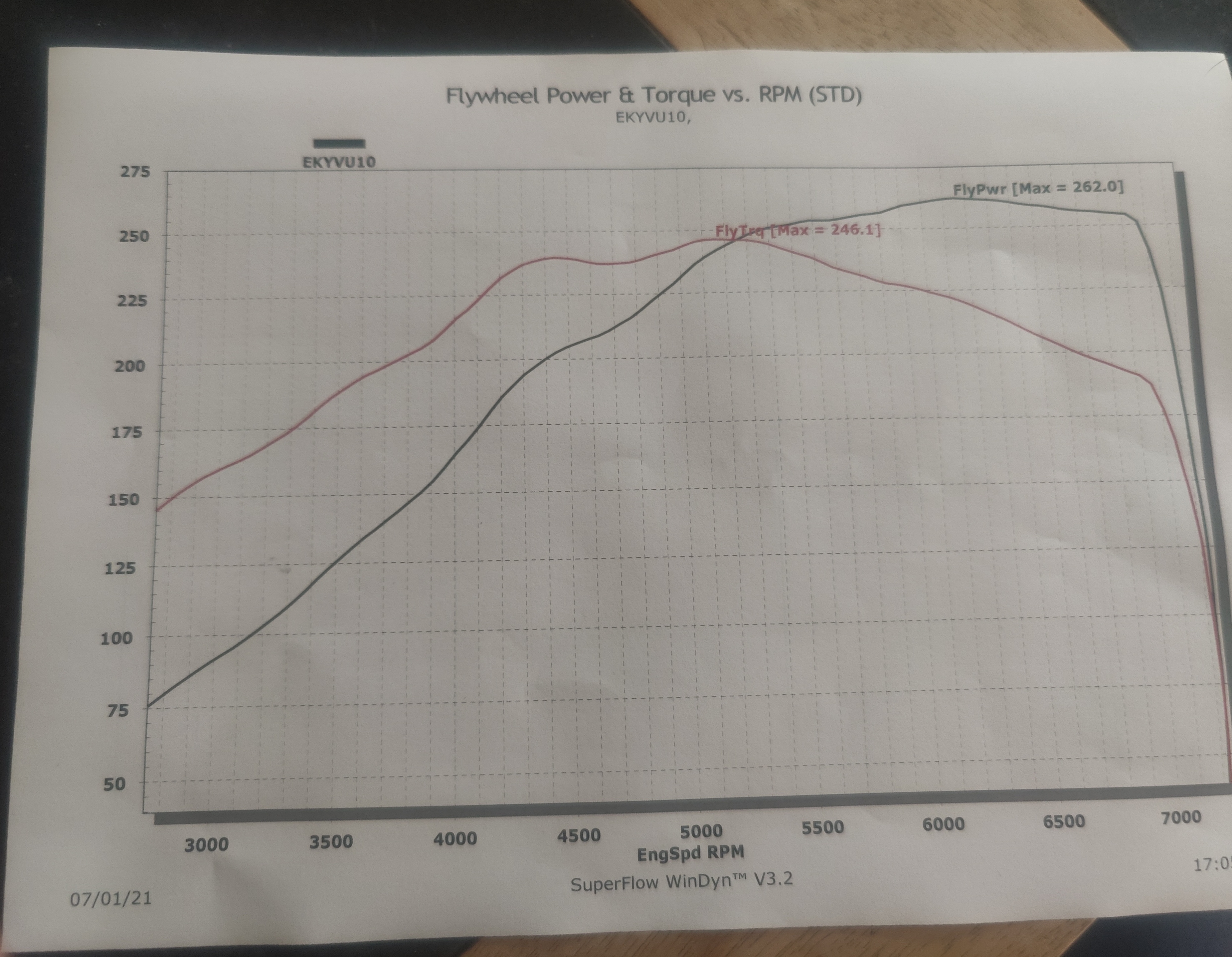

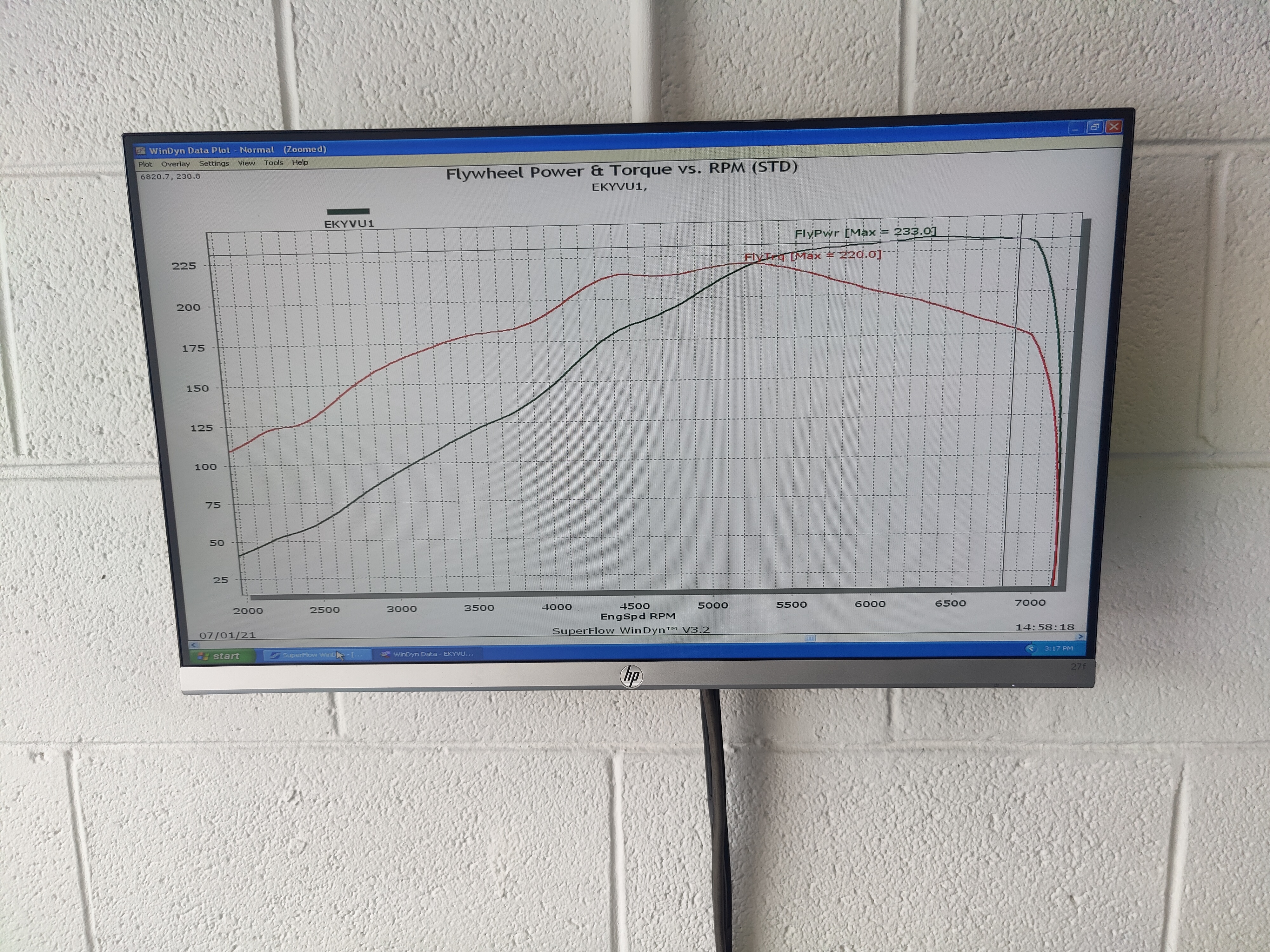

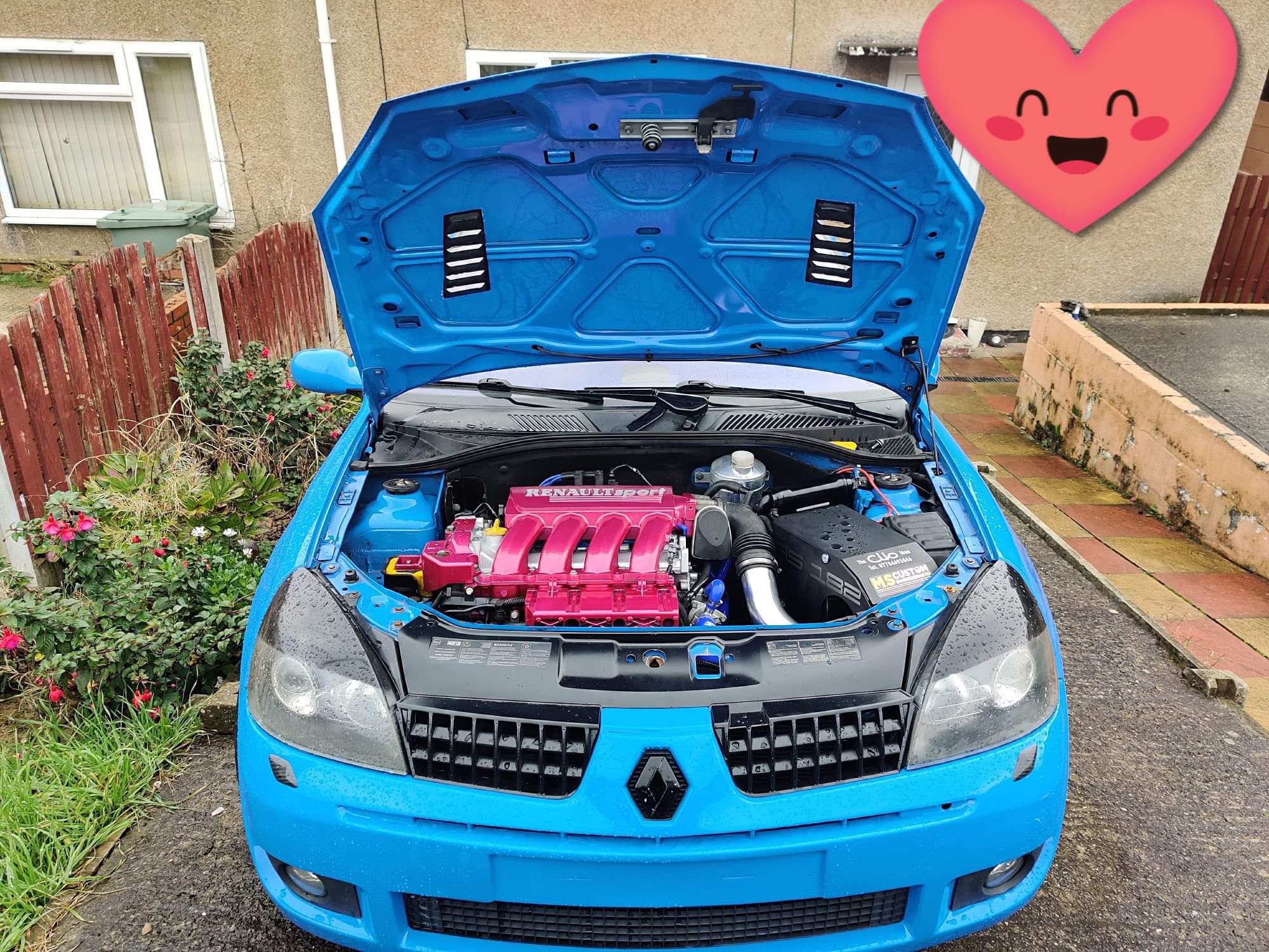

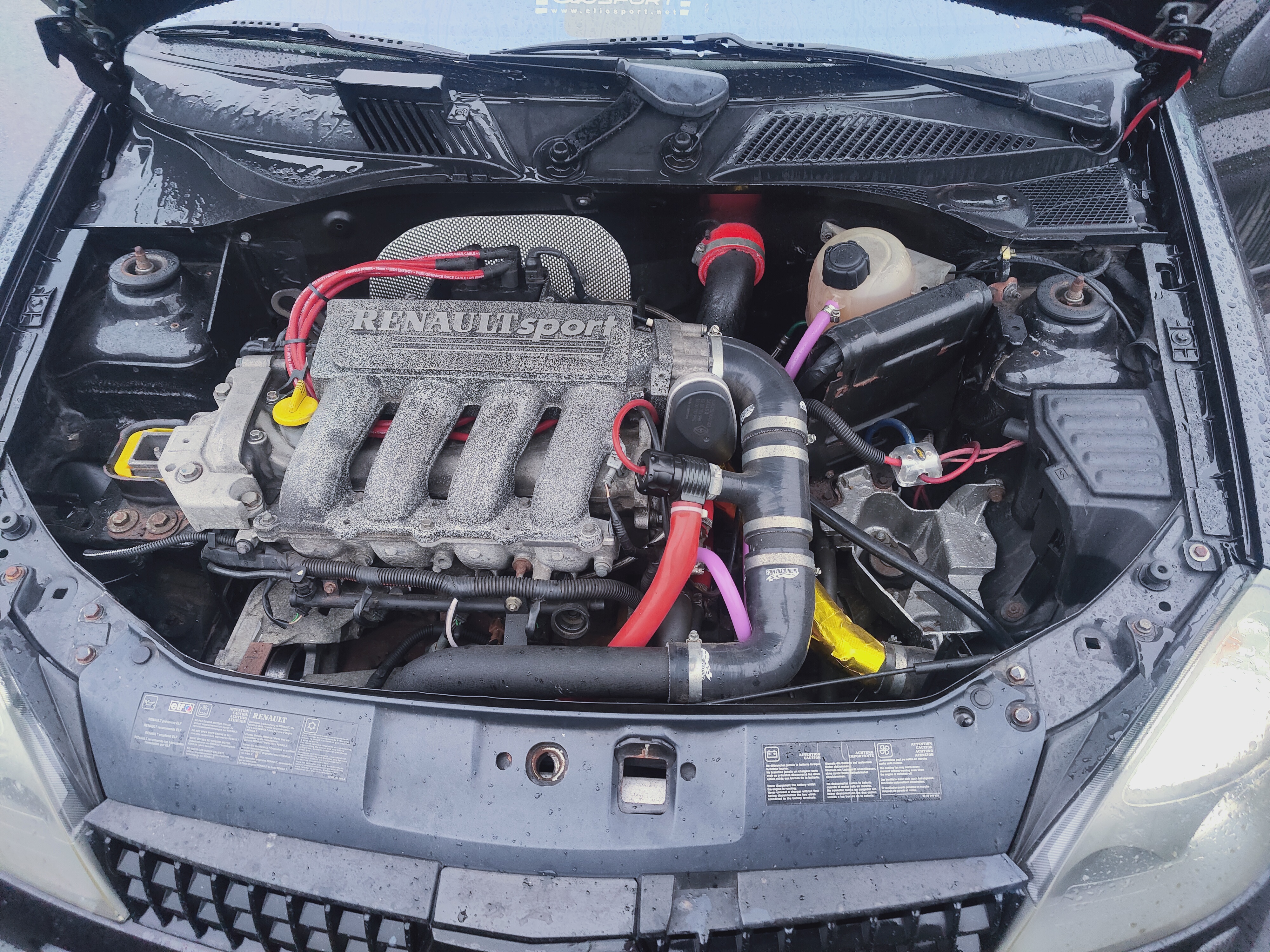

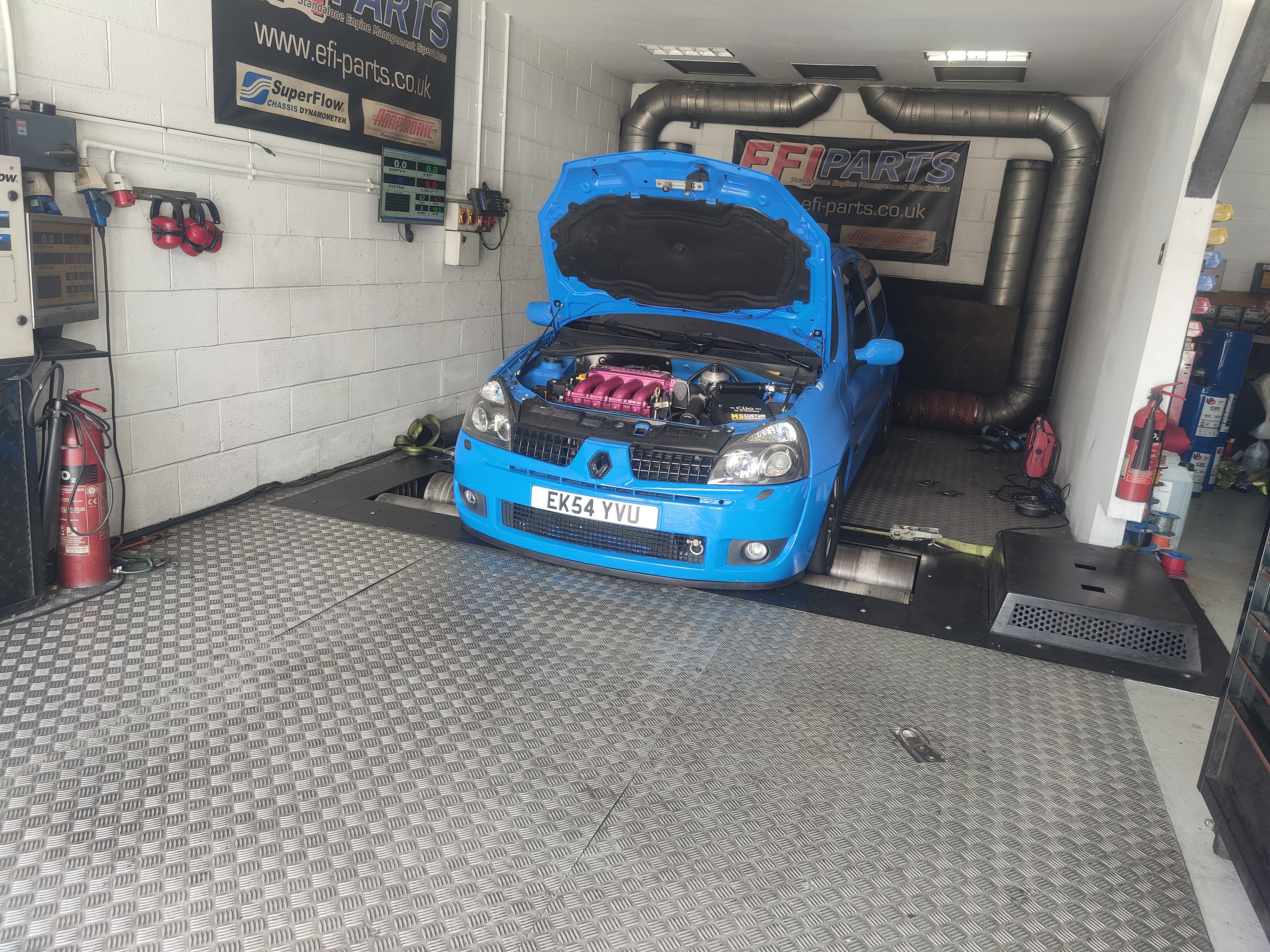

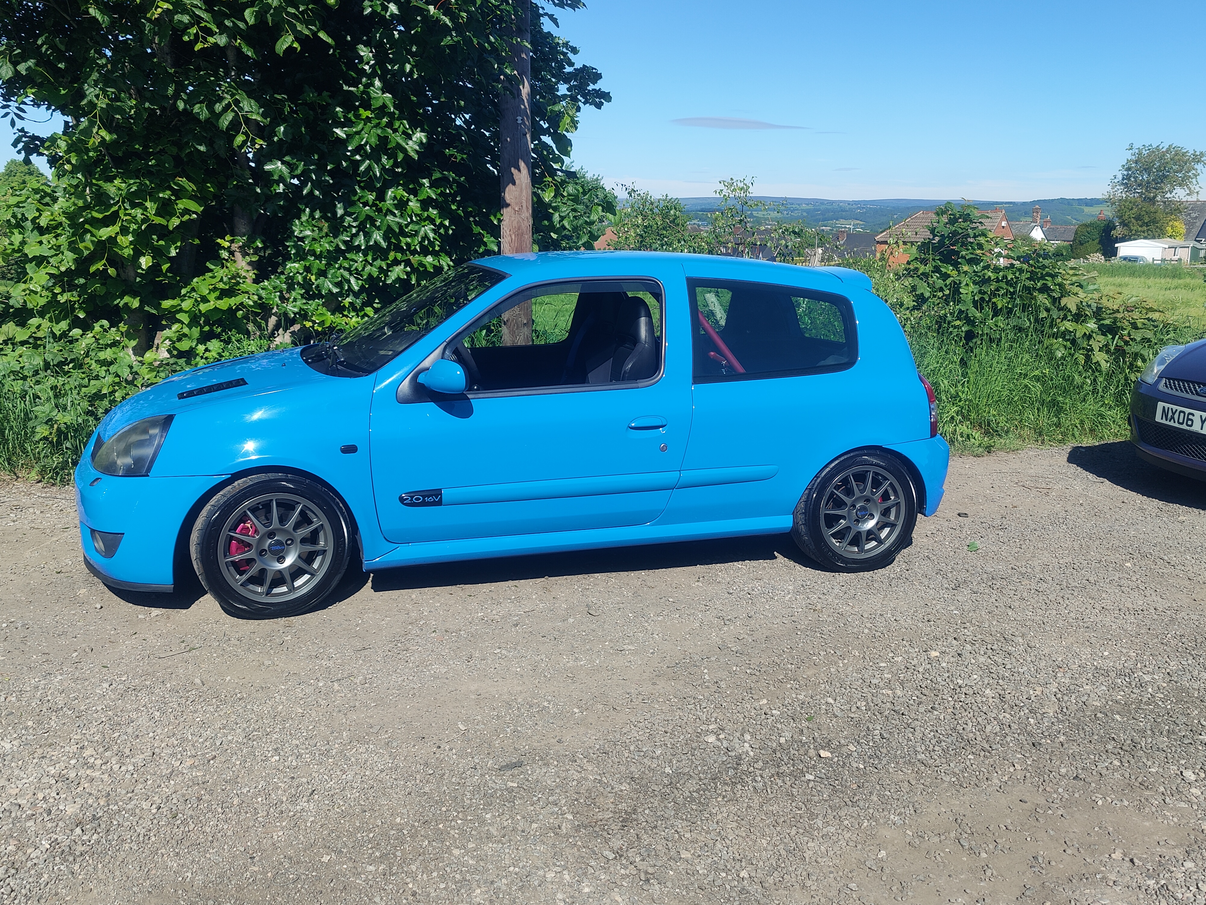

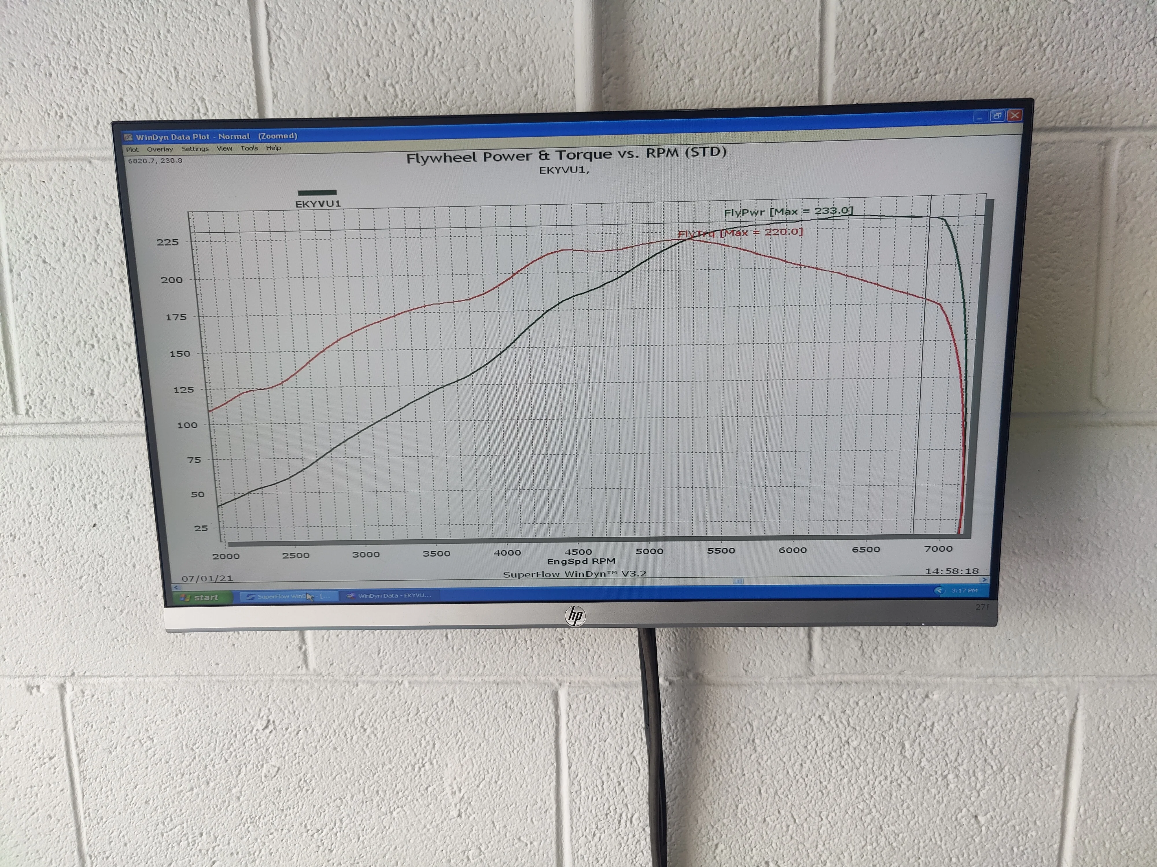

So the next day (1st July) was EFI day, when I bought this lump I was told it was running 260hp as it was. It was a stock block , apparently efi tuned . Only had paper work from engine dynamics for stock map so I took it as hearsay.
Finally got on the rollers after my brother his made nice figures 232 stock and 258 mapped, his intercooler is aftermarket but wasn't as good as Chris at EFI would of liked. Shame!
Mine on the other hand ran 233hp stock (nice!)
Some slight adjustments on the engine cranking up the psi from 7 to 12psi and it was running a nice 264hp! WOW!
We did have some issues with VVT not working. Solenoid is okay, wiring also fine. So we think this is down the the ECU. I've got to send Chris an ecu which he will map my stock map too and see if it re appears.
All in all I was very happy with the outcome and all I can say is it fly's!

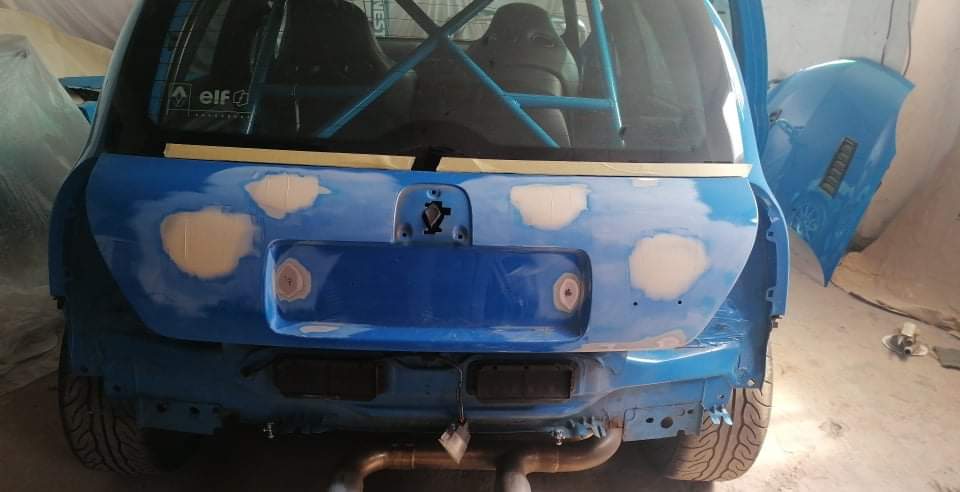

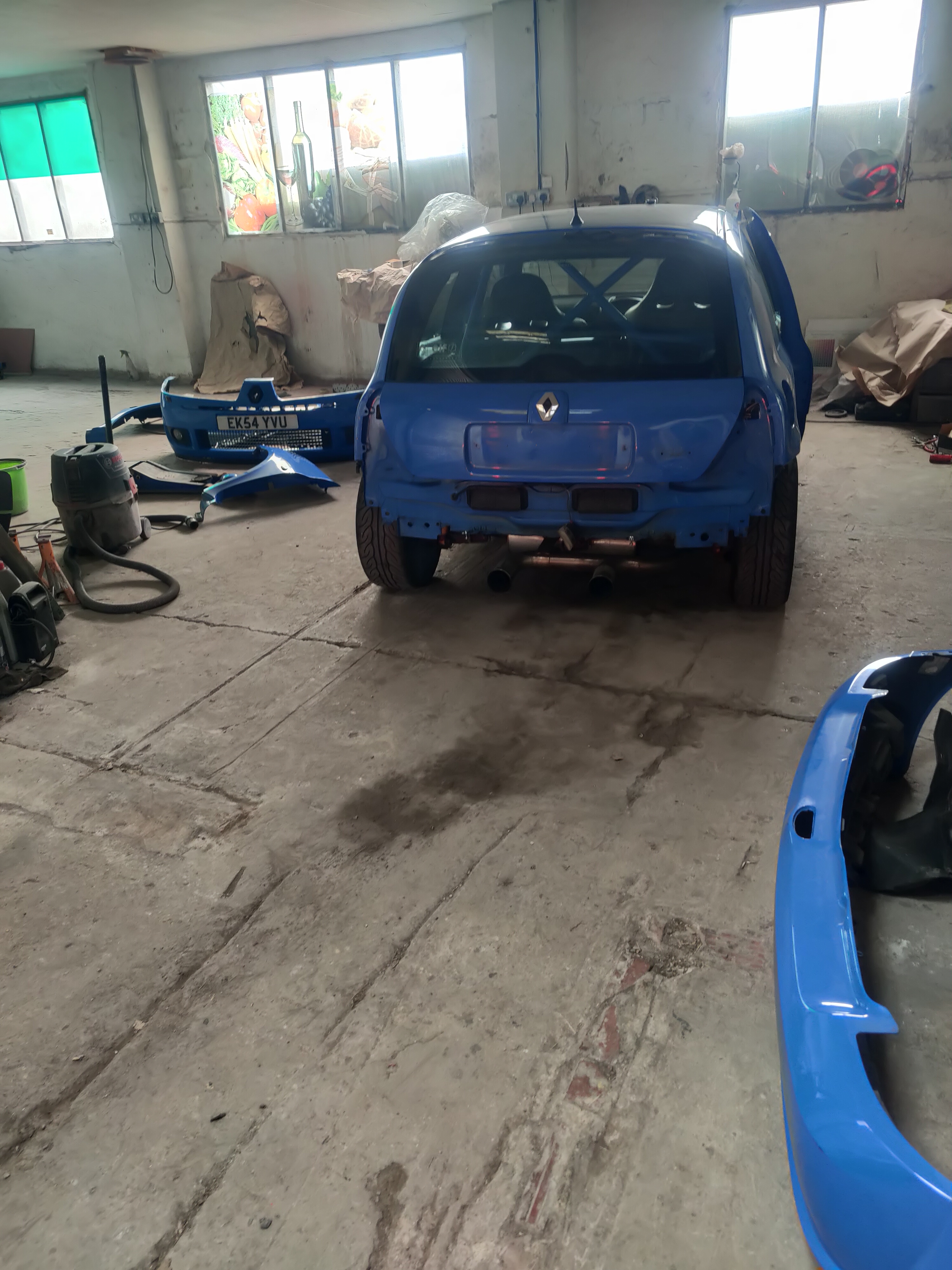

5th and it's paint day I'm also getting very broke🤣🤦‍♂️🤦‍♂️.
Car stripped down.
Few dents filled😅
Thats the rust of th archs gone also just surface. Lucky!
Stay tuned to see the full out come.
