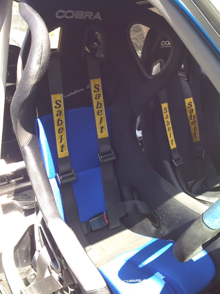

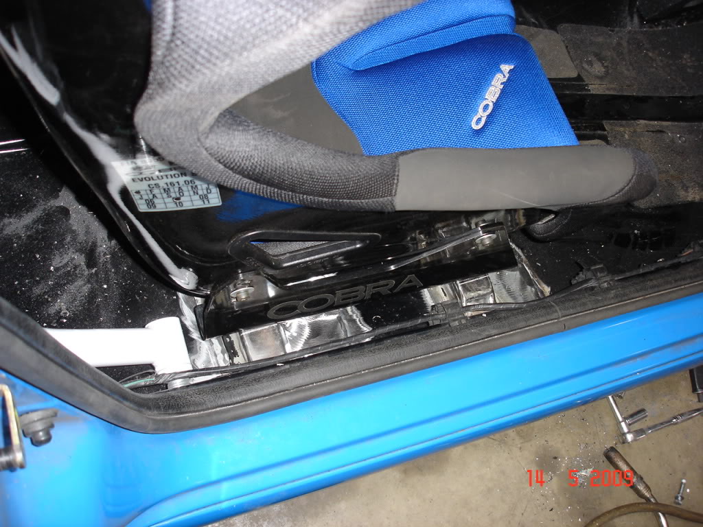

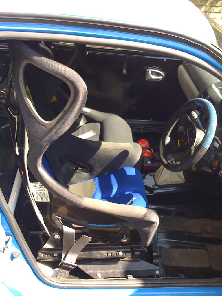

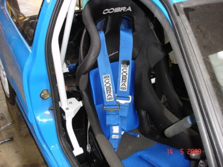

Fitted a Cobra Evolution seat, had to adapt it to work with the runners as me and bazzon drive in different positions. Sits abit too high for my liking so may need to bolt it to the floor and either me and bazzon suffer with driving position. Also have a 3 inch 5 piece harness to fit but waiting for eye bolts so currently have my 3 point sabelt harness fitted.

Looks smart...
How did the "seat adaptation" work out?! ;)
well the new seat fits on the old runners, so well :D
such a b*****d to get in and out of lol!

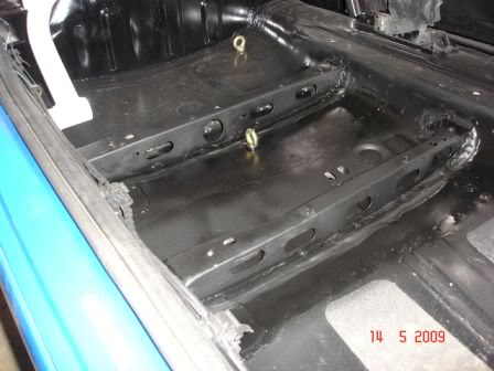

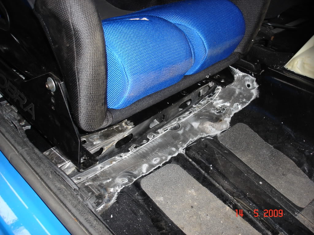

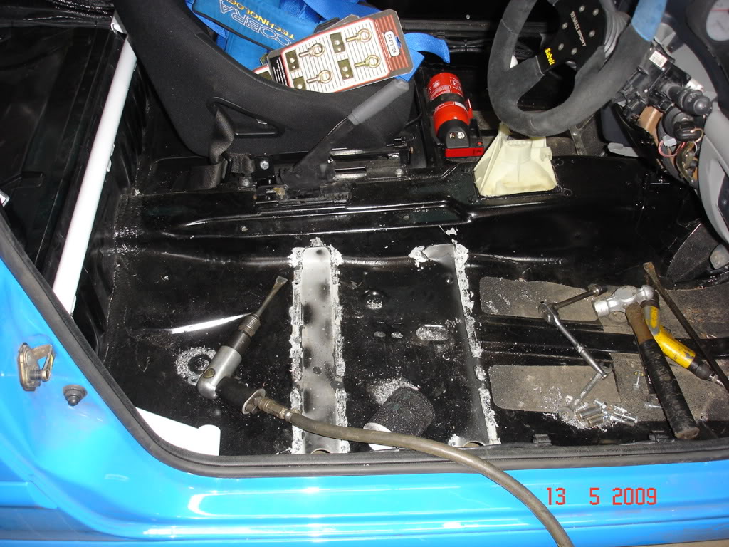

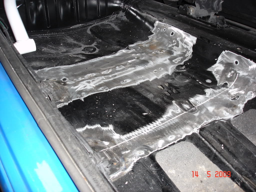

decided i wasnt happy with seat height so me and bazzon compromised on a fixed seating position. got my fabricator to cut the renault horizontal frames out and refit them further back and level. This means my sideframes just sit ontop of the frames. Meaning a low seat :)
floor will ofc be getting repainted :)
  340i
Re: PH1 172 Track Car, abit special *ITB update*
You make it look so easy ;) haha
Did you drill new holes in the horizontal frames, or do they bolt in existing ones?!

who has lost out now or did you meet half way between 2 seating positions?
Barron
  Turbo S,Exige,R5,182
further back than i would normally drive and further forward than bazzon would normally drive

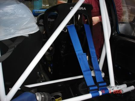

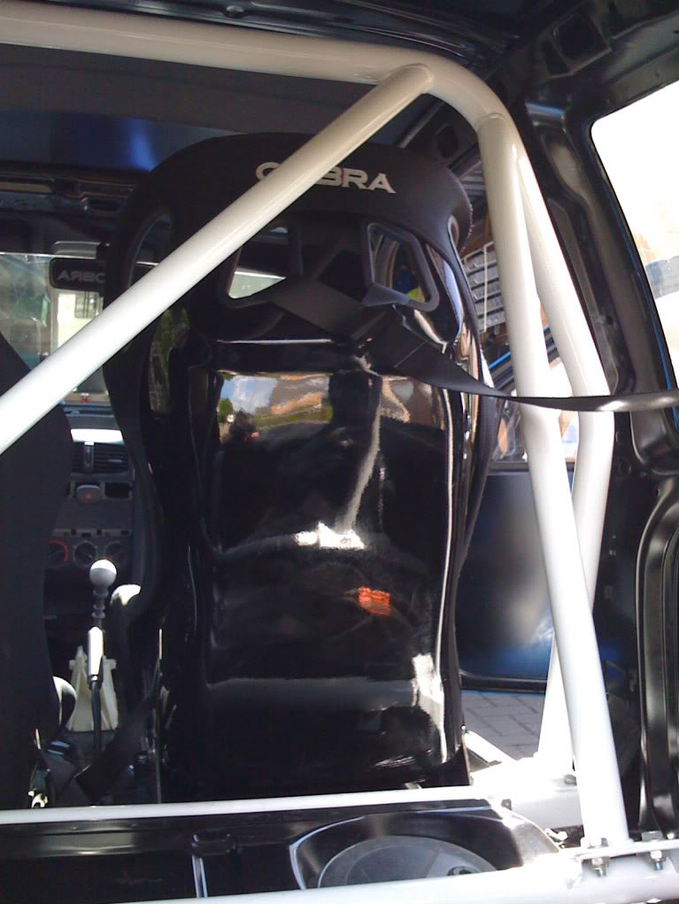

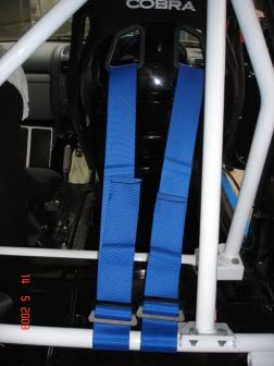

Cage is only a bolt in yes? So you're harnesses are wrapped around a bolt in cage, at a stupidly steep angle? Great!
Barron
thats what i thought too, the guy who has done it for me races grass track cars and he seemed to think it would be fine :)

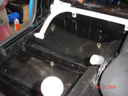

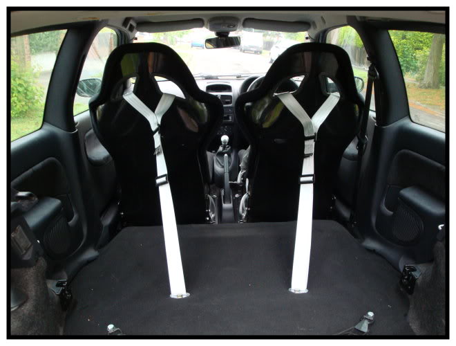

Geesus....just a bit off topic, Whiteley says do the cup racer wheels fit onto the mk1 valver boss straight fit? lol
you too ;)
anyway, i understand they have to be as horizontal as possible but where else can they really be attached apart from cage or the floor next to the fuel tank? (meaning more angle)
  F4R'd ITB'd '92 cup racer
my harnesses are attached to a bolt in rear brace
i showed the pic to mark fish and he said the brace was a standard fit from renaultsport and all the race teams used to use it, cant be much difference to what you have there barron
although mine arent at that much of an angle, that i would be a bit concerned with!
  BMW M5 & E36
Yep it was more the angle i'd be concerned about. Im sure the diagram that Edde posted about 7 billion times is still floating about. And I don't have the wheel sat in front of me yet, smart arse! ;)
Barron

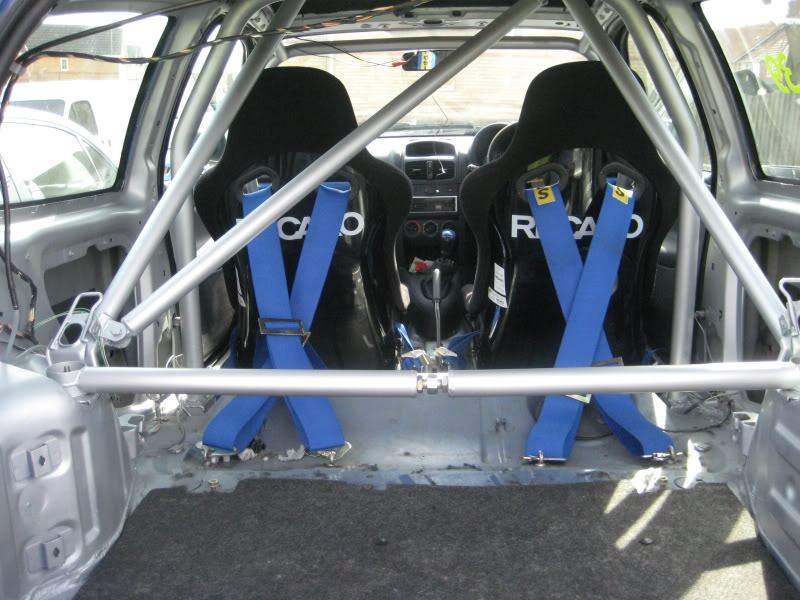

the angle is no more than this one
yeh but they are at too much of an angle still according to the diagram whitely is talking about
you just run the risk of being 2 inches shorter (or paralysed) if you have a big off :S
Barron
the only way to get a perfect fit harness is to have a full cage with a horizontal harness bar. I dont have that so no other choice. The way mine is, is no more dangerous than those two posted above though?
carl
  BMW M5 & E36
Doesnt make it any more correct. And being a track car, the chances of you crashing are a fair amount greater. Just thinking of your safety, not going to affect me!
Barron
na i understand that mate, just what else can i do in the situation apart from fitting a full cage?
