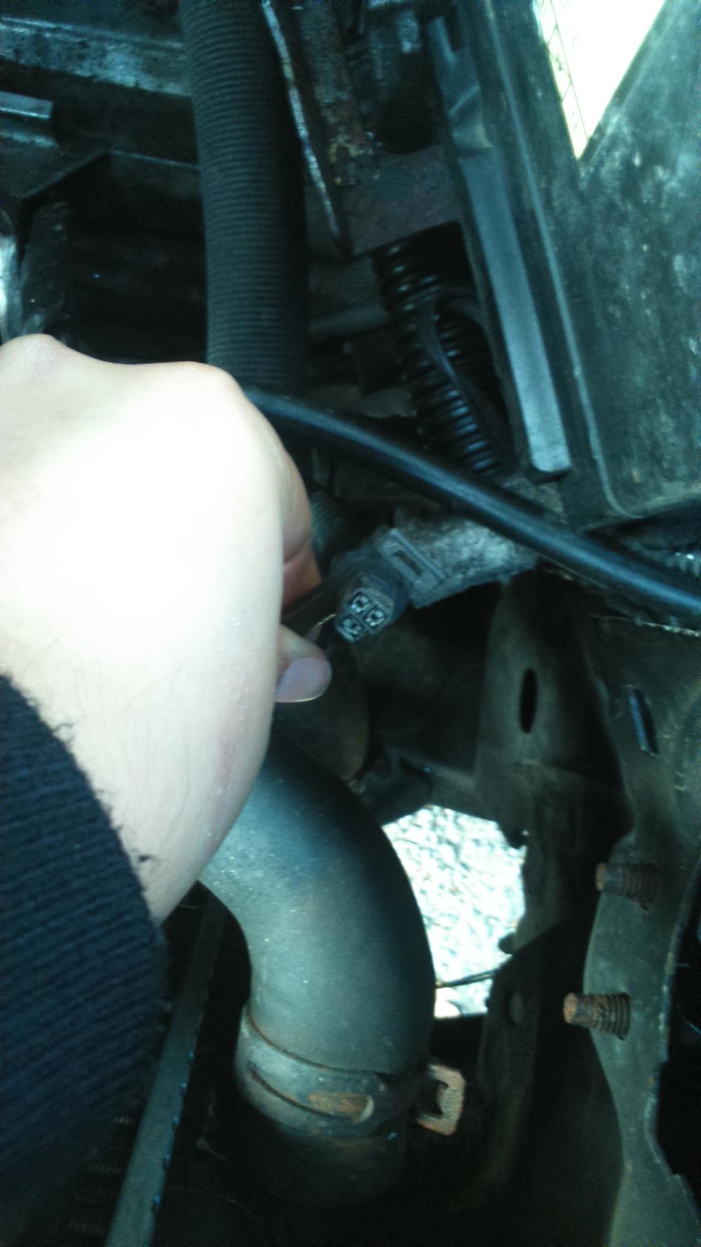

On my 172 PH2 the rad fan doesn't come on as I discovered when it overheated during MOT :@. The temp gauge works fine and sits at a constant level when driving, doesn't shoot up when waiting at the lights etc. I've sent a 12v current to the fan and it comes on fine. There's no loose/dodgy wires that I can see. Checked fuses and none are broken/corroded. I've read a few threads about it but there doesn't seem to be many answers. There's a small grey plug near where I presume the fan switch goes, but I was told PH2's don't use the switch? Odd as the plug for it is there (I think)

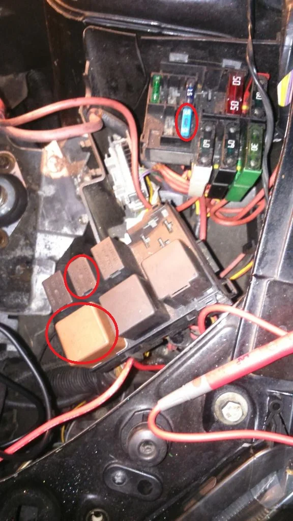

But this only shows 1 large relay, with 4 smaller ones? My 172 has 3 larger ones (one brown, two black) and 3 smaller, this is mine:
(ignore the circles)
The only thing I've managed to decipher is the middle smaller relay controls the engine start? Be really helpful if someone could tell me what the others do.
You should try doing exactly as I advised, disconnecting coolant sensor while engine is running won't trigger fan start, you have to switch ignition off, disconnect, then turn ignition/engine on. If afterwards fan is not spinning then you can be sure something's rotten. In my Clio those two small relays next to the circled one are for fan: one for low fan speed, second for high fan speed. If you don't have manual for your car and not sure which is for, just check all relays are ok, the we'll be able to search the problem cause further.

I'll give it a go now. Are any of the larger relays for the fan?

On each coil there is a scheme, if you are able to read it you can short circuit appropriate pins in the relay socket to test if the fan will start - that will tell you if the wiring is ok. Before that you can measure the voltage on those pins, should be ~ 12V. But do it only if you are sure what you are doing. Provide picture of the relay scheme inprinted on it so i can give you a hint.

Finally got the time to try bridging the relay today. I tried the smaller relay on the right in the above pic. The middle one is for the starter, left is something to do with the throttle body (when I unplug it the throttle body stops buzzing) so the right one must be one of the fan speeds. No luck. The other two bridge fine. So hopefully there's just a break between the relay and the fan plug.
