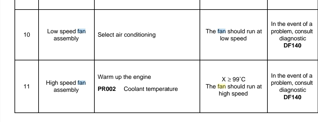

There certainly is low speed and high speed for fan, low speed on with ac.
High speed comes on at 99degrees.

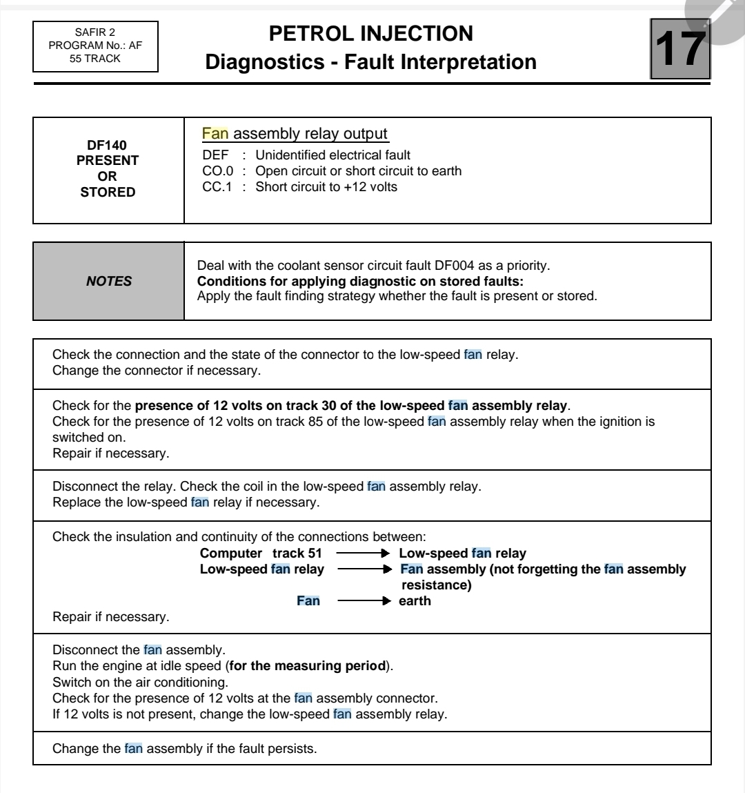

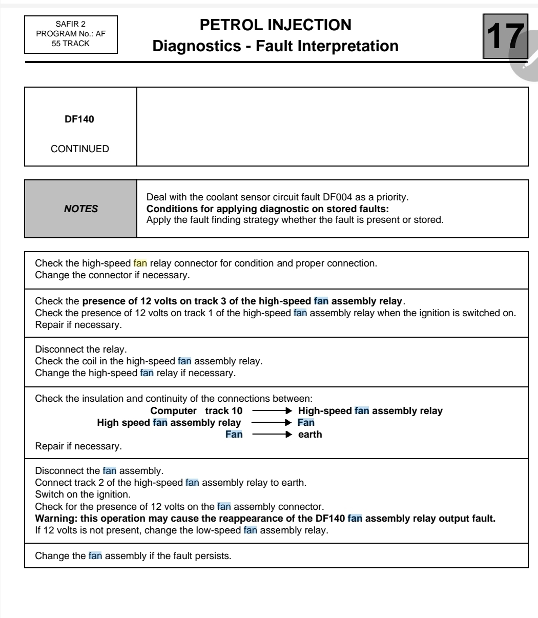

I dont think you will have an issue with it but here are the diagnostics from the manual.
