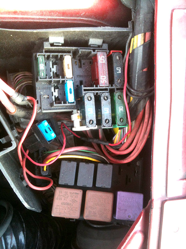

So I seem to have a Radiator fan problem at the moment, as in they do not turn on at all, Can anyone here tell me which Relay is the one responsible for controlling the Radiator fan?
So I did some looking around to my problem, am I right in thinking that the Coolant Sensor is responsible for turning the fan on, and if faulty the fan will not turn on.
You are correct that the coolant sensor is responsible for turning the fan on & on some if you disconnect the connector with the ignition on the fan will start . One of the 3 black relays in a row is the fan relay ,one is the fuel pump relay one is the fan & think the other is connected with the imobaliser low I am sure I will be corrected if not :argue:
