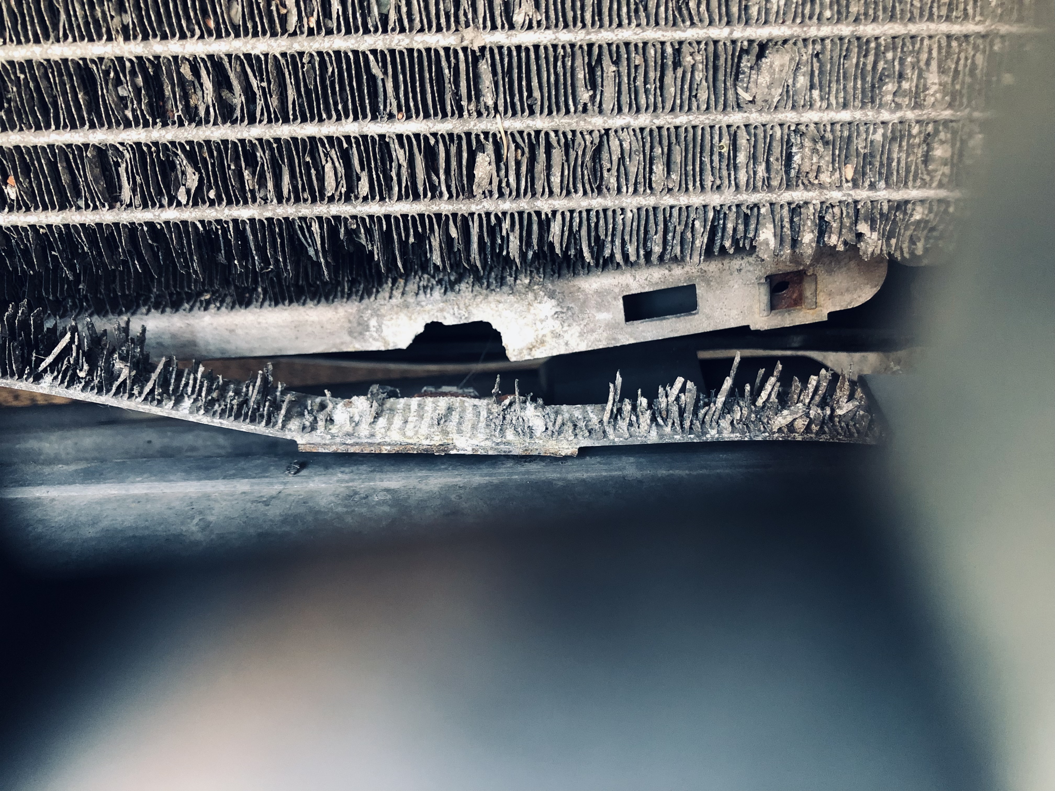

I'd leave it then. If the bottom of your radiator looks like this I'd be swapping them but it's rare you can replace one without the other.
Your condenser failing and losing AC is fine, but your radiator failing and losing coolant isn't so fine.

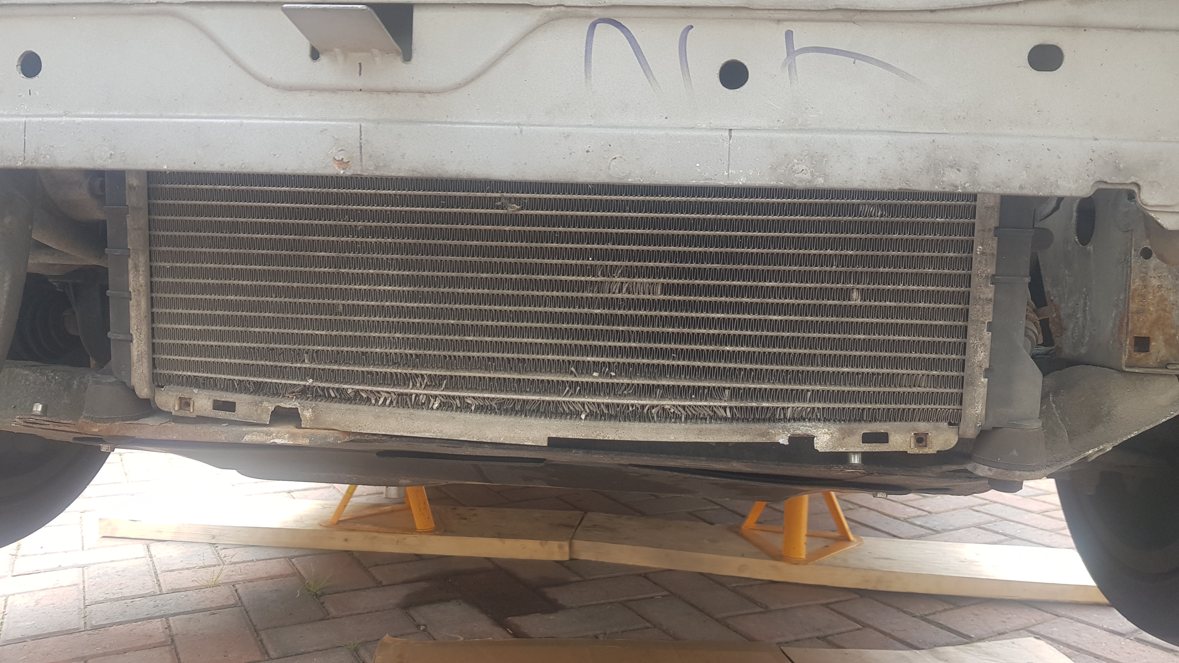

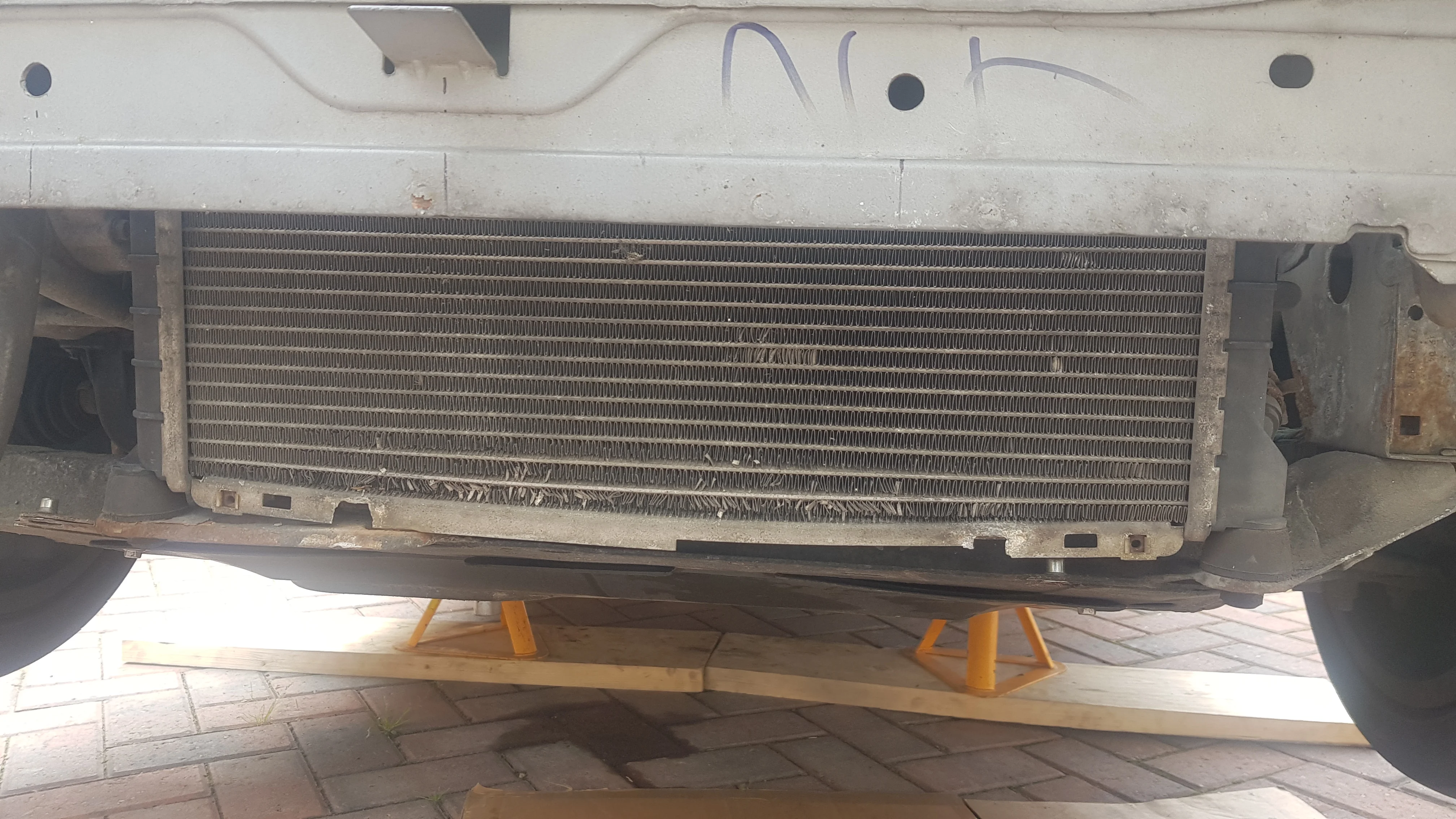

Don’t think in far off that and my condenser looks much worse.
My GF is dailying it at the moment so can’t be doing with a break down. What do you reckon?

For what’s it’s worth, I replaced everything when I did this.
As @Louis said, you’ll be hard pushed to replace the rad without destroying a couple of the caged nuts on the condenser. If you shop around, you ac get a rad, condenser and the cylinder thing that sits next to it cheap enough.
I’d replace it all looking at the pic above. When k pulled mine, it looked the same and crumbled in my hands as I pulled it out the bay…
Yours looks worse than mine did 🤣
Go nissens or genuine, both are equally as good imho.

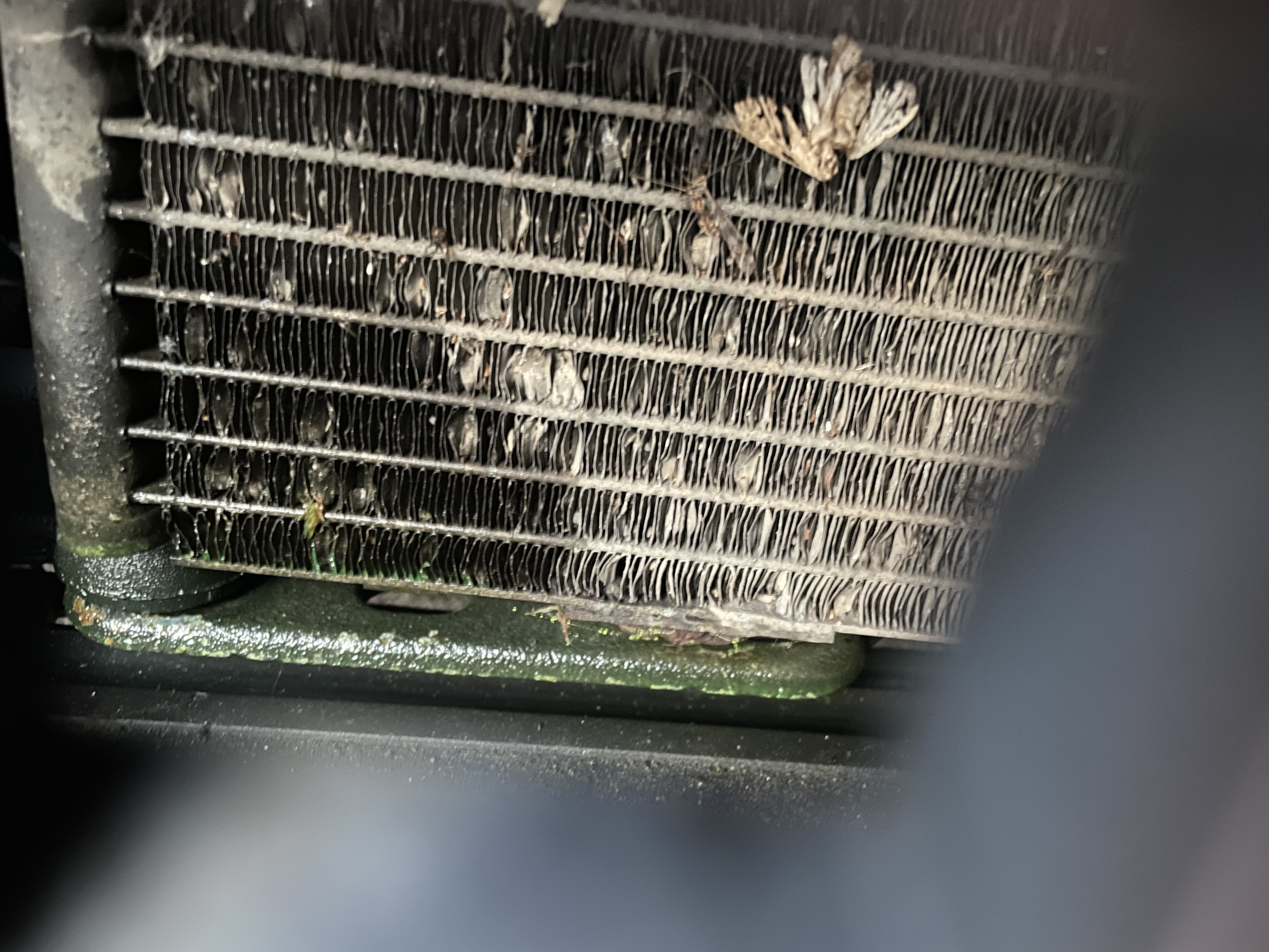

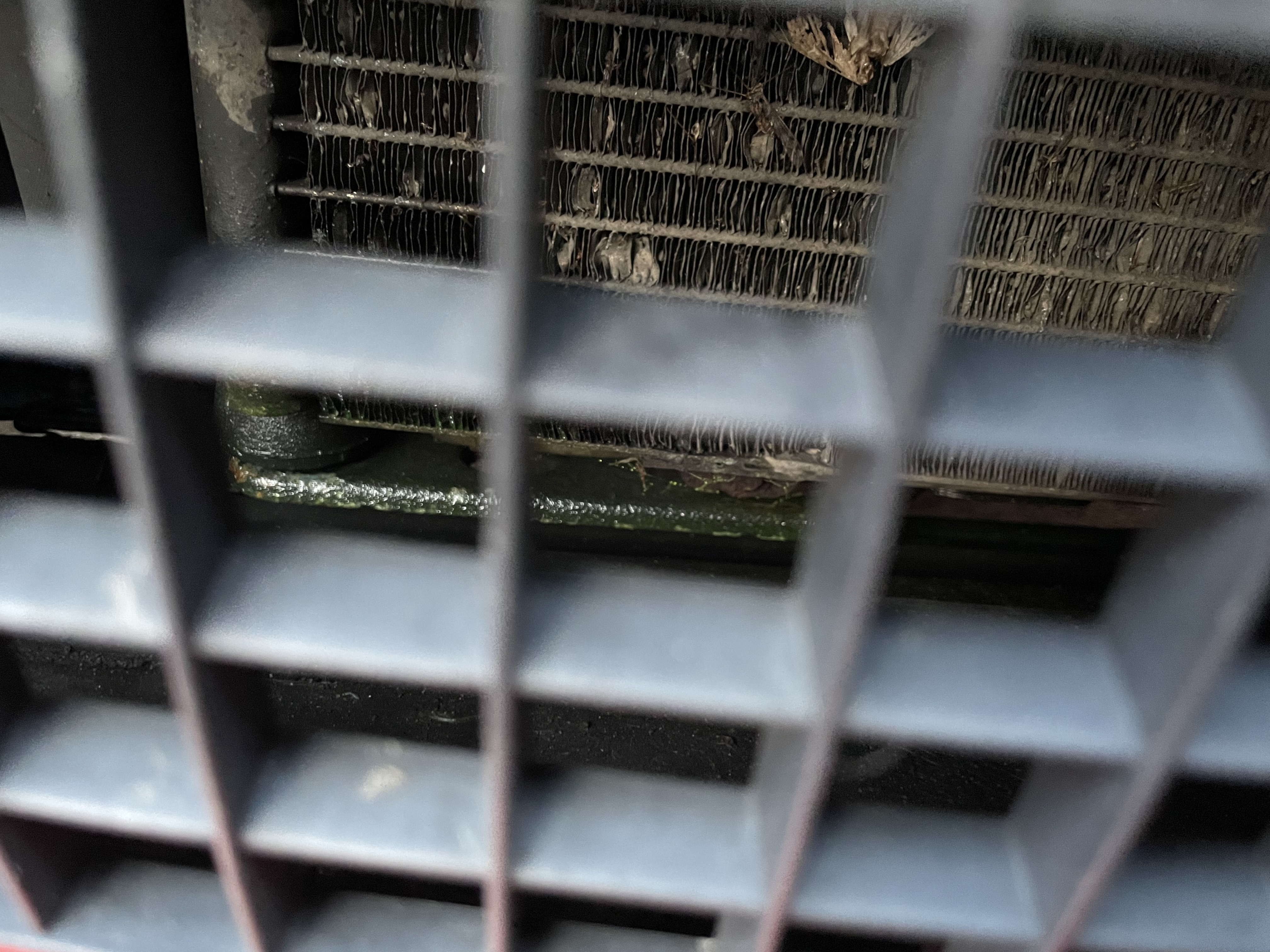

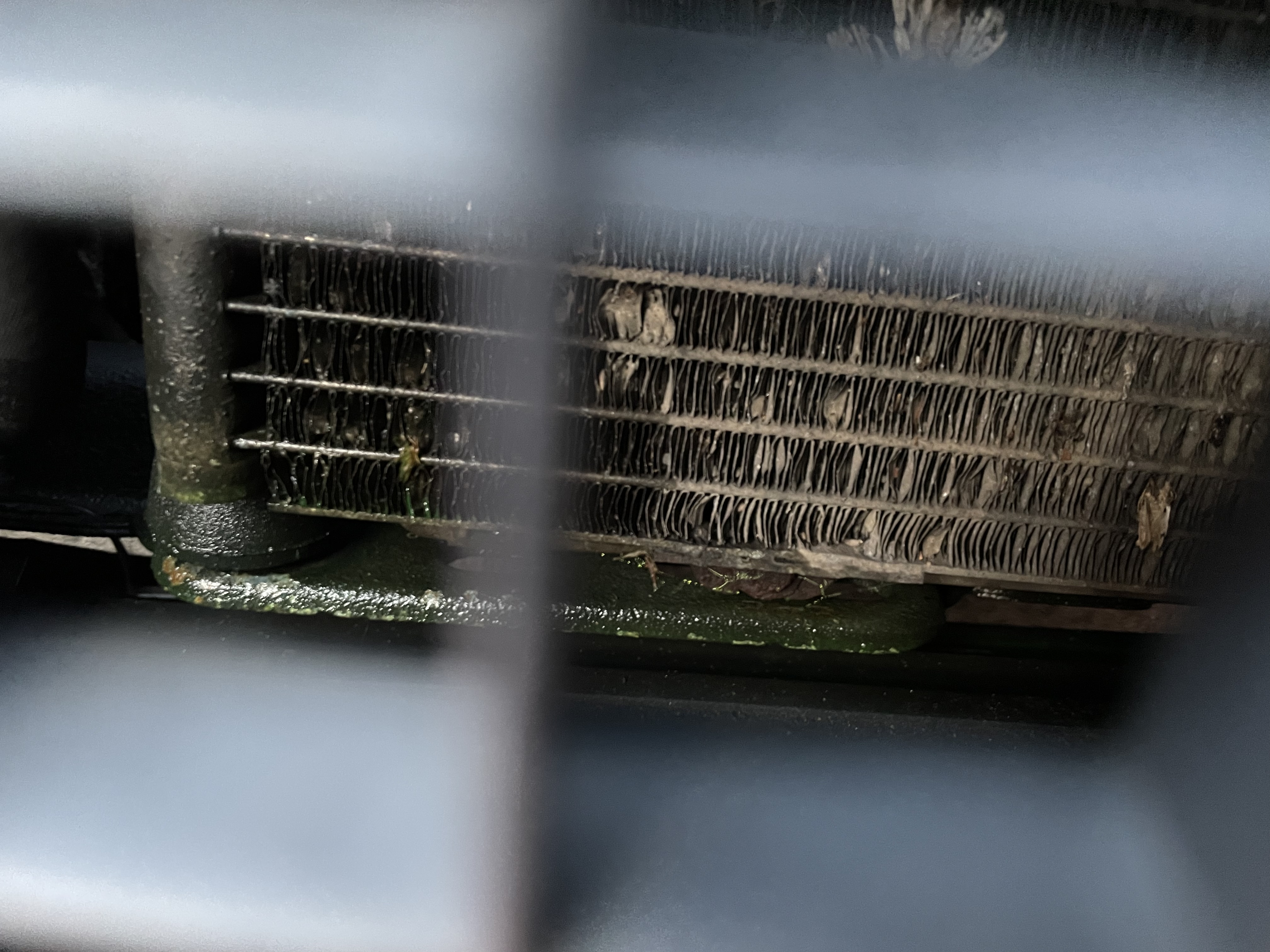

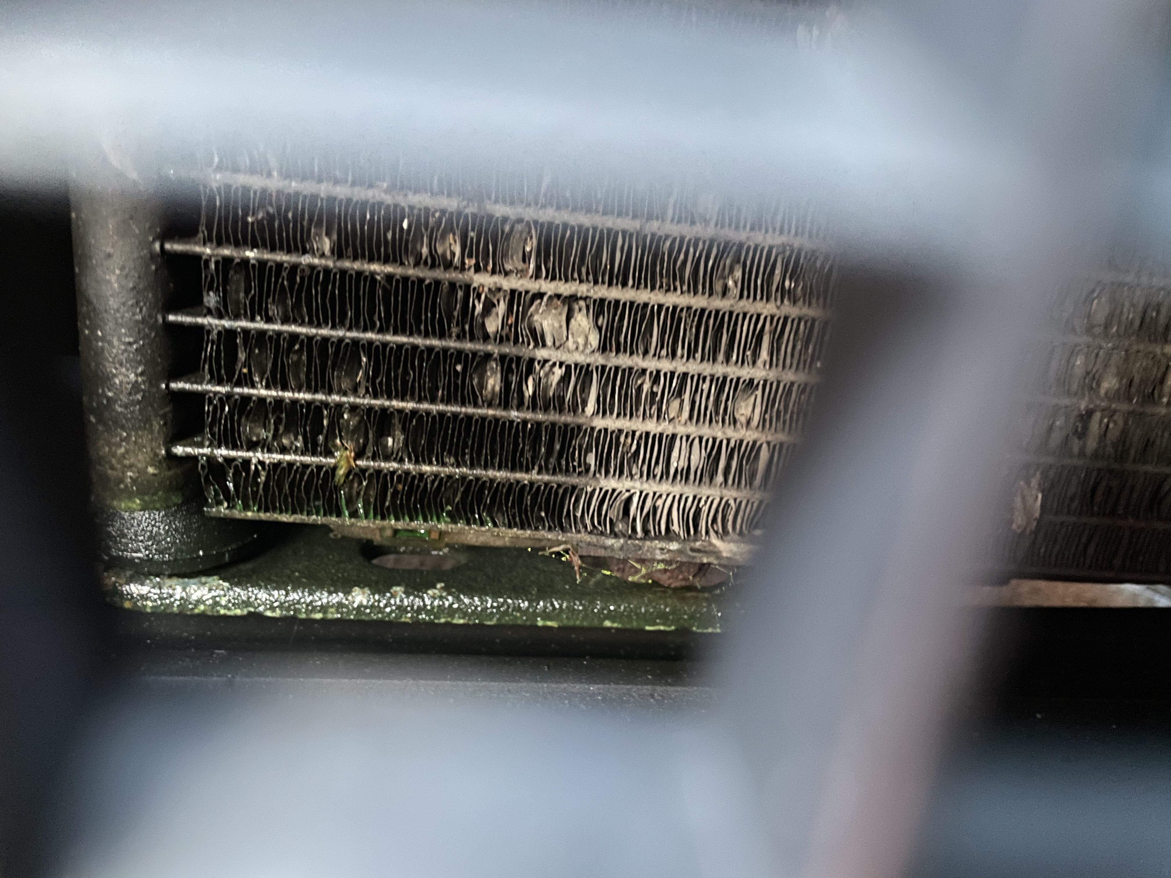

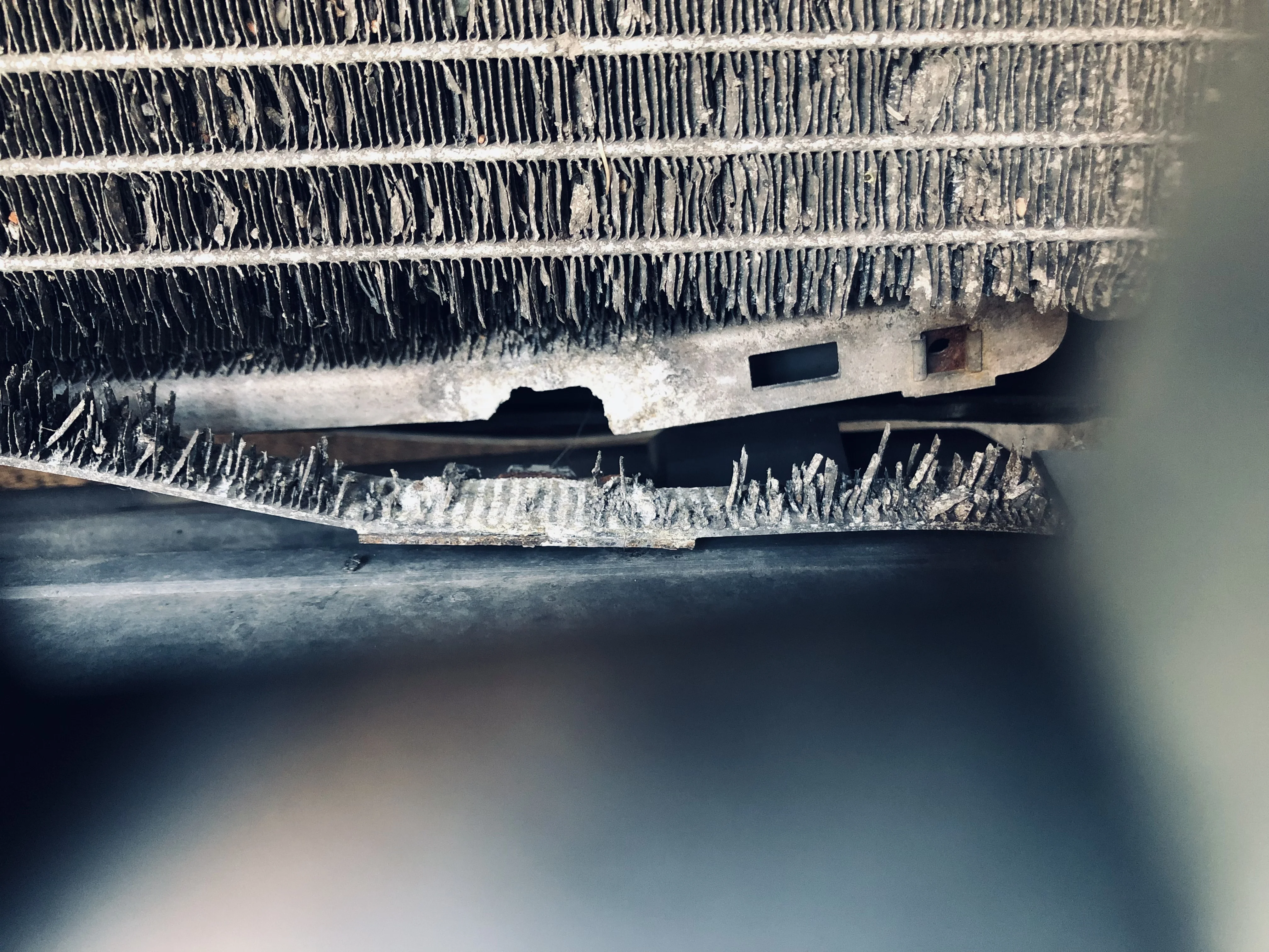

Not that I expect any of you to be able to make anything out of these photos, but that’s the drivers side of the condenser/radiator looking through the lower front bumper grille

Looks like coolant to me.
The dye in the AC oil is usually more luminous looking.
Hard to say for definite. What's your coolant level like, is it going down? It would be very noticeable with a leak like that.
Nah think you’re right; it was REALLY luminous when it came out. Prob is it’s quite cold at the mo, but pretty sure ac not as cold as it was blowing. Coolant level hasn’t moved

I would be pointing towards the condenser, theoretically shouldn’t need to “top up” system. If it’s being re gassed it’s because it’s lost it. Best way to check is if you’ve got someone local who’s ac engineer to get a gauge on it, on 134a you’d be looking at about 3 bar ish on the suction (bigger) port
