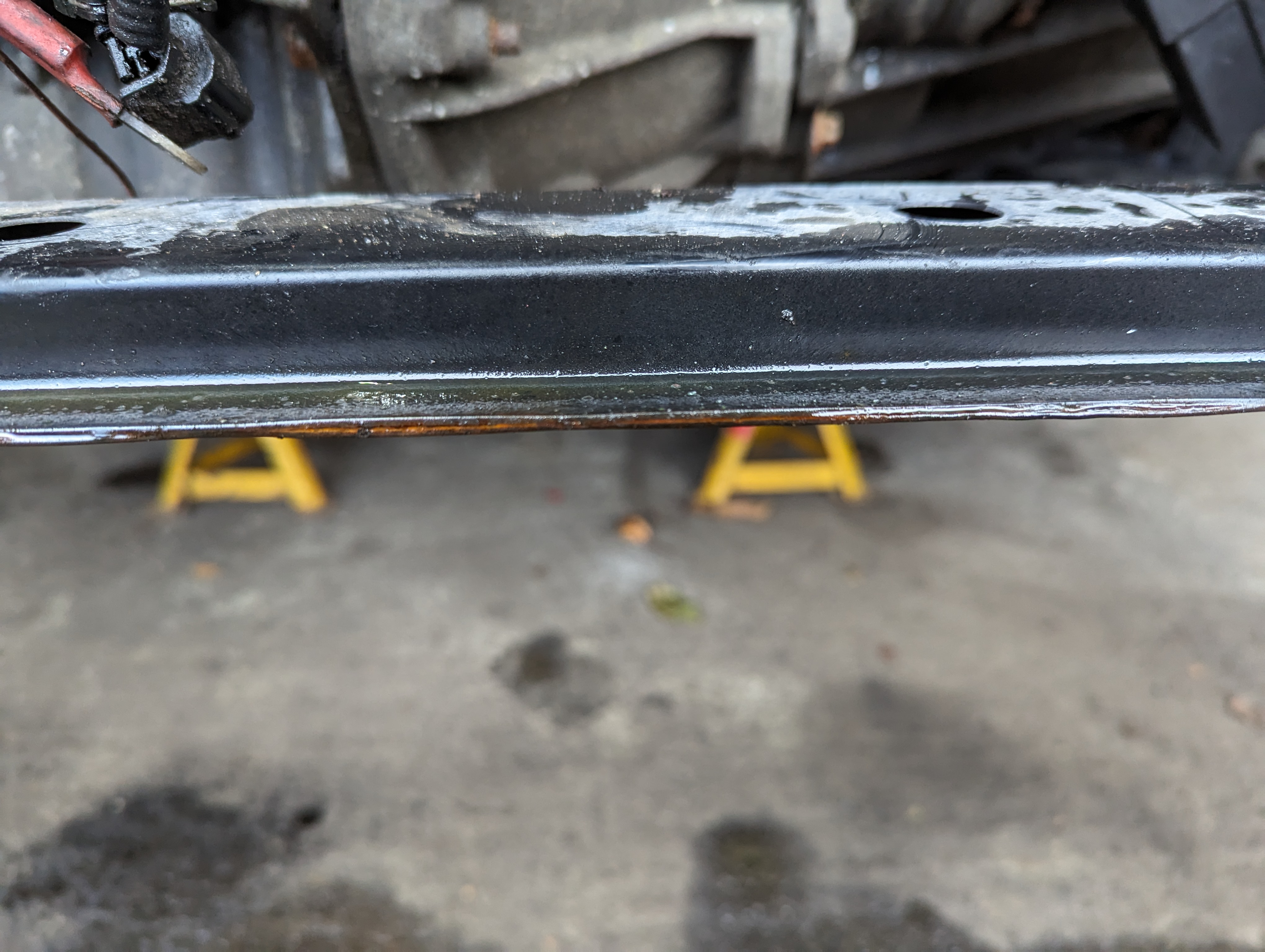

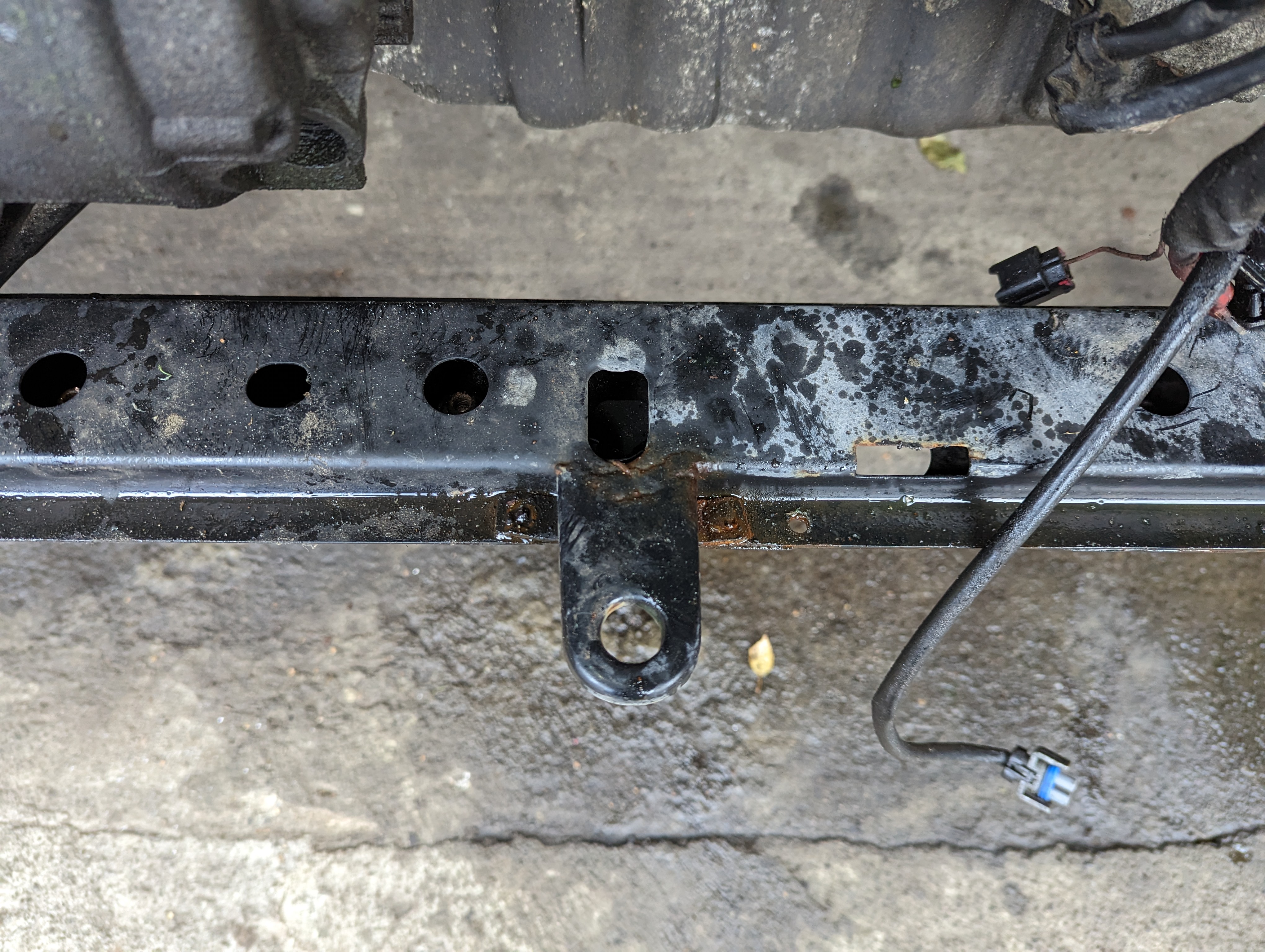

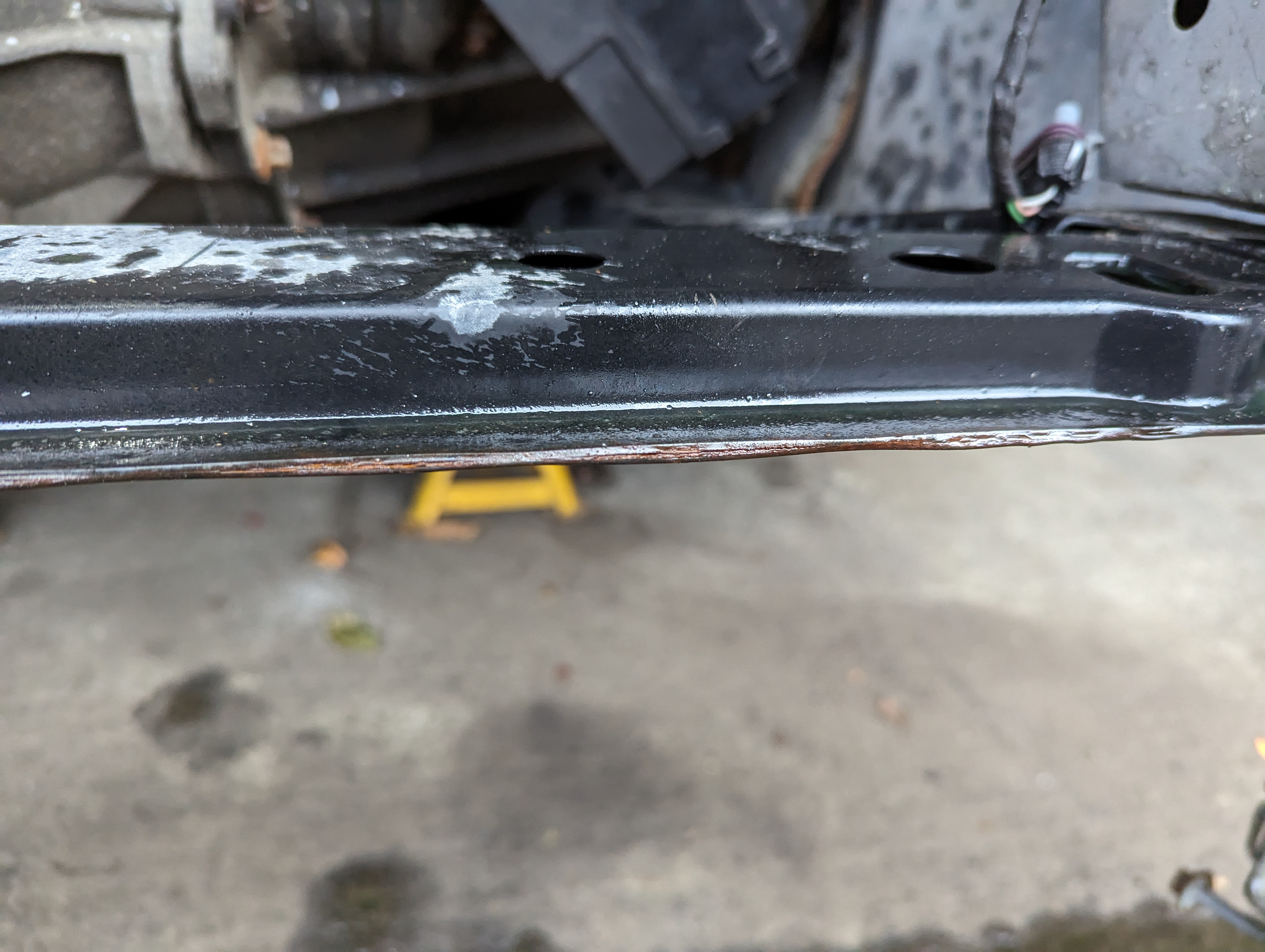

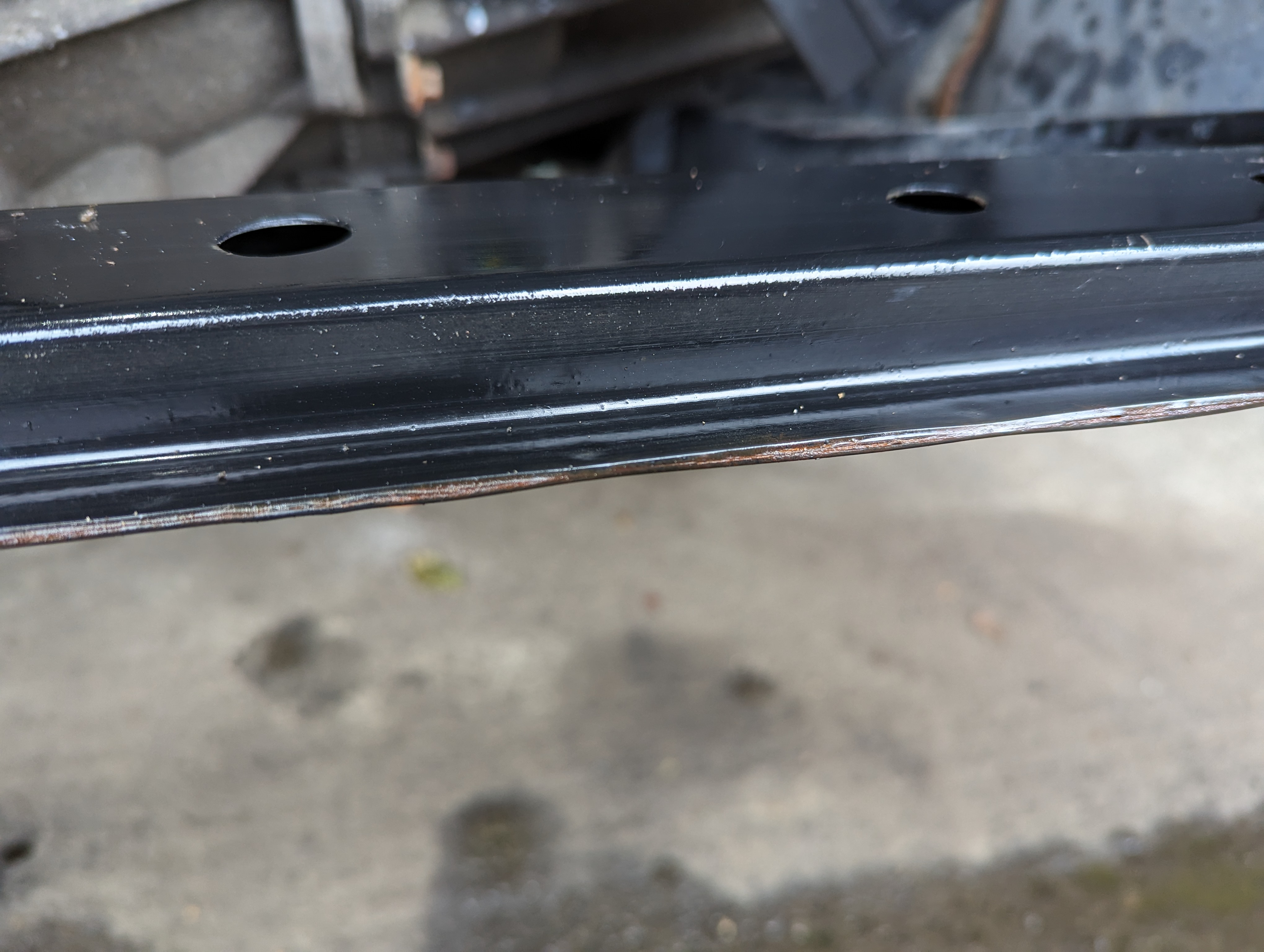

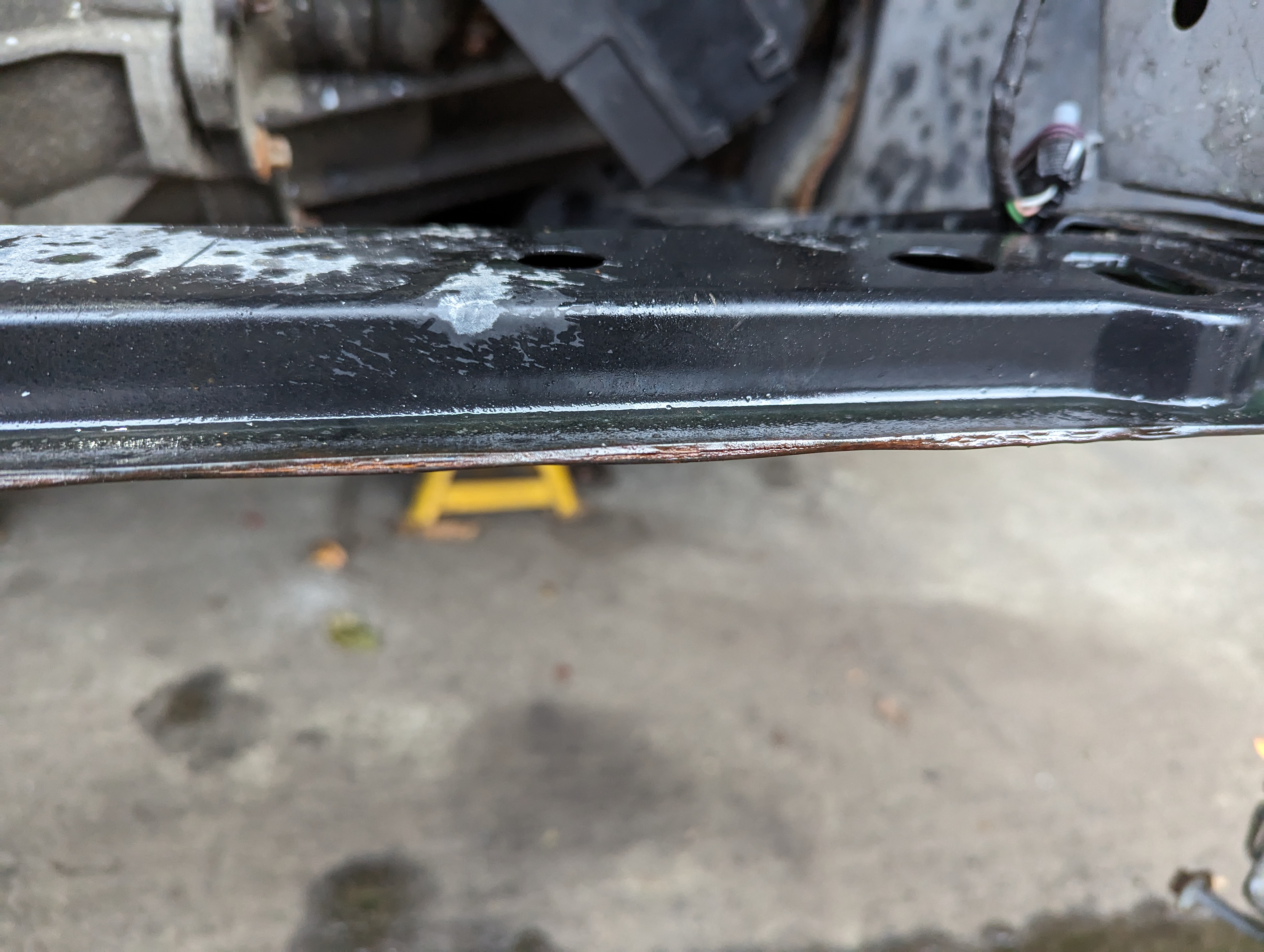

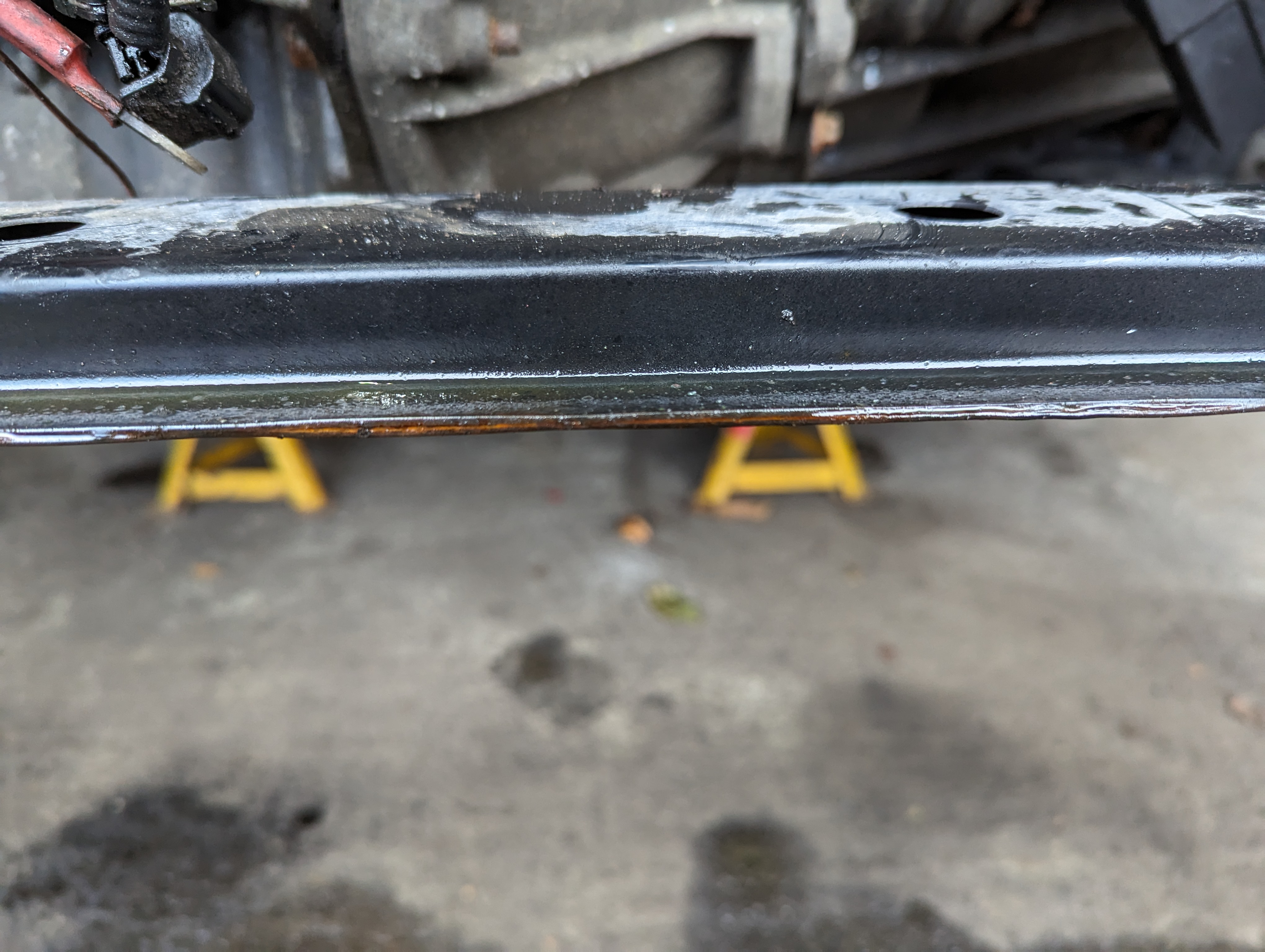

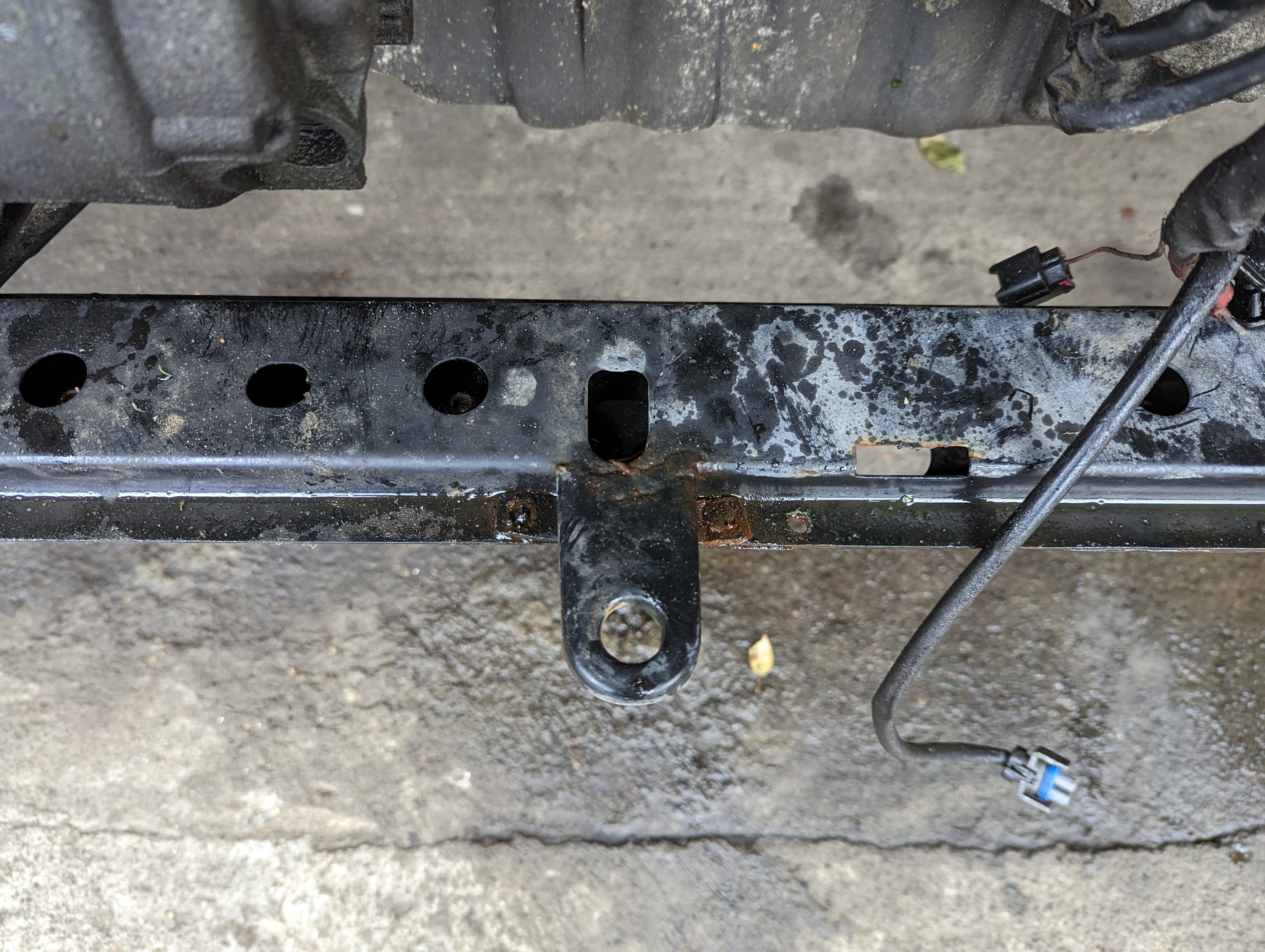

Just an update to this, as I had the car stripped yesterday, it's been fitted for just over 12 months, 1000 miles...
I'd go for the cheap ones as this is starting to corrode already.

Amazing, does anyone know why this part is so susceptible to rusting, whereas the rest of the front subframe does not (or not as quickly)?
