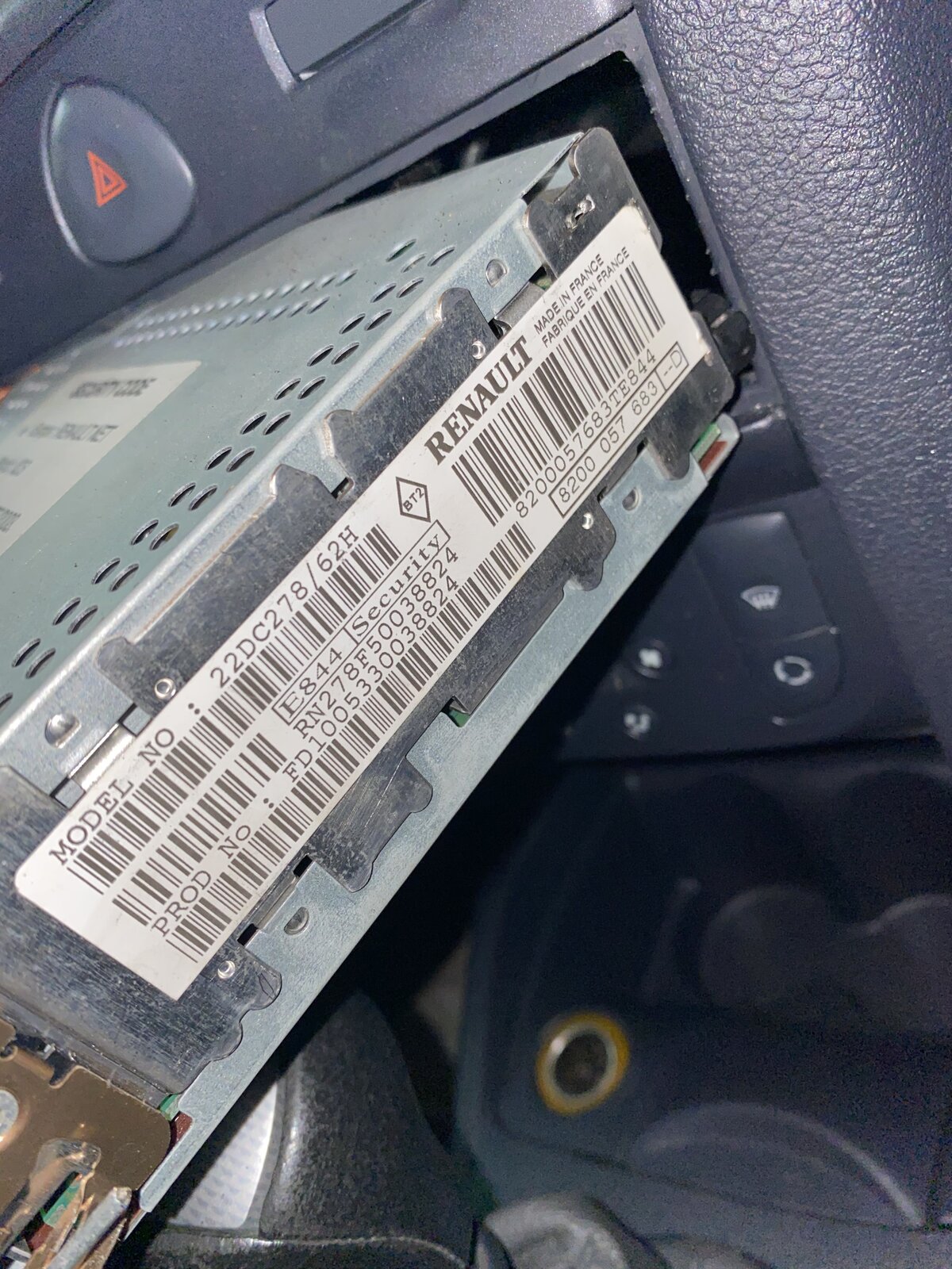

Hey Guys - can anyone help out? lost the radio code for my head unit
digits on the side are E844

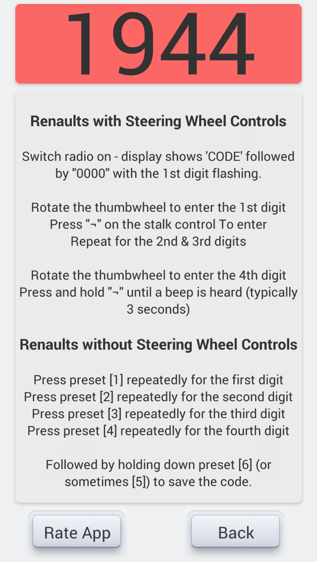

Any thoughts as to why this might be the case? does the radio lock itself for some reason? should i disconnect the battery, reconnect and try '1944' again maybe?
MLB
Did you do the last step? Press and hold the enter button three seconds? It doesn't automatically accept the code when put in.

Yeah, followed the steps; ill dissconect the battery and try again, will see if that fixes it
Crayola
Yeah I got 1944 too
If your headunit is the wrong one for the age of the car (pre-05 is tunerlist and 05 onwards is update list) then the radio wont work at all and you'll just see "ERROR" on the display
If it's not asking for the code hold down 2 and 5 on the headunit and it will reset it, the radio will play for 2 mins and then it will ask you for the code
