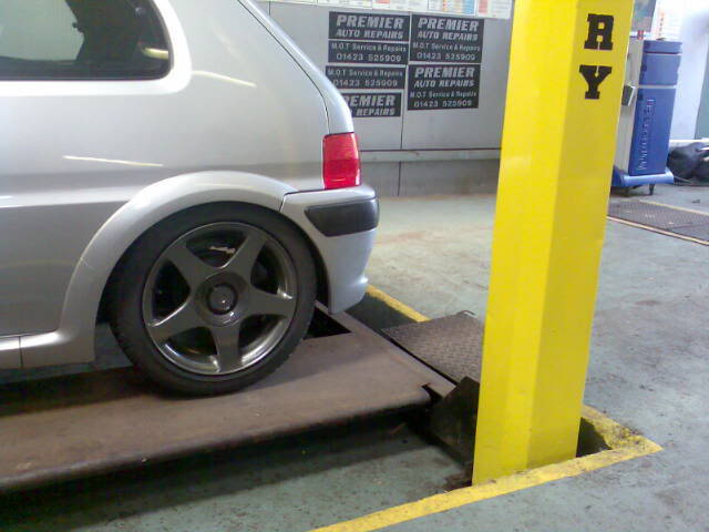

as said above mot ramp should be a 4 poster that sits flush to floor, like so....
as you can see unless the car is literally 2 cms off the floor it shouldnt have any bother getting on the ramp, 2 posters on the other hand are a royal pain in the back side for my 106! have to get trolley jacks under it and then but blocks of wood under the wheels to raise it up enough :clown: the joys of having a modified car eh! :rolleyes:

It wasn't so much getting it on to the ramp, I didn't explain very well. Once the car was half way onto the ramp, there was like 2 sections of metal running between the 2 halves of the ramp that apparantly they jack the car up on while it's on the ramp to check the steering components, and it was these that the car couldn't get over.
But thanks for the replies anyway, I'll take it somewhere with flush to the floor ramps and tell them to reverse it on.
