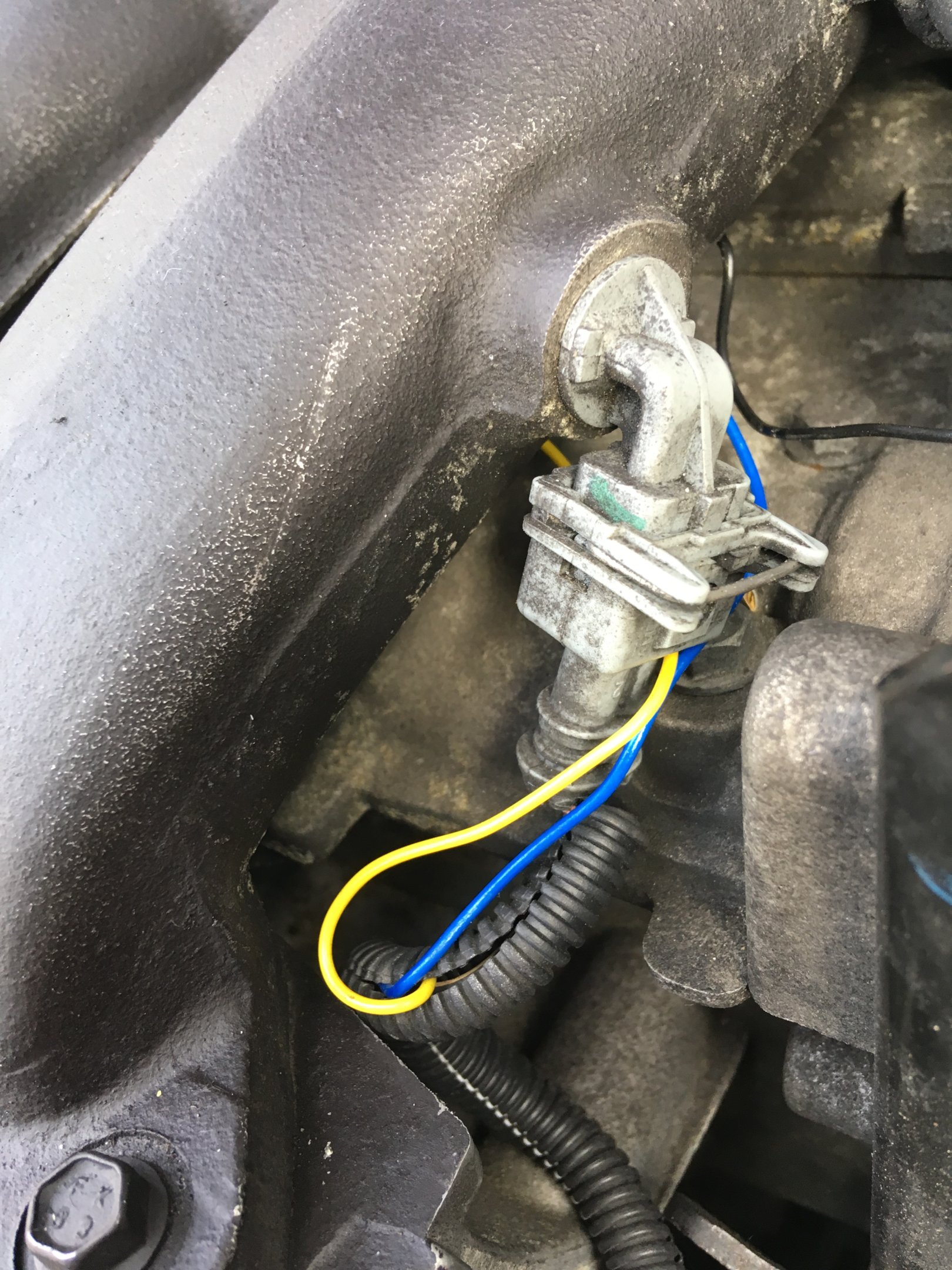

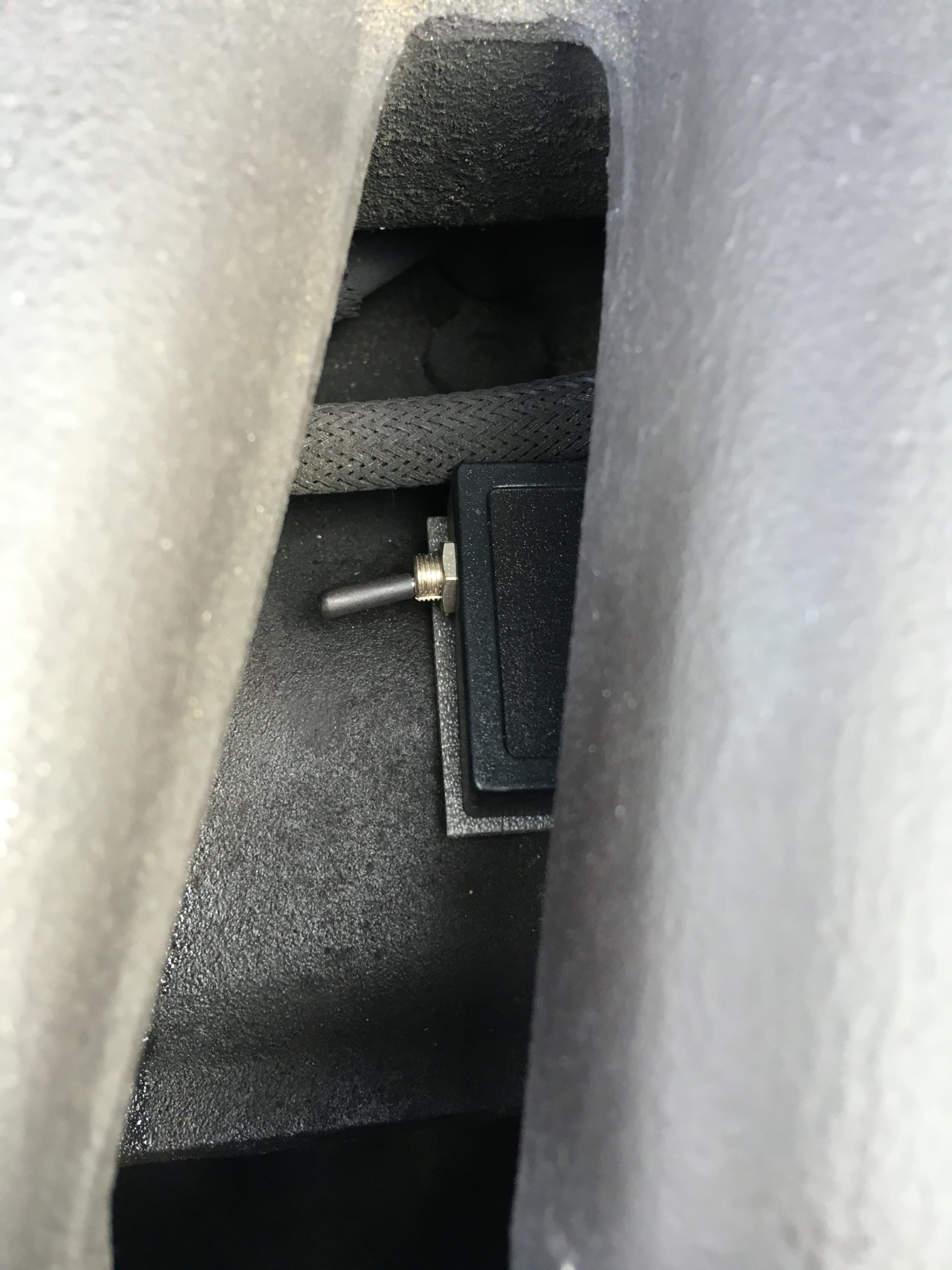

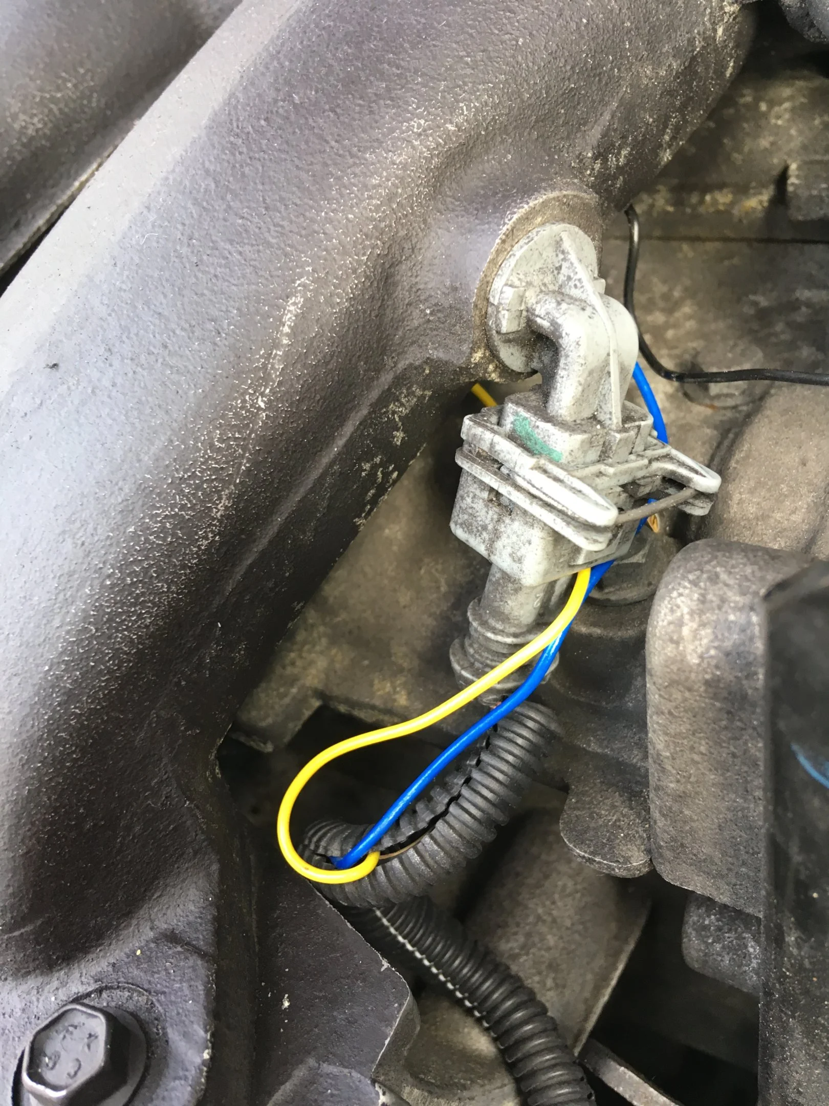

So I have brought a 182 and had a look over it and it’s in pretty good condition just needs the belts doing, but I found a random switch tucked under the inlet manifold, it seems to be wired into the sensor on the manifold? I have no idea what’s it’s for or doing can anybody shed any light?

Wired to the inlet air temp sensor, strange!
Probably one of those old eBay resistor ‘chip’ mods.
Tried flicking it didn’t seem to make any difference, I think I’ll be removing that ASAP any mods made will be proper ones tried and tested from actually experienced members ?

Having been a member of various car forums and been asked whether these 'tuning chips' work a bazillion times by other members, and after seeing how many are being listed on Ebay, i thought it was time to set the record straight on what they are, and the harm they can do to your engine. Firstly, they neither chip or tune your engine - only a proper ECU chip, mapped to suit your car with the correct fuelling/air ratios can tune it (superchip, seb etc) and these are usually 100+ pounds to buy and are a replacement EPROM for the board in your cars ecu. They're NOT a 10p resistor available from any branch of maplins or RS. So what does this resistor actually do? In a nutshell it cons your ecu by sending it false information about the temperature of the air going through the airflow meter or IAT sensor on your cars engine. It basically makes the ecu think the air is much colder than it actually is. The colder the air, the denser it becomes. Dense air (if my physics is right) means that you're getting more oxygen per cubic centimetre (CC) in the combustion chamber which makes the mixture of fuel and air burn hotter, making a bigger bang and creating more power. Its this information that is used by the ecu to adjust the amount of fuel needed for the conditions its sensing, and proper running of the engine. Right, thats the science bit out the way.
So whats the problem with the resistor 'chip' then?? Right.....with one of these resistors fitted, your cars ecu recieves the air temperature info via the resistor which, as said previously, is not an accurate reading of the air temperature going into the throttle body. Because of this, the ecu makes the fuel system of your vehicle deliver fuel at a higher rate than the engine needs. Yes you might feel a small improvement in power (although in some vehicles the opposite is true) but too much or too little fuel is pretty serious as it can lead to detonation, lumpy idle, bore wash, higher emissions, lower mpg and, in extreme cases, even wrecked pistons!! Anyone whose ever had their car in for repairs at a garage will know how costly in terms of inconvenience and money this can be, and dont expect much help from the seller, as the small print on the packaging will state that no liability will be taken for damage caused from use of the product :(
