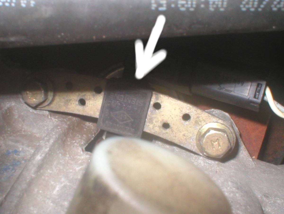

When you are stood in front of your car looking at the engine. You look down the right hand side, where the gear box bell housing meets the engine block. There is a sensor with 2 wires going to it. It'l held on by a kind of curved bracket.
I literally just whipped it off (2 little 10mm bolts I think), cleaned it up with some GT85 and stuck it back on. Car hasn't missed a beat since. :cool: It's a bit fiddly to get to one of the bolts but it's no problem really, I just used an angle joint and an extension on my small wrench.
