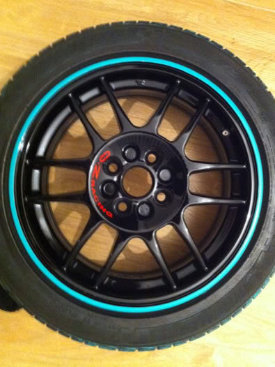

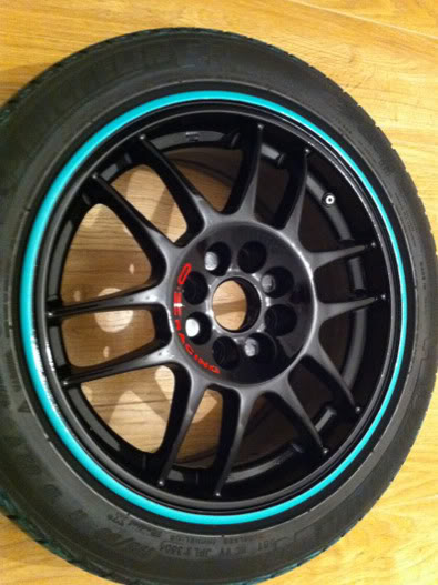

I did 172 alloys twice, and did an o.z f1 to match a set I had.
With the 172 wheels I did the following:
Attacked any AWFUL bits with a 120, then worked this up to 180, 400, 800. (i.e the lip around the edge, and the proud bits of the spokes)
I then attacked any not so awful bits with 400
Then went over the whole wheel (EVERY SINGLE NOOK AND CRANNY) with 800.
I then did three coats of primer, 800 flatted any bits that weren't perfect
Then three coats of paint. (If you mess up at this point, 800 and blow it in)
Then did three coats of lacquer. Done.
I do however promise you that once you're finished you'll regret doing it and not paying, as it's hard f**king work.

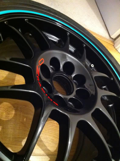

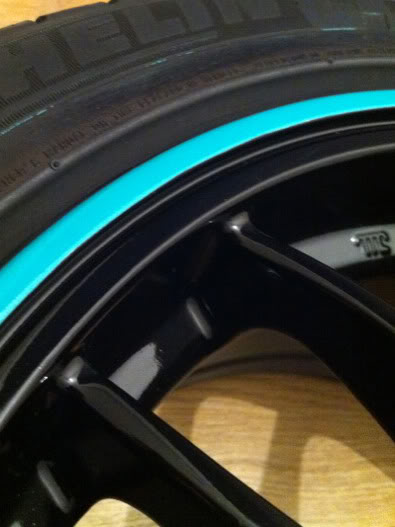

Here's the level of finish you can get with rattle cans and a little patience:
Or here's a 172 wheel:
Wow, there's some proper hard work gone into those Rob, they look amazing!

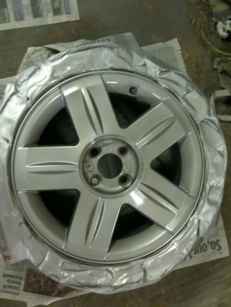

here they are

After looking closely at the wheels, they're not as bad as I thought,
but there are some nasty bits that'll need repairing before any coating happens.
^^Quite a nasty dent.
^^Probably the worst bit, although most of the wheels have some sections like that.
Any advice/comments on how best to sort these out would be appreciated,
as would a rough idea of repair costs.
