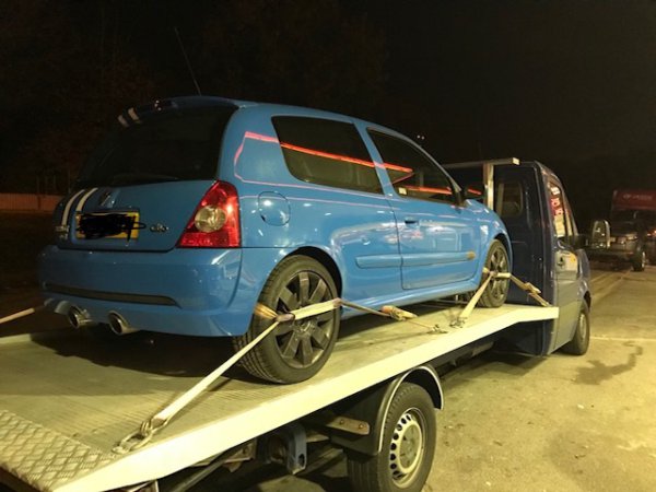

Anyway... the shell of the old one is bent so I’ve bought this -
Absolute bargain, it popped up on eBay on Tuesday night advertised as a non runner so I messaged the guy, struck up a deal and me an my mate Scot drove to Chelmsford on Wednesday night to drag it home, strange it was in Essex as the old car was too!
Stuck it on the truck, got back to his unit at 11pm, unloaded it and set about diagnosing the issue. Put the jump pack on it and realised the fuel pump wasn’t priming, wiggled the wires, still nothing so Scot grabbed his power probe to check for continuity... nothing, switched it to supply power, turned the key and vroom, it fired right up! This obviously pinpointed the problem straight away, after about 5 minutes of diagnosing, all it was was the fuel pump fuse!
The only issue now is that it’s probably too good to strip, but hey ho, until they’re worth £10k I won’t feel guilty.
