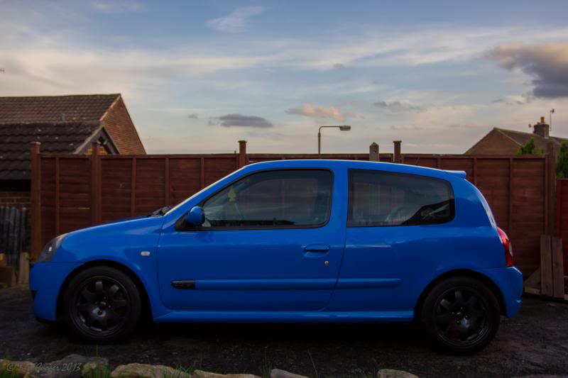

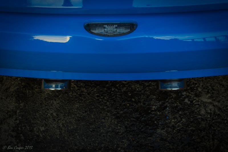

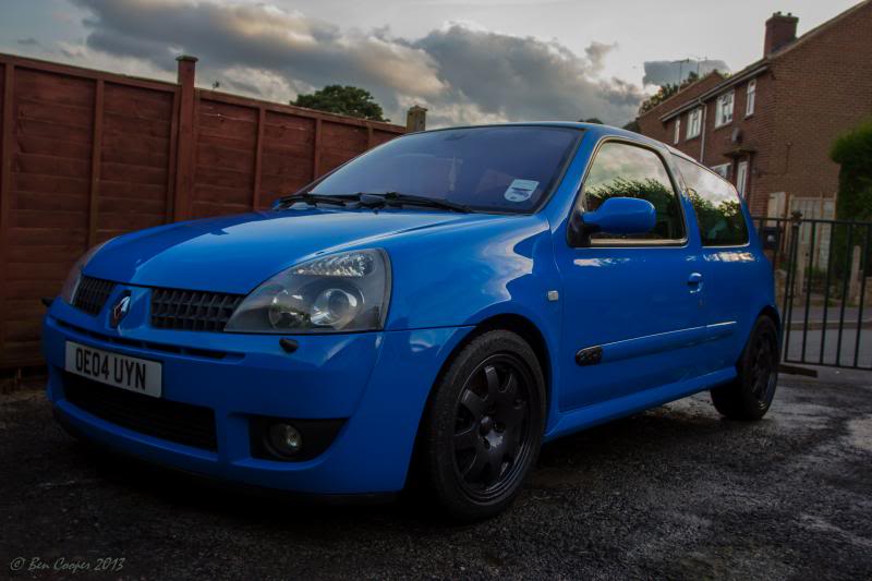

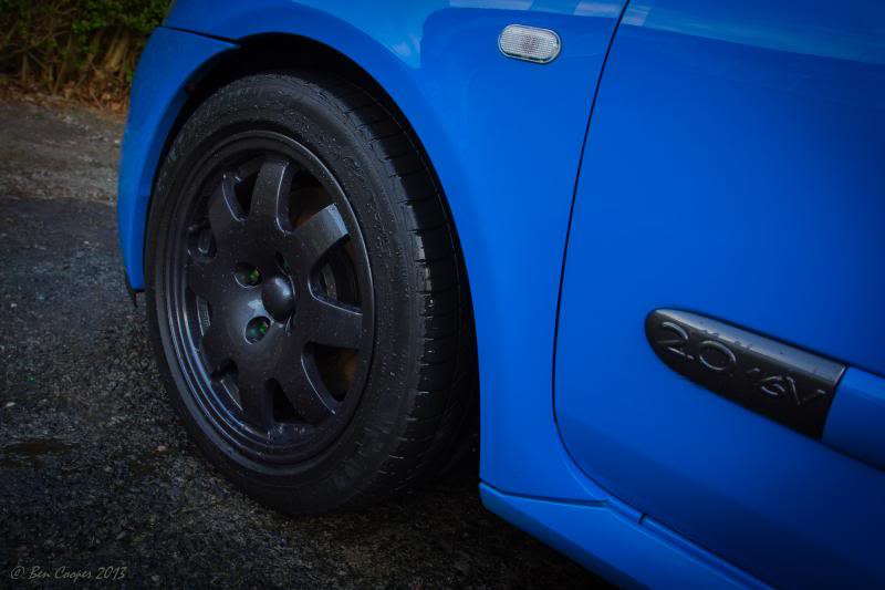

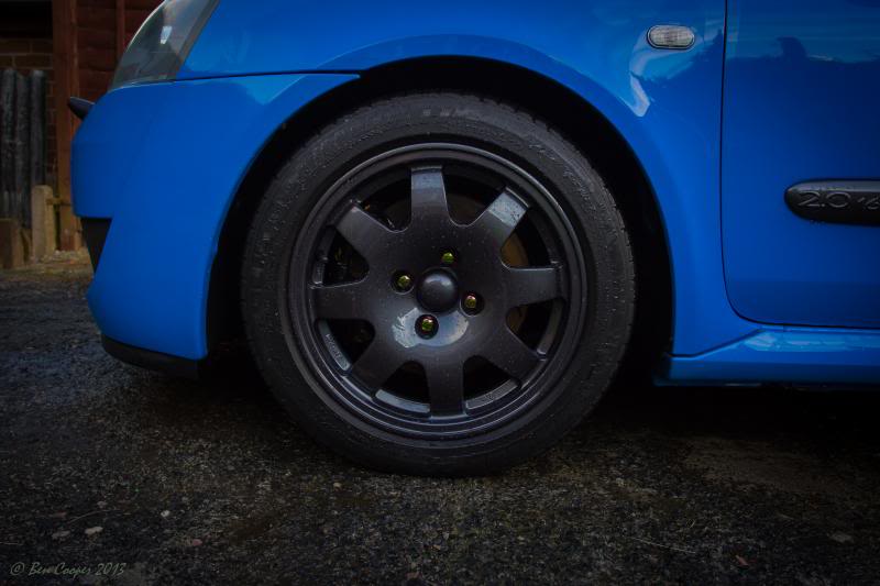

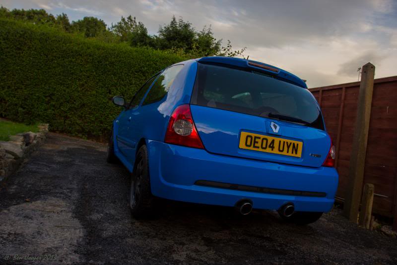

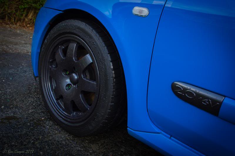

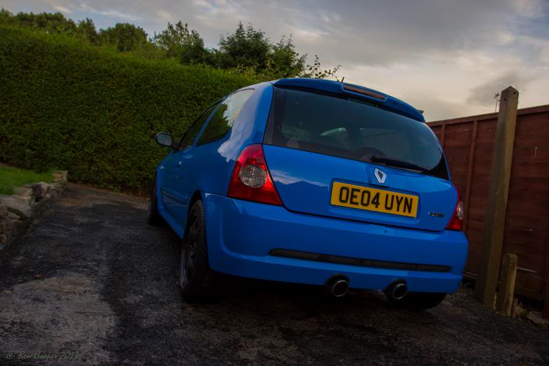

New willy wheels and janspeed fitted recently.
exhaust fit to the bumper pics first, Coops mod to get it to sit proudm, can just read the janspeed branding :)

Boom - the pics are just poorly processed chap, hence dark as hell, my laptop screen is a major let down for PP so I need to sort something. I just cba going back over them tbh for boring on the drive pics anyway.

I've always had a strong dislike for willy wheels on a 182, but I fitted some to mine this week and they look so much better in the flesh!

100%, had willys on my cup for a good while now, on photo's it looks s**t! in the flesh it looks superb!

Just seen this old post of yours.
I have been wanting to put some different tyres on my 172 Cup as I just dont like the Rain Spott 3’s that it came with, the side walls are just too soft for me.
I have a spare set of Williams wheels that I had sort of forgotten about, that would be a great way for me to have some different tyres on the car.
What size tyres did you fit on your rims? Did they mess around with the speedo accuracy at all?
What about off set etc, did you need spacers?
I want to do something to enhance the handling

Holy thread bump batman! lol!
I run 195/50 R15 Michelin PS3 tyres on the Williams wheels, the offset of them is ET36 so like running 7mm spacers all round so they bolt straight on with no issue and fill the arches slightly better with no scrubbing issues even when lowered (in these pics think it was on cooksport springs and standard shocks).
I also ran spacers along with the wheels in these pics, 15mm front and 10mm rear iirc and that did cause some rubbing but I just coped with it as it looked ace, lol!
don't really notice any speedo issues, the speedo isn't mega accurate anyway in all honesty on the original wheels and tyres.
