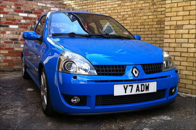

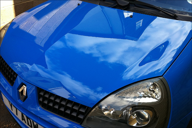

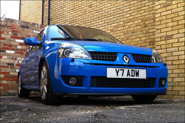

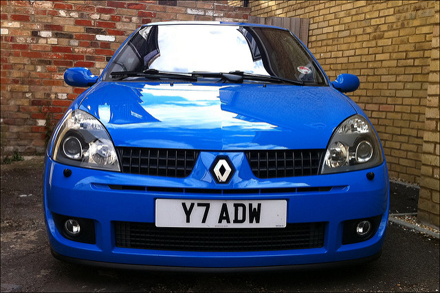

Thursday I had the afternoon off and decided to give the RB a machine polish. I have no photos before or during as I was on a mission as I new I would run out of light. I would say it is about 90% corrected, with a few light stubborn scratches left, but as i'm an a perfectionist lol, it will do for now, at least the swirls have now gone.

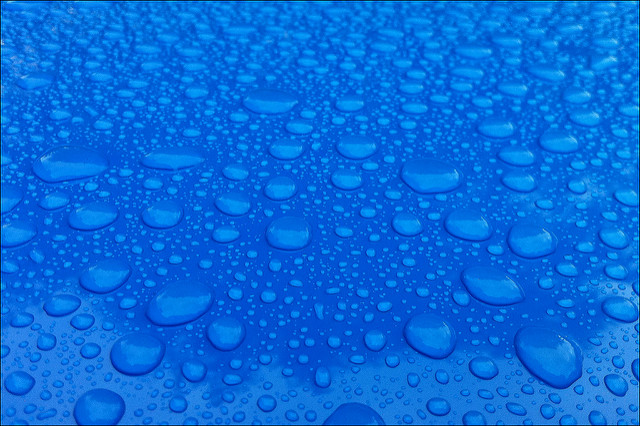

And some beadage..

Cracking results there Ash. I'm a HUGE fan of your car. I'll be looking at doing pretty much exactly the same on my BG soon after the purchase of a DA. How did you find the menz products? What pads did you use?
  RB One Eight Two
Looking good mate, how do you rate the DAS-6?
Cheers mate. The DAS-6 is a superb polisher to be fair. If your looking to buy your first Machine Polisher then I rate this very highly. Really easy to use and with the right products/pads etc it is superb.
Cheers buddy :) Get the DAS-6 mate its a superb polisher and easy to use. I used a Green and Black Hex pad, its just a case of try it see how it comes up and then try it again sort of thing. Thanks to Gally for the advice. The Menzerna products are great, really rate them also. One thing I will ay after correcting my cousins Honda CTR is that Renault paint is very hard.

lovely mate i agree it took me ages to remove swirls on my rb and im not happy with the results one bit. how long did it take you out of interest? looks like you have done an amazing job anyway well done.
  RB One Eight Two
Cheers for the comments guys, appreciate it.
I spent about 5 hours on it with the polisher and in total about 6 half hours. Wasn't happy when I came back to the car yesterday afternoon to find it covered in tree sap after parking it up at a wedding venue :(

Kingy - it was a state before mate believe it or not. Everytime the sun was out or it was sitting under lights it did my head in, as you know what I'm like :eek:
Looks great, as always mate.
You sound the same as me. Most people thought that my car was looking mint, but I knew its dirty little secret ;) I just had to correct that paintwork. Im still not happy with the finish on mine though.

car looks great, would have been nice to see before pics to compare.
what compounds did you use with the green Hexlogic pad? I used 203 with an orange cutting hexlogic pad on the DAS6 and didnt get great correction
  RB One Eight Two
Cheers mate. I was using 203 with a green Hex pad and just seeing how it goes, it turned out not too bad.
