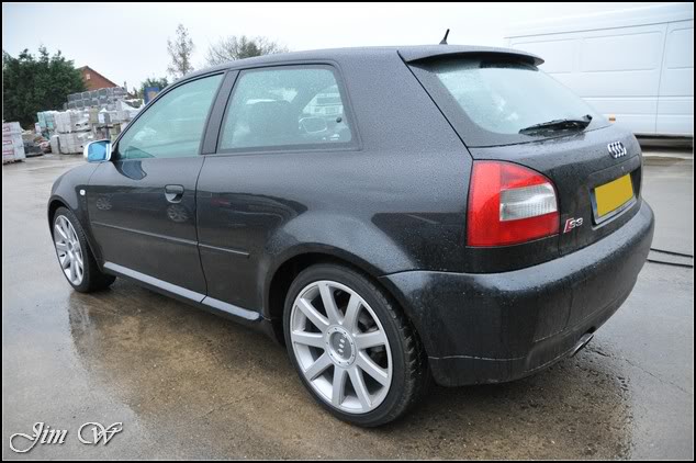

Quick inspection:

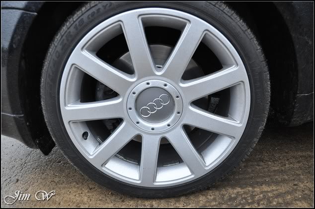

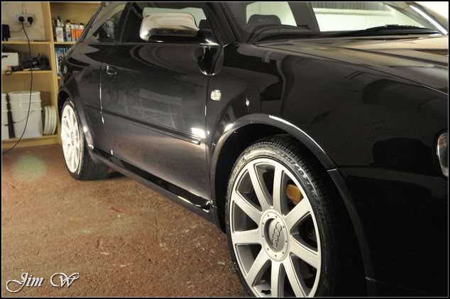

Recently refurbished wheels:

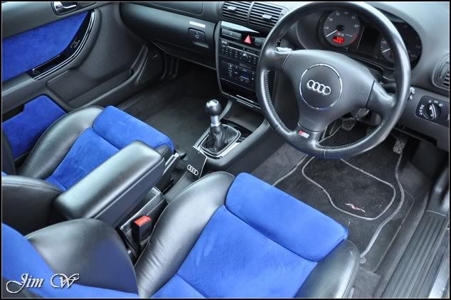

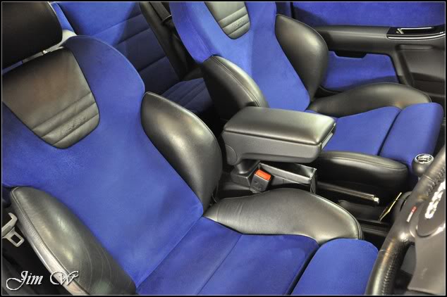

Nice colour combo on the interior; going by photos I'd seen previously, I wasn't a fan of the part leather, part alcantara, but I must say it was stunning!

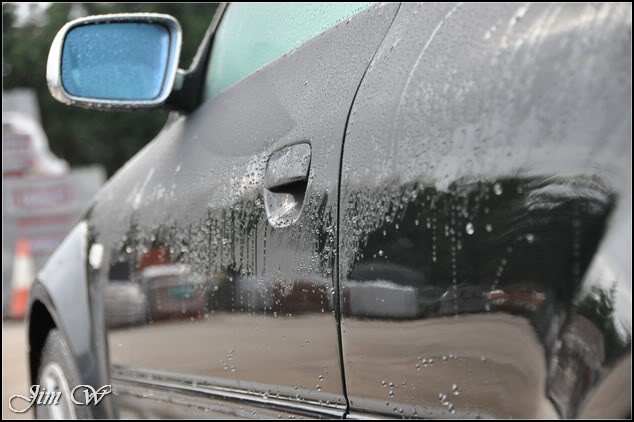

Starting with the wheels – other than a blast with G101 and slight agitation, they didn't need a lot. Arches and tyres soaked with Megs Super Degreaser and scrubbed. Engine-bay covered with Super Deagreaser, agitated and later rinsed on medium pressure.
Washed via the two-bucket system and Dodo's Born to be Mild shampoo.
Previously protected with Blackfire (all finish paint protection and the midnight sun wax)

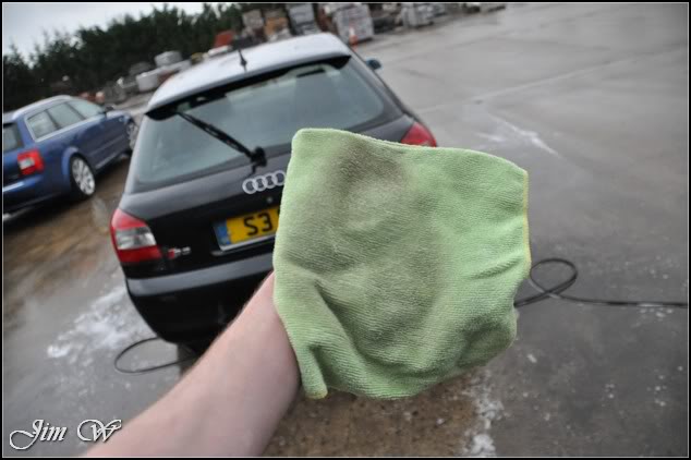

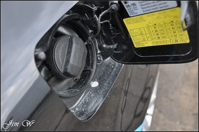

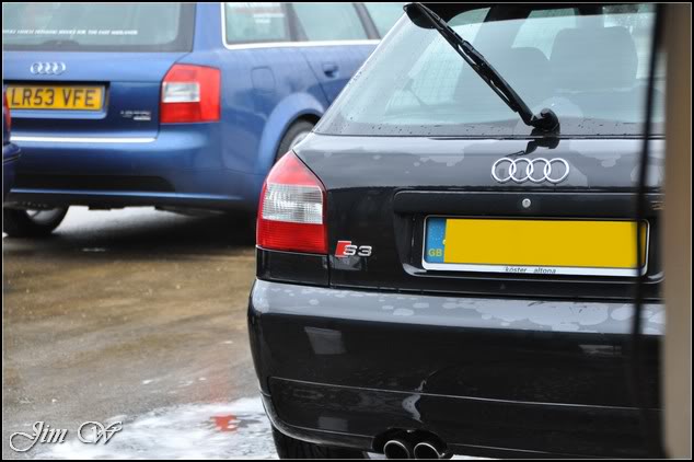

AS Tardis used to dissolve tar deposits.

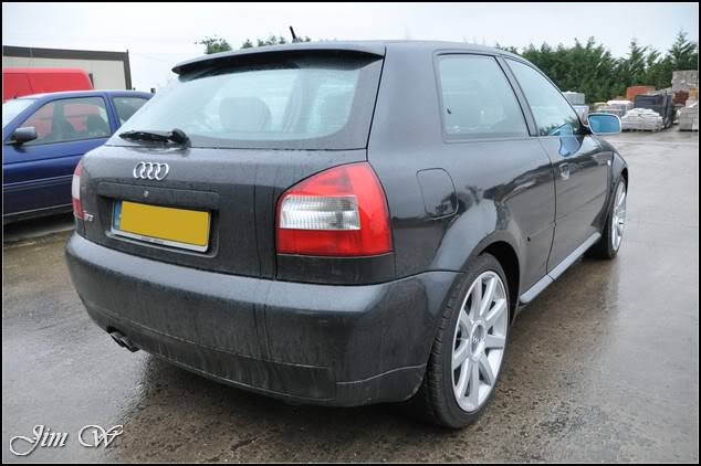

Tar is pretty tricky to spot on a black car! I didn't think there was a lot there but the towel used to remove the residues proved me wrong:

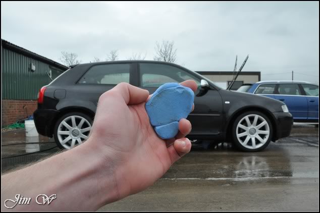

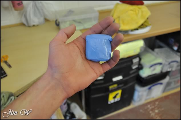

Now, thanks to Alan @ http://www.amdetails.co.uk/ here... He'd sent his new mild claybar for me to trial and I must say, I was very impressed.
Dunked in a bowl of hot water to keep it malleable, I set about claying the car.
The paintwork was relatively clean already though; the owner claims he'd clayed it himself just under a month or so ago. Very little contaminants picked up:

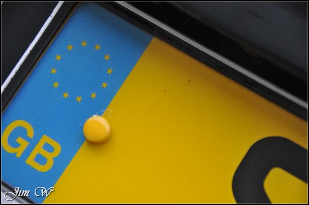

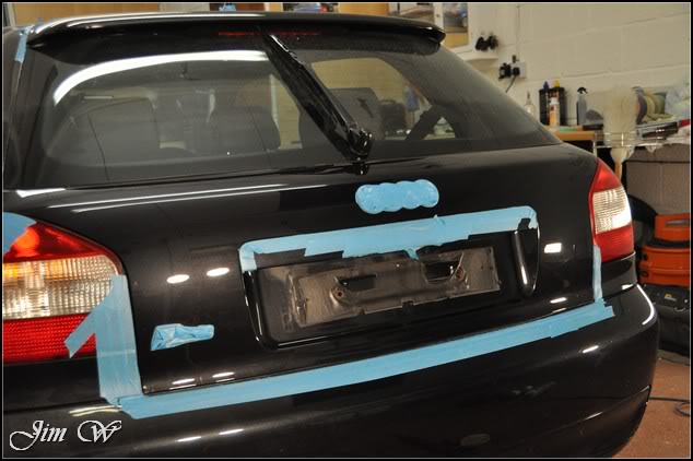

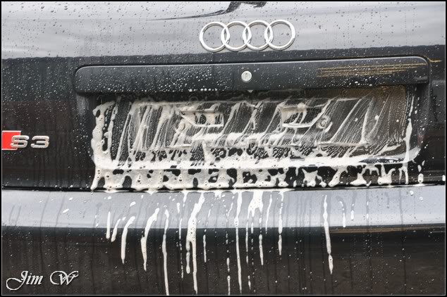

Rear reg. plate removed to assist machine polishing later:

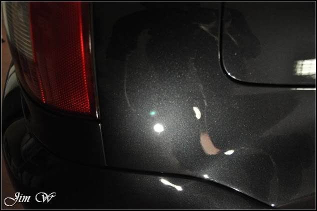

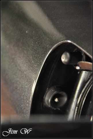

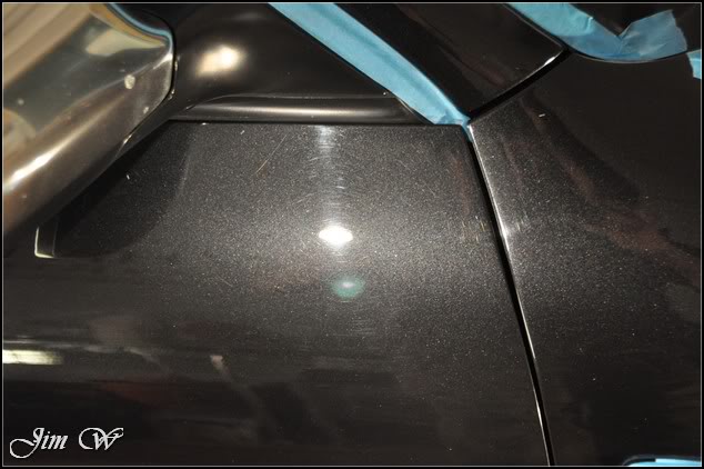

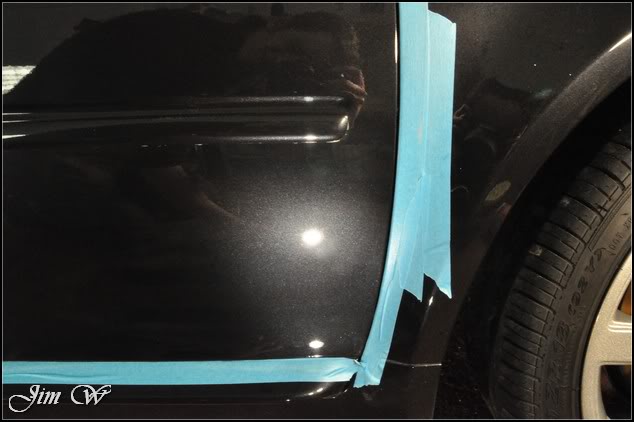

The owner mentioned that the NS had been painted due to someone catching the rear quarter a year or so back.

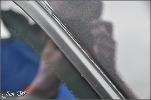

Paint looking a little streaky?

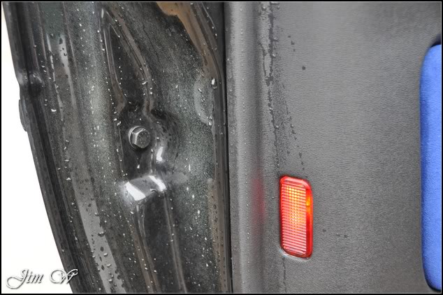

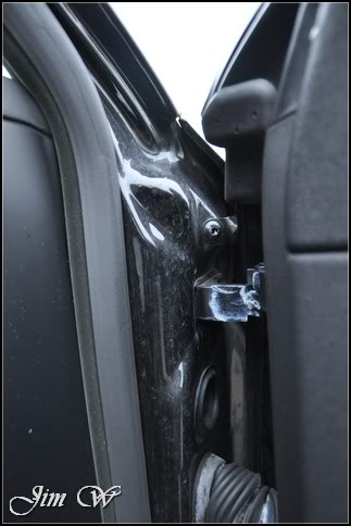

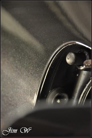

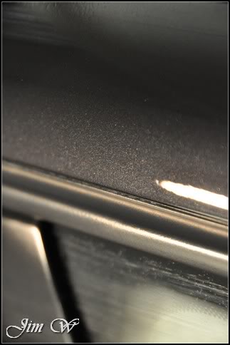

and with overspray in the window rubbers and doorshuts:

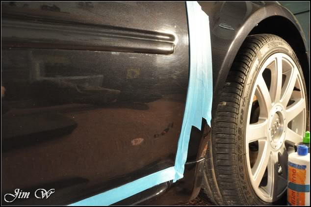

After bringing the vehicle inside and drying it down, it turns out both the NS and OS had been painted. Only areas with original audi paint were the boonet, the roof, the bootlid and two front wings.

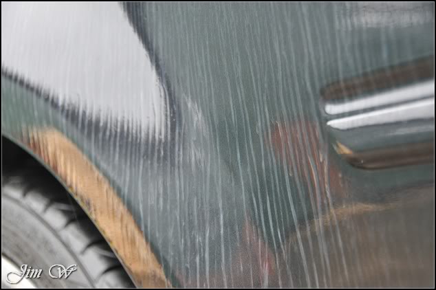

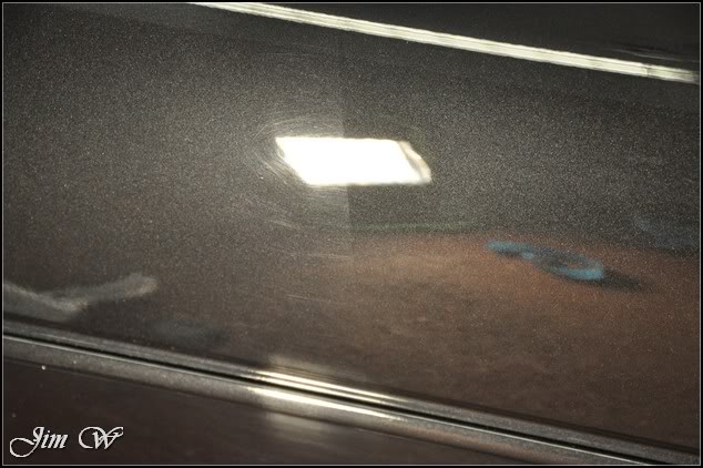

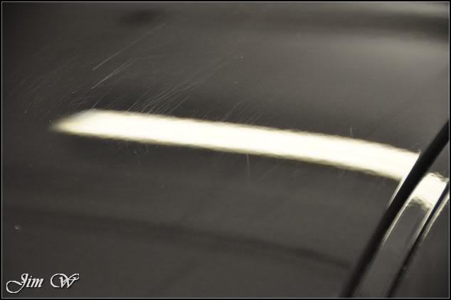

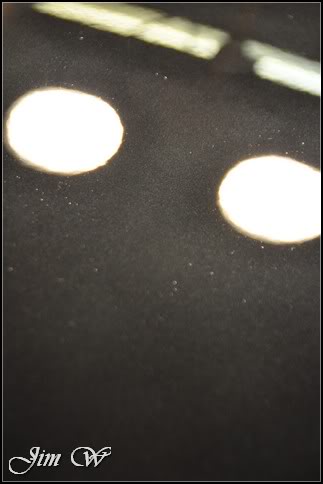

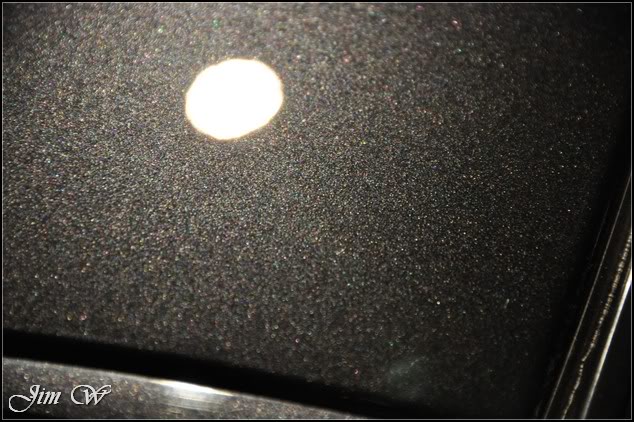

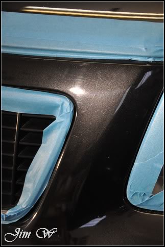

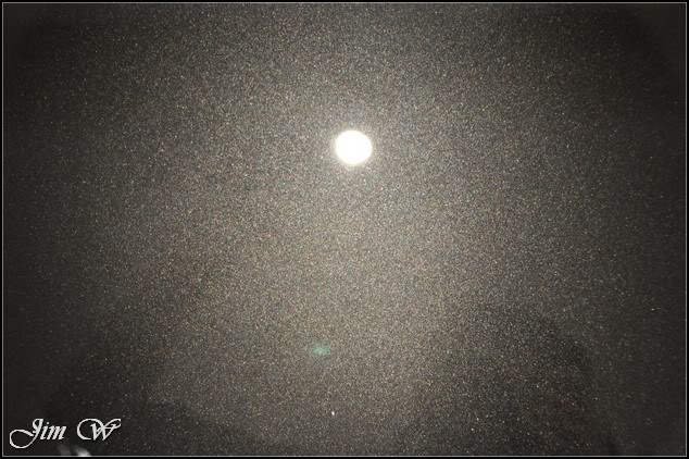

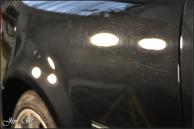

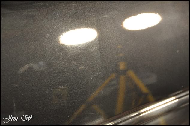

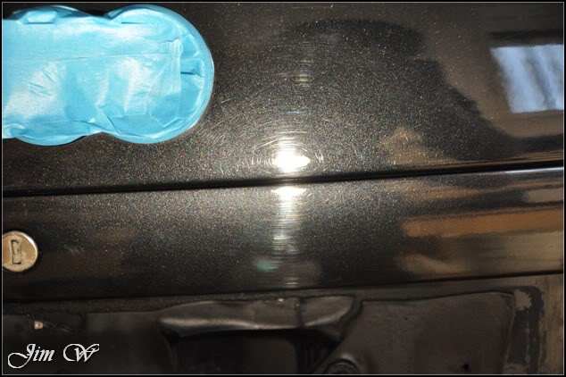

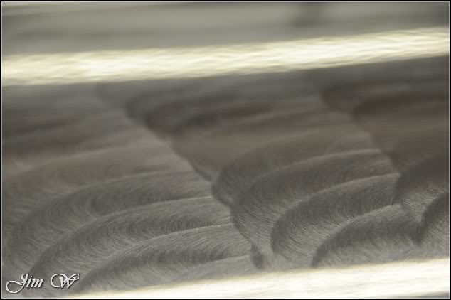

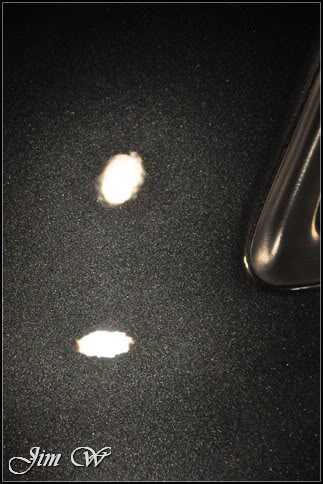

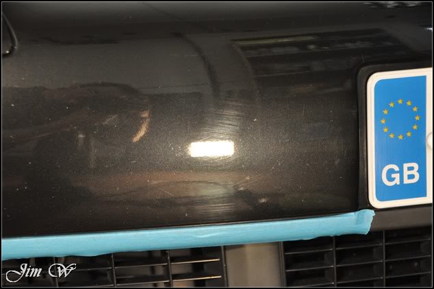

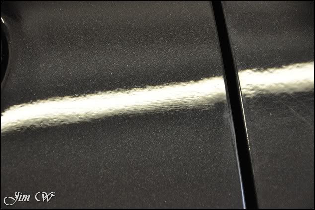

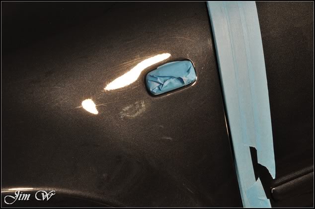

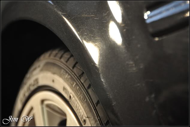

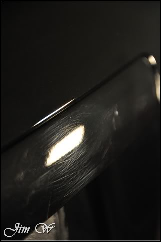

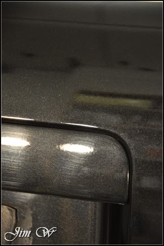

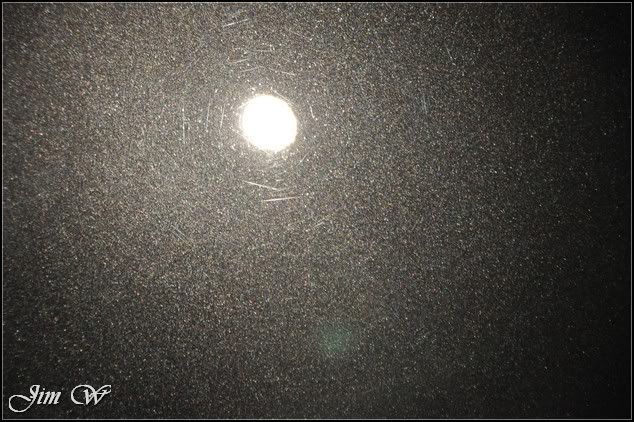

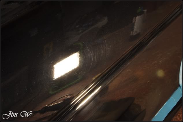

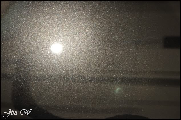

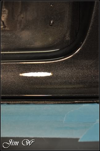

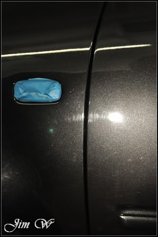

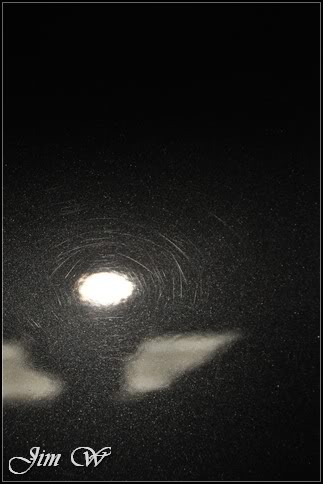

In terms of 'defects', the car wasn't too bad. Not so much your general swirling, but more deep scratches from bodyshop sanding, polishing etc.

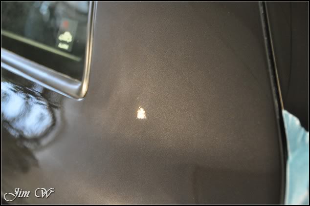

Flat spots:

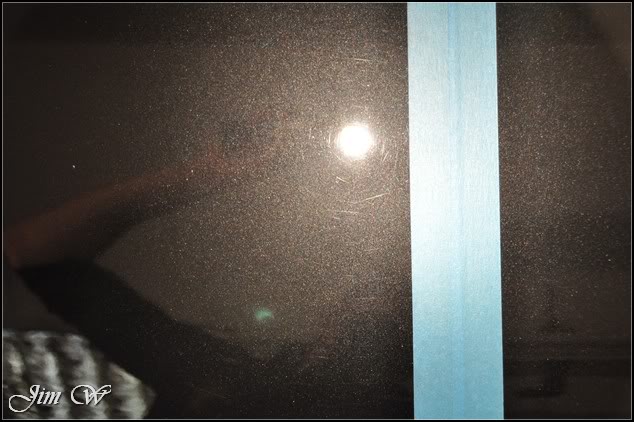

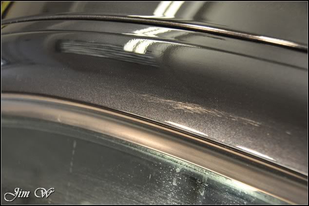

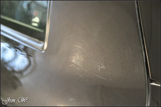

A tree/branch had fallen on the NS leading edge of the roof which had left some nice scratches:

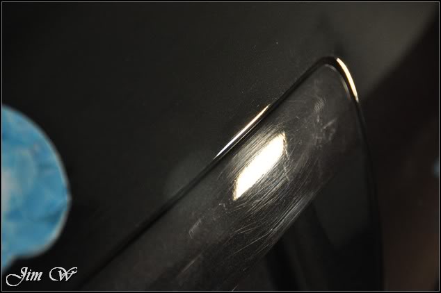

Sanding scores:

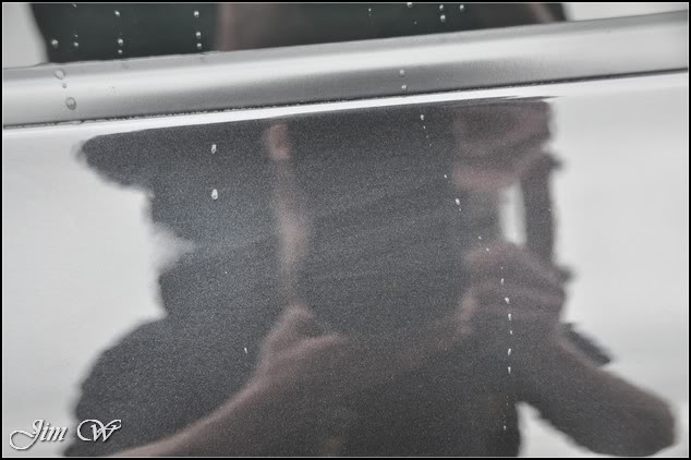

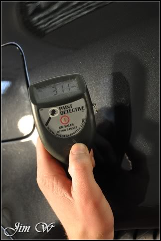

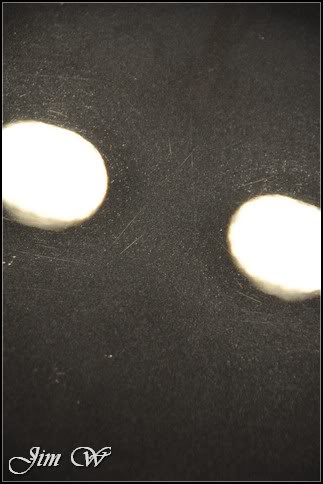

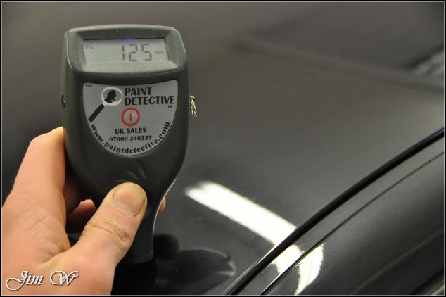

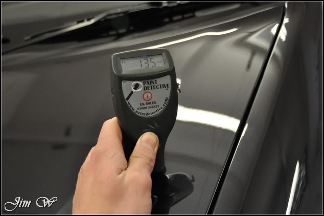

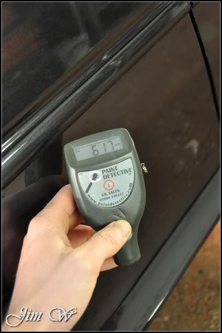

The bonnet (with original paint) averaged a healthy 130 microns

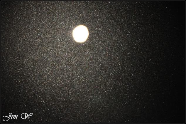

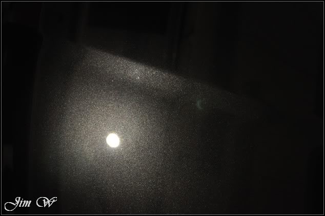

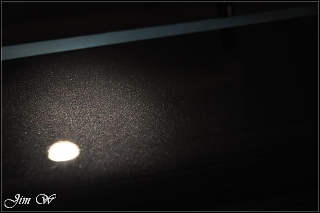

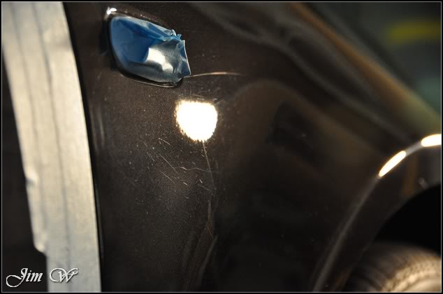

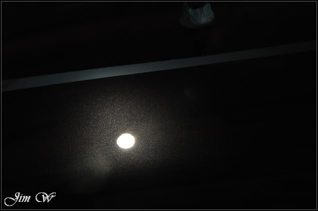

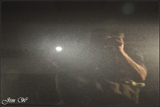

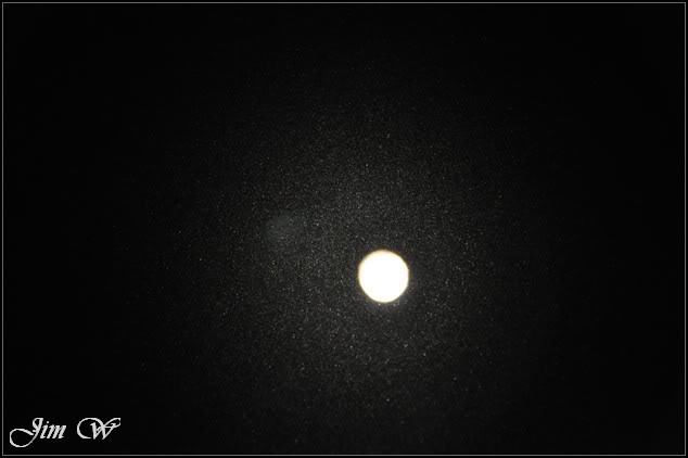

Defects under the brinkmann LED torch:

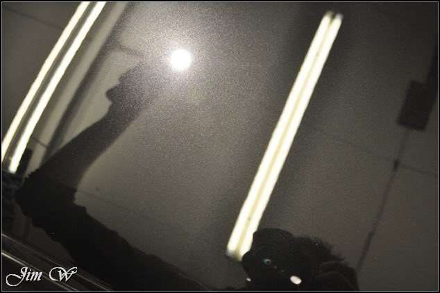

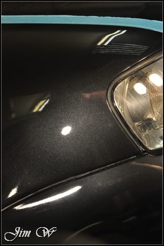

Starting my polishing set on the bonnet (original paint) with a yellow 3m polishing pad and Menz 3.02. Lots of deep marks remain. Stepping up to a light-cut hexlogic pad but made very little difference.
After a few more tests with polish and pad combinations, I found the results I was looking for:
Before/After

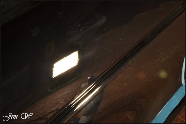

The paint was extremely hard. Requiring 2-3 hits per section with 3M FastCut + and a mix of compounding pads (yellow hexlogic and green 3M) In checking the finish under the brinkmann, there wasn't much need at this point to follow with a refinement pass! FastCut was being burnished down to a near perfect finish...

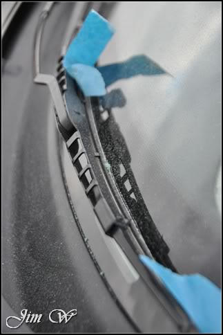

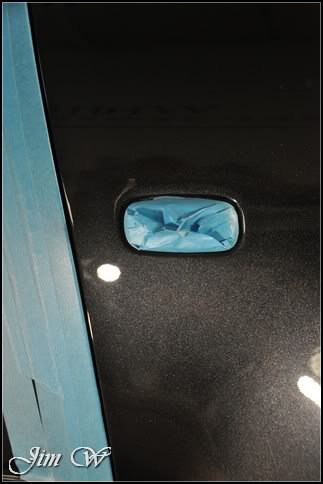

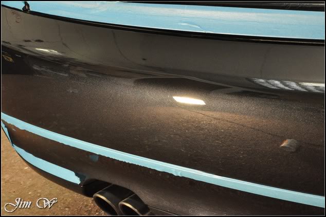

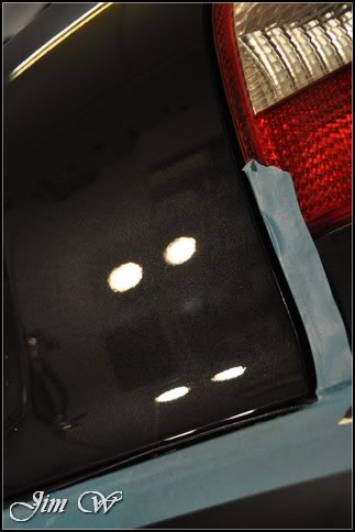

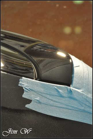

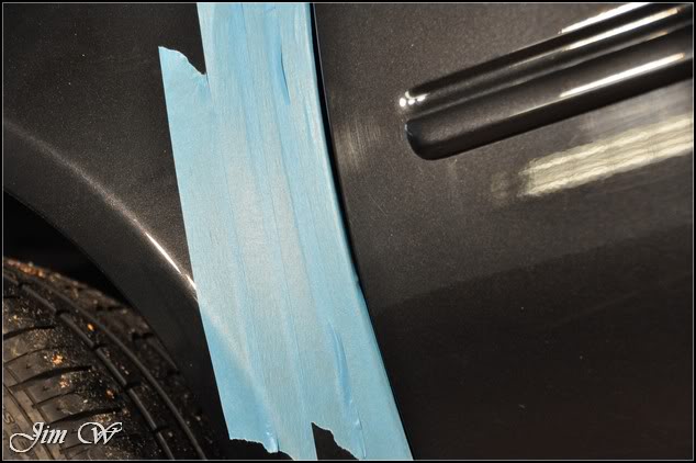

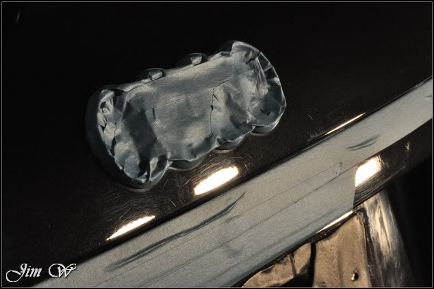

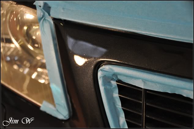

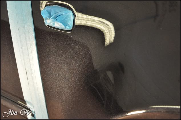

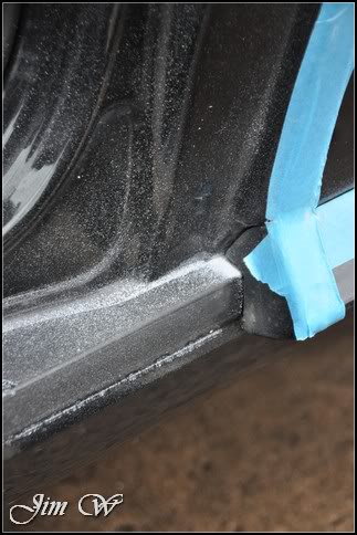

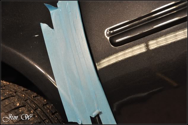

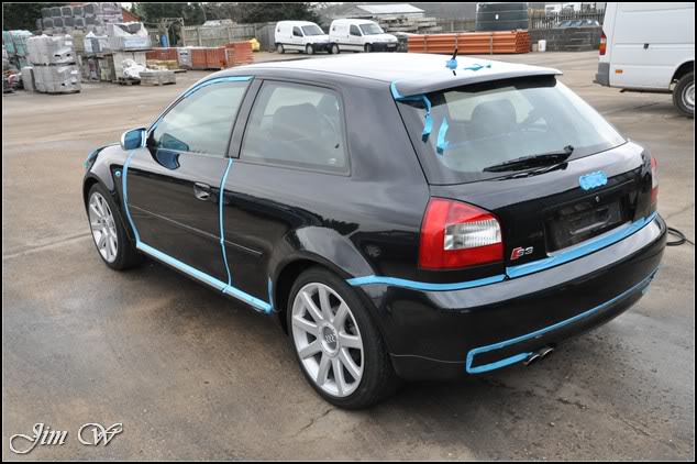

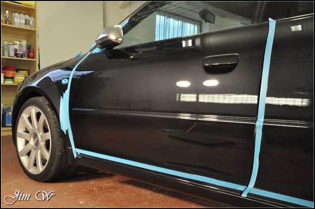

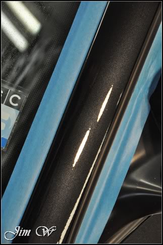

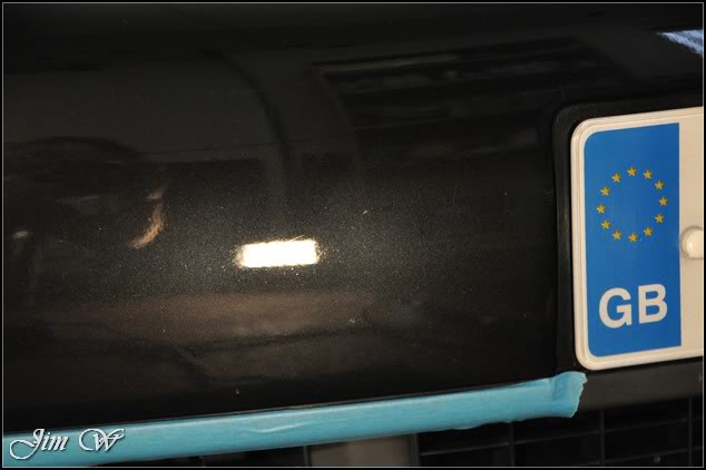

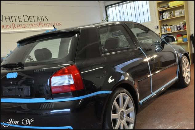

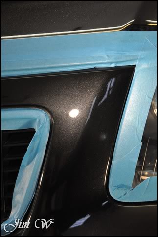

To safely correct some of the intricate areas, lots of tape overlapping had to be done.

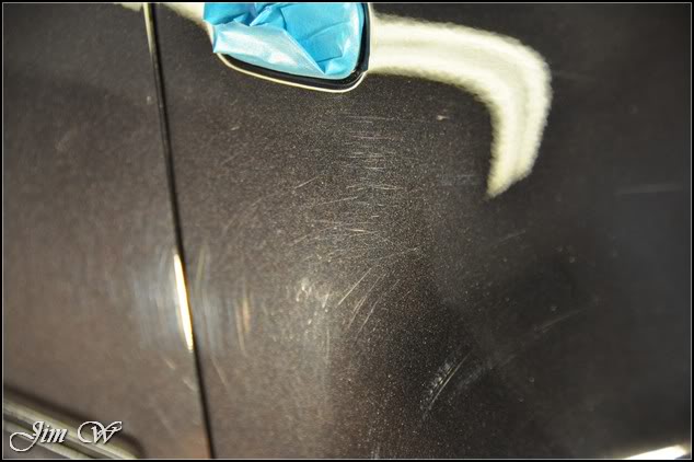

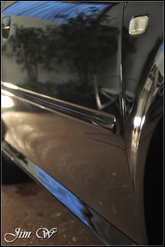

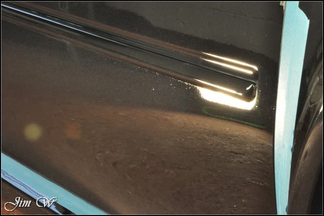

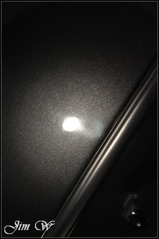

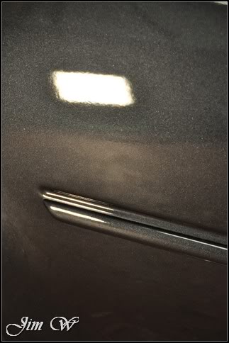

OS door 50/50's (again, to be honest, they're not too badly swirled – mainly just deep scratches (the beauty of a tough VAG paint (more resistant against wash induced swirls)
Before/After. Hand polished with Menz 203s:

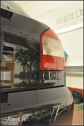

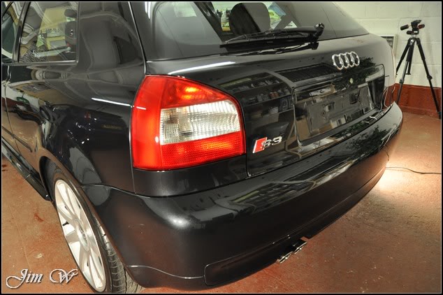

Boot lid. Before/After:

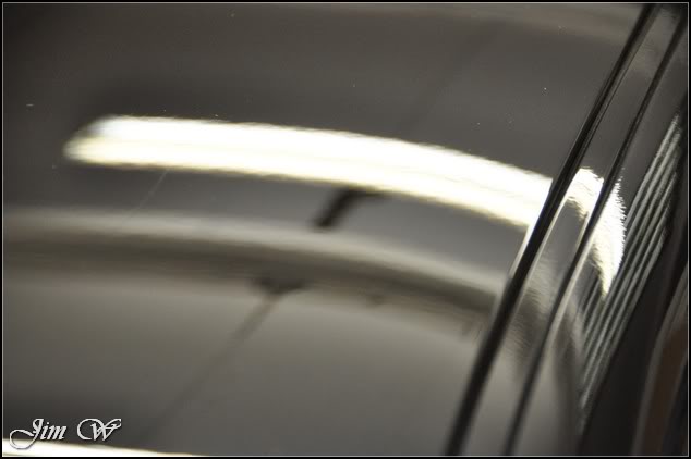

Some tricky areas on here..

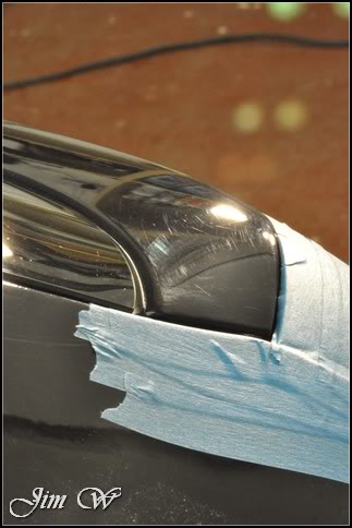

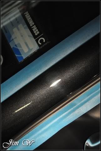

With the tape coming off the plastic strip, there was a noticeable difference!
50/50:
and corrected...

Roof before (where the tree fell)
After (the deepest of the scratches remains)

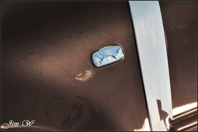

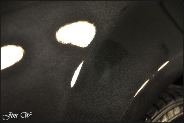

A nasty scrape just above the NS door:
Took multiple hits with a 3M compounding spot-pad to shift.

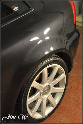

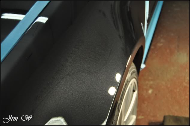

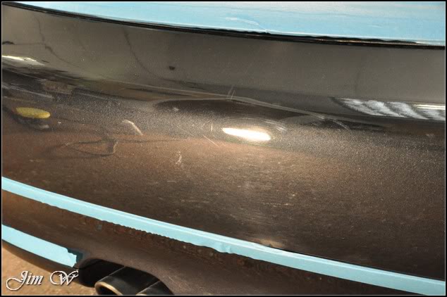

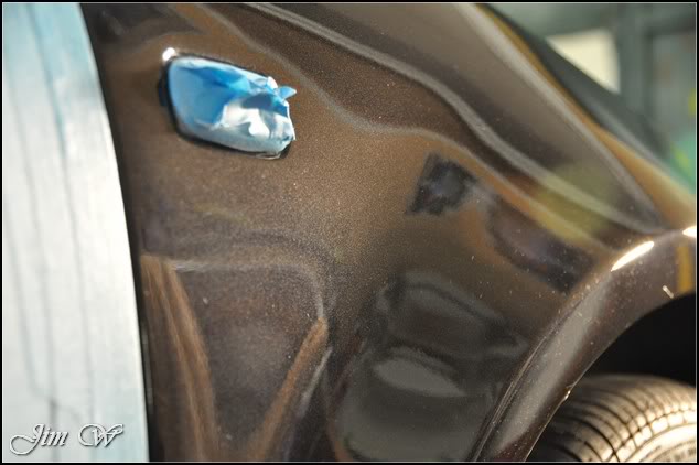

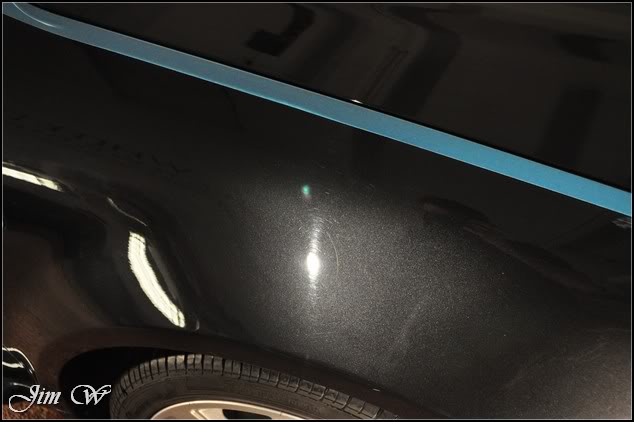

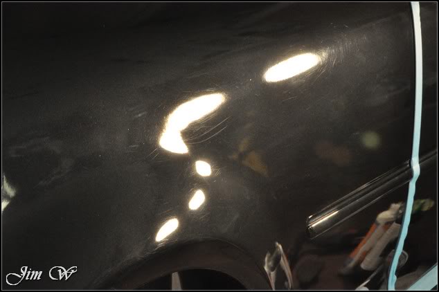

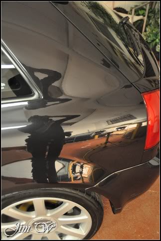

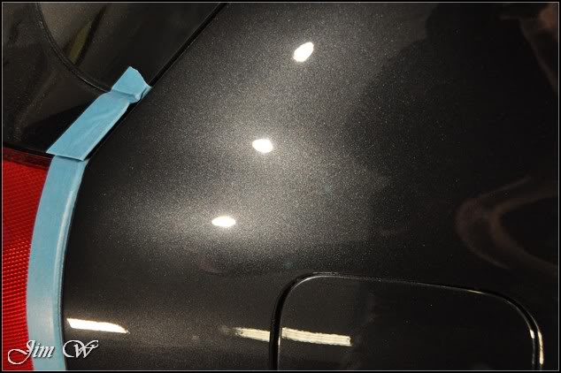

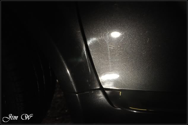

NS rear quarter. Before/After: (check the paint overspray in the panel gap!)

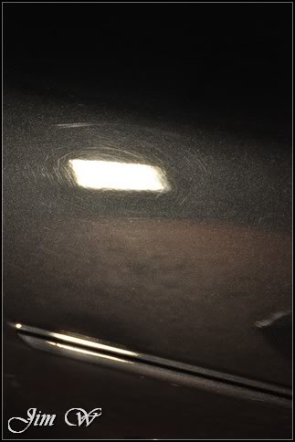

A bit more spotted here, too:
Before:
Corrected:
Refined:
Before/After:

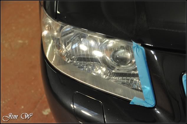

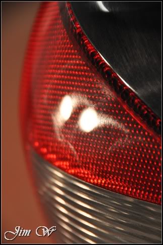

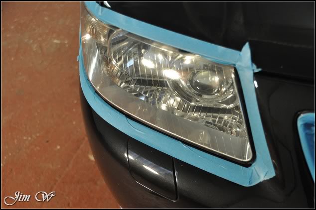

Light clusters, both front and rear, polished with Menz 203s. Before/After:

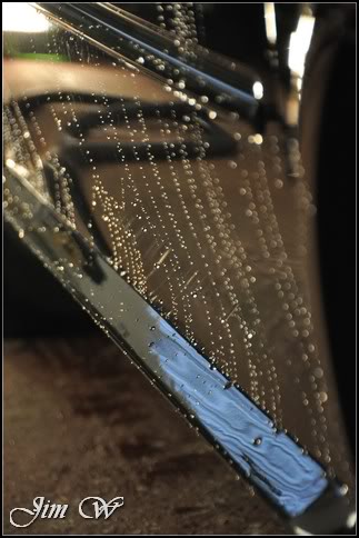

Rinsed with a free flowing hose to sheet the water over the panels, thus, aiding the drying stage.
Blown dry with the Black Baron vehicle dryer.

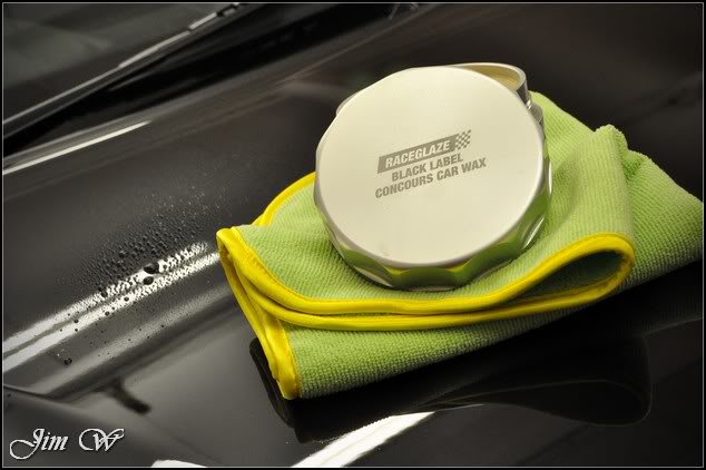

Next? Wax.
Raceglaze Black Label. 66% carnauba content. New wax for my premium appliations.

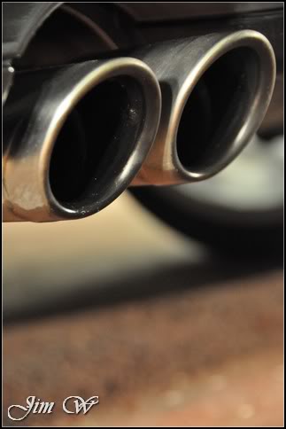

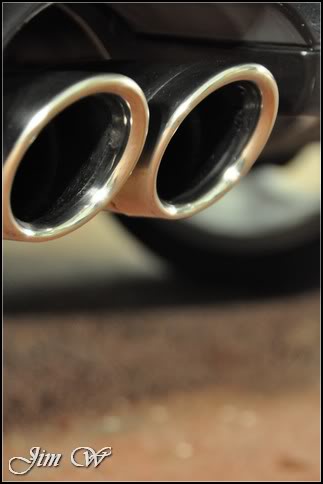

Exhausts wit 00 wire wool and autosol.

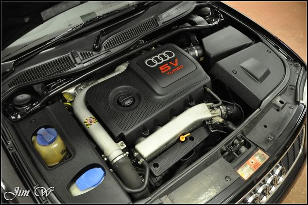

Engine bay plastics dressed,

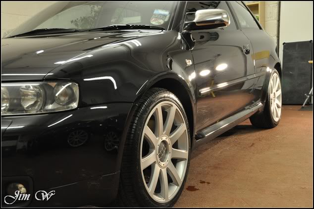

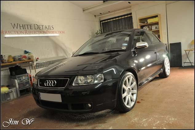

22 hours. Fini. The trouble, and, I know it would happen, is I want an S3 again now! A car to sit alongside the A4 as a mint demo car for weekend and show use only. Hmm. Better polish some more cars first!

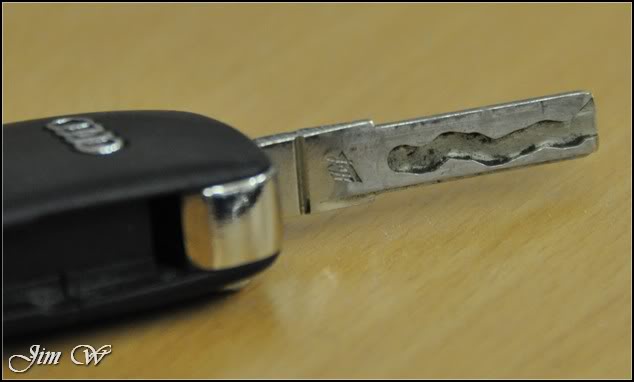

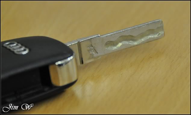

Good job on the key ;)

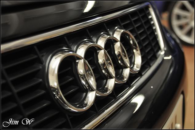

Prime used for the chrome?
You know me too well buddy.
