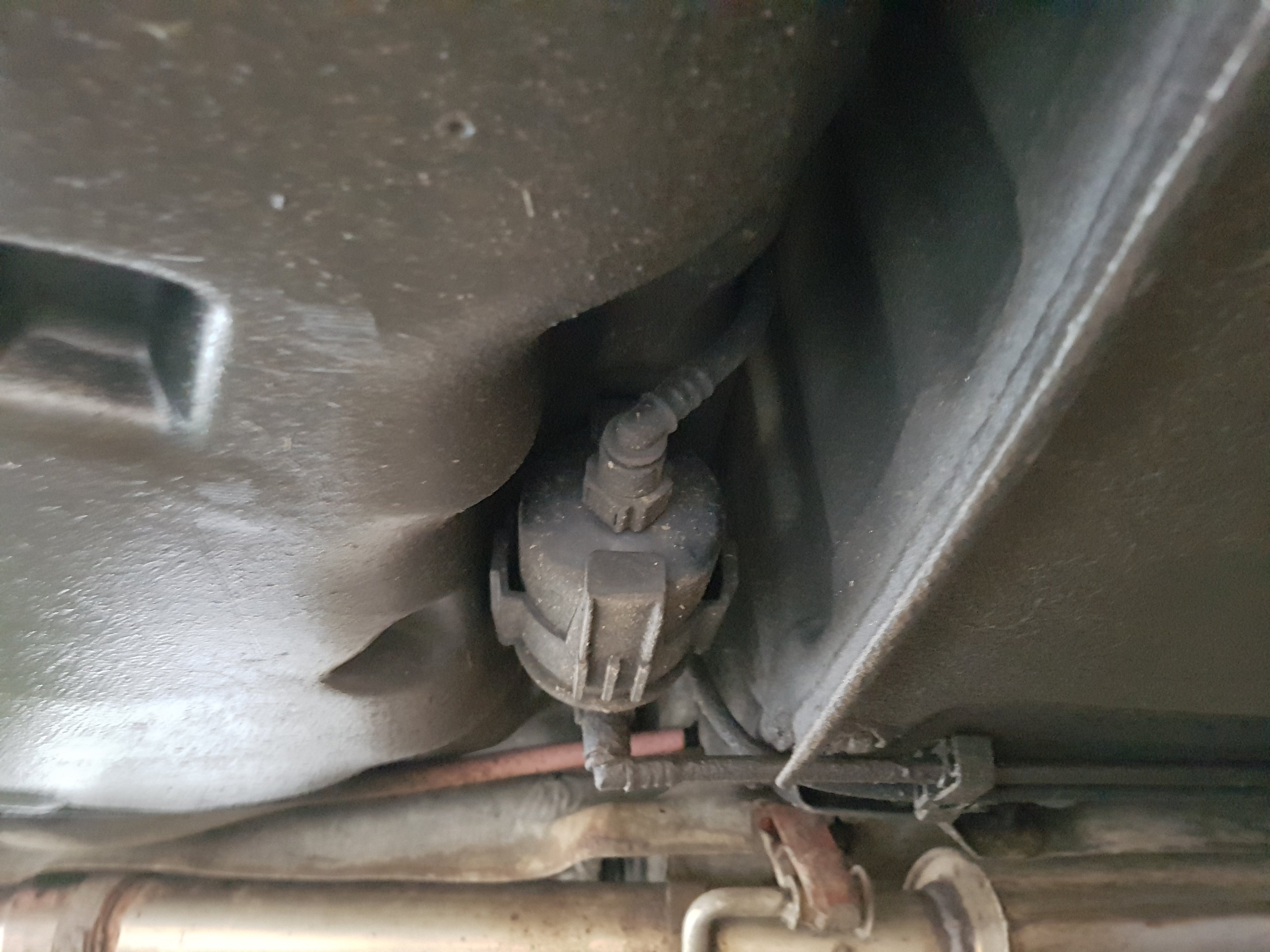

I will pull the pump and eyeball it on Thursday night as I have a handbrake cable to do (yes, that went today, fml) but I do believe that my car has an external filter. I know, this is normal but i see a few have mentioned this with these cars that should not have them but do.
I would guess that at 100K and having never been done, this may very well be an item that needs done?
Will probably still grab the coil pack Darren, let me know about $$.
J

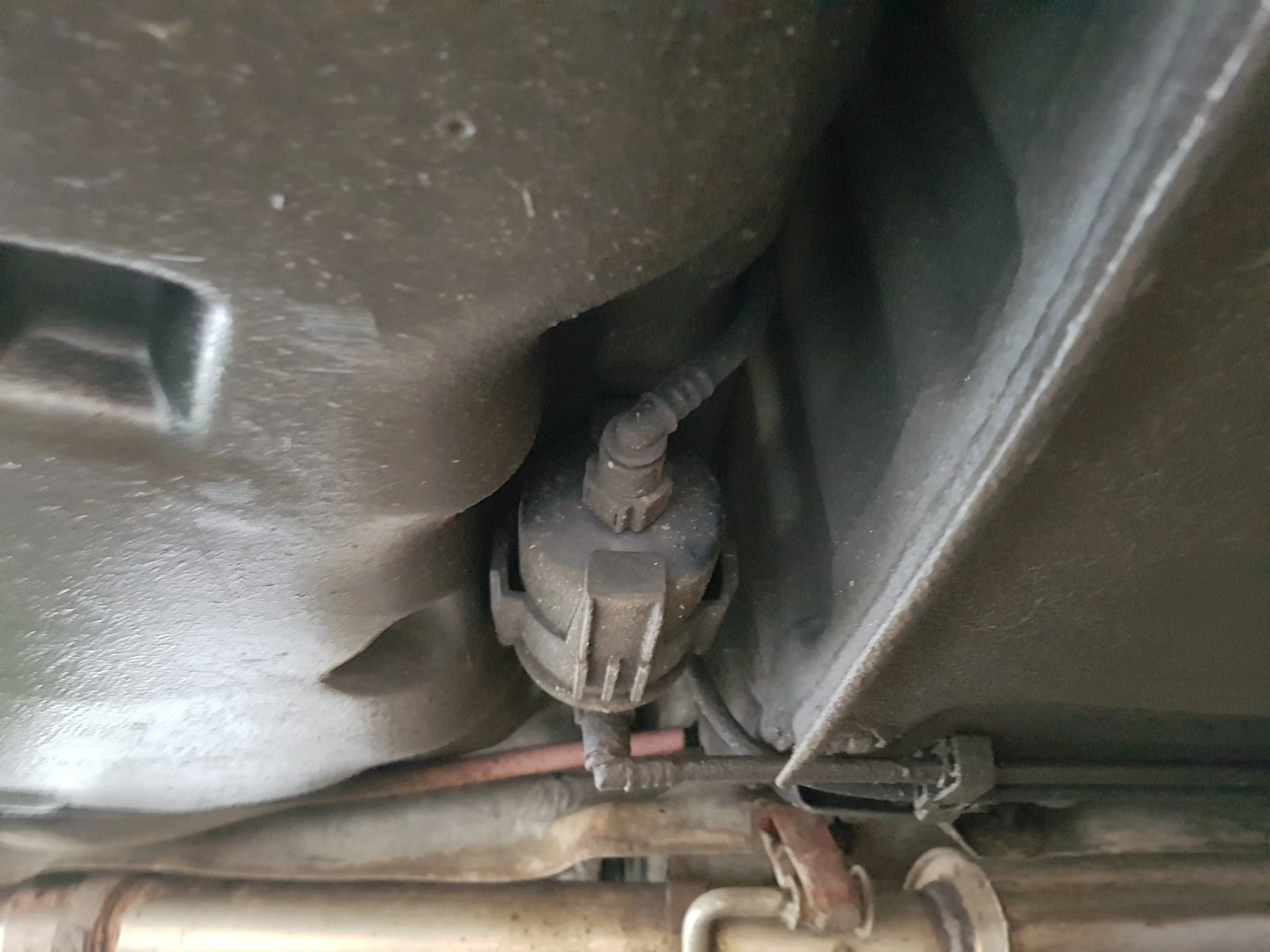

Am i being really dumb.................or is this not a fuel filter?
I had slight miss on my 172 Cup once, that showed its head one cold morning that started as a feint mis-fire. On the 30 mile commute it gradually got worse, that turned out to be the coilpack. But, when it got really bad just as I approached work, it lost a cylinder and threw me the electrical fault light in the cluster.
As you say Injectors can get clogged too.
Did the filter help?
