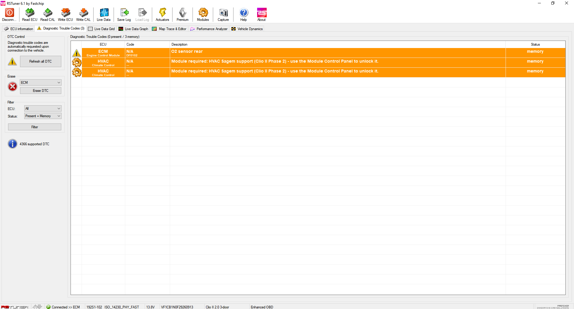

rear o2 was showing a historic error at start which I cleared.
it was there after the runs with no cel thrown.

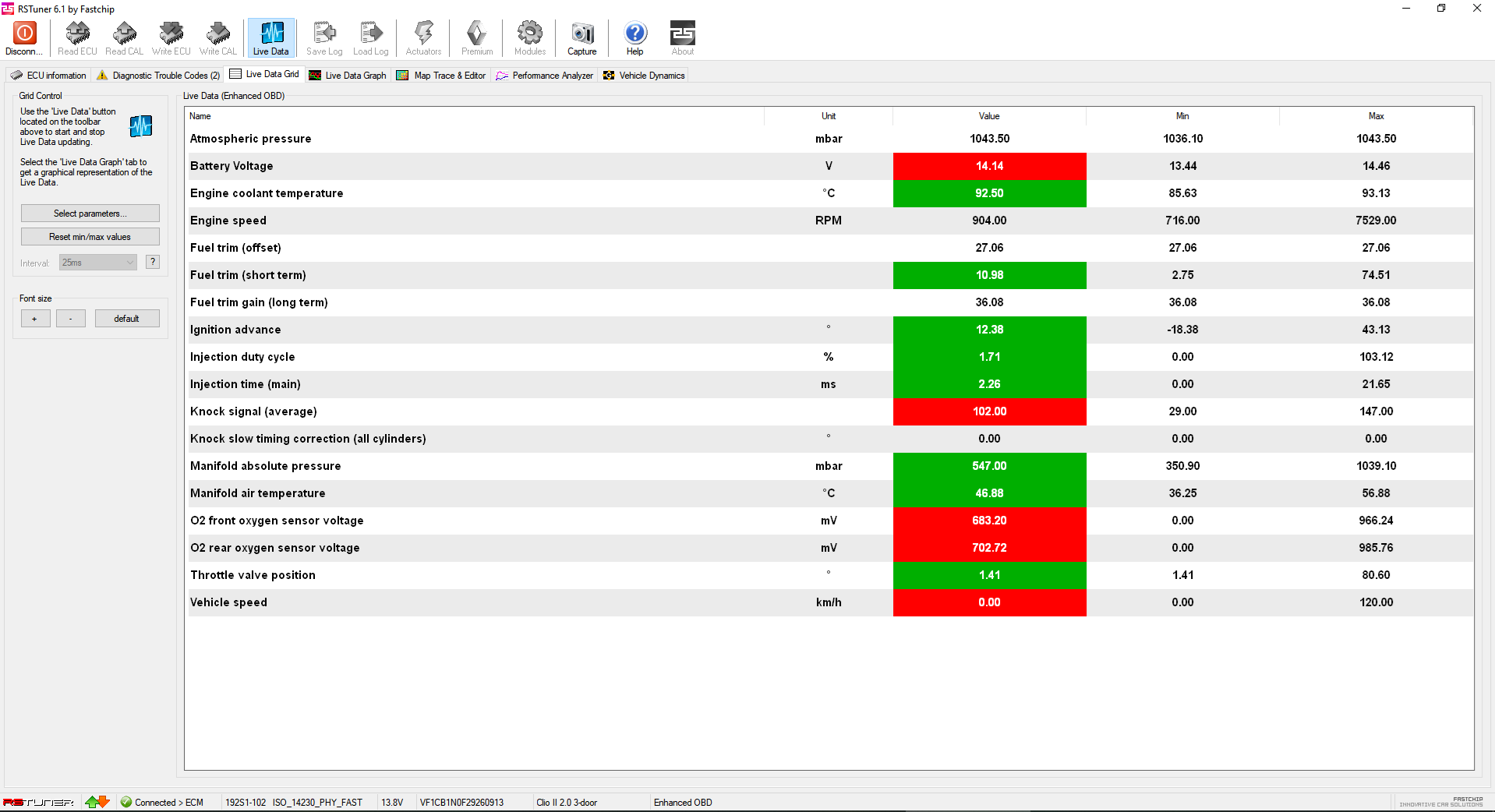

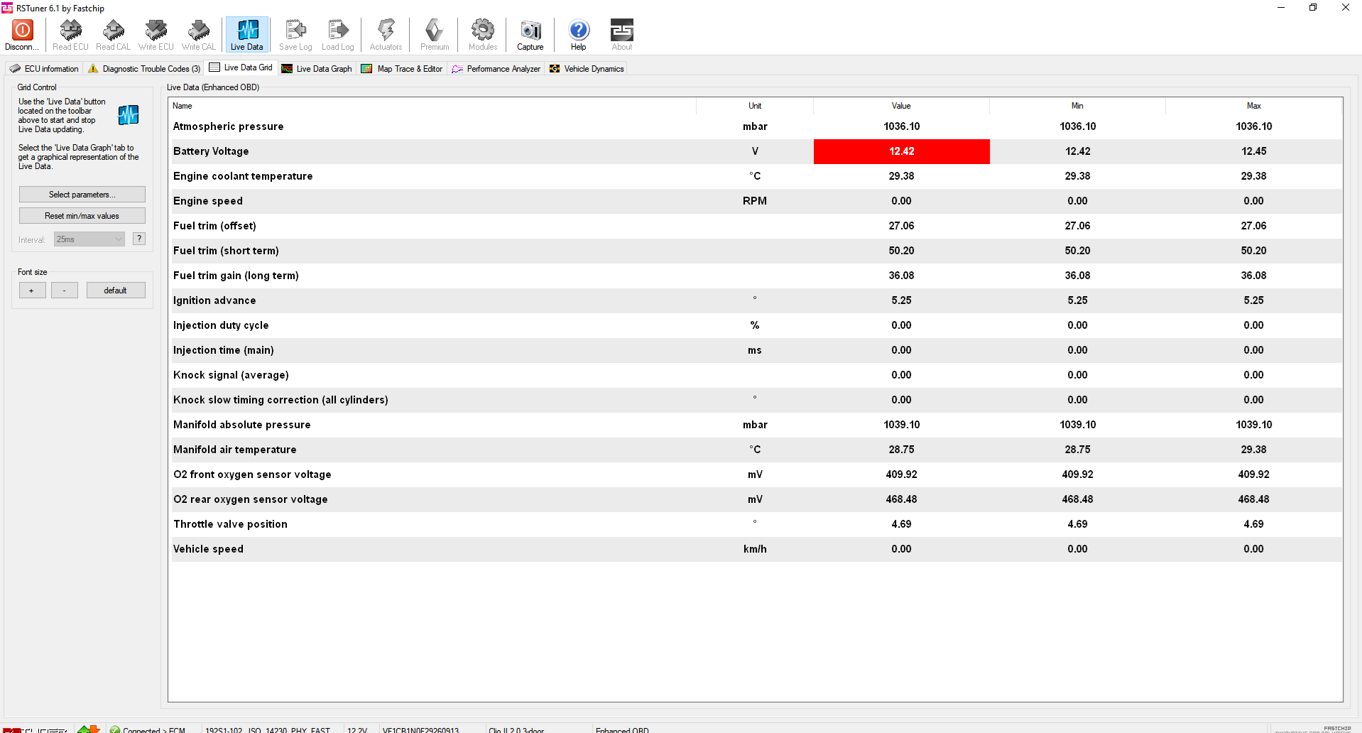

So I reset the codes and pulled the following with the engine off
Took it for a little blast and we were looking at the following
And hey presto, this was back
