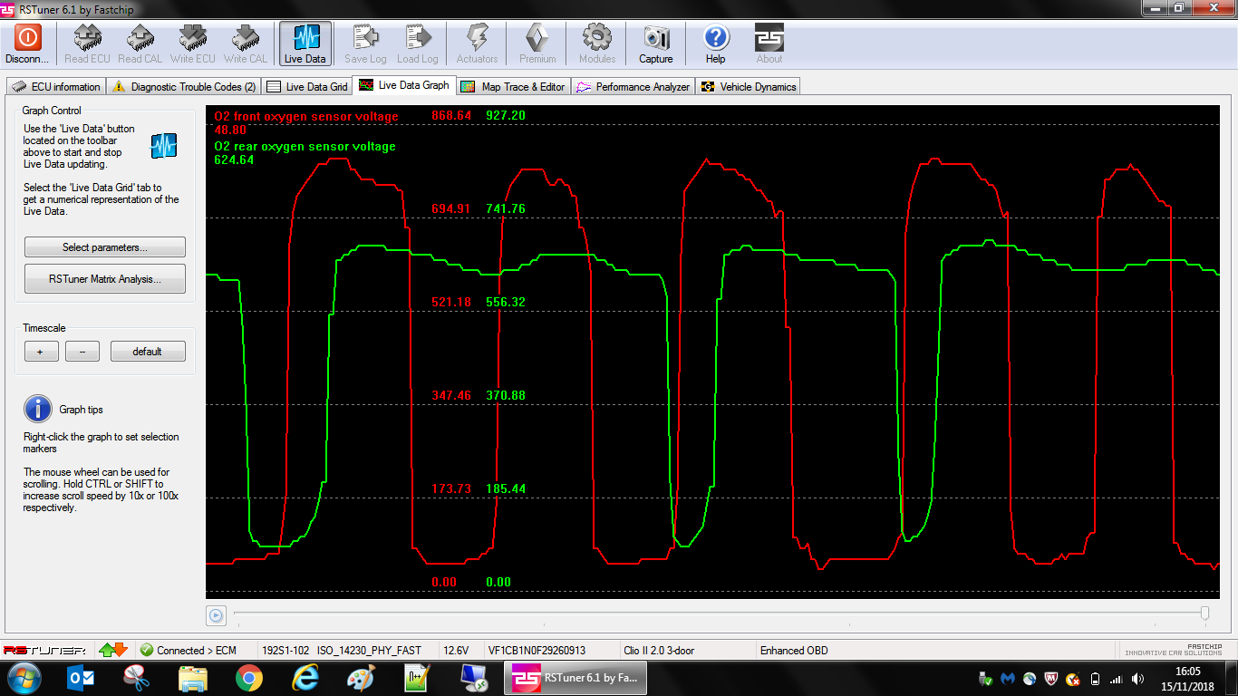

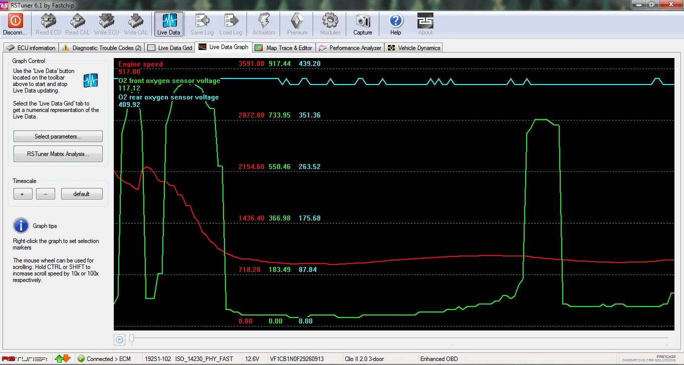

If i popped on the RSTuner and did a live data grab of everything while i went for a little drive and it misbehaves, do you think any of you guys would be able to eyeball it in case anything jumps out at you?
I just did a quick check with RSTuner and I had a historic "Rear O2 sensor" issue but I don't think they were replaced too long ago. Will have to check that mind.

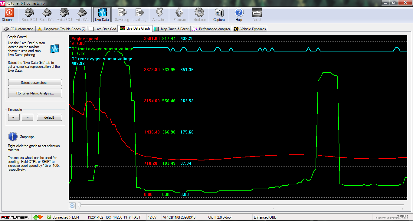

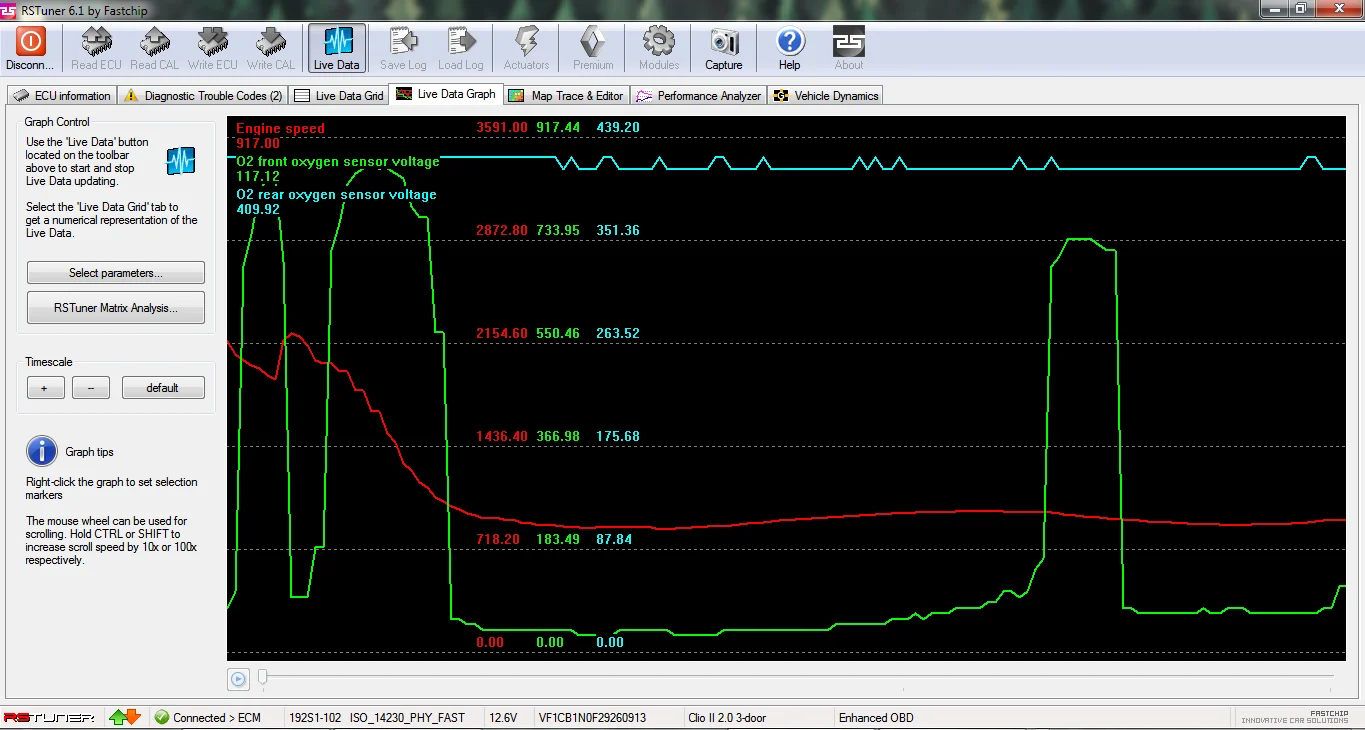

I looked at the output of both O2's while it was running there and you know..............I don't think it looks right.
In the below trace, i rev and hold the engine on very slight throttle (around 2k rpm) and let off and the idle drops down and gets super lumpy. At that point, the front O2 sensor loses its heartbeat like appearance and goes flat while the car lumps and bumps, then all of a sudden in comes back when the idle returns.
Not sure if that is relevant?

Front o2 sensor is slow switching, I had it on mine.
Replaced the front sensor and has been fine.
The rear shouldn’t move really.
Try swapping them over
right..............swapped them last night........................don't understand...................it was REALLY easy.............last time i replaced one it took about an hour :/ I am usually screaming "THAT BLOODY CLIP".....yeah, you know the one.

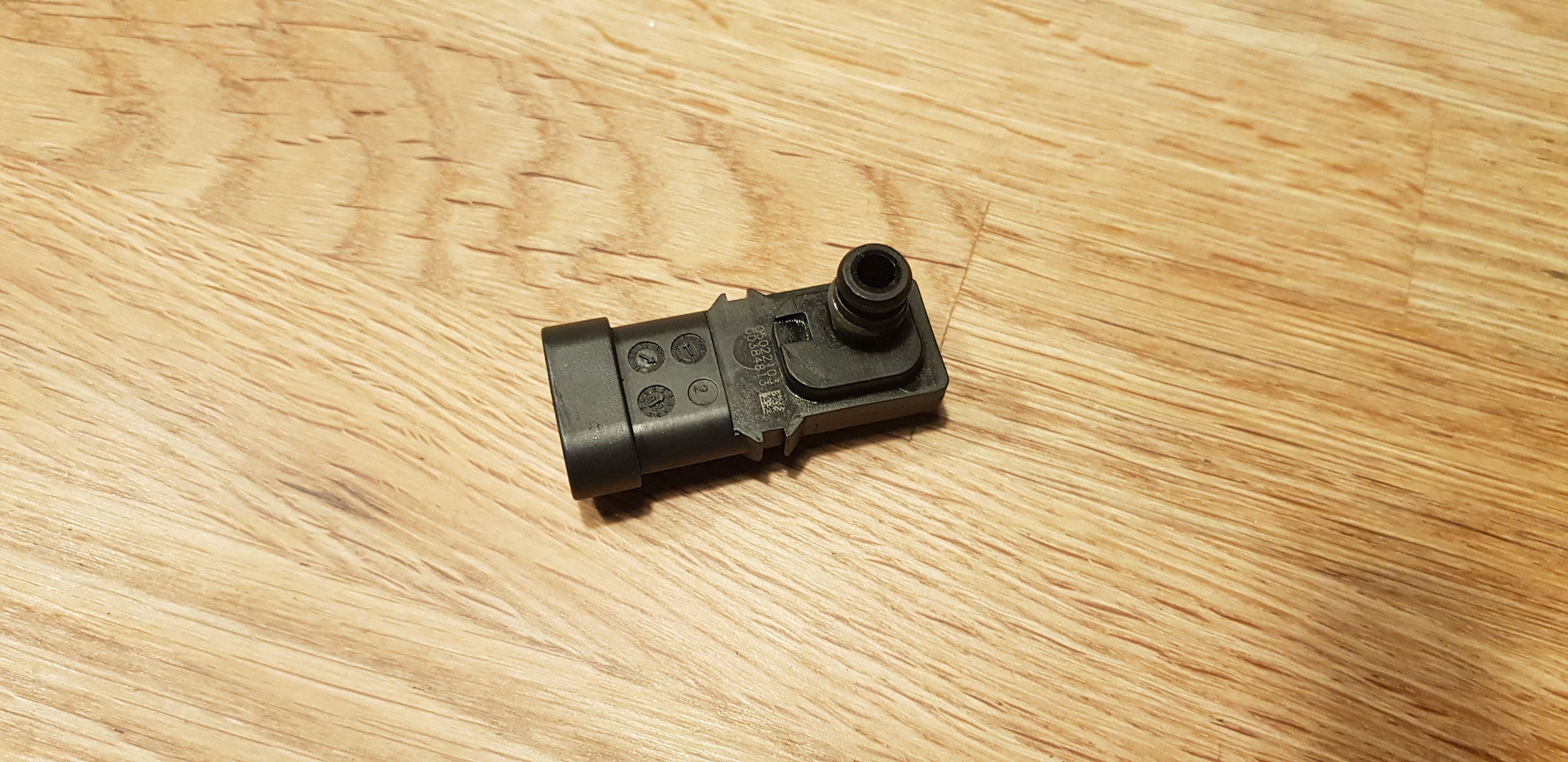

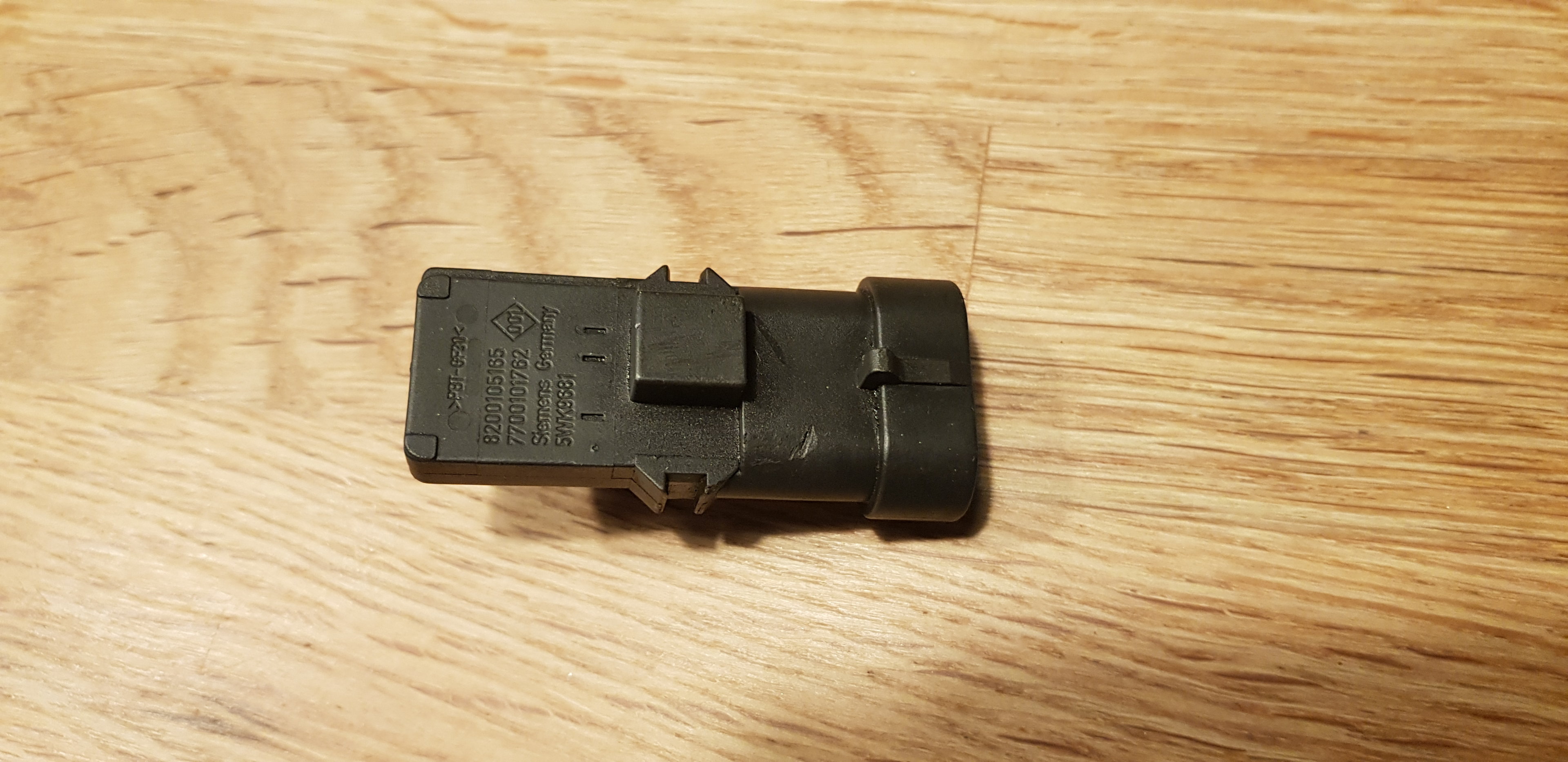

Oh, other thing. Anyone know who makes the MAP sensor for Renault?
The £140 asking price is making me feel ill. Especially when they can be had much cheaper but surely its possible to get a good quality aftermarket part such as VDO or Facet?

If you know someone with a 172/182 swap the map sensor over with a known working one save spending out £140. It's a 2 minute job to swap over and will answer that!

I am assuming that this MAP sensor is shared with other models, certainly looked that way looking at the replacements so it might even be easier to locate another model (Dacia, Nissan etc) in a scrappies and pulling one from that?

Nothing wrong with a used one as they rarely fail.

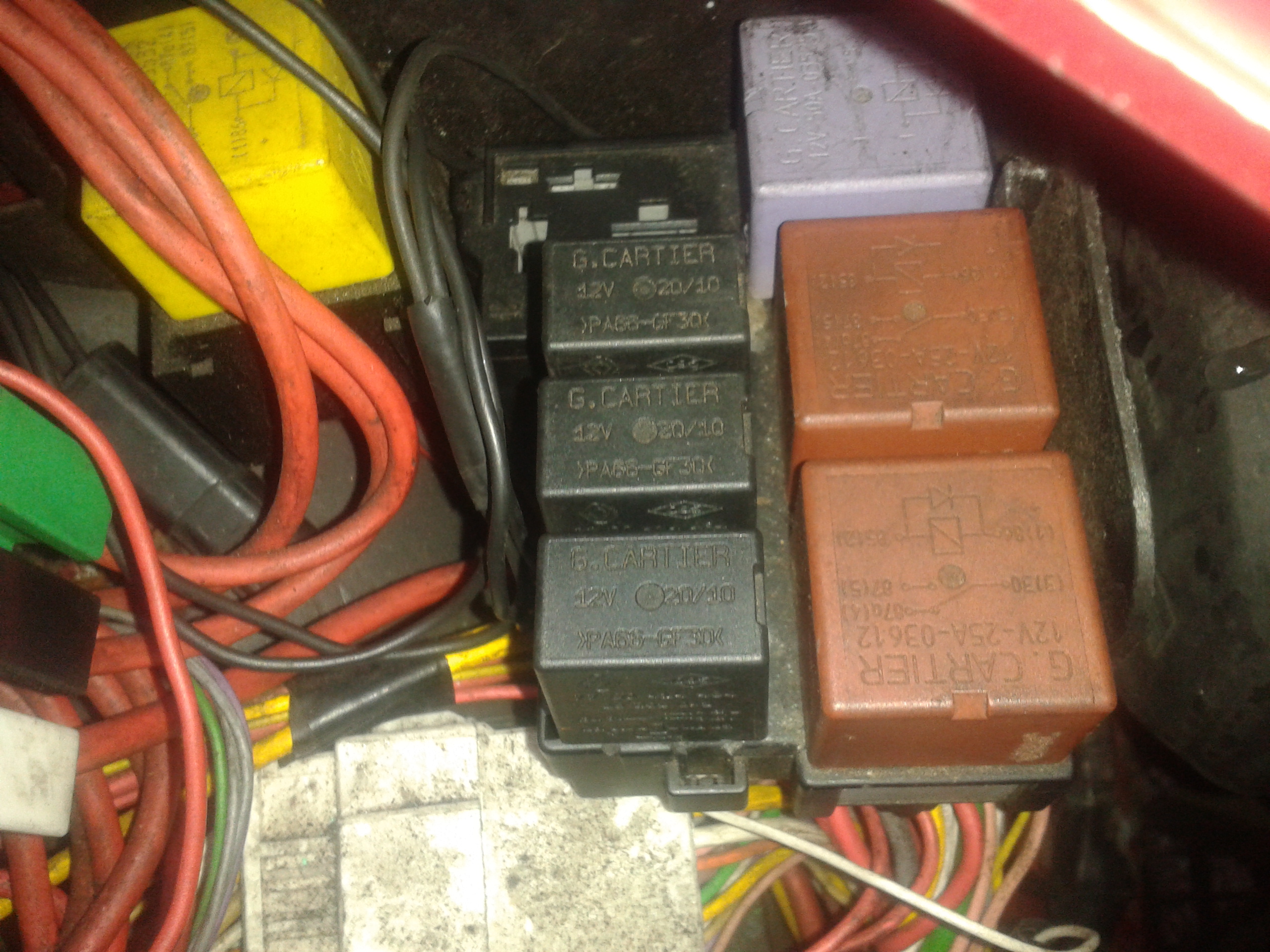

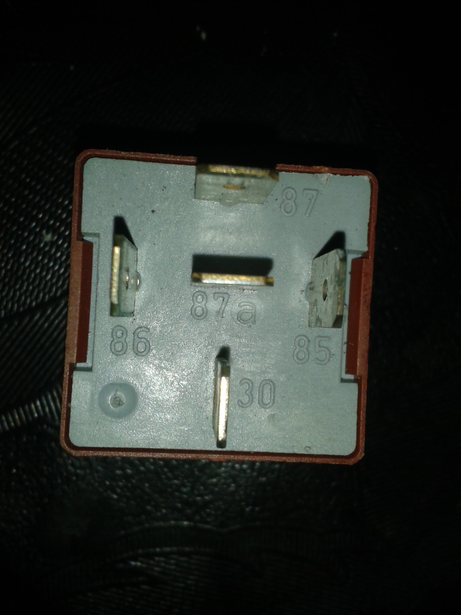

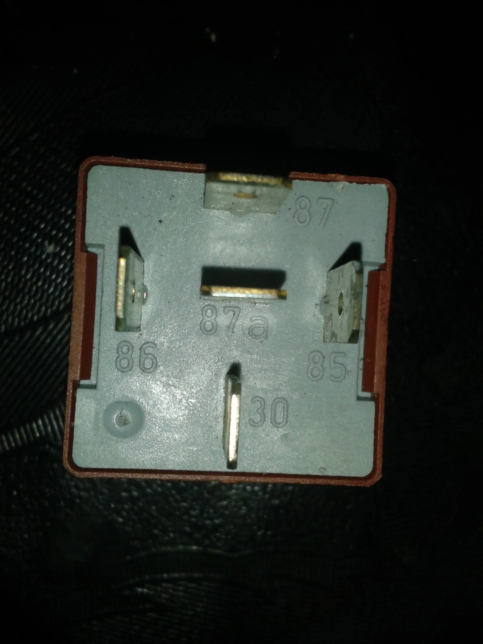

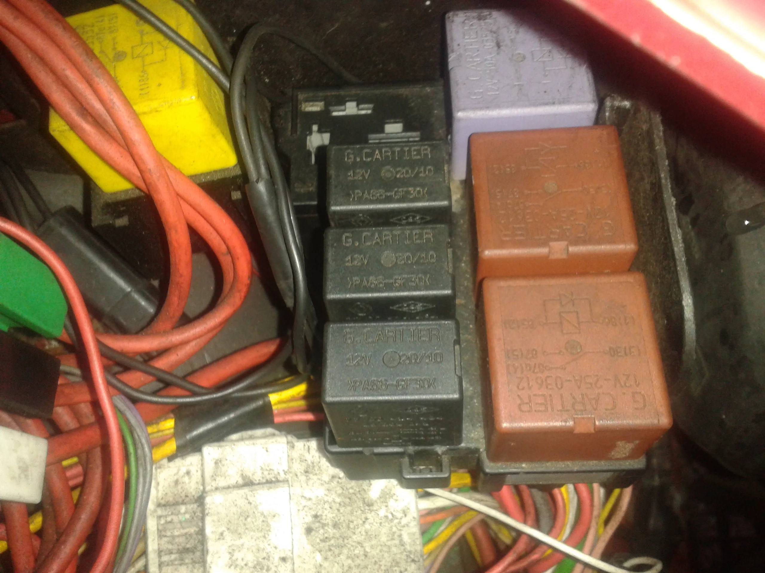

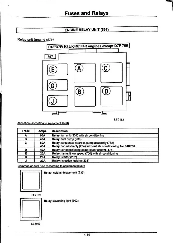

Interesting.............that bad boy is in the engine bay fuse box? Generic relay?

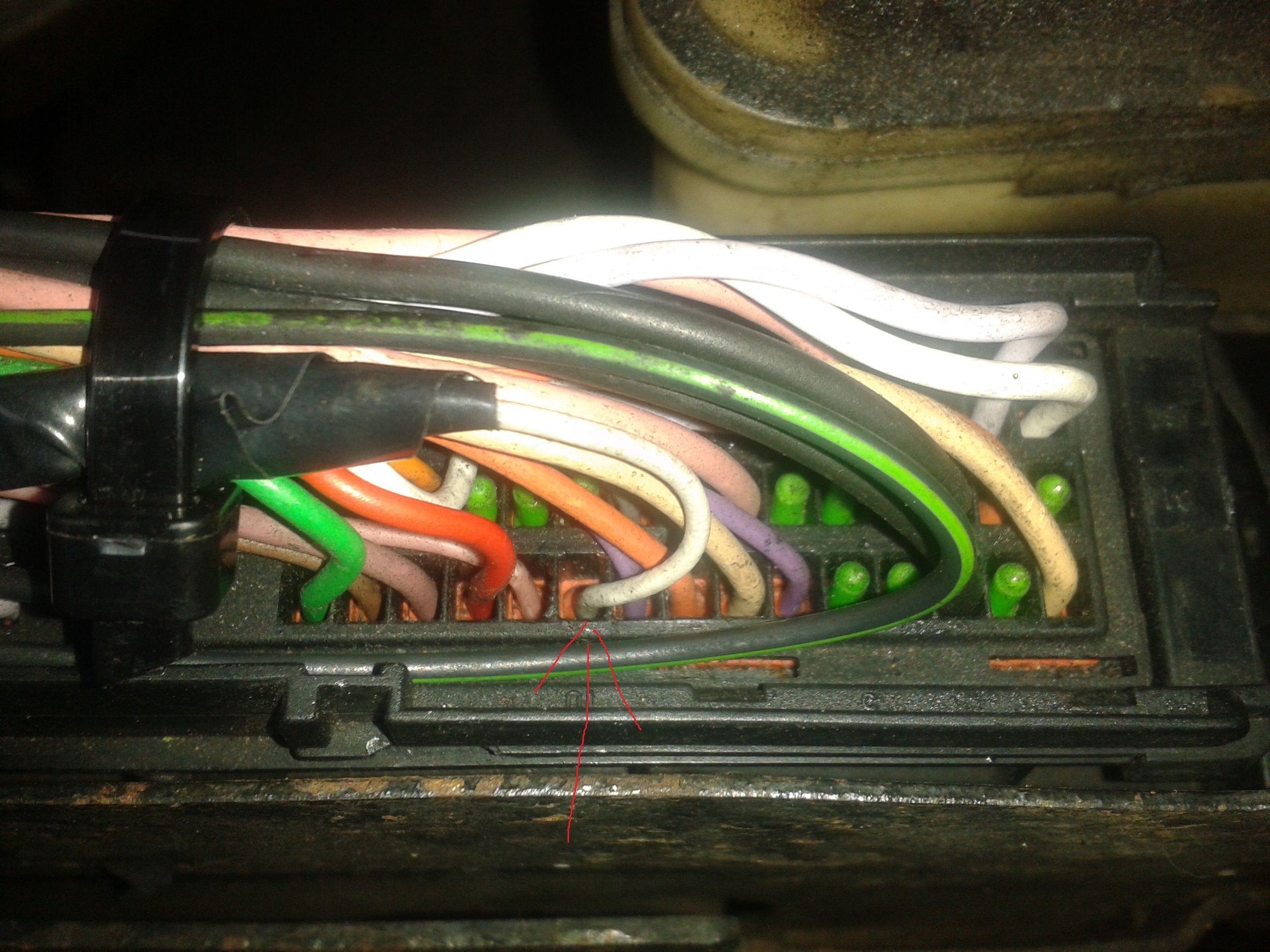

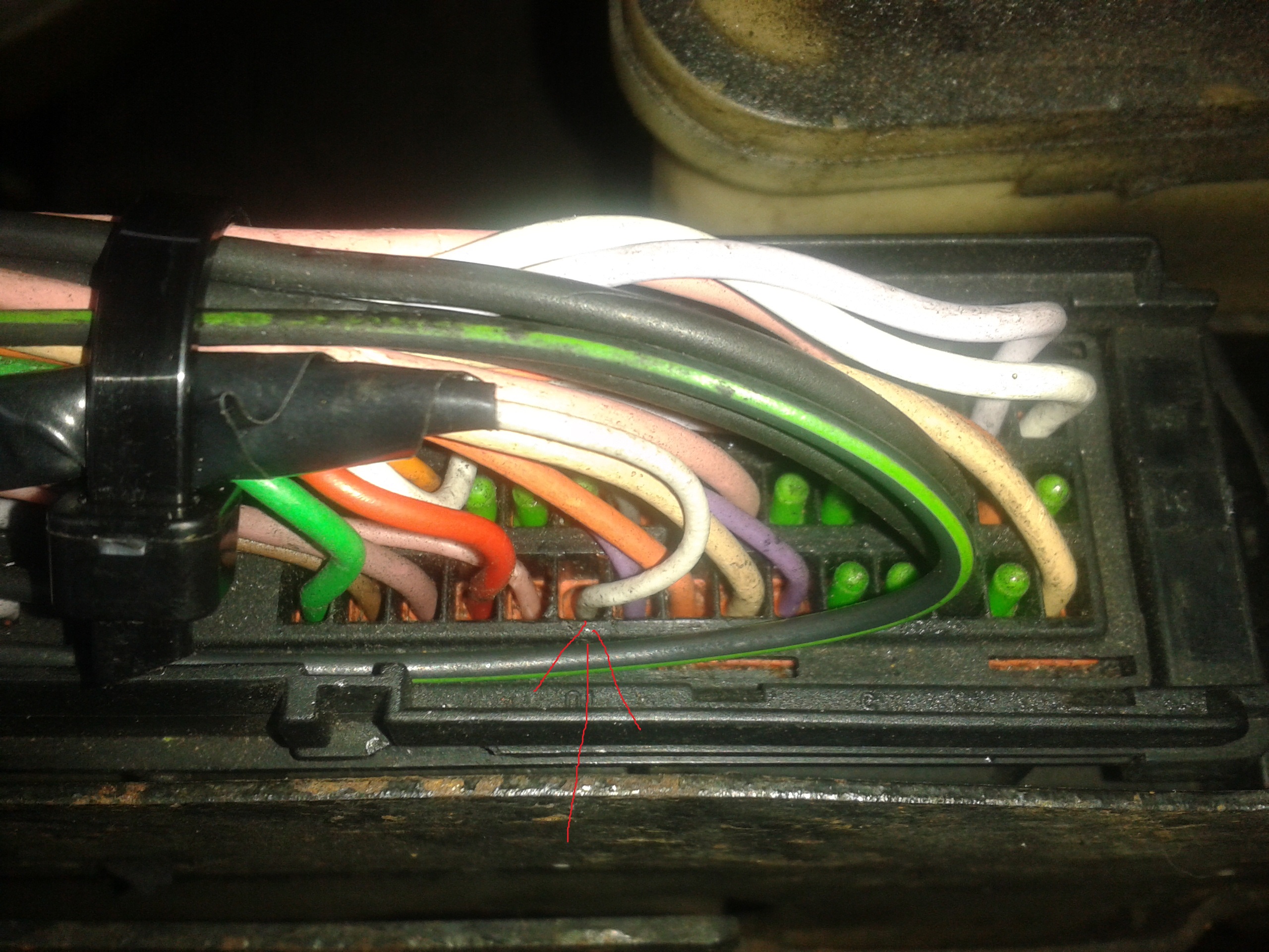

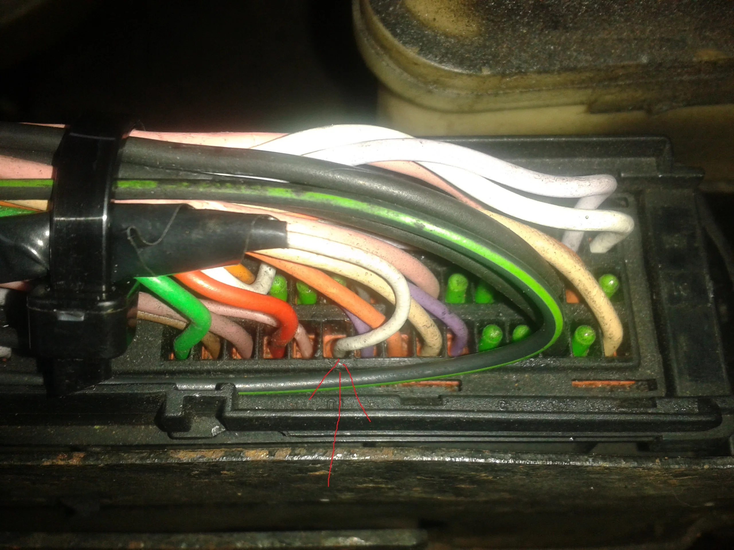

There could also be corrosion in the white wire from pin 11 of the ECU to relay J

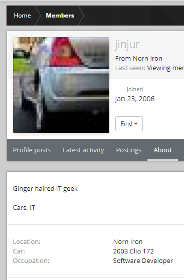

Congratulations on getting to post 76 and 12 months of this thread without actually confirming the car we are discussing, unless I missed it.
wtf fella?
When i started the thread, I think that the site still reflected the car i was driving in my profile, i can see that is now no-longer the case
But even from the now grainy avatar, it can bee seen that it is a ph2 172
Are you having a bad Wednesday or something Steve?
I called it a fuel pump relay but Renault call it injection locking J in the diagram.
E G and J have all gone wrong the brown ones have now been replaced with black if you buy from Renault
