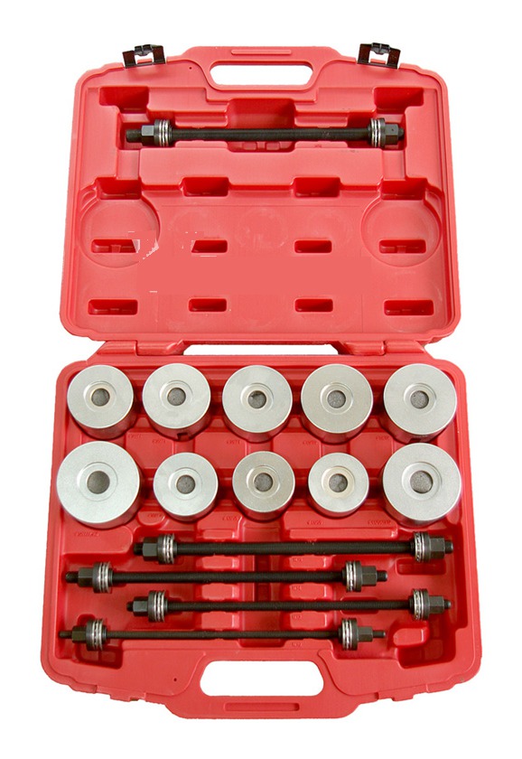

JamesBryan
We used one of these on my mates bushes, in combination with my impact gun. They were pretty tight tbh!
