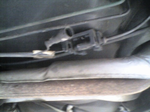

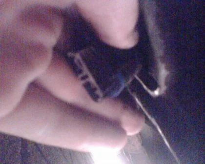

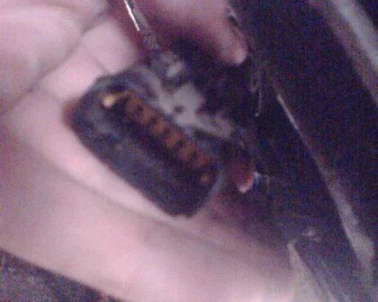

Just about to change the rear axle and was just wondering if the on the 172 where the axle connects up for the computer to calculate abs etc, is it the same type connection block used throughout the range i.e 1.2 16v. I have a yellow female block just under the passenger side of the car coming from the engine direction and a male connector coming from the 1.2 axle direction- these do not fit into each other! right/wrong blocks? the 172 axle im about to put on does not have a lead running the whole length of the car, do i need to get this from somewhere or have i the wrong leads mixed??Thanks
if its a 172 FF and not a cup then the ABS wires should just swap over! Although even after doing that the ABS will not work correctly as on the 172 rear axle the ABS rings have 32 teeth and the 1.2 oly has 28 therefore the ABS will kick in constantly and you will not be able to brake!! You need to get new ABS rings on the 172 rear axle which means getting new discs aswell as the rings come with the discs.
Sorry should have mentioned, the conversion has been done so the rear axle is all that is left, im looking at the yellow connector on the passenger wheel side and cant see how it will connect to the rear axle, the block thats there doesnt fit and theres no long wire from the 172 rear axle, possible missing part?
Quite bad pics but the phone is all i have around. My bad its a black block connector but yellow on the inside- which i presume is off the 172 loom from the conversion. the other connector goes back into the axle i think and doesn't fit. the new 172 rear axle has no long connecting wire or i have got the wrong wires

What year is your 1.2?? Where is that connector show above? The only connection i can think of looks like this:
The connection im looking at is just beside the passenger wheel arch. it was a 2001 1.2 16v facelift. Now 2l 172 engine. Currently the abs isnt hooked up anyway so i think i might just swap the axles and see if i come across anything
hmm might be good news then, il swap the axles over and take pics of any wires im left with.Cheers guys
I see what you mean now. This is on the other end of the part im taking about, so those connectors above are at the rear over the axle and the bit im talking about is on the other end at the front.

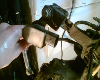

Any idea what that plastic box is on the 172 axle attached where the abs and brake lines attach? it has a small swivel arm coming off it, no such thing on the 1.2 axle?

Theres a blue and yellow handbrake cable... pretty normal. But why is the yellow sooooooooooo much longer than the blue?
i think one of them has to be longer due to way it is threaded around the axle and then under the car. as for that pic im not sure what it is. where abouts on the axle is it? near the calper/? is it on the O/S or the N/S?
its attached to the same place as where the brake lines meet just over the axle itself beside the n/s spring
well done fitting etc and all seems to be ok so thanks guys, remaining problems are just what the connector i found at the front wheel is, what the box is above the rear axle and where on earth is the connector for my abs wires run from the back brakes to the front and have nothing to connect into?!?!?
