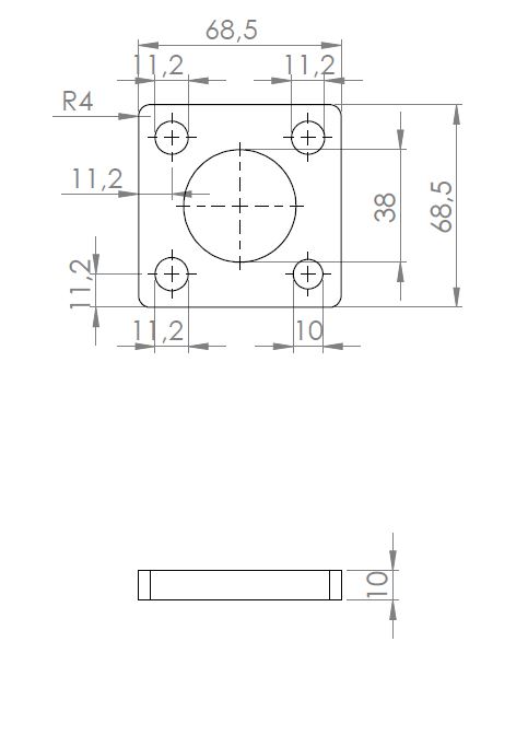

I want to make axle spacers. I'm wondering if anyone made them or measure them. If anyone have measures, feel free to comment.

Already made and fitted them.
Set your own camber while your at it and do a 1 piece 16mm spacer
