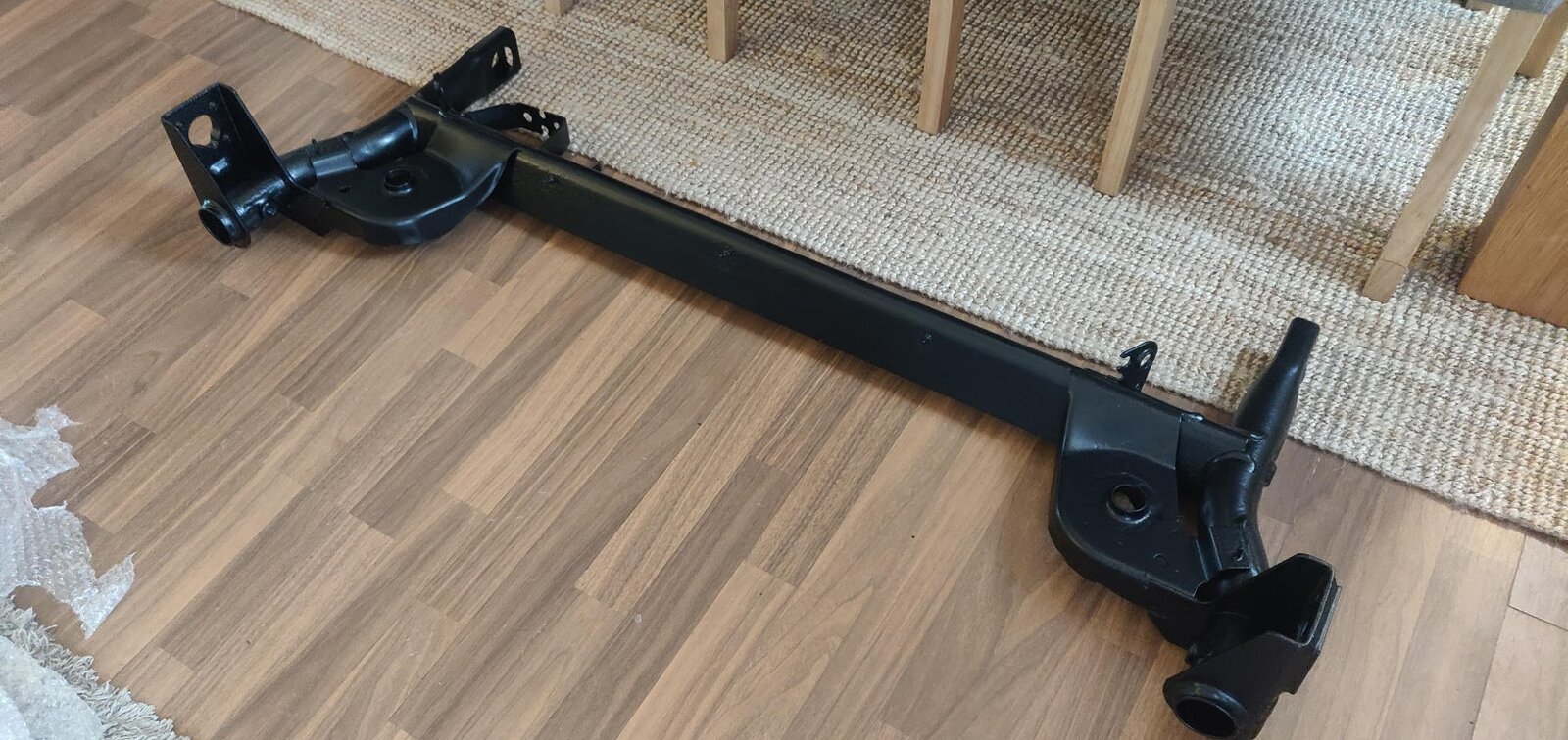

Depends if you want to remove the beam mounts from the shell. As discussed before, if you run the fuel tank low, remove the 4x fuel tank bolts you can then get enough access to remove the horizontal beam bolts out. This way you don't have to touch the captive bolts going through the boot floor.
It is nice having it blasted and powdercoated -
Looks good that! I need the mounts off though because I've got rust on the shell where they mount

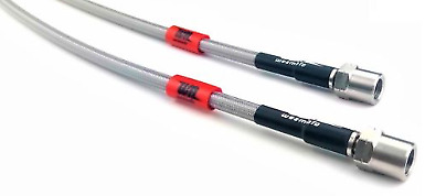

Thats not the lines to the calipers though?

Sorry, I was mislead into thinking this was a listing for hoses all the way back to the rear calipers by the photos of a long length of hose with a male fitting at one end, and a female at the other.
It is in fact the standard OE 8 inch with 2 females flexi`s.
Not sure why eBay sellers cannot use a picture of what they are selling?
