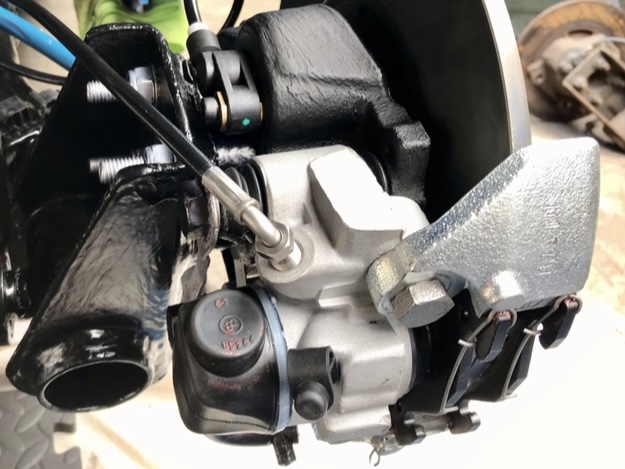

Did you manage to sort out the caliper carrier bolts?Hi All,
Does anyone know what the bolts are that connect the carrier to caliper?
I may have stripped the thread in the calliper and I want to make sure I get the right thread pitch to repair it
Thank you

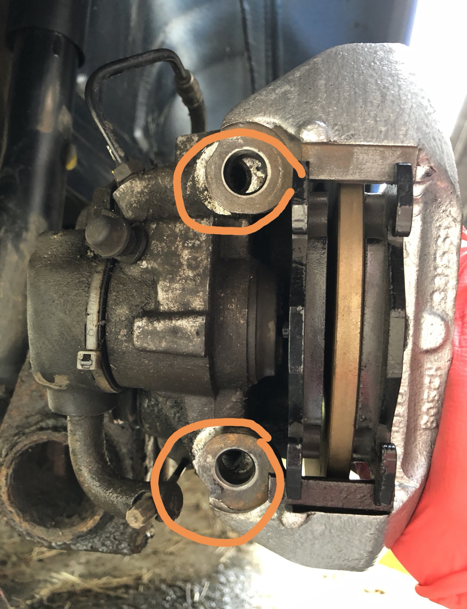

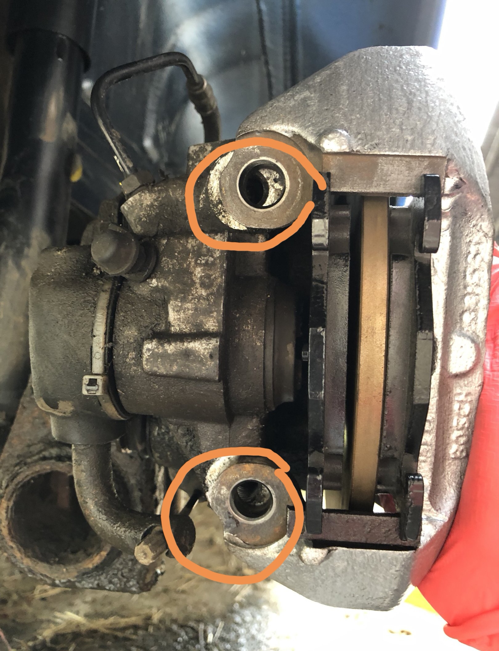

They're the 2 bolts that go in here. Not the 2 bolts that bolt the caliper to the hub.They're a special bolt from Renault. See this thread here - https://cliosport.net/threads/nuts-and-bolts.814078/#post-11524905
The bolt shank (the unthreaded part) is designed to work with the anti-rotation plate so it aligns properly.
Like Scott, I ended up reusing my old ones.
Ah sorry, my bad.They're the 2 bolts that go in here. Not the 2 bolts that bolt the caliper to the hub.

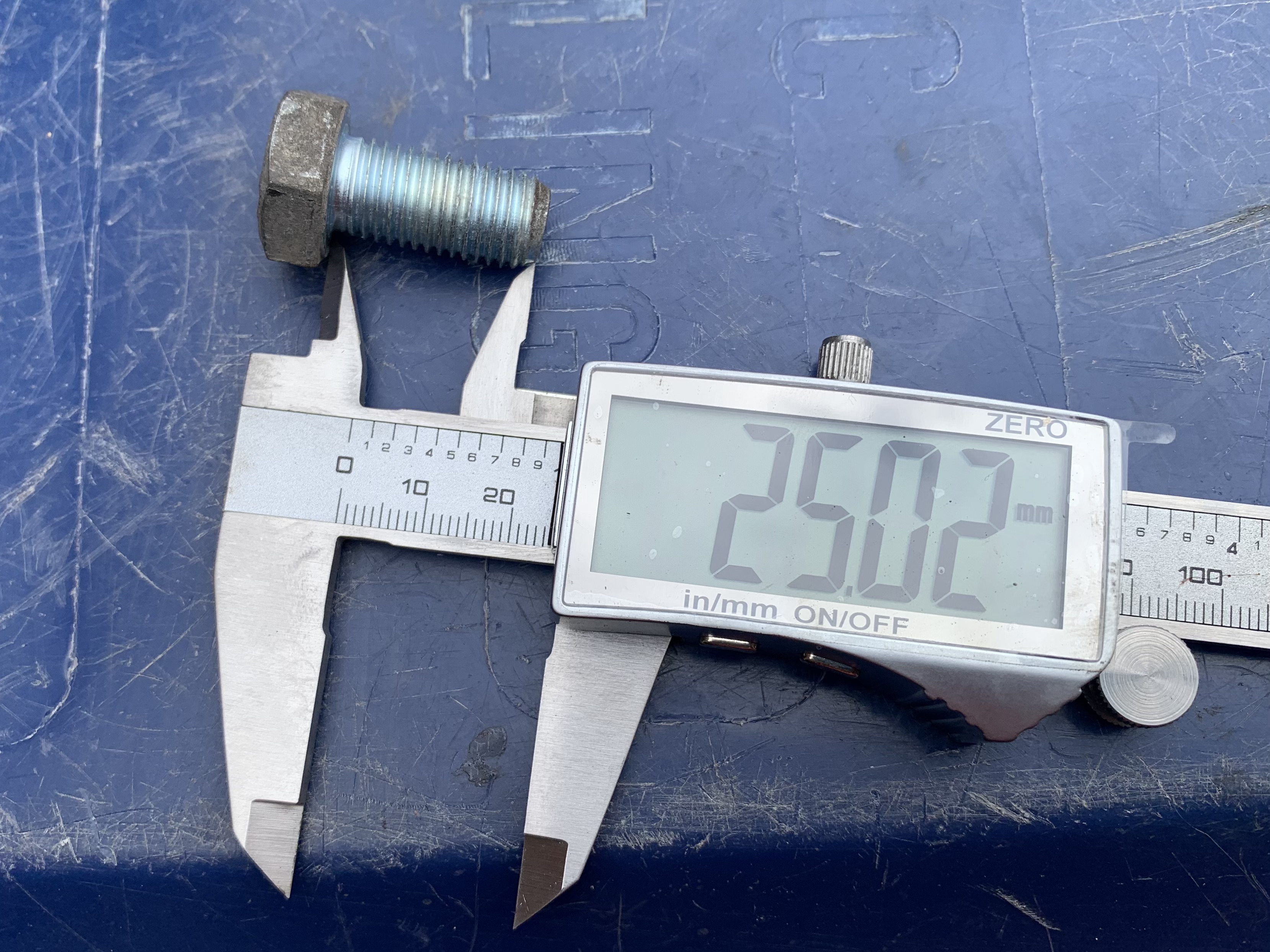

Looking on that list from the link you posted it doesn't show any of those bolts. They're about 25mm long.View attachment 1702638

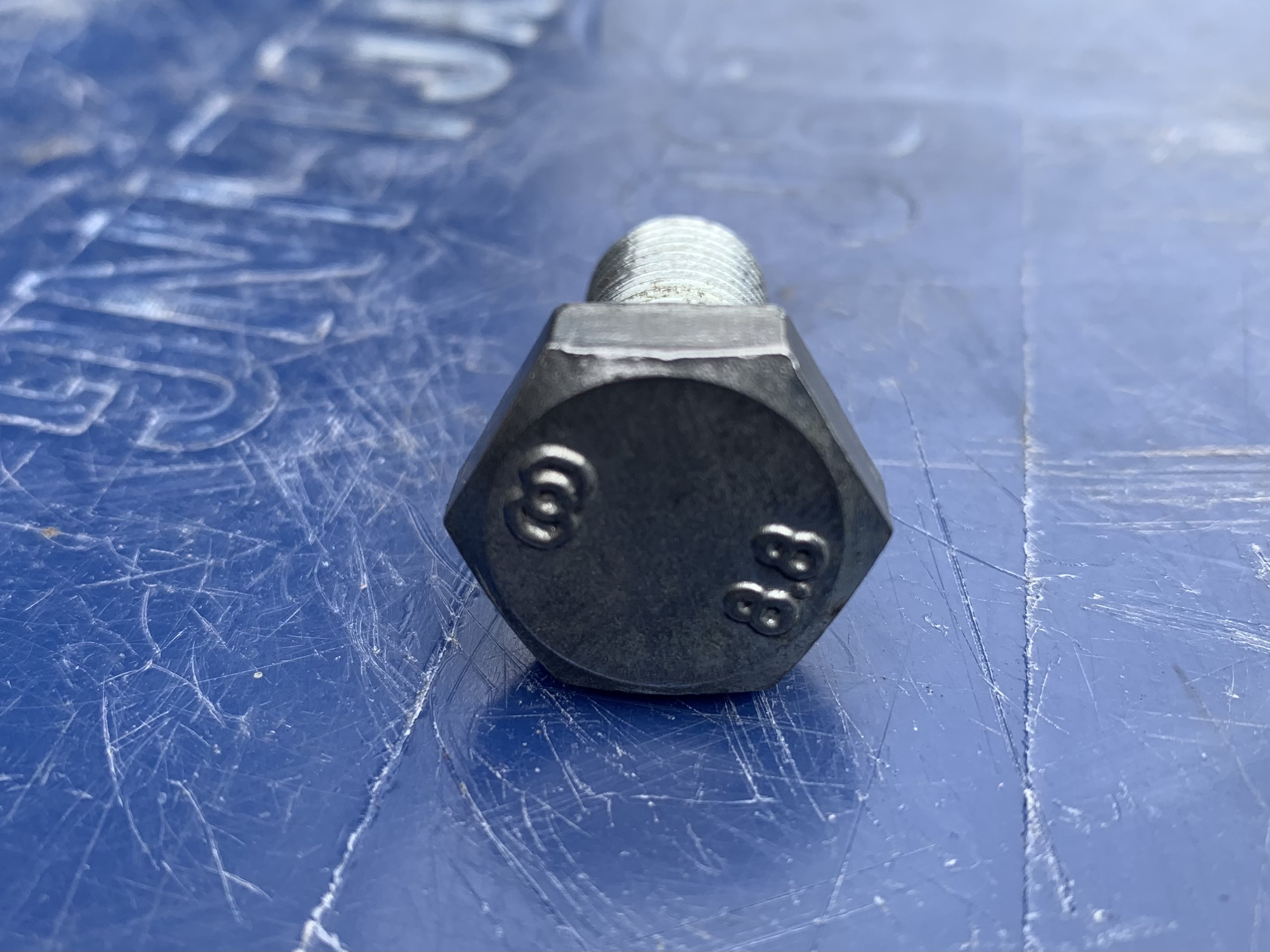

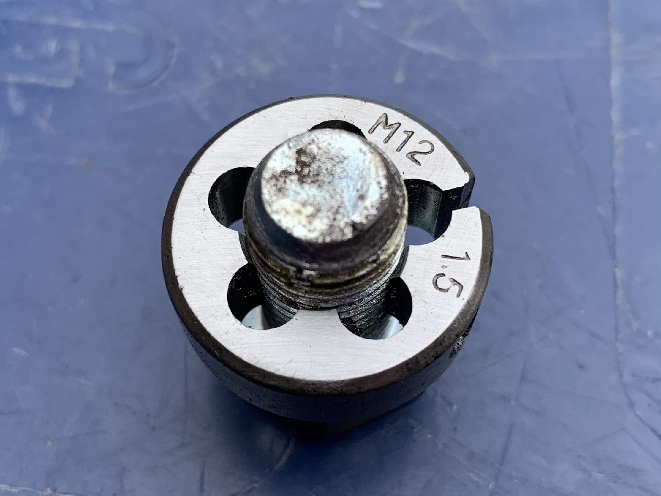

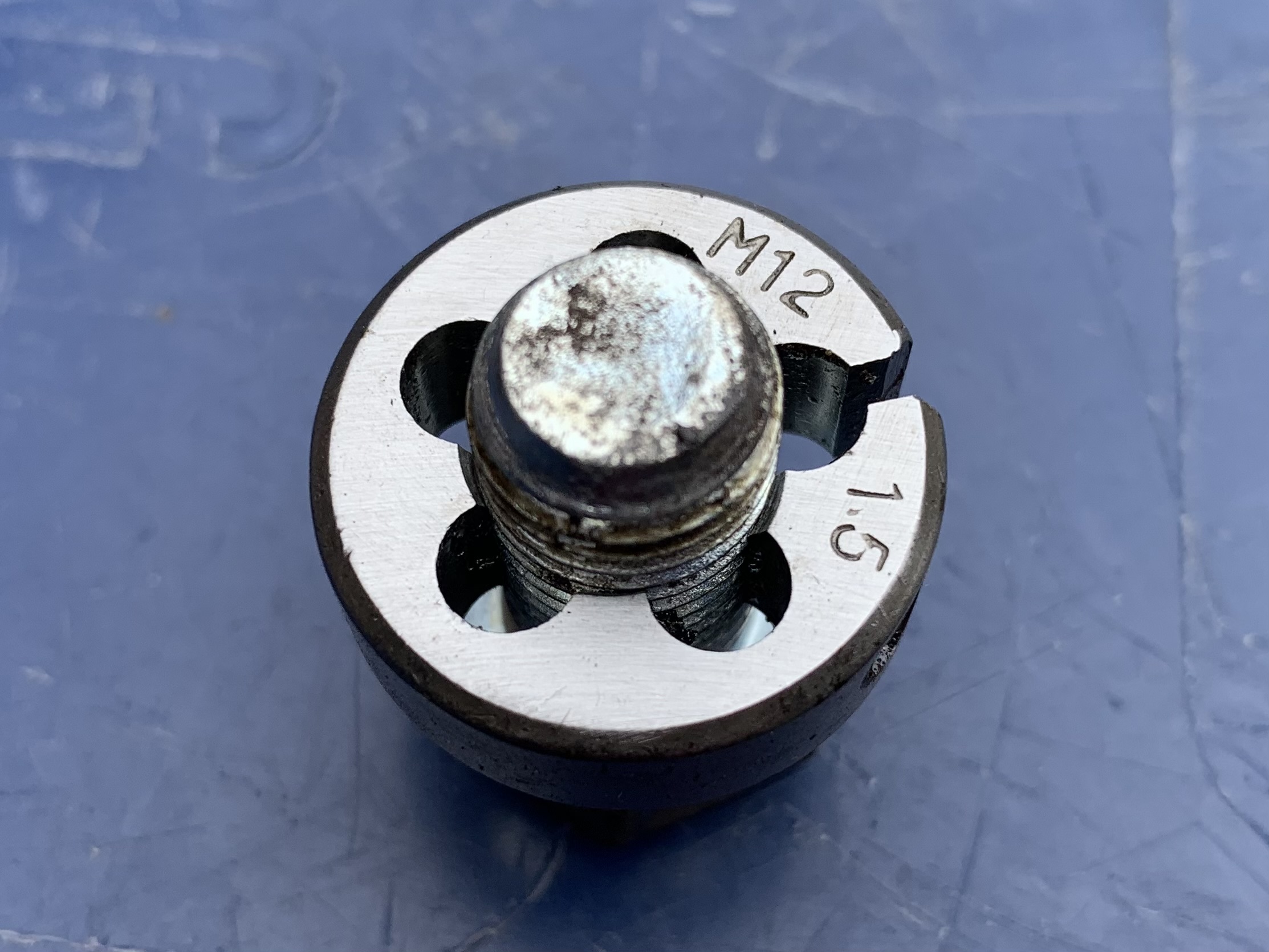

I ran a M12 x 1.25 die down a couple of the bolts just to clean them up but it removed a bit of material so I stopped. They are a fine thread. I'll be surprised if they're a 1.75 pitch. I've read a bit about the bolts, there's not much info to be honest but some people said they are 1.25 pitch which they obviously aren't.

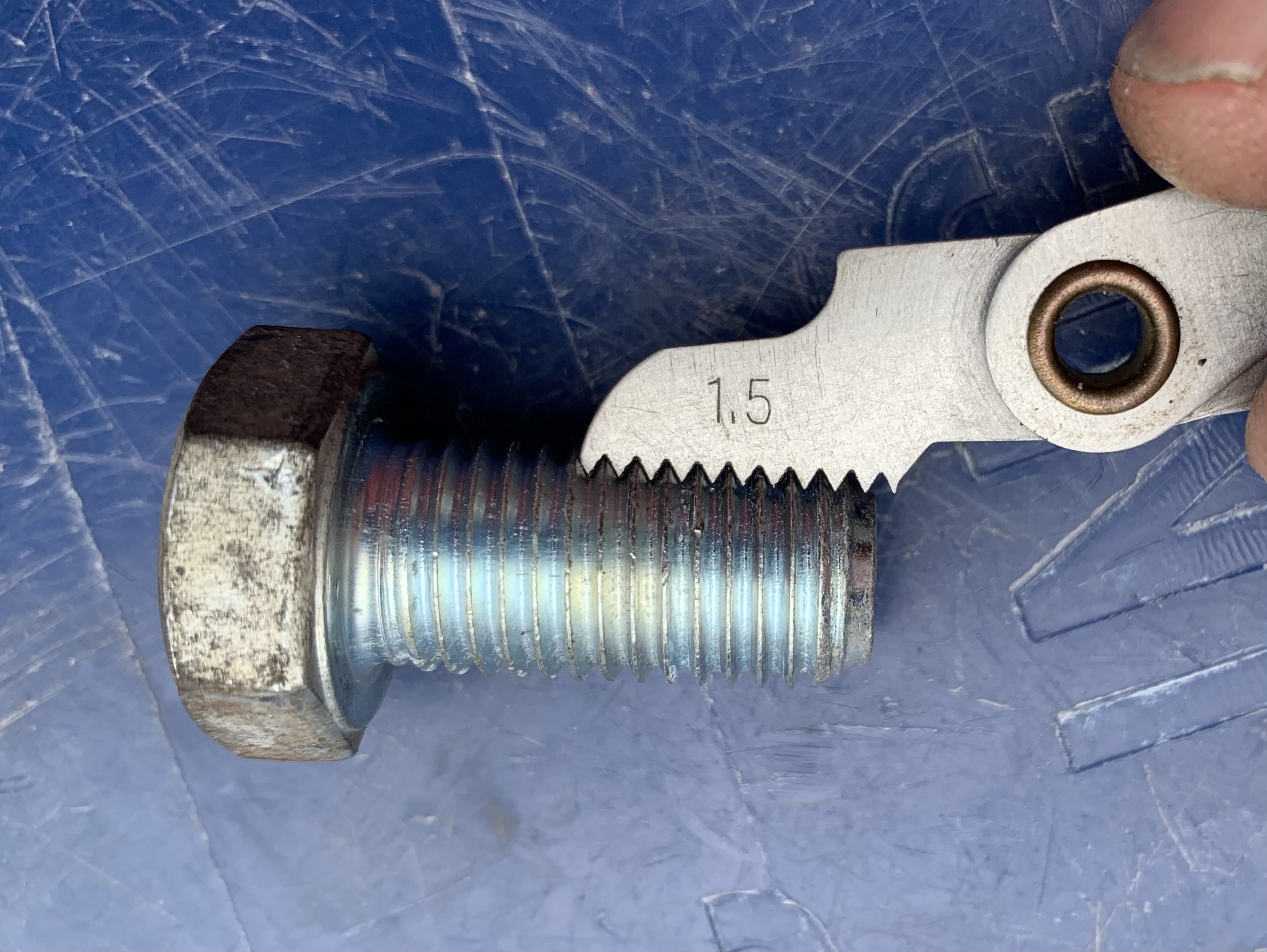

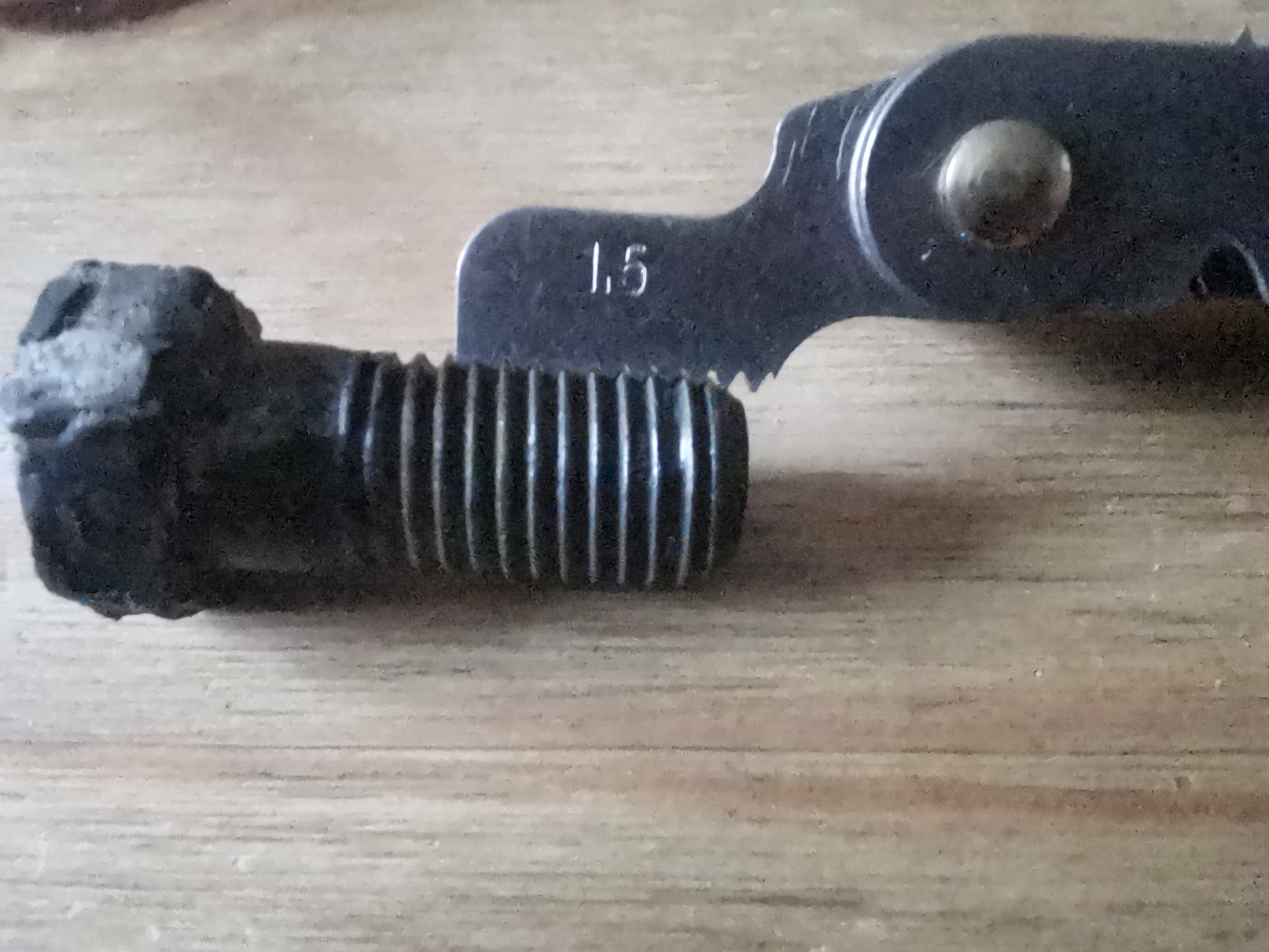

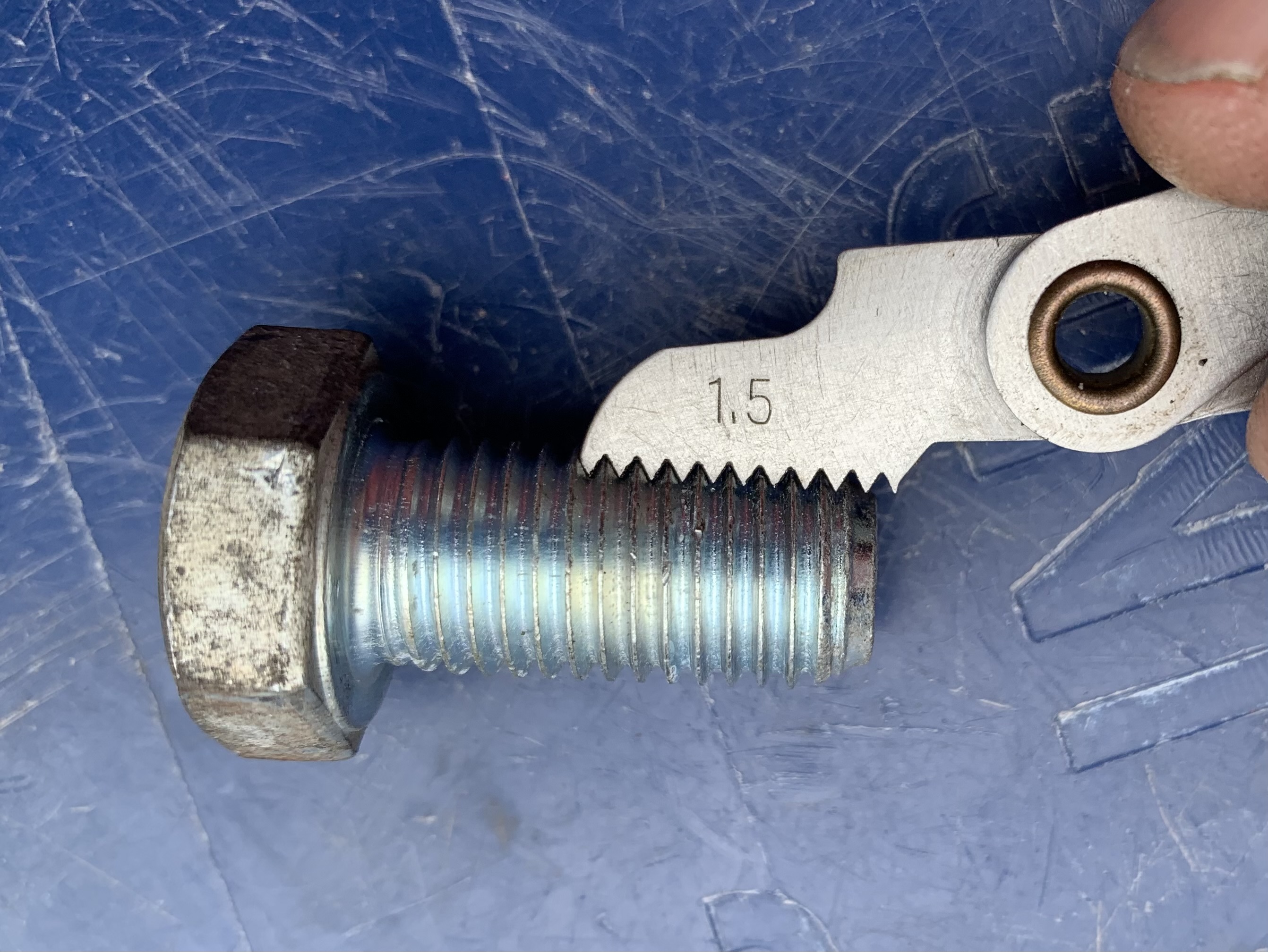

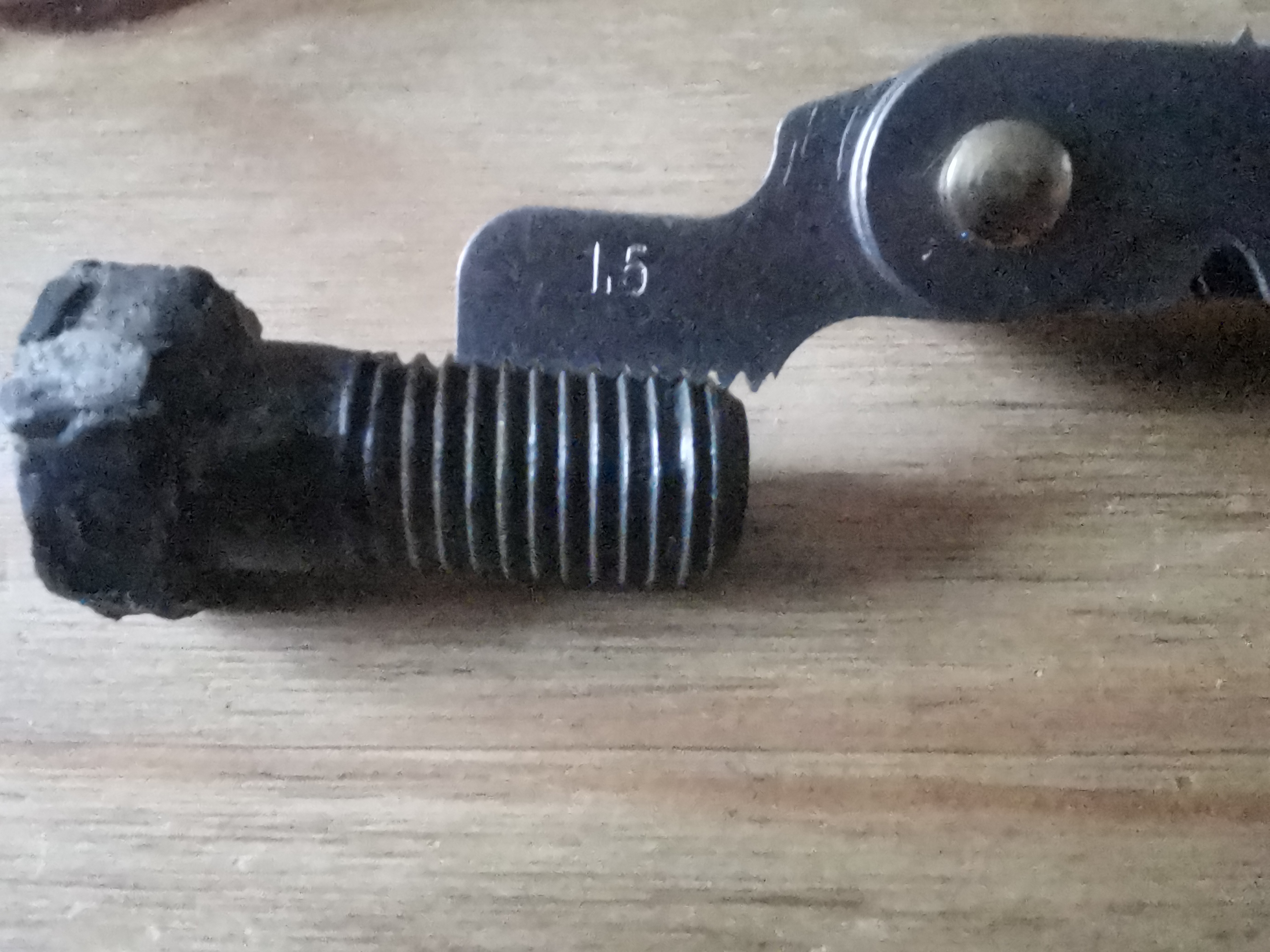

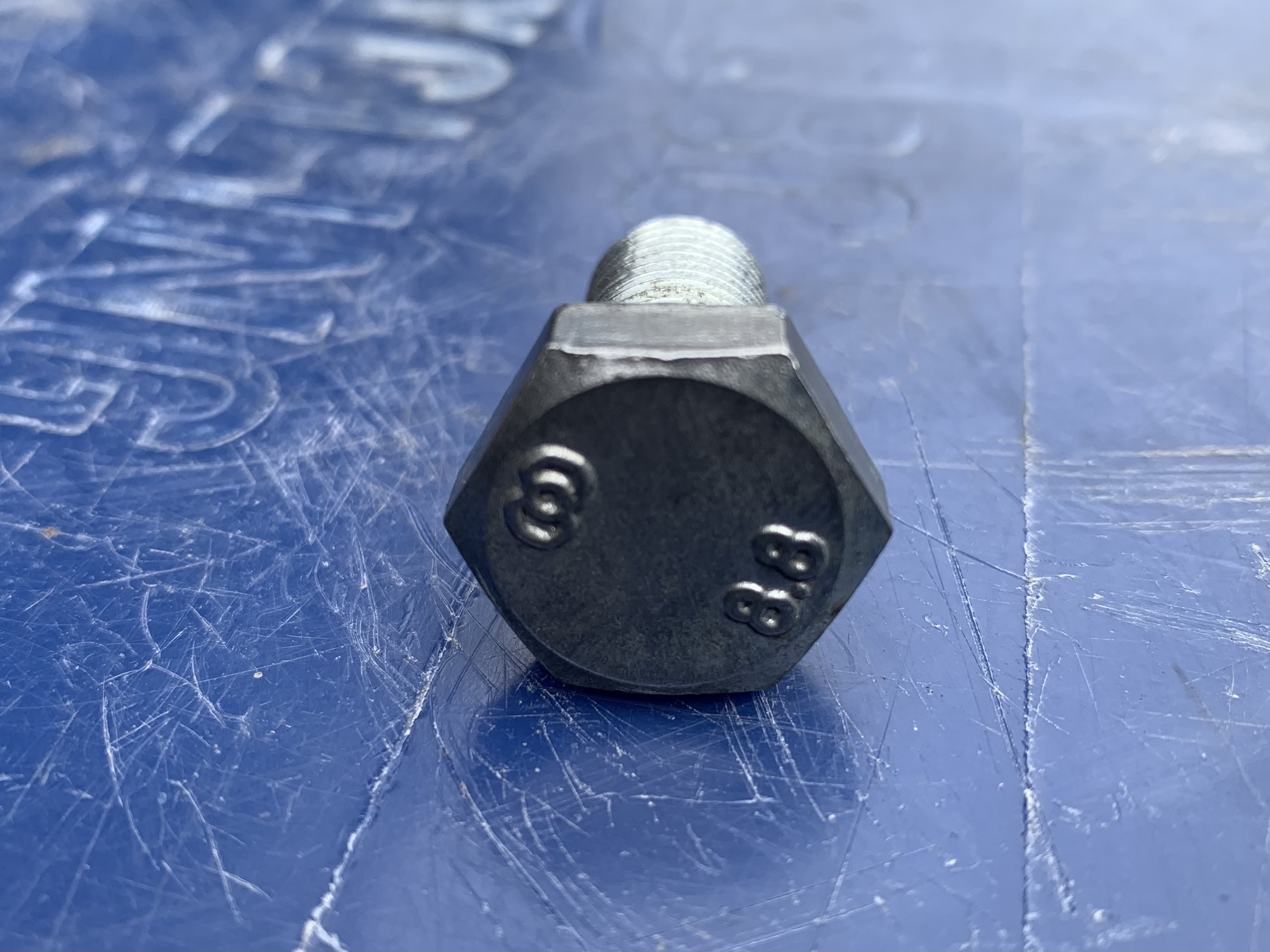

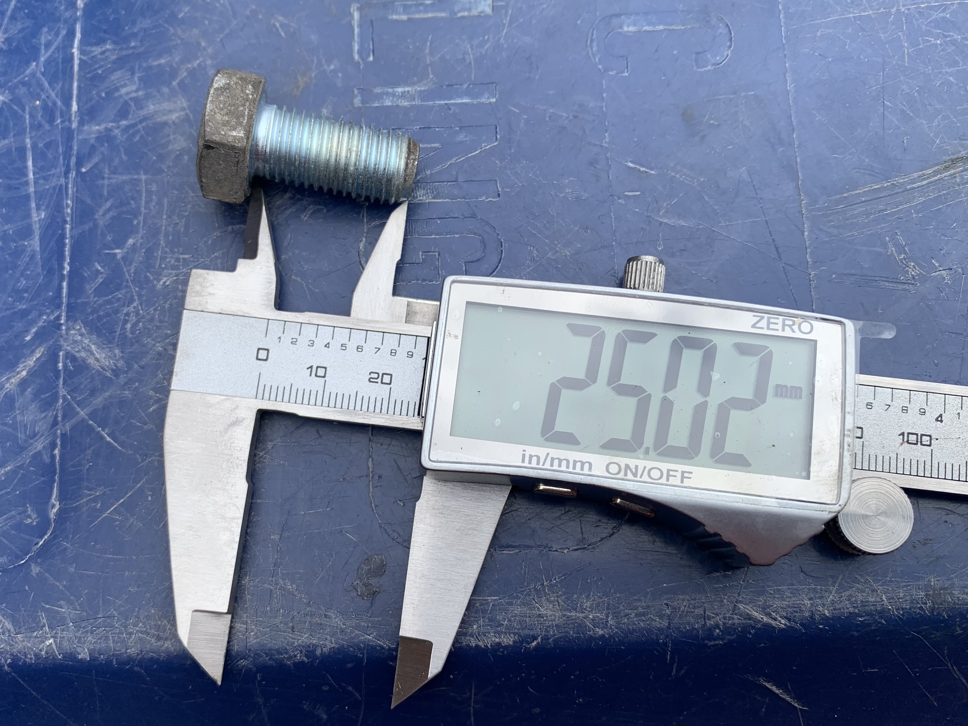

Cheers mateI removed the bolt for you and was surprised to find that the thread pitch was 1.5 mm instead of the standard 1.75 mm for a typical M12 hex bolt.
View attachment 1702843View attachment 1702844View attachment 1702845View attachment 1702846
It's worth noting that my calipers are not the original ones but an aftermarket equivalent from Febi Bilstein.
It's possible the original bolts are M12 x 25 mm x 1.75 mm. Otherwise, the different pitch would be noted in the bolt's technical details. At least we've ruled out the 1.25 mm pitch. Bolts are inexpensive, so it won't hurt to buy both thread types.
Just to confirm what you told me.I removed the bolt for you and was surprised to find that the thread pitch was 1.5 mm instead of the standard 1.75 mm for a typical M12 hex bolt.
