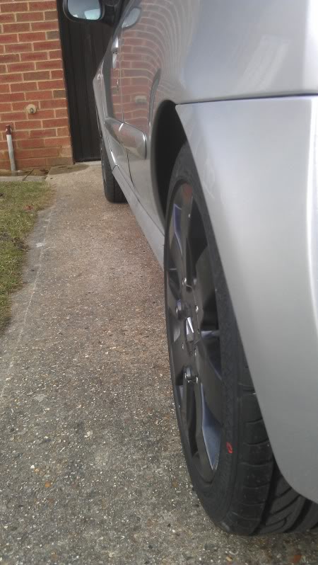

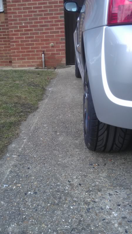

Not the best pictures
had my tracking done today the readout says 2deg all round and i have fitted 0.5deg shims on the back so std they must be 1.5 deg rear camber
