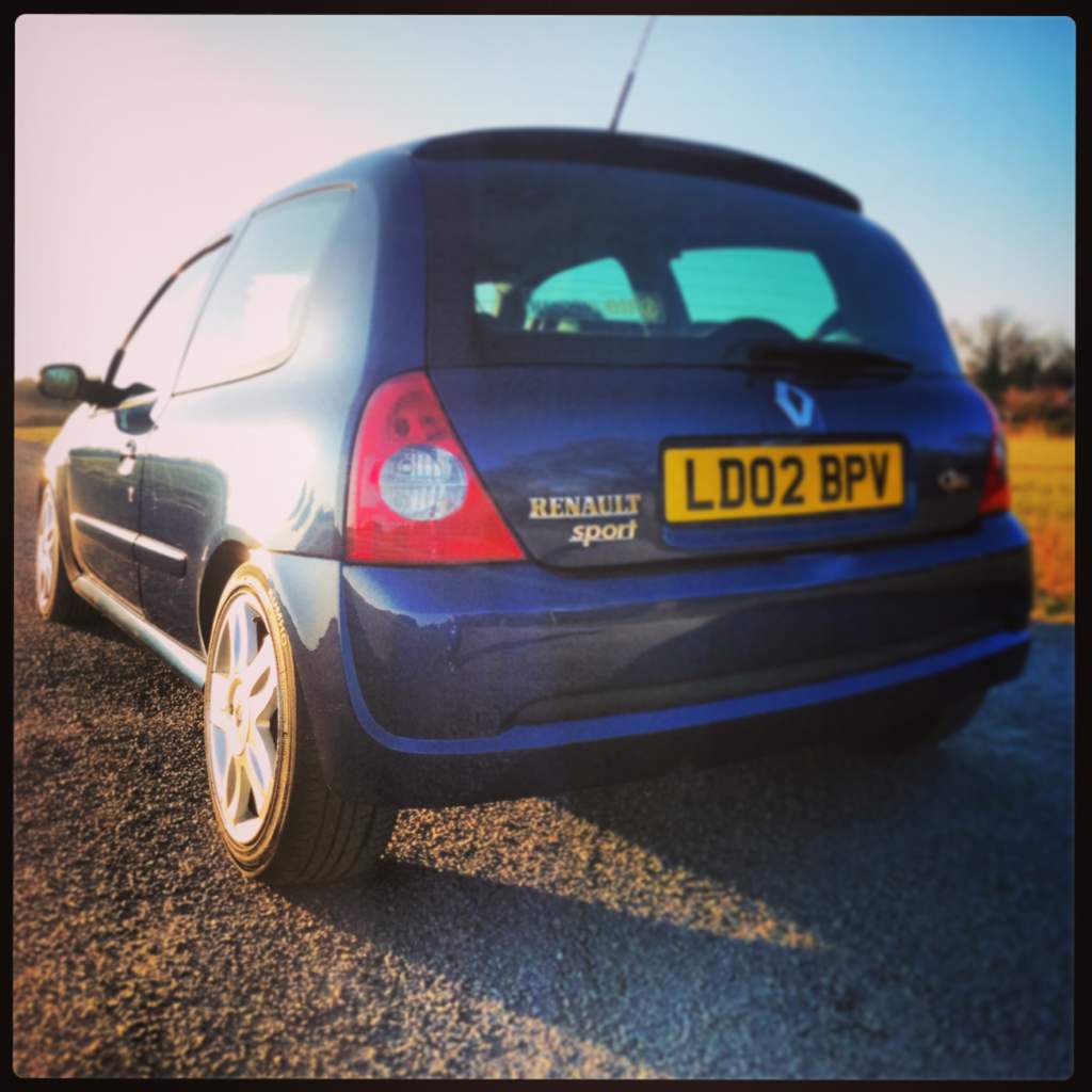

Need some rear cambered hub spacers for my 172 cup track car, just had geometry & corner weighting at BTM but been recomended to fit some cambered spacers to the rear, what dergree do you recomend???
