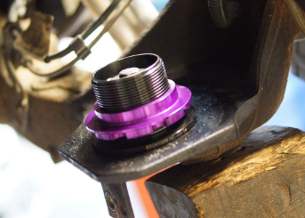

rear coil spring adjuster
Car  Clio MK2 ph3 1.6
mot tester has failed rear springs as they fall from seated position when on a 4 post ramp. hes suggested getting some rear adjustable mounts but im struggling too source some,
has anyone had the same issue please and where did you find them?
something similar to the image
yeah running springs. just need these in place so the spring stays in situ when lifted, he said could fall out if i hit a pothole, which i have quite frequently on these roads and never had a problem
