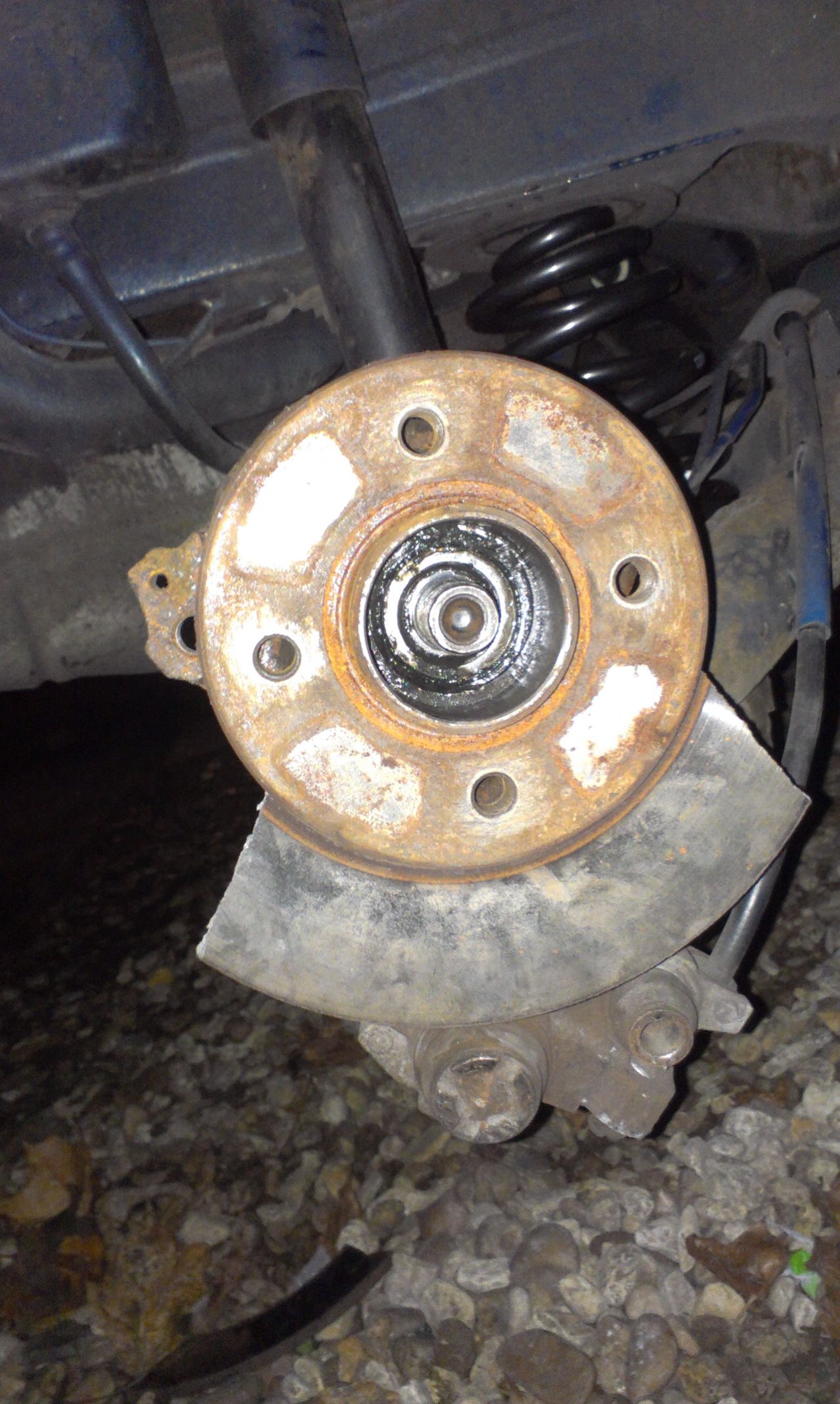

So I thought i'd get my hands dirty and have a go at changing my rear discs / pads.
This has not gone as smoothly as I have hoped, and I've had to give up for the day with my car still on stilts.
One disc slid right off, the other will not budge.. i've tried:
  • Hammer
  • Bigger hammer
  • lots of WD40
Any other ideas? The thing is wobbling around the bearing now, but that's about it. It's not looking like it's wanting to come off any time soon.
Would a blowtorch help?
Thanks in advance for any tips!
Adrian

I suspect when you eventually get it off you'll find that whoever last fitted the discs didn't install the spacer between the hub and bearing. As a result all the 175 Nm hub nut does is push the bearing up onto a very slight radius where it becomes a press fit and hence it won't come off.

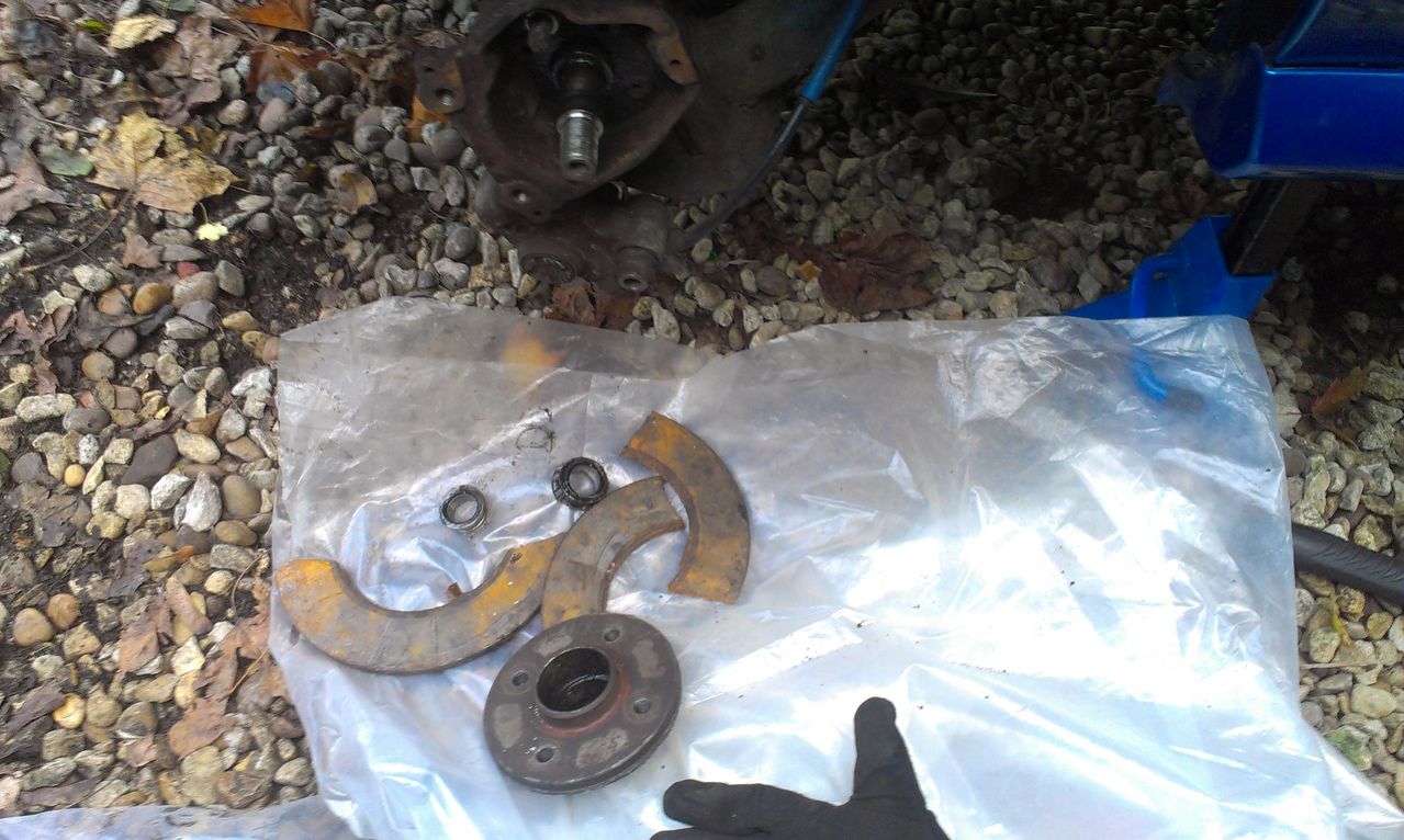

* The "easy" side absolutely wouldn't budge. Eventually came off by battering the disc with a mallet until there was a lot of play in the bearing, then using a small screwdriver to pluck the balls from the bearing, thus making even more play till the whole bearing collapses on itself and comes off in a million pieces. Not recommended TBH. Alternatively you can get a lot more leverage on the disc if you put the wheel back on and kick the sidewall. Clearly though this doesn't quite apply the force in the correct direction and is more useful for creating play in the bearing, should you adopt a "kill the bearing" strategy.

Thanks for this - I forgot to mention that the reason I am changing the discs is due to a knackered bearing, caused by... a lack of spacers! The side with the knackered bearing came off easily.
I have been reading up elsewhere, and some people suggest a sledgehammer. http://mechanics.stackexchange.com/questions/4/how-can-i-remove-a-seized-brake-disc
Going to give that a try first as it seems a simple option to begin with. I'll then try the M12 bolt option, as i'd rather not smash everything to pieces if I can help it (in which case a sledgehammer may not be the best course of action..)!

Try hammering off. The bearing will give up and the brake disc will come away, then use a set of bearing pullers on what's left.

Using a lump hammer, i managed to get the disc off after much hammering.
