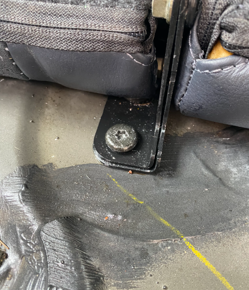

So, I have a couple Torx-40 bit and a ratchet, but this little t**t is refusing to budge.
I've sprayed some WD on it, though I'm really wary that the T-40 bits will just start to chew up the metal.
Is an impact gun the best option? I'll bob by a garage and see if they can zap it loose - unless there are any other options I can try first?

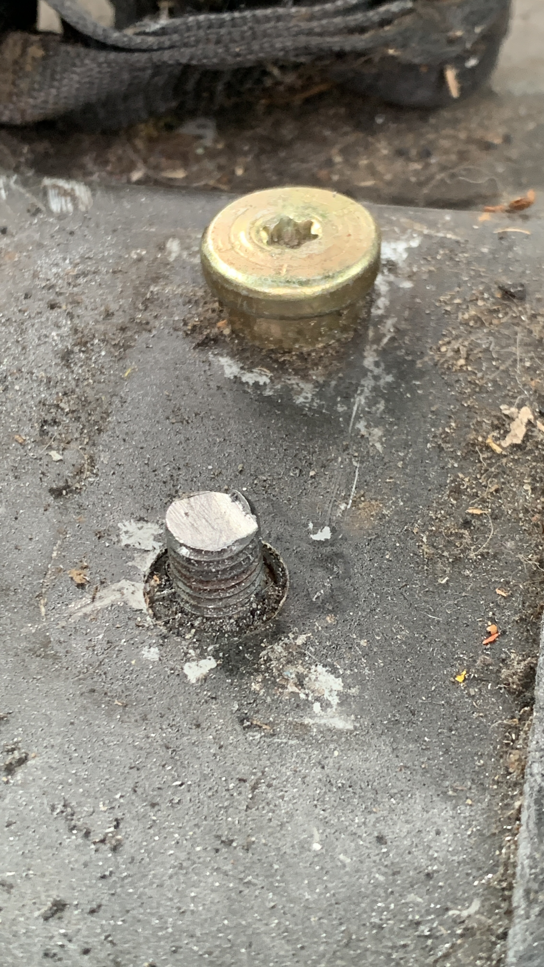

chazza114
Don't use an impact on it, I made that mistake on mine because I couldn't get the b*****d to budge. The impact pulled the bolt about halfway out before completely stripping the torx thread. I ended up using a hacksaw to cut through the bolt as that's the only way I could get it out :ROFLMAO:
Do as @Chode Lint says, clean it up and then soak some WD-40 through it, and give it a smack. A breaker bar might give you enough leverage to get it to break lose without stripping the top.
This is how mine ended up:

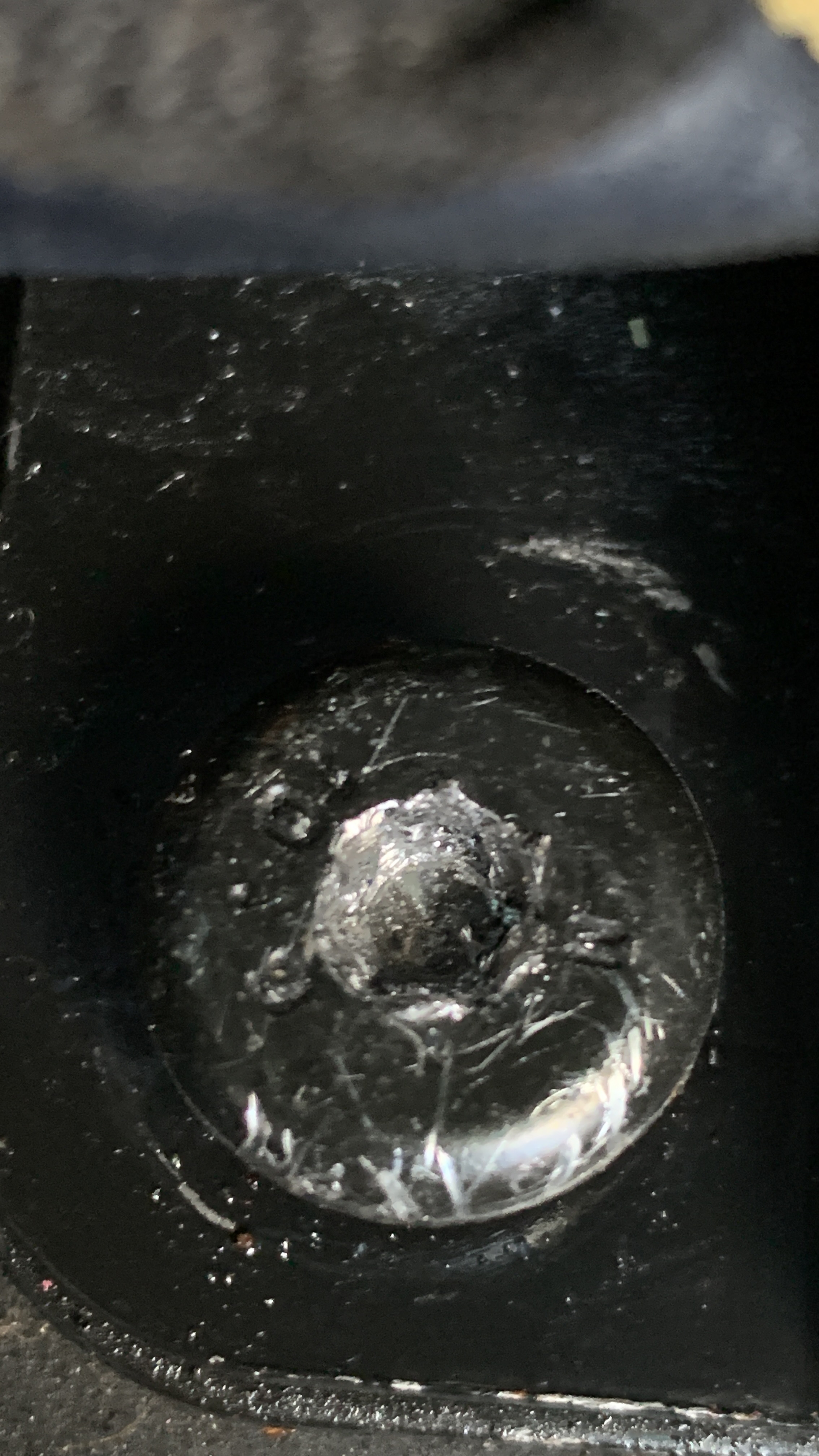

Darren S
So, twatted the thing repeatedly with a hammer - drowned it from both sides with Plus Gas and ended up with a half inch Torx40 drive on it.
It slipped once then started to move - but as per @chazza114 - it got probably about half way before going rock-solid again. No amount of forward and backward motion helped - it's not going anywhere and started to chew the thread.
Absolutely f**king raging with it. It's in a c**t of a position to begin with. It's clearly not up to the job. It's made of cheese because that saves some pence and I've got the majority of the rear interior out and come to a stop through the s**t design of one f**king bolt.
s**t like this pushes my buttons when 'just one b*****d thing' immediately stops you doing a whole host of others.
Now more time and faffing about will be needed for cutting the f**king thing off. ARGH!!!!!
