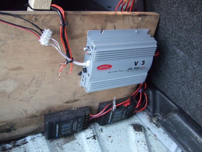

I am trying to get my rear speakers working in my clio, they are not the standard ones and are aftermarket. The car is a mk2 ph1 and has a standard renault philips radio cassette. In the boot it has

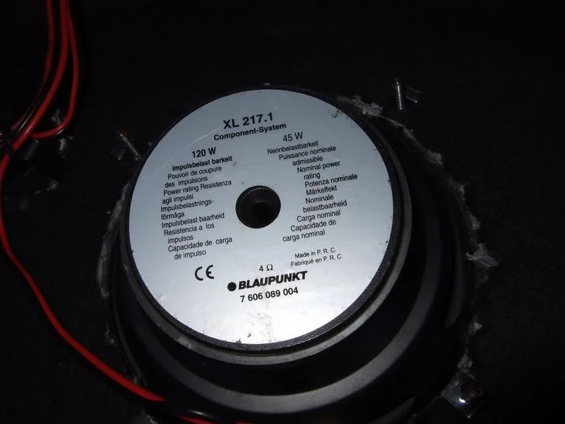

and two of these speakers in the parcel shelf

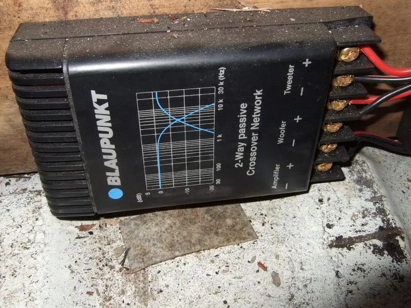

I know the amp is a Koac V3 which google says is rubbish so is any of the rest any good? and what are passive cross overs for???
Currently it goes radio - Amp - one crossover - 2nd crossover - speakers and theres no sound. Would it be best to remove eveything and just wire up the speakers?

A Crossover Splits the full range signal from the amp into 2 seperate signals, one for the mid and one for the tweeter
The HU goes to the amp, the amp then goes into the crossovers teh crossovers then should goto the speakers
looks like the crossovers are not conencted to your amp (teh close up picture of teh crossover certainly doesnt have anything connected to teh input)
