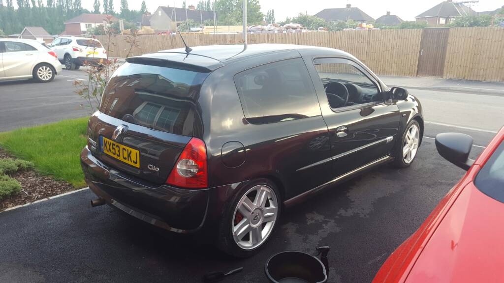

I've had my clio a little while now and the car was lowered before I bought it, I was changing the brake fluid and noticed that the rear springs were a coilover kit rear spring on anew adjustable platform.
The only issue is that the previous owner thought it would be a clever ides to achieve "maximum lows" by removing the upper adjuster ring.
I've been part of the volkswagen "let's take out the helper springs" scene before and this isn't what I want for this car, as it makes the back end feel rather skittish around corners sometimes as the shocks aren't really working to the ideal parameters.
Does anyone know what adjuster rings are the right size? Or does anyone know where I can pick up the adjustable platforms from without having to buy a new set of springs.
I don't really want to have to fork out more than necessary.
Thanks, here is a photograph to show you how low the back sits

There aren't many suspension options that offer adjustable rear height, the ones that do are priced close to a grand. Stuff like Spax, Avon, KTR etc etc
So if you don't like them take it off and flog it for a good chunk of change, you should have plenty to buy other suspension more to your liking.
They're a normal lowering springs kit bar the rear springs and adjuster platform, fronts are lowering springs on standard shocks, I'd like the ktec coilover kit but not at the moment haha

That doesn't loo that low at all to me. Might as well just get a complete set of new standard cup shocks all round, wouldn't look any different, and would handle a dream.

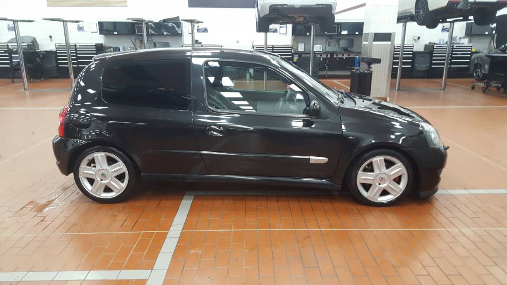

So I had the car in at work today (I'm always at work lol) and had a look at this suspension issue, luckily the spring seats are still there so I took them off and cleaned them up and wound them up!
The car rides so much smoother and feels alot more positive when driving, definite improvement!
They are race land springs and adjusters and the springs are tiny, they don't sit very well on the spring seats though so may end up getting new springs sooner than I thought
Here is how she sits now
