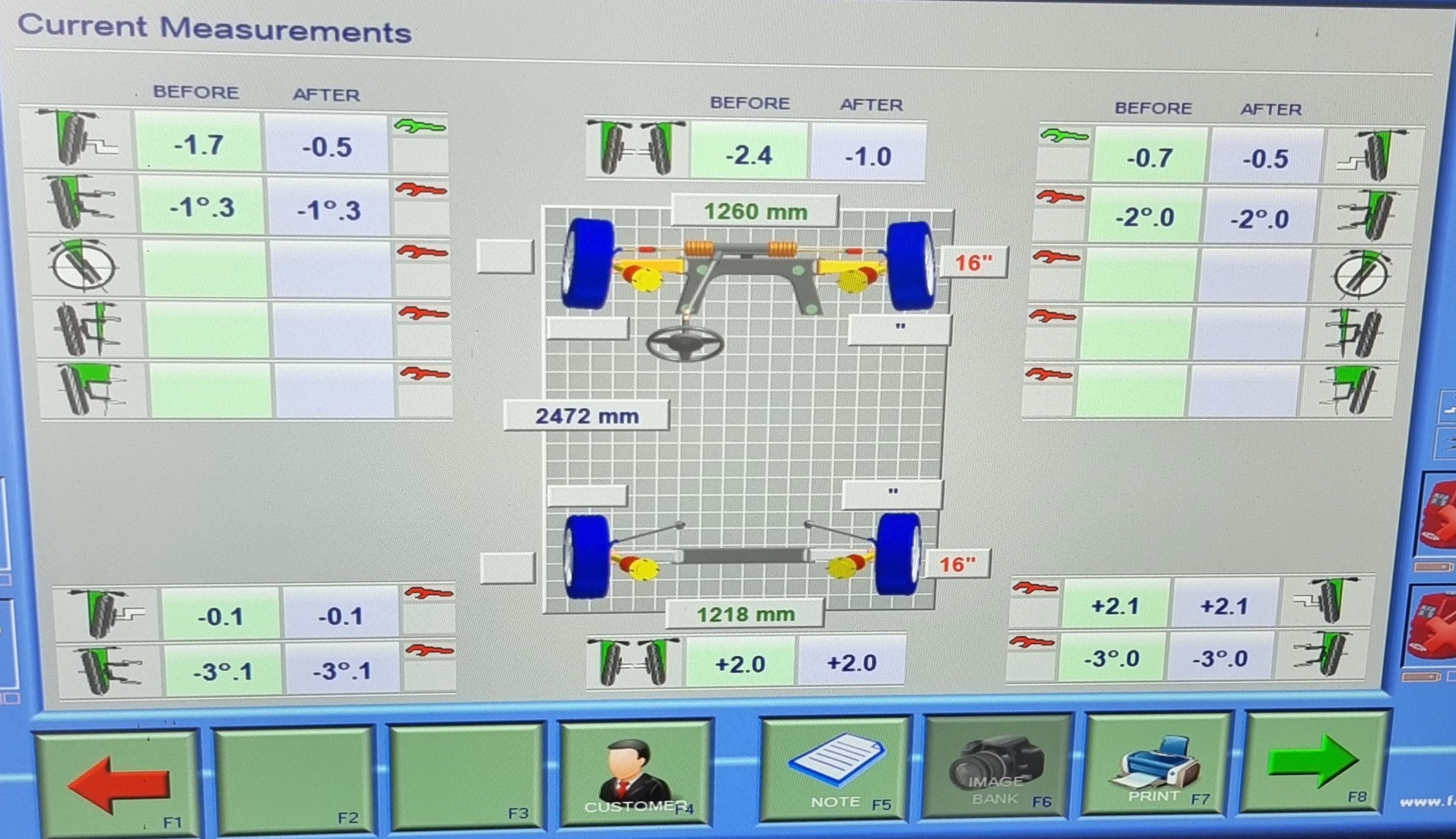

I have clio 182 cup with bilstein b14. I installed camber rear hub shims 5mm -1.0 degree.
I noticed on the print out that it says there is a big difference in rear toe!would it be a solution if we put toe shims on the right side? what degrees would be needed to make it at least approximately right?

Any idea what units it’s being measured in?
Our rear beam was miles off too. Had to be a fair few shims in there to get it sorted.
1mm toe measured on a 15inch rim is 0.132degrees.
0.1667 degrees is 10 minutes.
