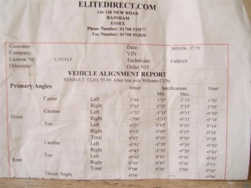

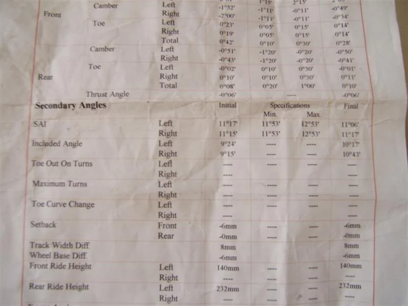

ever since ive had this clio it has had a slight pull to the right when driving. i thought something maybe bent at the front so thats 1 of the reason i went for the widetrack. got it back and it still does it. i found my printout from when i first got the tracking done and it seems my rear beam maybe f**ked, notice the rear left toe was toeing out rather than in and right seemed to be just ok. would this cause the car to pull to the right? got another beam from my old valver which i know for sure is fine as that never pulled left or right.
Doesnt look like there is a big enough difference for it to make the car pull to one side.
Does it pull on the steering or does the car tend to drift?
Asuming that its the same rack, could the power steering be trying to centre the wheel in the wrong place?
The fact that you've had the track done rules out the wishbones
if i let go of the steering wheel it will tend to wonder to the right. does'nt like doing left turns to much either, feels fine going right tho. when i had the widetrack done i had everything changed apart from the subframe ( was told its in good condition ) and the power steering pump, could that be fucked?
silly question but are all the tyres the same make and type , also same wear, and pressure. and they fitted corectly , outside wall is correct
