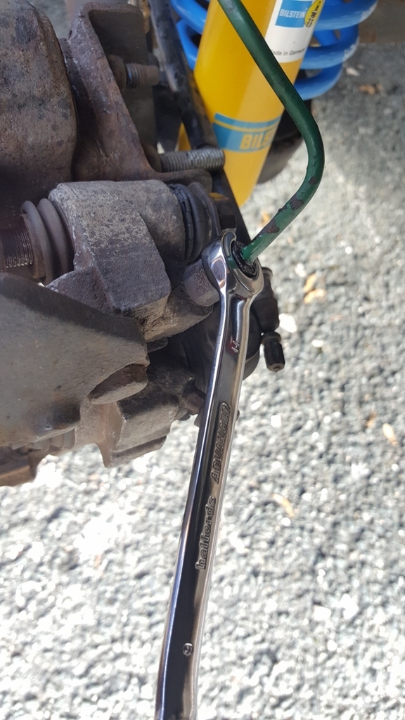

Replacing a leaky rear wheel cylinder on my 2005 1.2. What size is the nut that secures the brake pipe into the back of the wheel cylinder? I heard it was an 11mm, just checking.

The unions?
11mm yes, well on Sports anyway, should be the same size

A drop or two of wd40 or similar will help if everything's covered in dirt too
