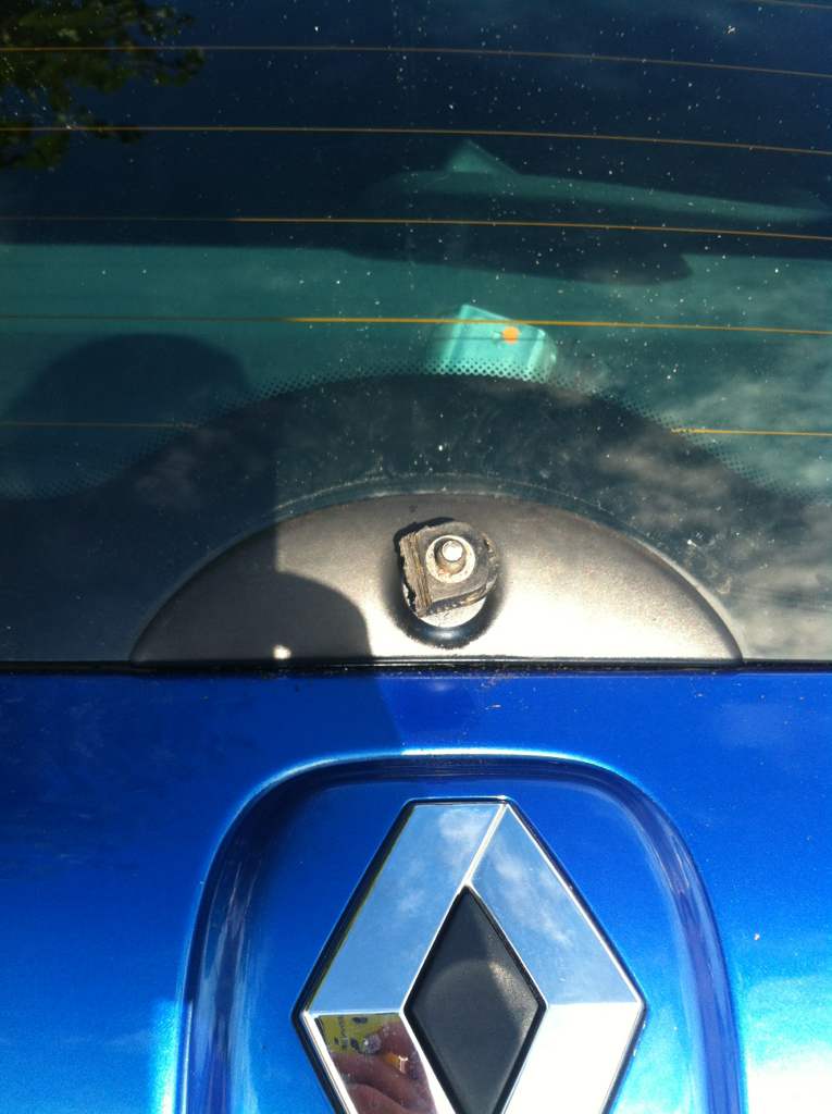

Im having real trouble getting the fooker off. How do i get the bugger to drop out

Ive totally butchered it lol
Im proper worried about breaking the window or damaging the boot
Just use a 2 or 3 armed gear puller. Will get it off straight away!
Managed it twice, both times without buggering things up.
Good to see you've sorted it now :) , but encase anyone else wants to get it off without hacking the arm off and hasn't got a pulling tool you can use two spanners to the same effect, one to place behind the spinal which holds it all together and then another to losen the blade. Can't remember exact sizes as I removed mine ages ago :/ Just remember lots of WD40 on the bolt and let it soak. Hope it helps :D
