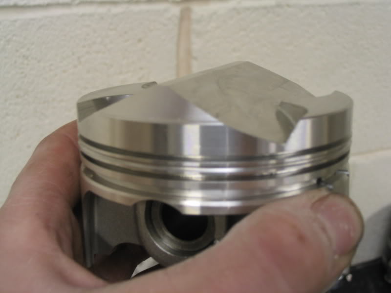

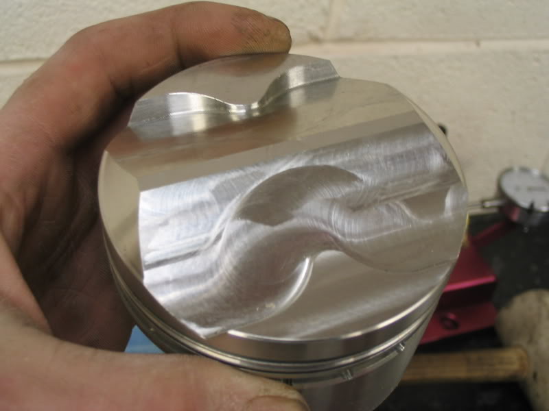

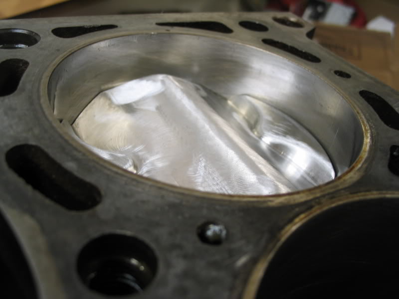

Reason for smoothing edges on a piston?
Just curious to why people smooth the edges off a piston.
From this
To this
Surprised fred didnt answer this .... pocketed pistons (that ones extreme) for very lary cams ?
Thsts got four round cut outs for valve clearance
  HBT 172 Cup

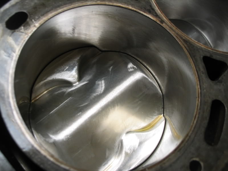

You can see in this picture, the sharp edge of the squish has become a focus point for detonation
