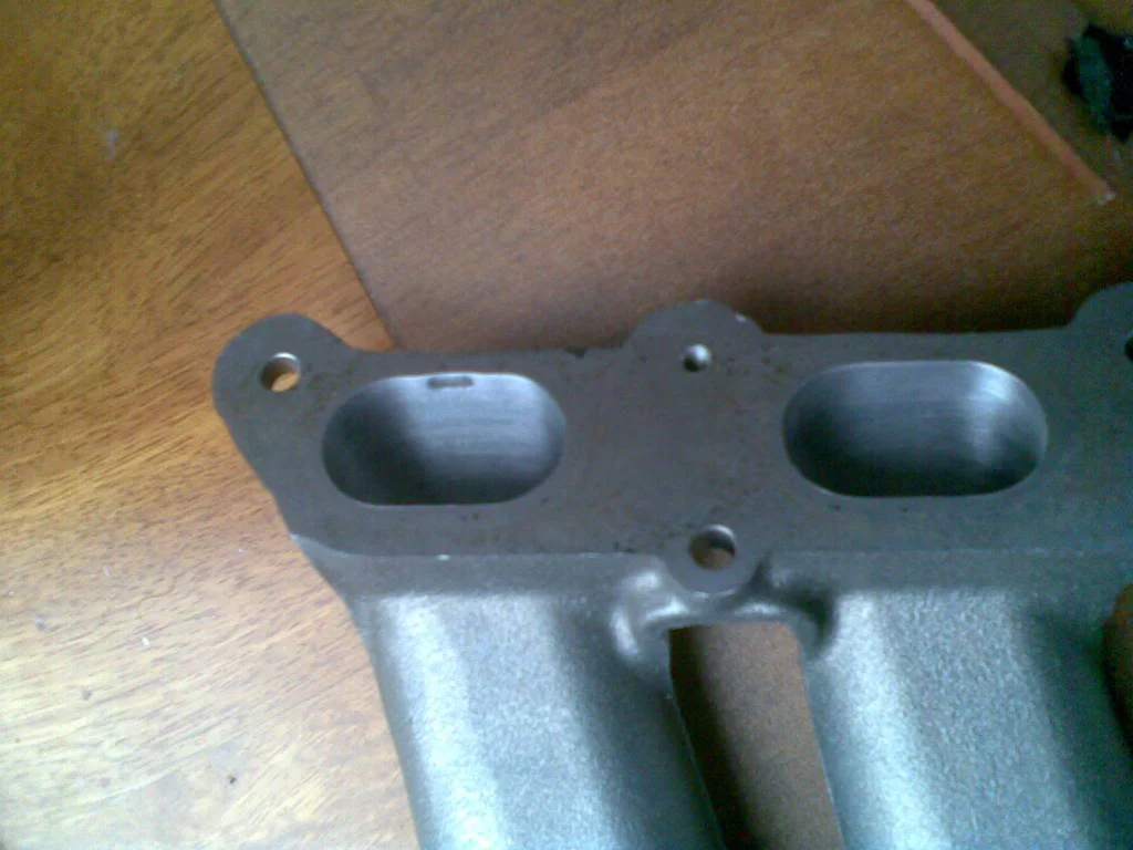

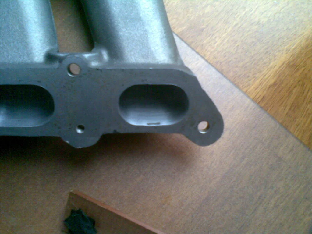

received matched inlets , is this one okay ?
  RS RIP
i received them from Ben, after looking closely at them there is a spot where the grinder might have "bit" itself in and there is a "dent" on this spot.
excuse my English :eek: but when looking at the pictures you'll see what i mean..
Will this be a problem (maybe a different flow through this one?) or should i go ahead and mount them ?
please advise , thanks very much

To me, it is not a bit mark instead a slight marking of "cast-core". I would not bother, go ahead and get it installed.

yeah well it's defo a dent , 1mm off in comparison to the rest.. Nothing dramatic, just wondering how this would maybe have influance on the flow ?

Thats normal most of them come like that. If you look at the inlets before being matched then there is a big groove there already. Its just the matching process does not require that much material to be removed so that the groove goes. One of the best mods ive done since getting the car.

i've been convinced already about the inlets, not worrying. i have seen othe pics and yep the mark is there on others too ..
