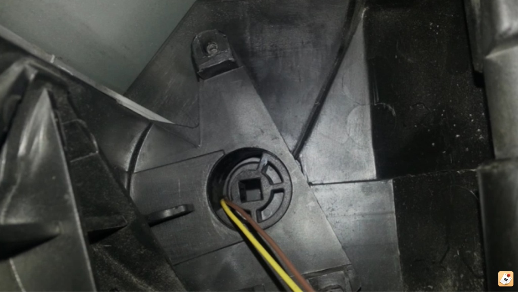

My motor works fine. It's the part that the motor fits into that has broken. This the motor goes round and round in that square hole. However the square hole is broken on one corner.
  Clio
This square hole that the motor goes into. One corner of this square hole is broken and the motor goes round and round. The recirculation flap never opens or closes properly.
Is there a way to fix the broken square hole?
  clio campus
The square hole is perfect in the picture you've posted. It seems to be a picture taken from one of my videos. :evil:
But the answer to your question is ... you may use Q-Bond to fix it. ;)

Sorry, I meant that the square hole in that picture; that that part on my car has broken. The top left corner has cracked and the motor goes round and round forcing the square hole open and doesn't actually move the flap. The motor is fine. I've had it off and it moves fine. Then I saw the square hole cracked.

I can't, if you look at that square hole in the picture, the top left corner is snapped open and the square thing on the motor that goes in that hole, just therefore goes round and round opening that corner and won't turn the flap. The motor I have works fine.
(that picture is off someone elses car, and the square hole is perfect and not broken, but mine is broken)
