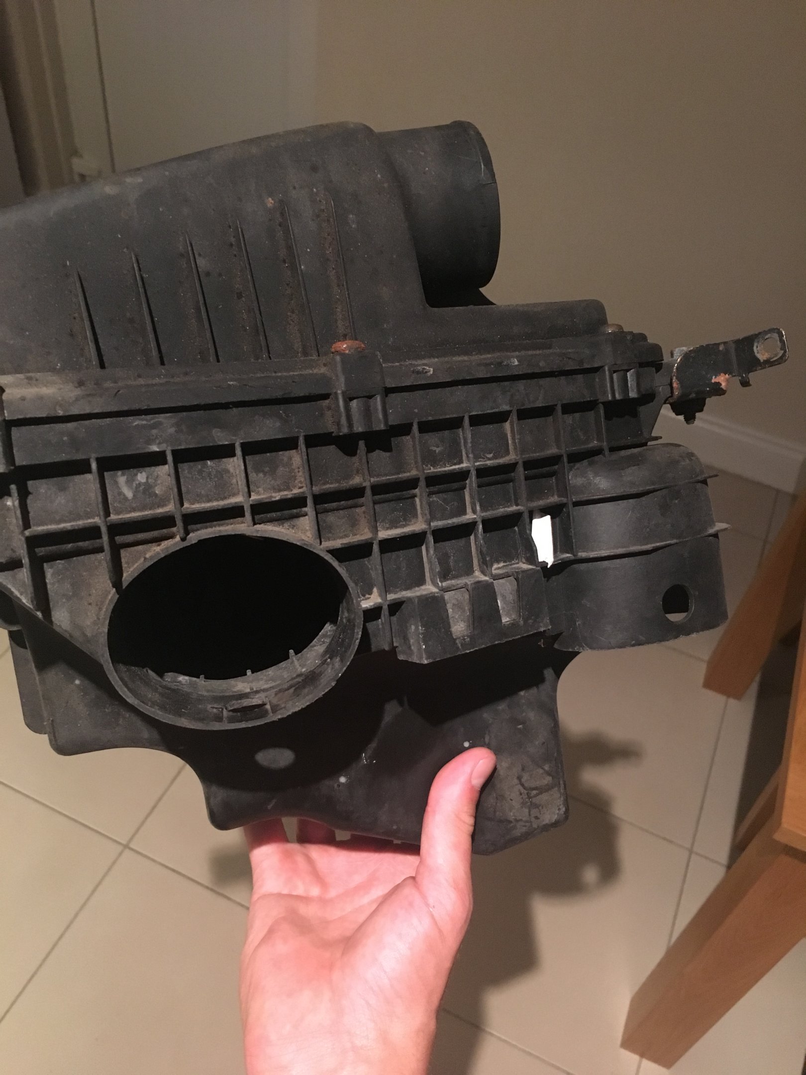

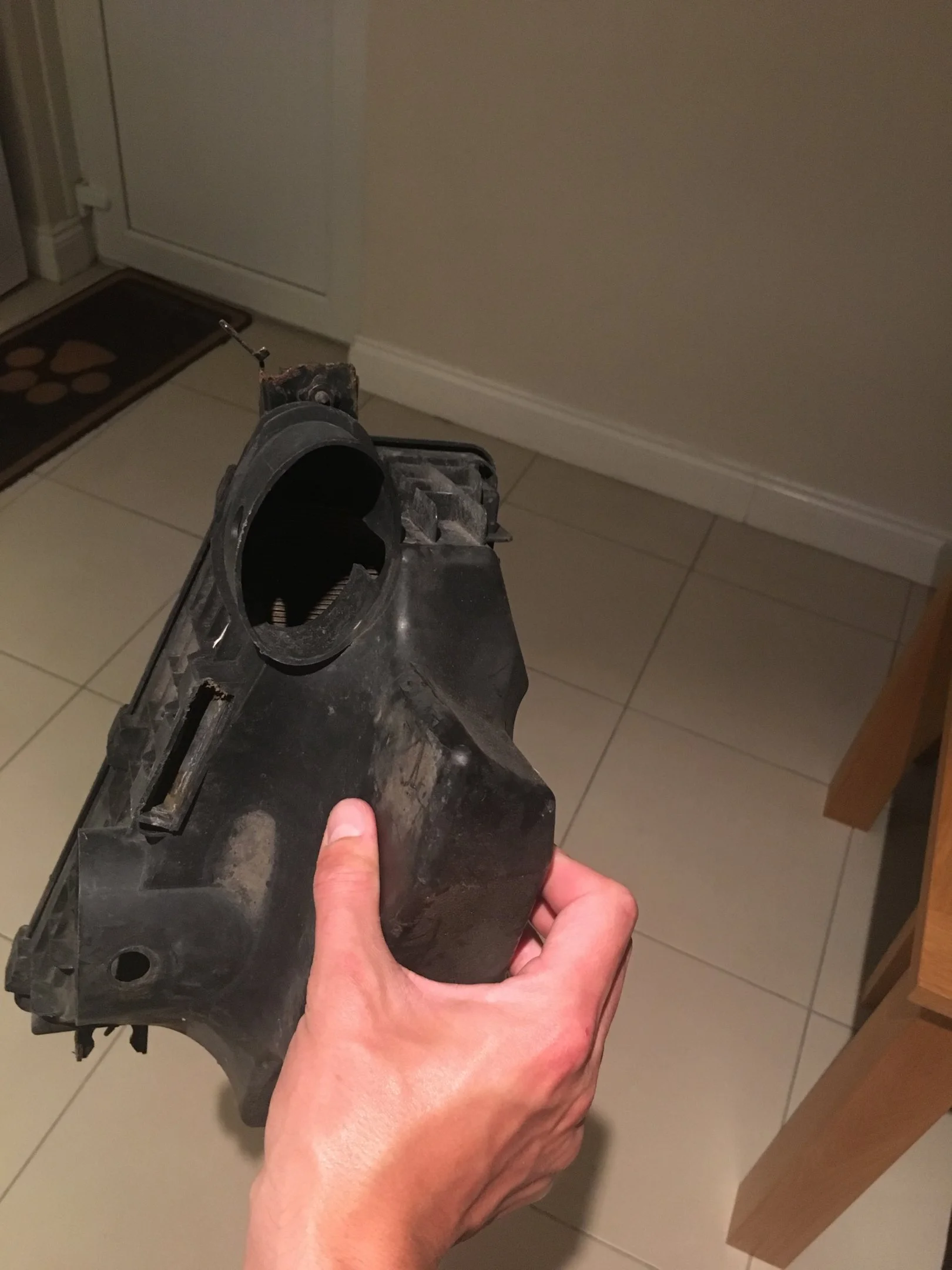

Hi guys, so I bought a standard airbox off eBay to replace the ramair induction kit that’s fitted to my 172 cup. However Iv noticed the intake on the standard airbox is oval! Has anyone just fitted a CAF pipe to this even though it’s oval? If not has anyone got a standard one they’d sell?

Yea the round one runs to acoustic valve and oval is the air feed?
Big oval one runs to the acoustic valve , smaller round one is just an air feed iirc . I think the smaller round one is 50mm , you can use a round one on the oval side , you'll obviously just have to make it fit . Some people remove the acoustic valve altogether .

Here’s what I have. Seems both are oval ?

Ahhh yeah you're right . They're oval on the airbox end and round on the other end . On the oval end there are like some little lugs that sit inside the holes to hold them in place . If you get the right size tubing they should be able to sit inside and not fall out . Or you could put up an ad in the wanted section. I'm sure somebody will have both of the tubes lying about .

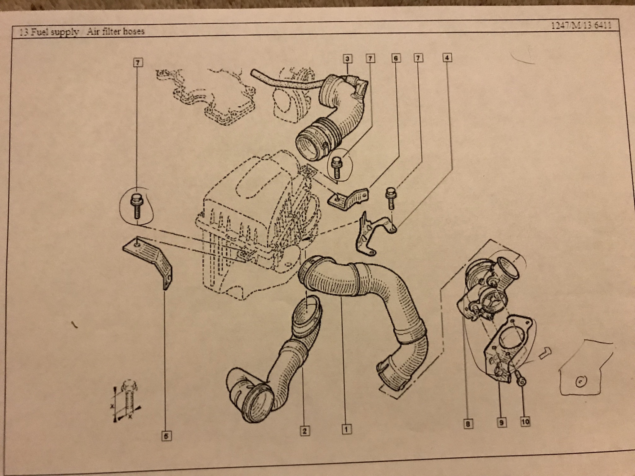

Could someone show me what way the airbox bolts in. I don’t seem to have the brackets needed to mount it. It looks like it may mount onto the ecu bracket at the back but can’t see how the front mounts

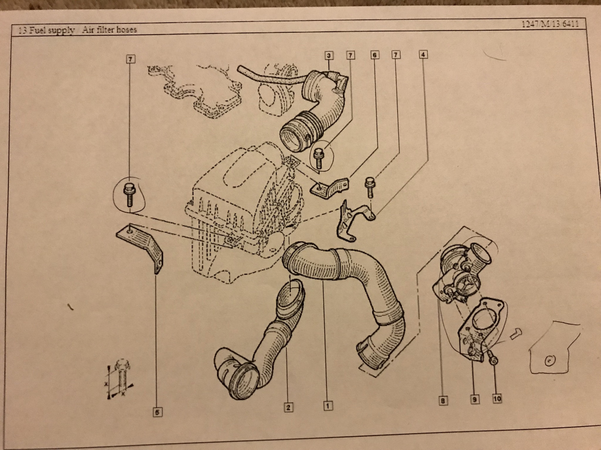

Oooh the pipes seem to be made from plastic in that pic, with joins between moulded pieces. Were they ever available?
I think it's just the pic that makes them look like they're plastic. The ones in my 182 were the felt type you mentioned , I had the same felt type in my 172 also.
  Clio RS 172 2002
I’ve only ever seen felt. Was hoping the came in plastic because they may be a bit more durable particularly the acoustic value pipe which gets squashed and moved about a lot being next to the battery and near the headlight.
