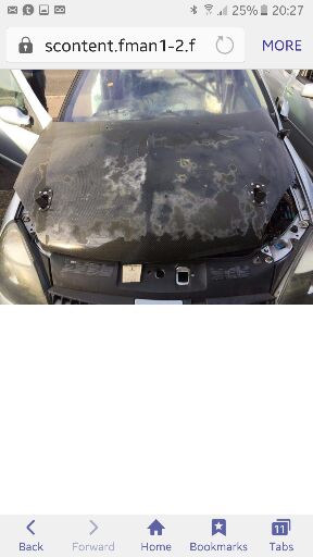

Im collecting this bonnet friday it looks like it needs a full laquer is it just the case of flat back and laquer or is there anything i should be aware of before attempting it.
Be careful not to sand/abraid too much as you'll start to break the fibres below. Normally composites have a layer of prepreg glass on them so when it's cured you get the gloss finish. If it's a Matt finish it usually means there's no glass layer. It could be they've just lacquered the carbon if so it should be easy enough to prep but still be careful not to sand into the fibres.
I would start on an 800 grit wet and dry to be on the safe side. If you feel it's not taking much off then go a bit coarser, don't go any more coarse than 320/340. I work in composites and have had to prep cured carbon before before. It's time consuming so be patient.
Hope this helps.

Thanks mate just what im after

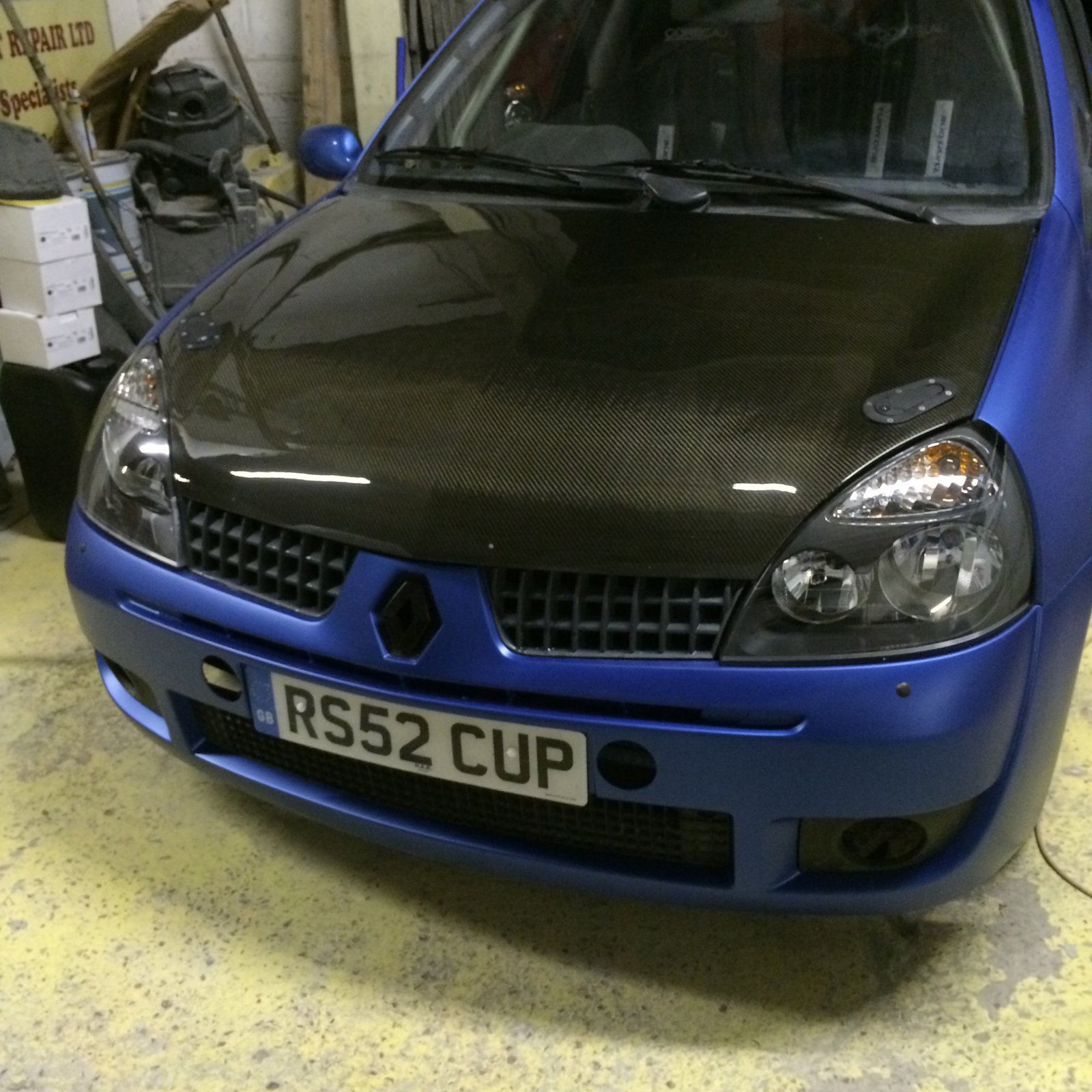

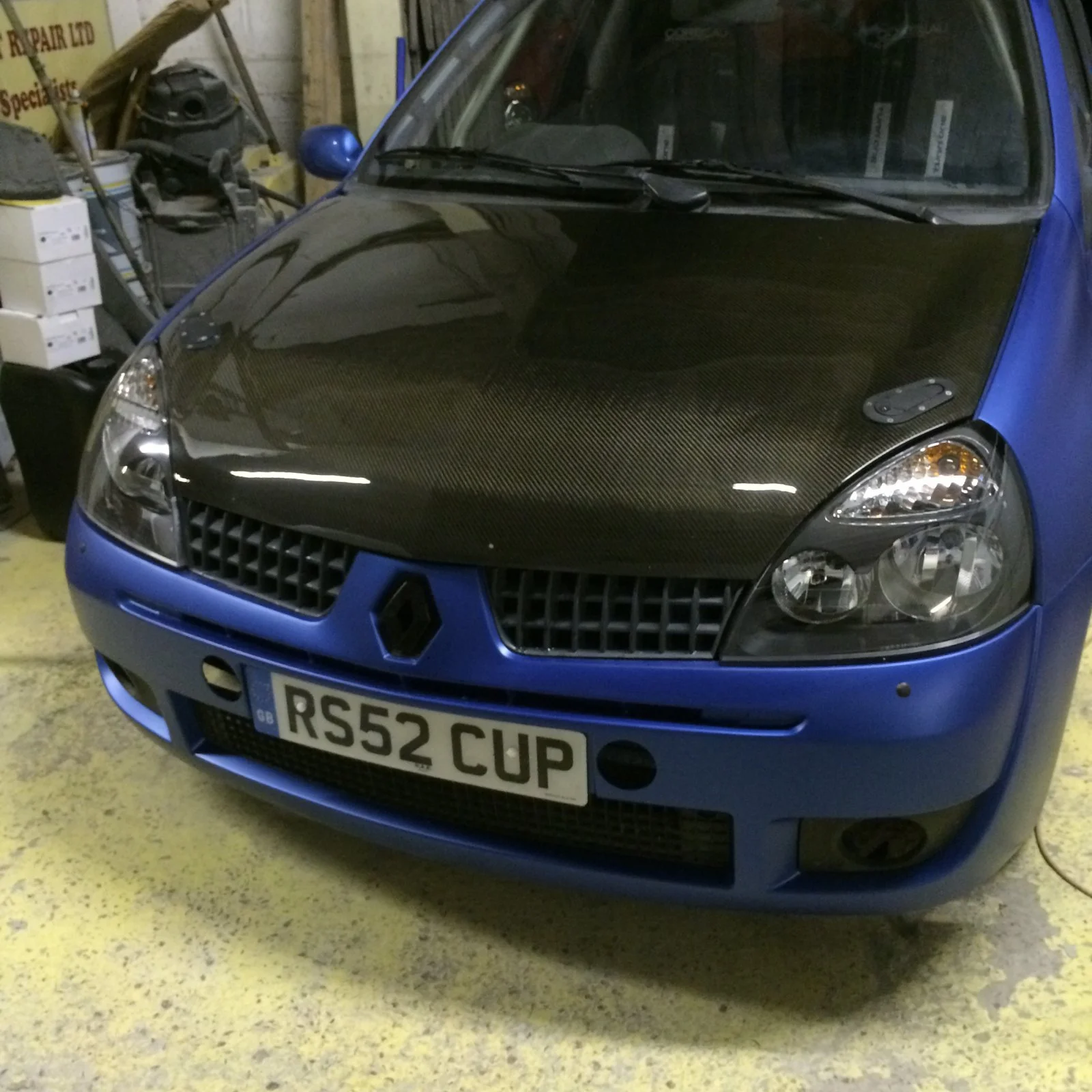

Mine was exactly the same as yours blow the worst off with an airline da it all down with 320 dry dont use any water until youve got the first lot of lacquer on once the lacquer is dry flat it all off again 500 dry/800 wet and repeat until your happy with the finish mine needed about 9 coats in all
If the bonnet has got wet make sure it is 100 % dry before you start hope this helps

Stunning mate thanks
