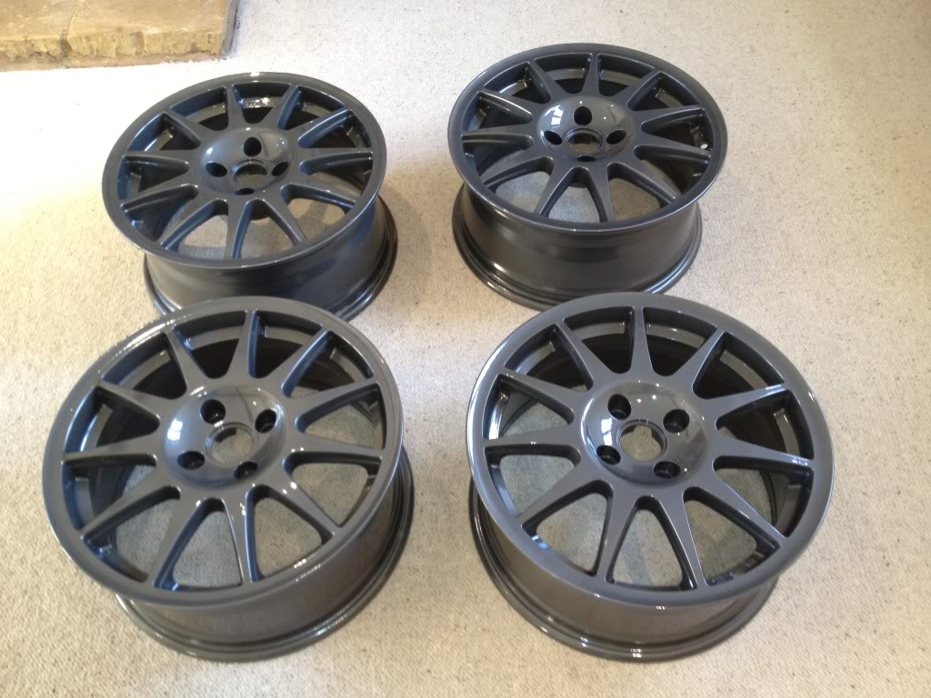

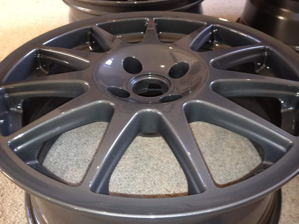

There is a place in Birmingham that powndercoat wheels for £20 each. They fully refurb them aswell and do a top job. It's called citypowdercoating.
Not worth the effort of doing them yourself to be honest.
Recent set i had done:
