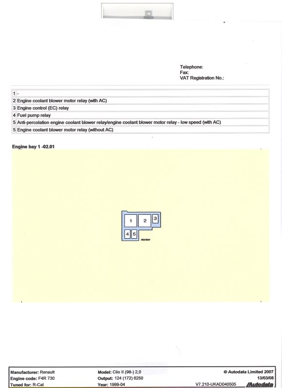

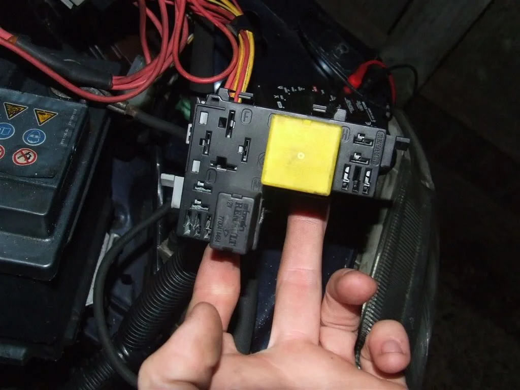

That shows up as a PAS relay on dialogys. Don't suppose you've got a pic of the relays you need? With the ratings etc on them? It won't just show me.
yeh, shows up as PAS for me too, but afaik, the PAS doesnt have a relay?

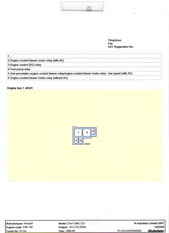

3 and 4
both just switching 12v
3 & 4 are missing in that pic, but they're the same as 5
