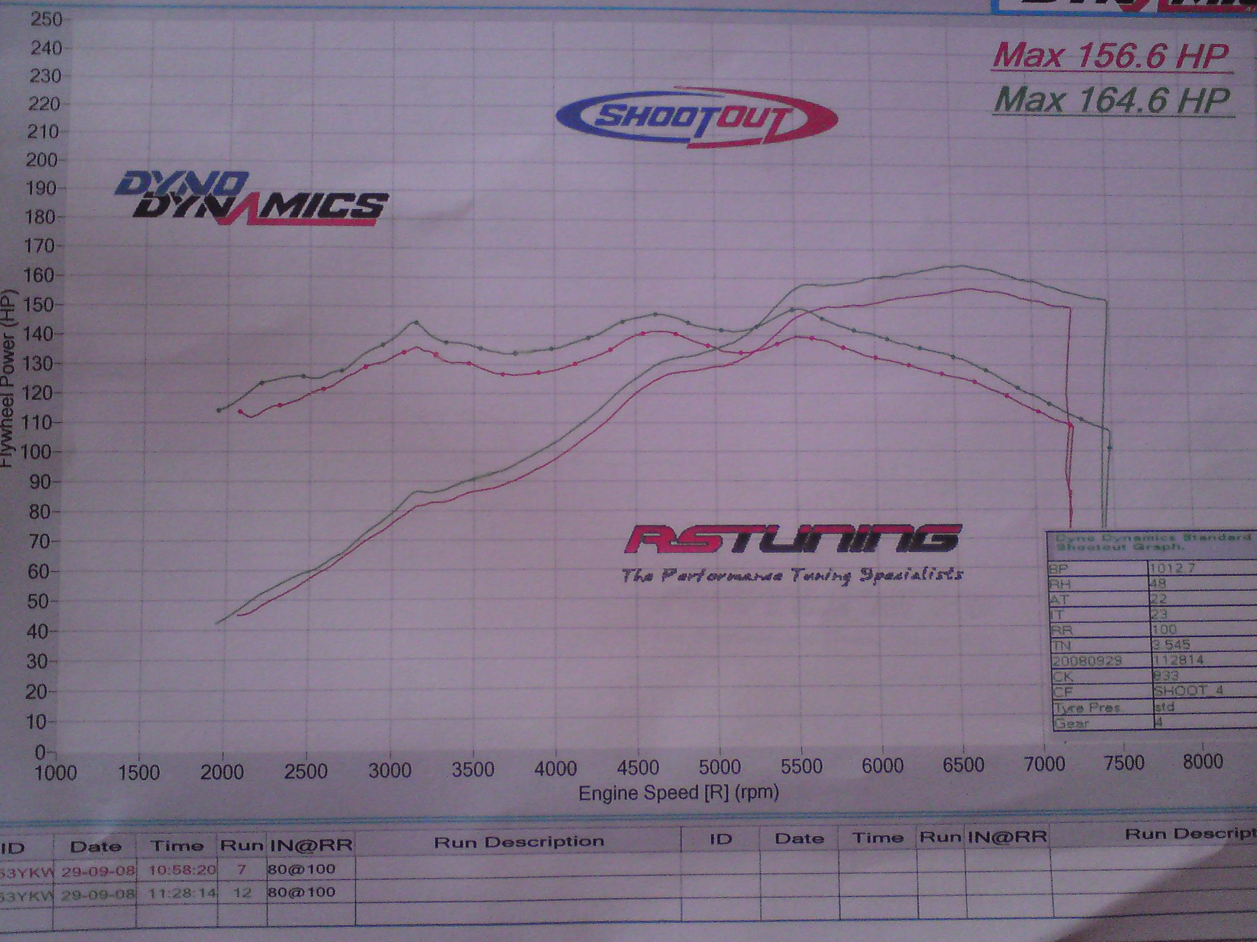

TooneySonic Car 182 Apr 20, 2009 #6 remapping is worth it but as has been said do any other mods first, always map last to suit pay a visit to RStuning in leeds, here is my remap result; Attachments DSC00026.webp 356.3 KB · Views: 73
