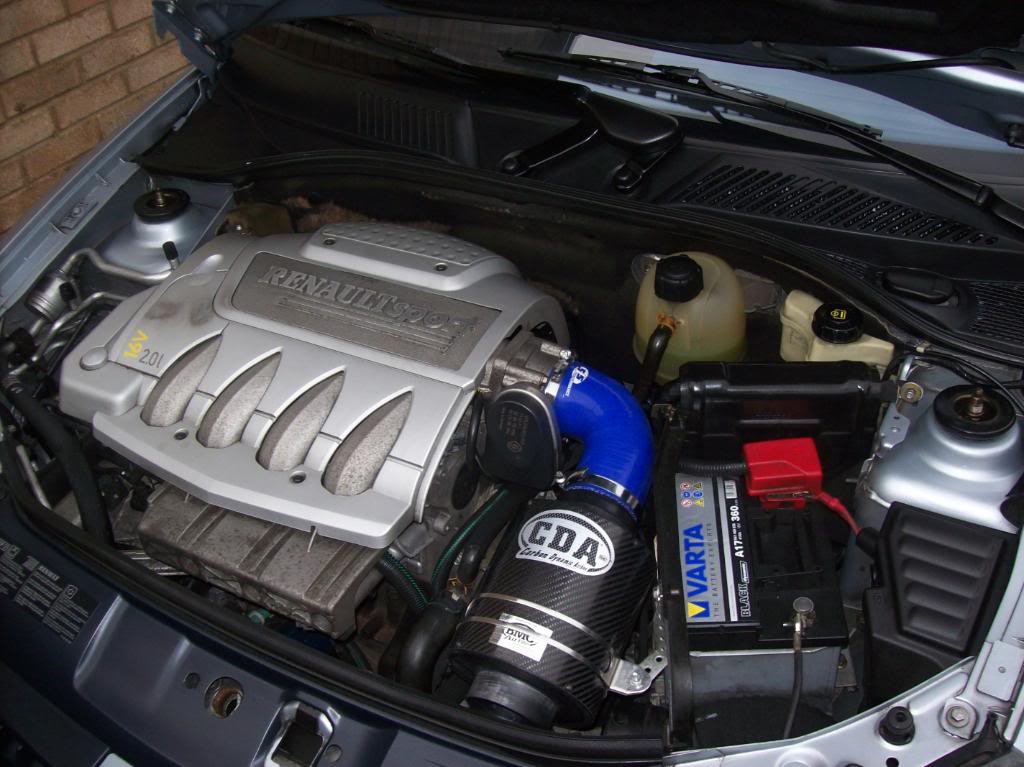

Is there a guide or a simple way to remvoe the Injector cover? I want to remove mine to clean and tidy up the engine bay but I cannot find any information on how to remove it. Does any one have a photo guide or something?

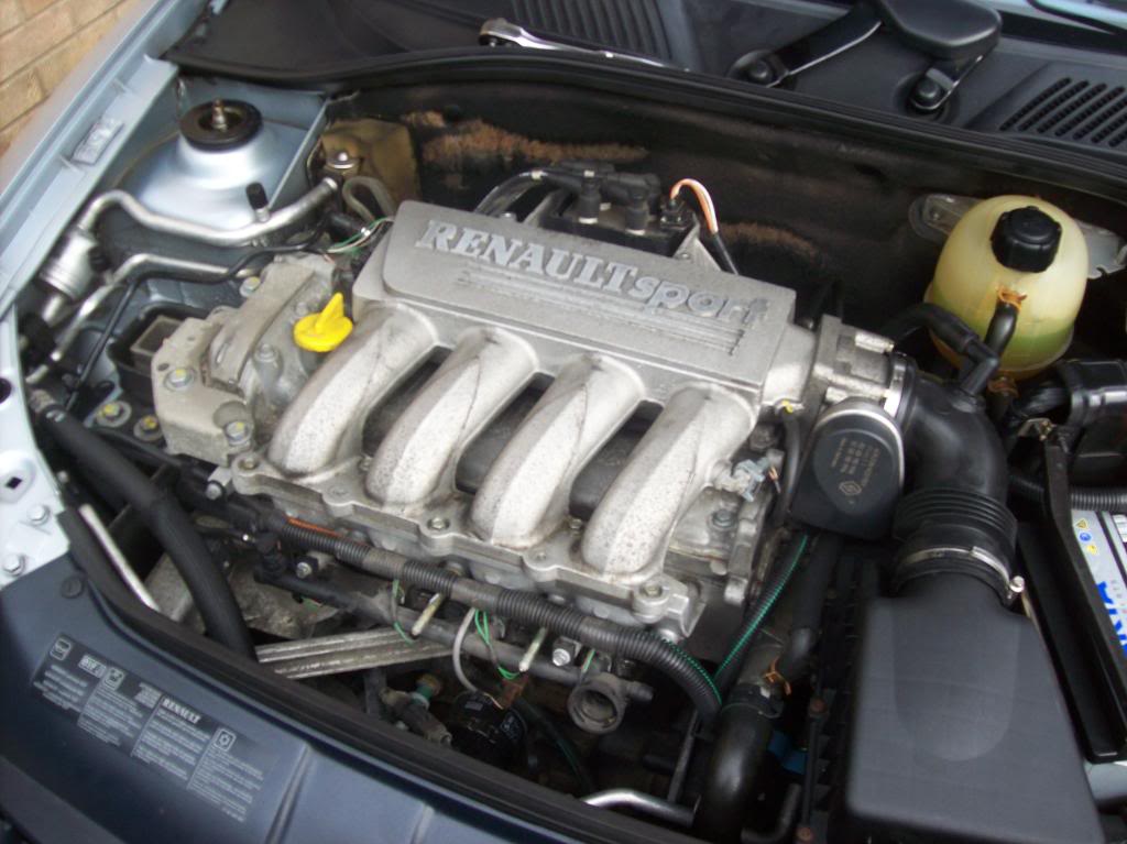

2 holes located on the front of it, in there theres a nut 10mm iirc
Picture of it removed shows the 2 studs that its fasterned on.
